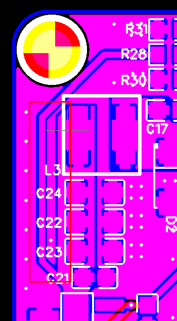

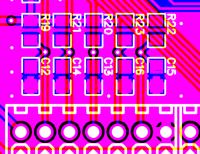

    I glanced at the layout out of curiosity. As I understand it, the connector at the bottom is only the input for signals and power supply ? In the case of the output for e.g. 3.3V it is better to derive the power supply from the capacitor (C28) not from the leg of the stabiliser.
    - Around C23, C22, C24 you have such a messy fill. It's good that there is one via there to whip up the antenna effect but with inverters it's worth just cutting something like that out.
    - Have you thought about routing the paths to C12, C14, C13, C16, C15 differently? So that the signal first enters these capacitors (no via, each via is an inductance) and only then from the capacitor to the IO ESP. In this way, using already small capacitances with NPO dielectric and an operating voltage of 50V, you can have a minimum ESD protection of these inputs.

    >>21488596 The connectors at the bottom are signal inputs/outputs, you are right, the via could have been moved a few mm to the left. The area around C24, C22, C23 I left that filling as such "isolating" the feedback path from the +5V line, while I was doing it "by feel", I don't have much experience in designing DC-DC converters, next time I will remember. As to the last point, I've heard somewhere that the ESP32 has ESD protection as such, but I don't know how effective it is. Inductance probably doesn't matter too much in this case, I don't foresee signals above 100Khz for I2C. Anyway, also an interesting comment about ESD protection, I will try to follow it in the future.

  • Short ESD path to capacitors and spark gaps

    >>21489747 ESD protection in the ESP itself may not be able to help. The system is too far away. The potential landing will extend across the board and may "mess up". Therefore, it would be best to connect along the TOP layer by the shortest route to capacitors C12-C15 and only from them take the signal further. Somewhere you have to take over and dissipate this energy charge. There is also the option of using spark gaps on the PCB. This is for the future.
    According to the datasheet, the ESP32U has:
    - Human body model (HBM): ±2000 V which is not too much.
