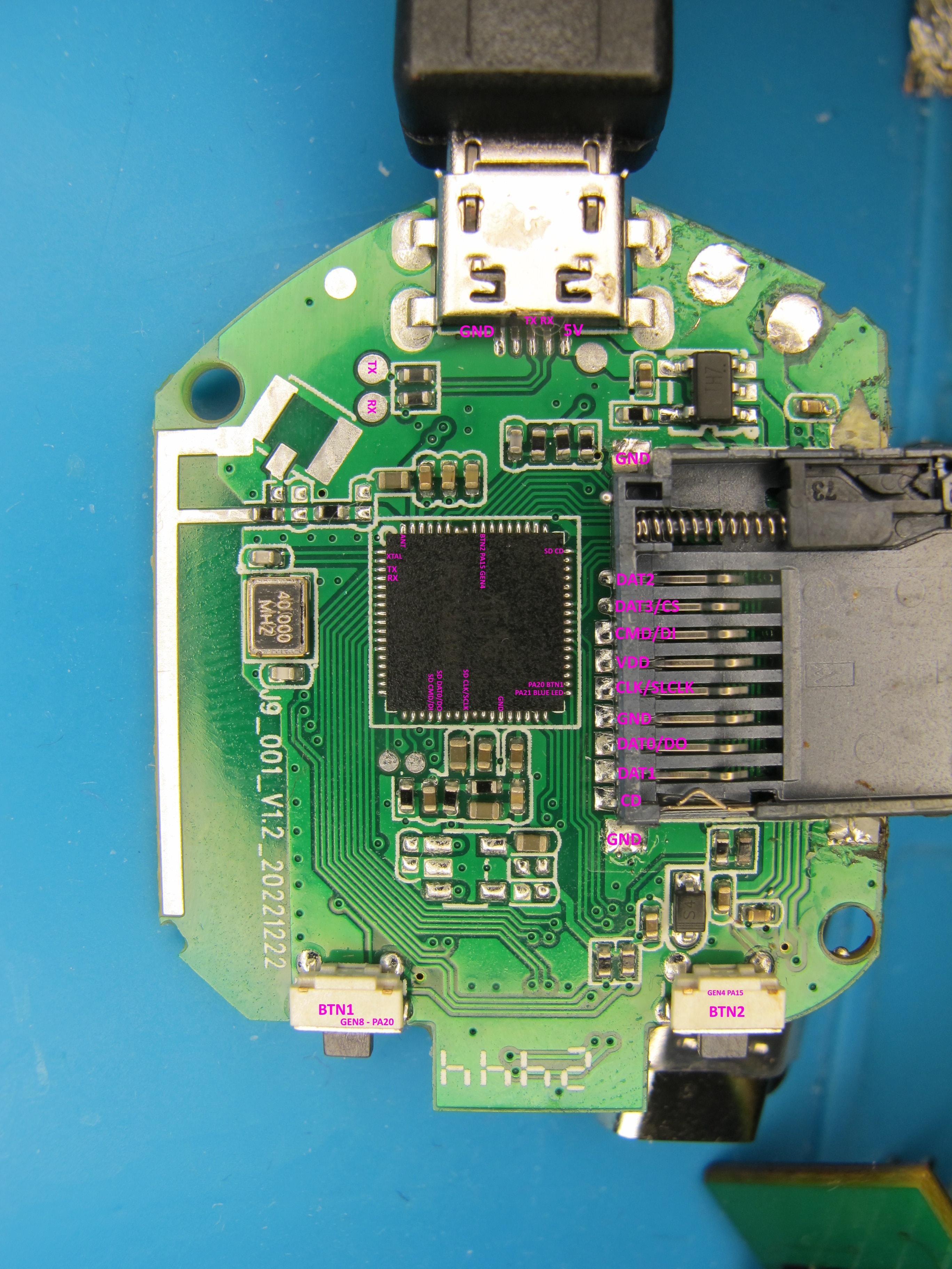

    @insmod @p.kaczmarek2

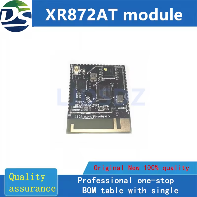

    I was thinking about tracing as many of the XF16 pins as possible against known components/functions, like RX/TX, LEDs. BUT, can what been seen in XR872 currently be relied on as a correct XR872 pin number to any extent? I'm thinking maybe not yet
    Screenshot of a configuration interface showing a list of pins and dropdown menus with editable value fields.
  • #187 21575844
    Posts: 5026
    Help: 438
    Rate: 891
    work in progress

    I think you'd probably need to add more entries here:
    https://github.com/openshwprojects/OpenBK7231T_App/blob/main/src/hal/xr809/hal_pins_xr809.c
    Check respective SDKs for what may be present and then check each pin one by one:
    Code: C / C++
    Check here:
    https://github.com/openshwprojects/OpenXR872/...343b51ba9/include/driver/chip/hal_gpio.h#L657

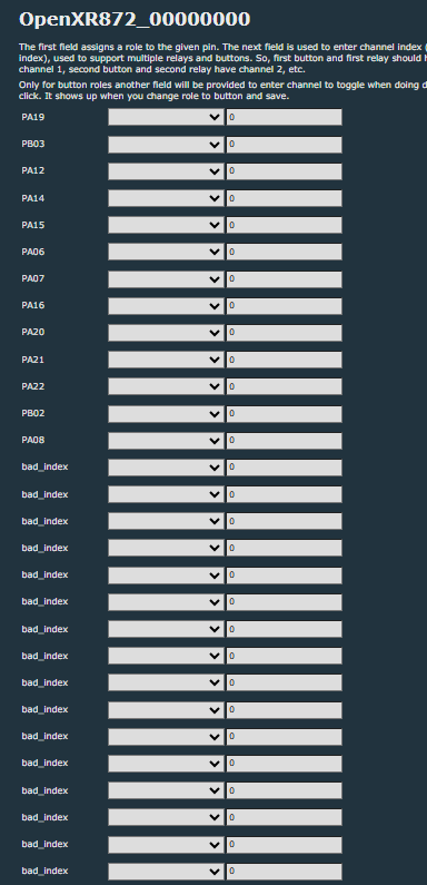

    This seems to mean that there are at most:
    #define GPIOA_PIN_NUM    24
    #define GPIOB_PIN_NUM    22
    #define GPIOC_PIN_NUM    13
    24+22+13 pins to check, but usually not all are routed out on the case.

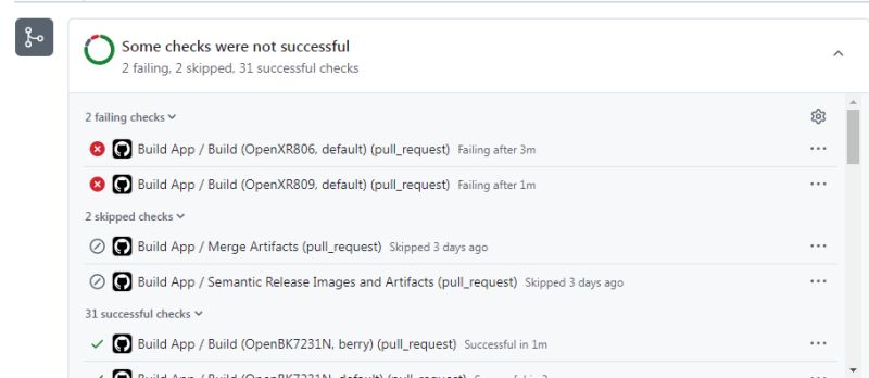

    You're getting XR809 and XR806 build errors because port C seems to be present only on XR872.
    Exploring A9 Minicam Variation: XF16 PB380EA6341 MCU, T25S80 SPI Flash, XR872, Skylark SDK
    Code: C / C++
    Probably just need to take PORTC pins into the #if PLATFORM_XR872 block

    Posts: 5026
    Help: 438
    Rate: 891
    Ah ok. Thanks. It also looks like this in gui so I'm missing something else too. Need to get back to looking at it
  • #193 21580264
    Posts: 14580
    Help: 654
    Rate: 12604
    There is also PLATFORM_GPIO_MAX in new_pins.h

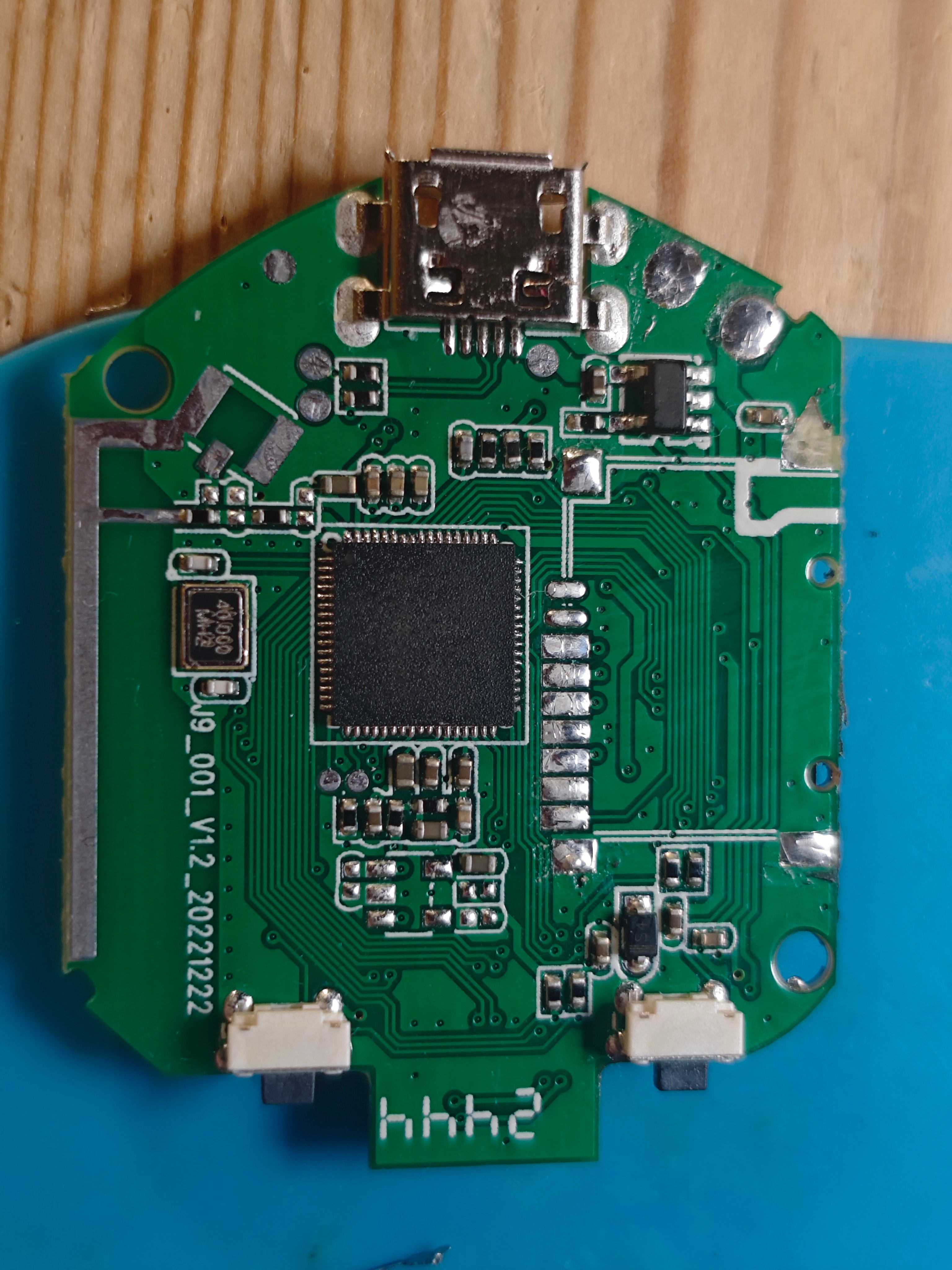

    :( ok ok. thanks. will come back to it probably. I need something more concrete to check pins against than the XF16 so have ordered this
    need to locate datasheet or trace though as it doesn't look like contacts are labelled. Alibaba/Tmall module

    should this get merged first? https://github.com/openshwprojects/OpenXR872/pull/2
    I wonder if it would help with this size issue when more pins are set https://github.com/openshwprojects/OpenBK7231T_App/actions/runs/15688113310/job/44196324941

    My sample is the same as your post #121 in this current thread (https://www.elektroda.com/rtvforum/topic4074636-120.html#21530504)
    Bought here: https://aliexpress.com/item/1005006948283462.html
    Is this what you mean?
    And yes, it is what I meant.

  • Confirmed XF16 camera-connector tracing mapped SDA/SCL to PA18/PA17, PCLK to PA08, MCLK to PA09, HSYNC to PA10, VSYNC to PA11, and DVP data lines across PA00–PA07. [#21732686]

How can I trace the 18-pin FFC camera connector on an XF16 A9 board to map SDA, SCL, DVP data pins, MCLK, HSYNC, VSYNC, and PCLK to XR872 GPIOs?
The cleanest method is continuity tracing plus a pin-toggle test firmware. On the confirmed XF16 A9 mapping, pin 2 is SDA on PA18, pin 3 is SCL on PA17, pin 13 is MCLK on PA09, pin 12 is HSYNC on PA10, pin 11 is VSYNC on PA11, pin 15 is PCLK on PA08, and DVP data runs from PA00–PA07. Contributors validated the map with an 18-pin FFC walker that pulsed each GPIO while a multimeter watched the connector. [#21732686]
