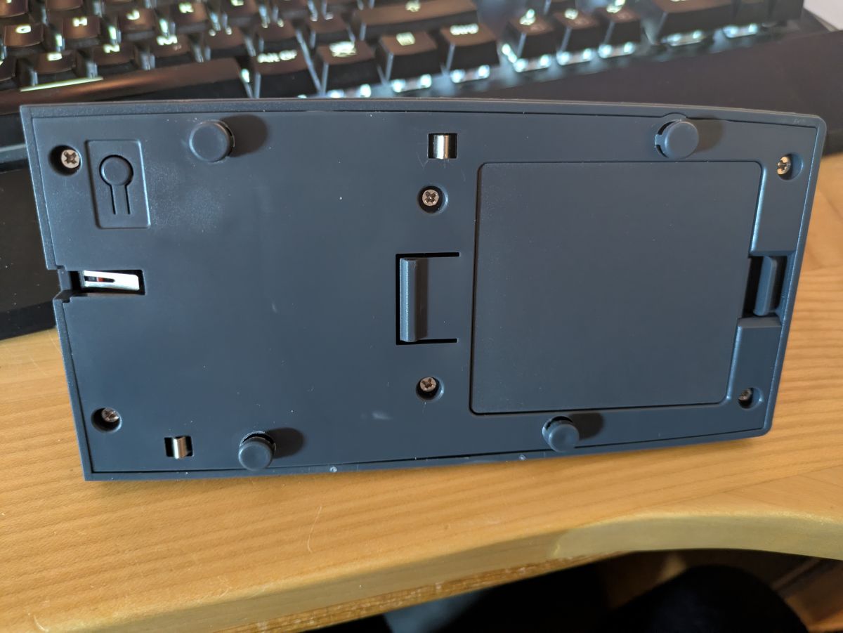

    Opening of the trap is quite simple. Unscrew the 6 Phillips screws shown in the picture.
    The bottom of a plastic electronic device with a battery compartment and rubber feet.

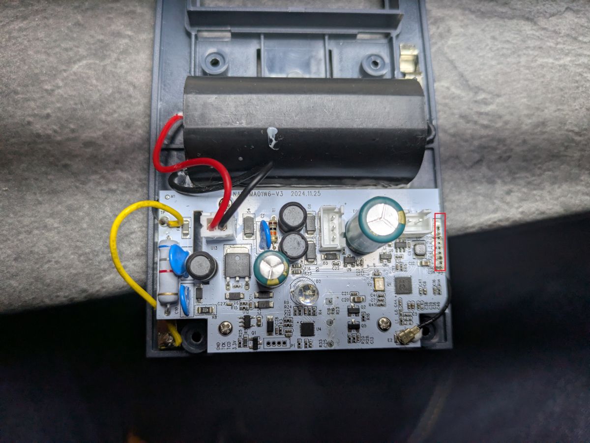

    For flashing, labeled connectors are located on the right side of the board. In the photo, they are outlined in red.
    Open enclosure with visible circuit board and connected wires.
    Add Startup Command Text :
    backlog startDriver tuyaMCU; startDriver tmSensor; linkTuyaMCUOutputToChannel 101 val 0; linkTuyaMCUOutputToChannel 102 val 1; linkTuyaMCUOutputToChannel 103 val 2;
    Channel 0 and Channel 2 show mouse catch.
    Channel 1 is Battery status. 0=100%, 1=75%, 2=50%, 3=25%
