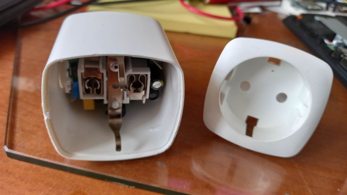

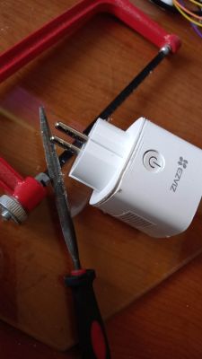

    To remove the top plug at the socket, just pry it up. Unfortunately, removing the PCB without destroying the housing seems impossible. An attempt to knock out and unscrew the pins gave nothing, so they were probably sunk in the plastic of the housing. Unfortunately, even heating them with hot air did not help. Desoldering them and removing them from the PCB is also not an easy task - I managed to collect tin from the outside, but a lot of it was left on the bottom of the board and there was no way to melt it. Trying to remove the plastic in the middle holding the socket plates, one of them fell off. The only way to disassemble was to cut the casing. I've done it so that it can be easily glued if needed...

    Inside there is a quite popular TYWE2S microcontroller, compatible with ESP, so theoretically you can throw FW Tasmota and EspHome.
    In practice, this involves either destroying the device's housing and soldering it to the board, or you could make a small PCB (or some wire structure on a piece of tape or something similar) to size with the corresponding pin spacing, try to stick it to the TYWE2S board, or catch on a magnet and then program. However, this is a daunting task.
    Tuya-convert over Wifi turned out to be ineffective. I wanted to check if it will start after shorting GPIO0 to GND, but after inserting the plug there was some short circuit and gray smoke went. Probably during heating and trying to pull out the pins some tin poured where it shouldn't, but fortunately the strip, UPS and fuses passed the test positively. ;) In the face of this fact, I decided to finish the work and it turned out that some layout was fried from the bottom ...

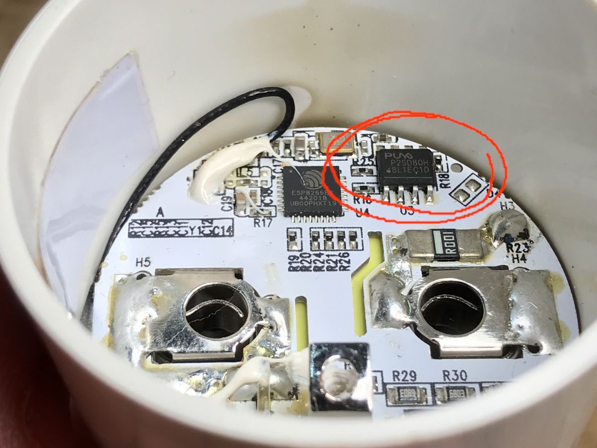

    I have several Neo NAS-WR01W, but I approached the matter a little differently. After unscrewing the triangular screw (I sawed off the star bit to unscrew it) and ejecting the electronics by pushing out the pins, you can desolder the P25D80H visible next to the ESP, solder it to the SOP base on DIP and throw the FW through the programmer. I used XGecu T48, but even CH341A should be enough. This is probably the fastest and least invasive way. ;)
    [TYWE2S] Ezviz CS-T30 10A EU (WG08(10)V1.4) brute-force teardown
    I'm going to add this info in the linked entry about Neo, because maybe someone will find it useful. ;)
