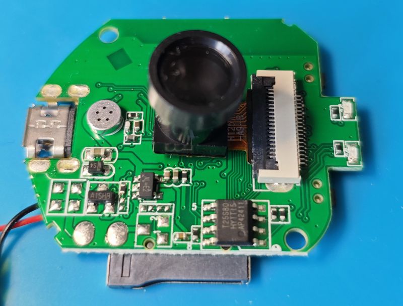

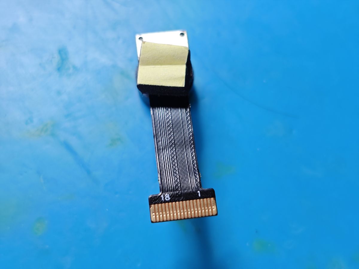

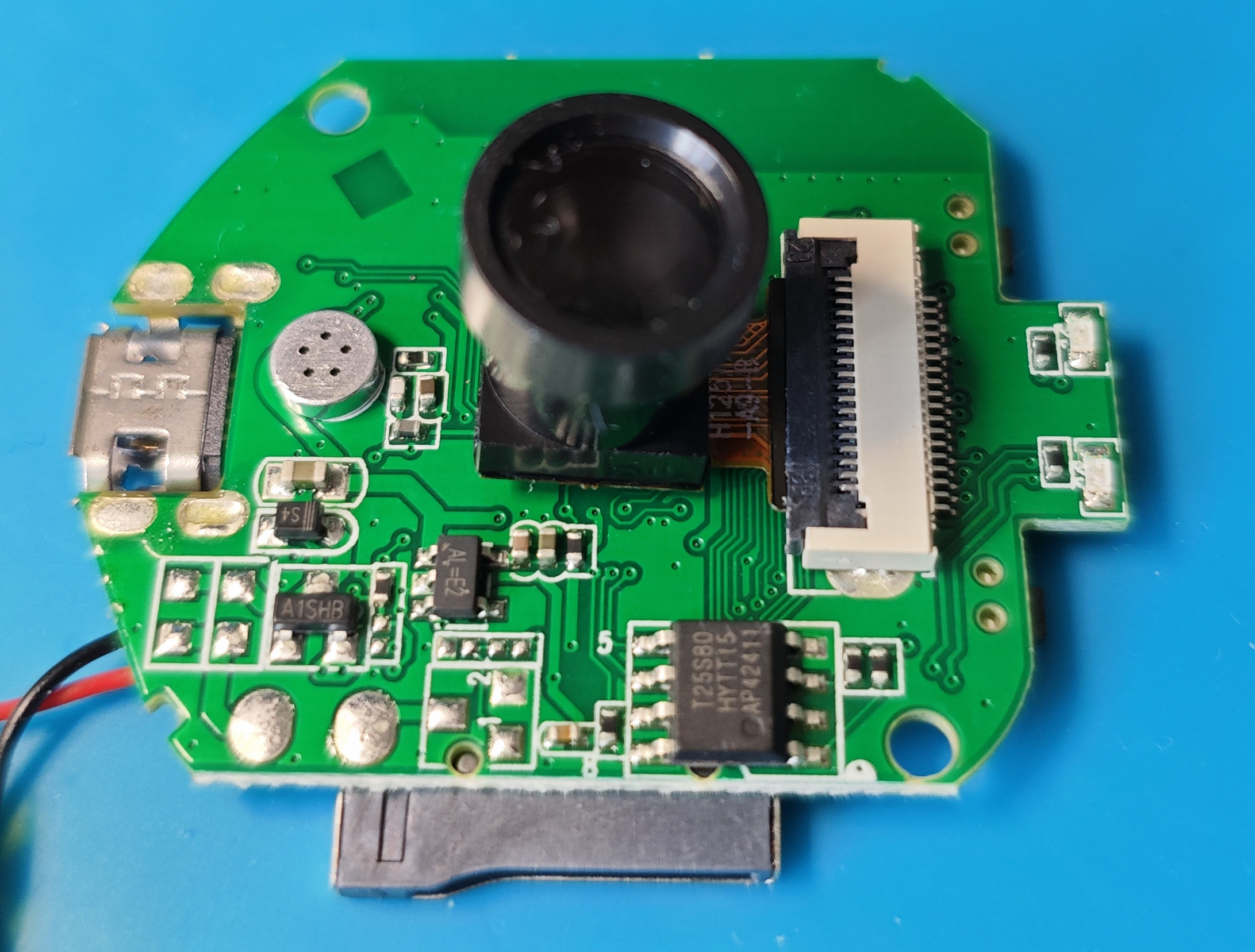

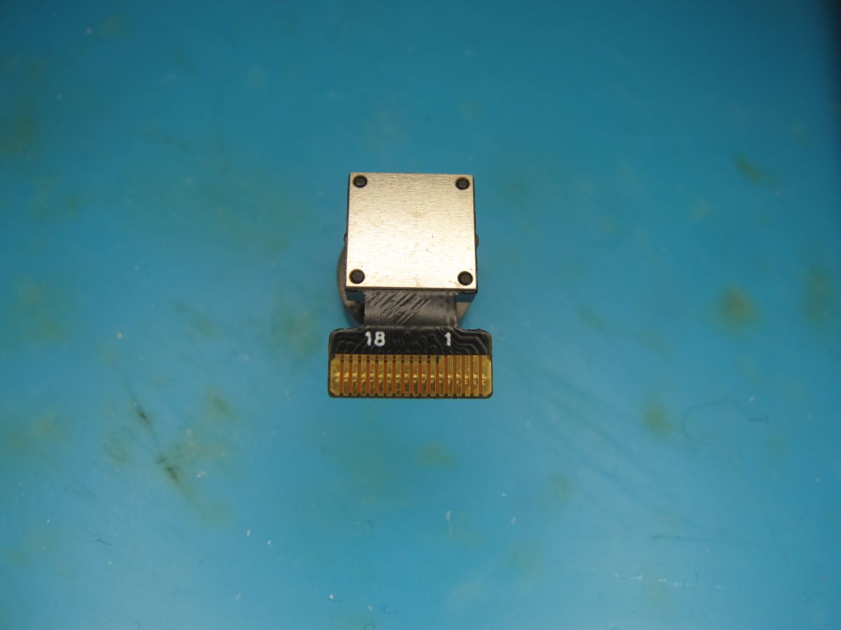

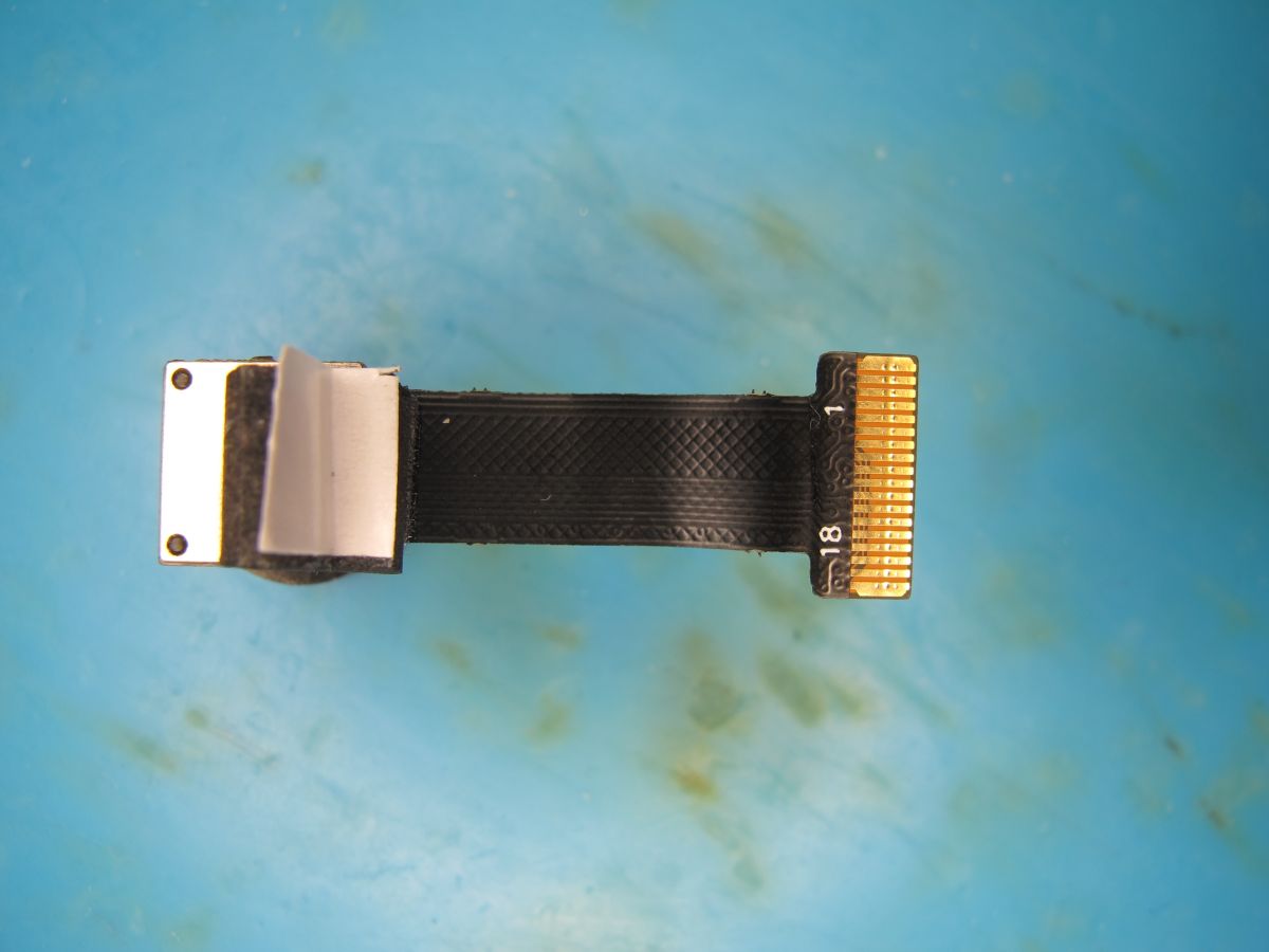

    I have a small collection of X6, A9 and X5 mini spy cams with main chips from Taixin, Beken and XRadioTech. One commonality is the 18-pin FFC (flexible flat cable) ZIF (zero insertion force) connector that the cam modules are connected to the main PCB with.
    A mini spy camera circuit board with a microphone, lens, and 18-pin FFC ZIF connector on a blue background.
    From looking at strings in the firmware dump of an XRadio XF16 chip it seems the XF16 might support this list of cams:
    The XF16's uart log out is helpful enough to print which one it detects is connected. This presents a good opportunity to identify each cam, assuming the pins are the same. Often identifying text printed on the ribbon doesn't make it immediately obvious what make/model the cam is. Here'll I'll present pics and the relevant XF16 boot log to show initialisation. Maybe this will help others to identify their cameras. It is also a record for me of what I have.

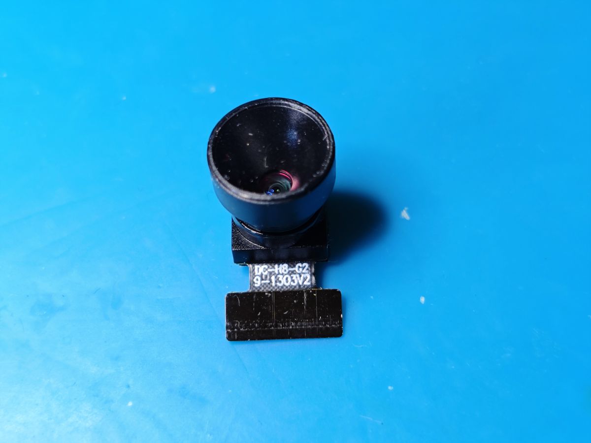

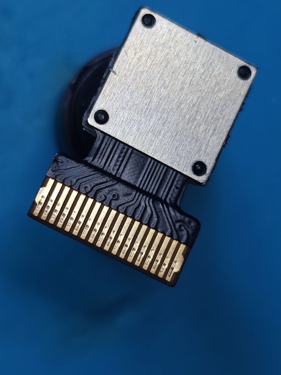

    GalaxyCore GC0329 DC-H8-G2 DC-H8-C2 9-1303V2
    Mini camera module with wide-angle lens and FFC cable on a blue background. Mini camera module with 18-pin FFC ZIF connector, viewed from connector side, on a blue surface.

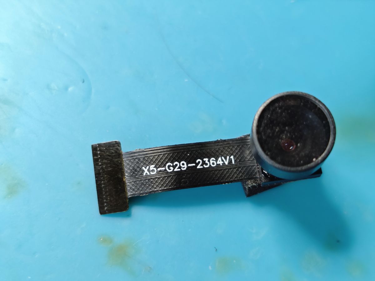

    Init
    GalaxyCore GC0329 X5-G29-2364V1
    Camera module with X5-G29-2364V1 printed on a black FFC cable lying on a blue surface. Mini camera module with connected 18-pin FFC cable on a blue surface.

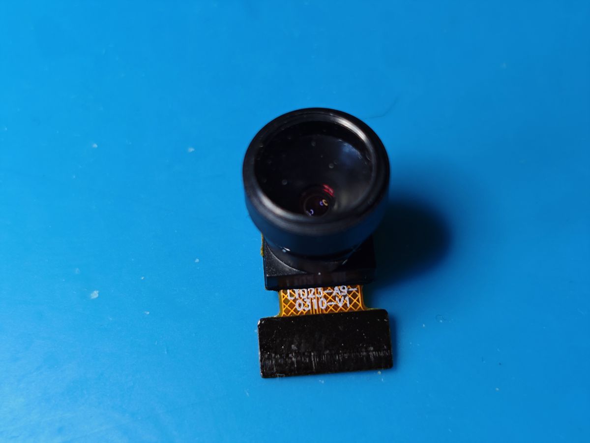

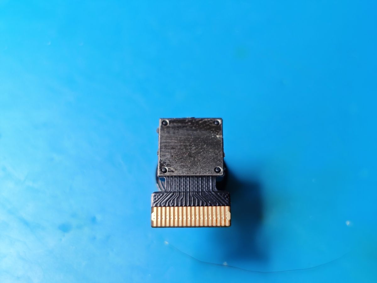

    GalaxyCore GC0310 LY023-A9-0310-V1 LT023-A9-0310-V1
    Mini camera module with fisheye lens and FFC ribbon cable on a blue background. Camera module with a flexible flat FFC cable and 18-pin connector on a blue background.
    Init

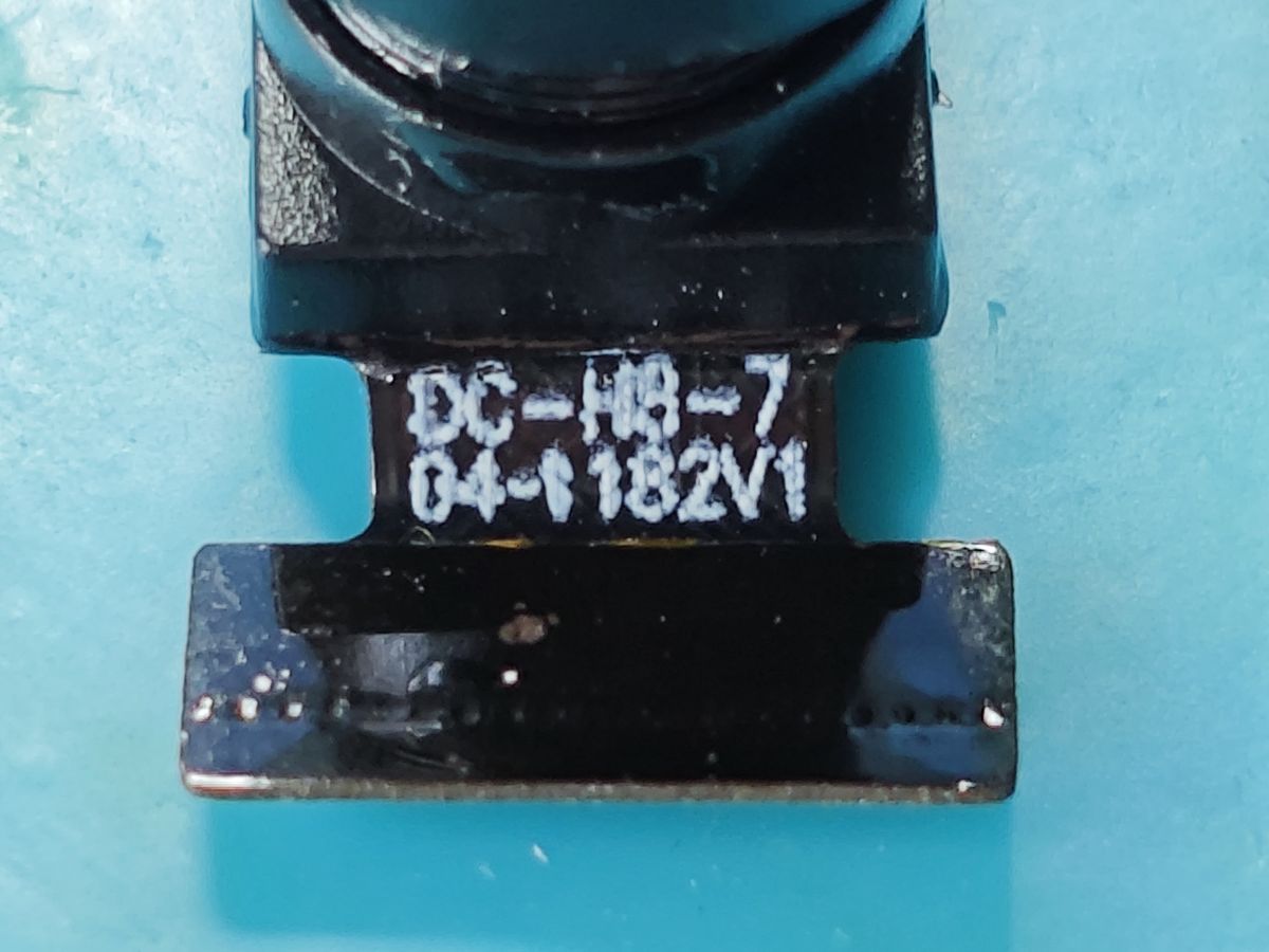

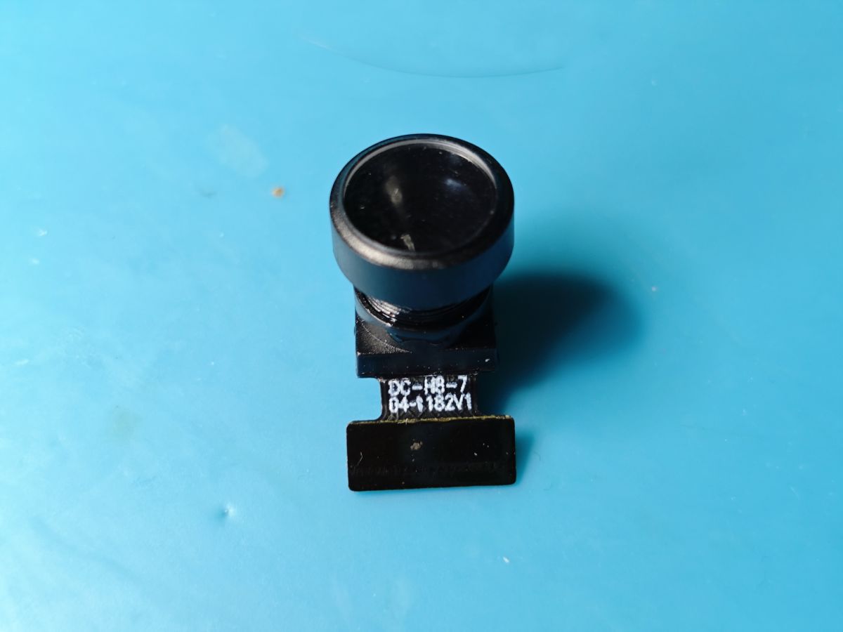

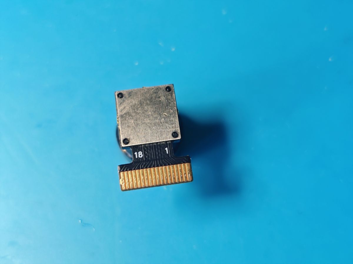

    Hynix HI704 DC-H8-704-6182V1 DC-H0-7040-6182V1
    A small camera module with a wide-angle black lens on a flat cable labeled DC-H8-7 04-1182V1, placed on a blue background. Close-up of a camera module labeled DC-H8-7 04-1182V1 on a blue background. Camera module with metal shield and 18-pin FFC/ZIF connector, front view on blue background.

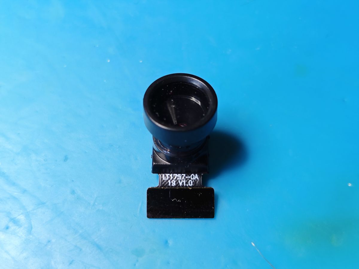

    SuperPix SP0A19 LT1757-OA-10 V1.0 LT1757-QA-19 V1.0
    Mini camera module with a large lens and FFC ribbon labeled LT1757-OA 1.0 on a blue background. Spy camera module with flexible flat cable and 18-pin FFC connector on a blue background.
    Init

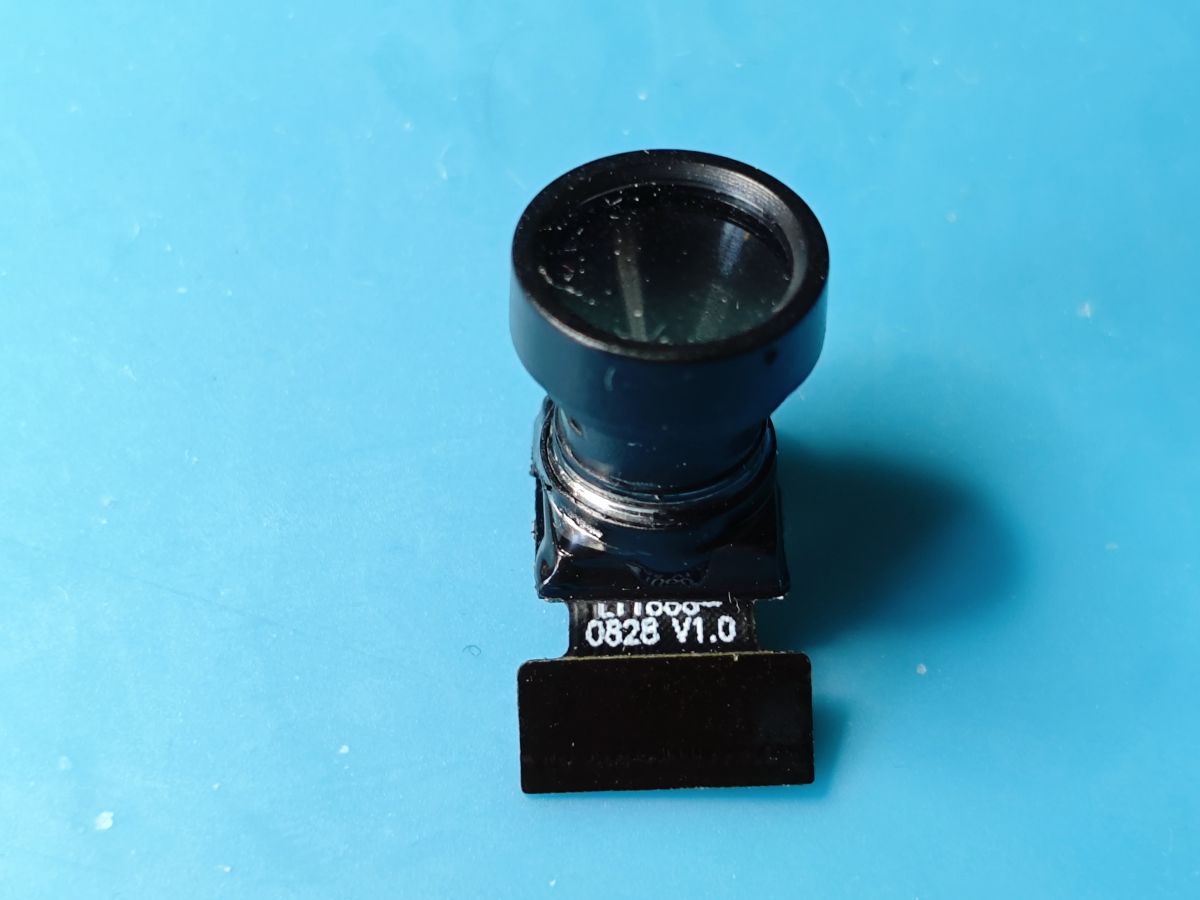

    SuperPix SP0828 LT1888-0828(?) V1.0 L11888-0828(?)
    Miniature camera module on a blue background, with a large lens and 0828 V1.0 marking on the board. Mini camera module with metal cover and 18-pin FFC connector on a blue background.
    Init

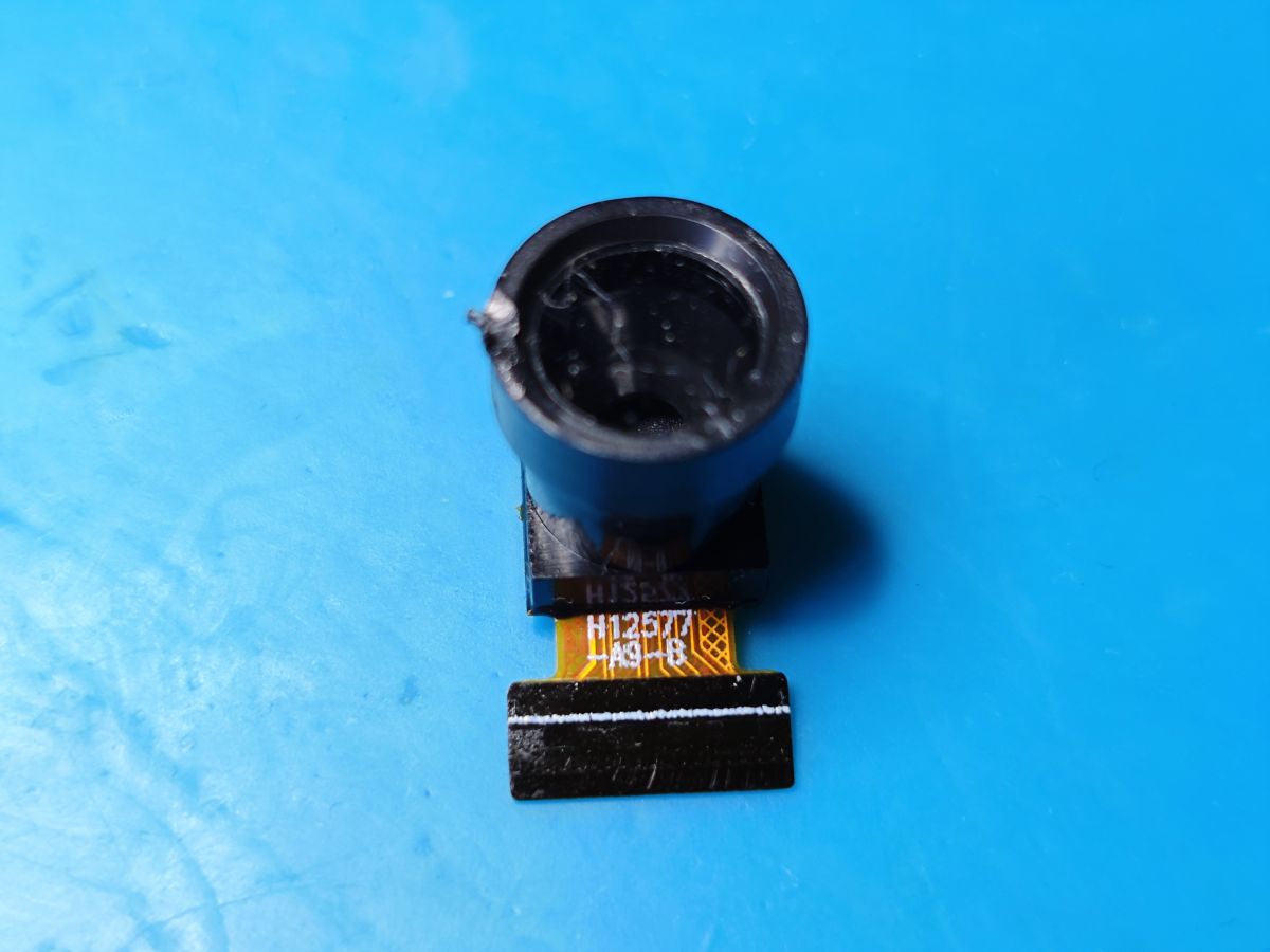

    SuperPix SP0828 HT12577-A9-B H12577-A9-8
    Miniature camera module with FFC ribbon cable on blue background, marked H12577 A9 B on the cable. Mini camera module with 18-pin FFC ZIF connector on a blue background, viewed from the shielding side.
    Init

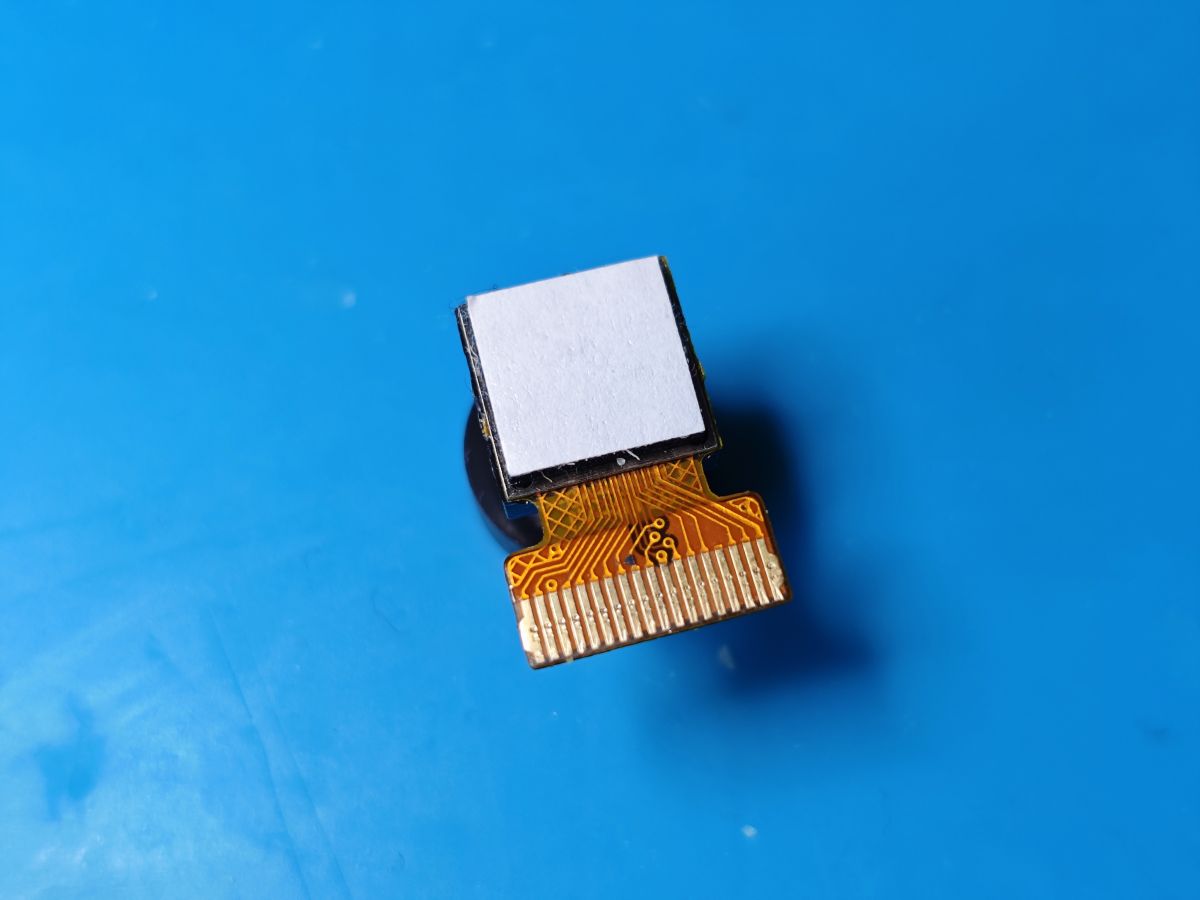

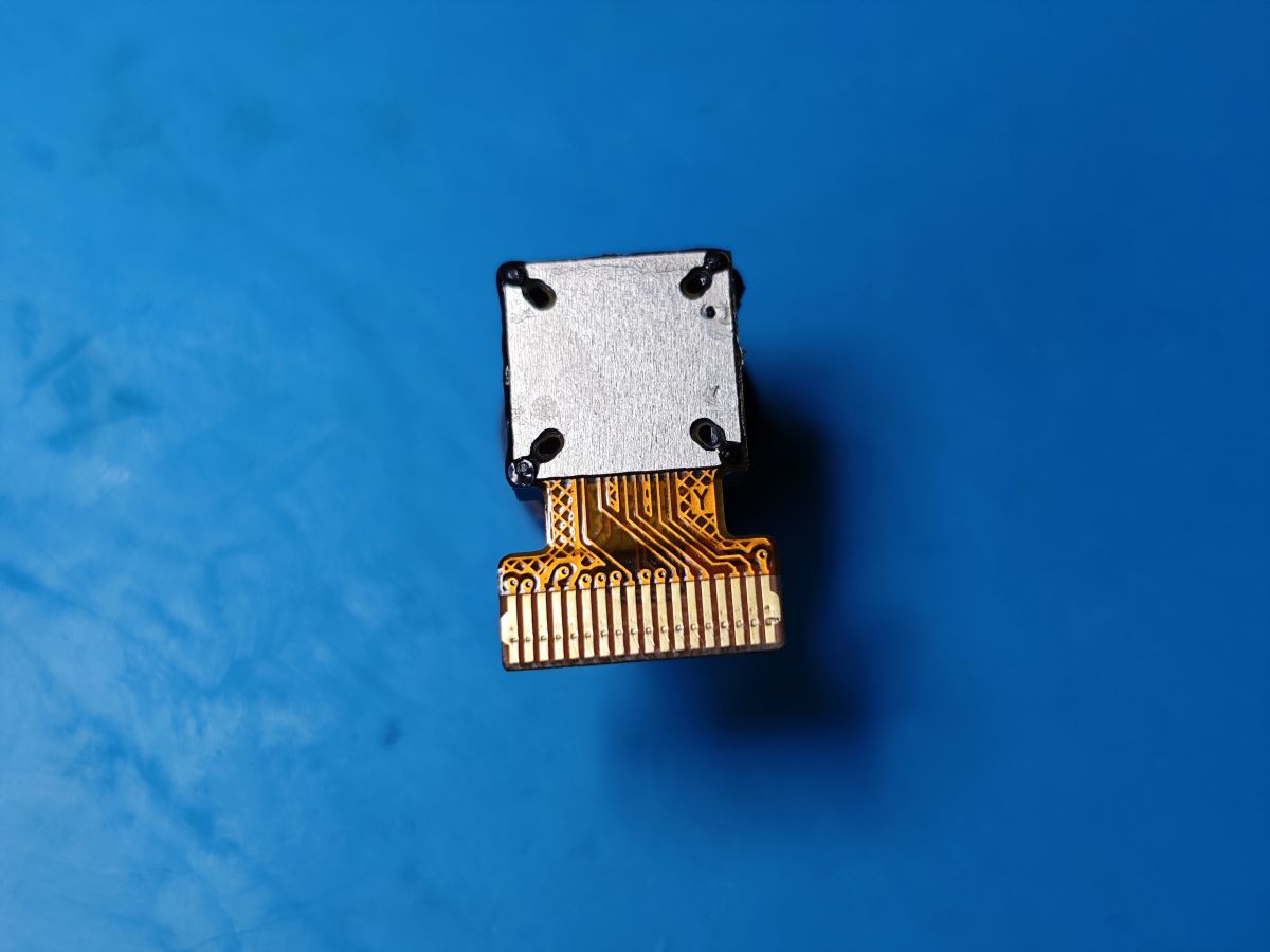

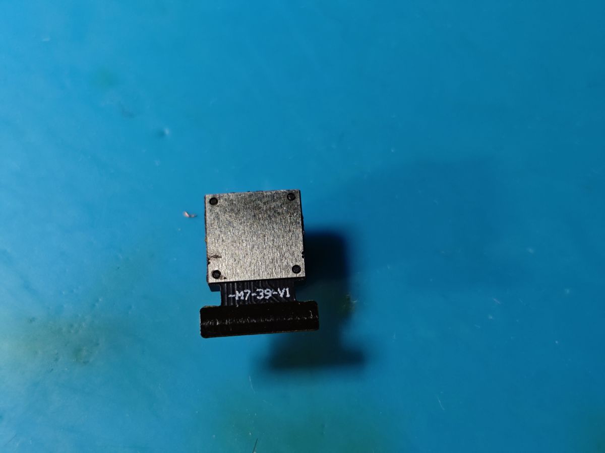

  • GC0309 detected in Tuya mini doorbell module
    #2 21550528
    Posts: 5208
    Help: 446
    Rate: 914

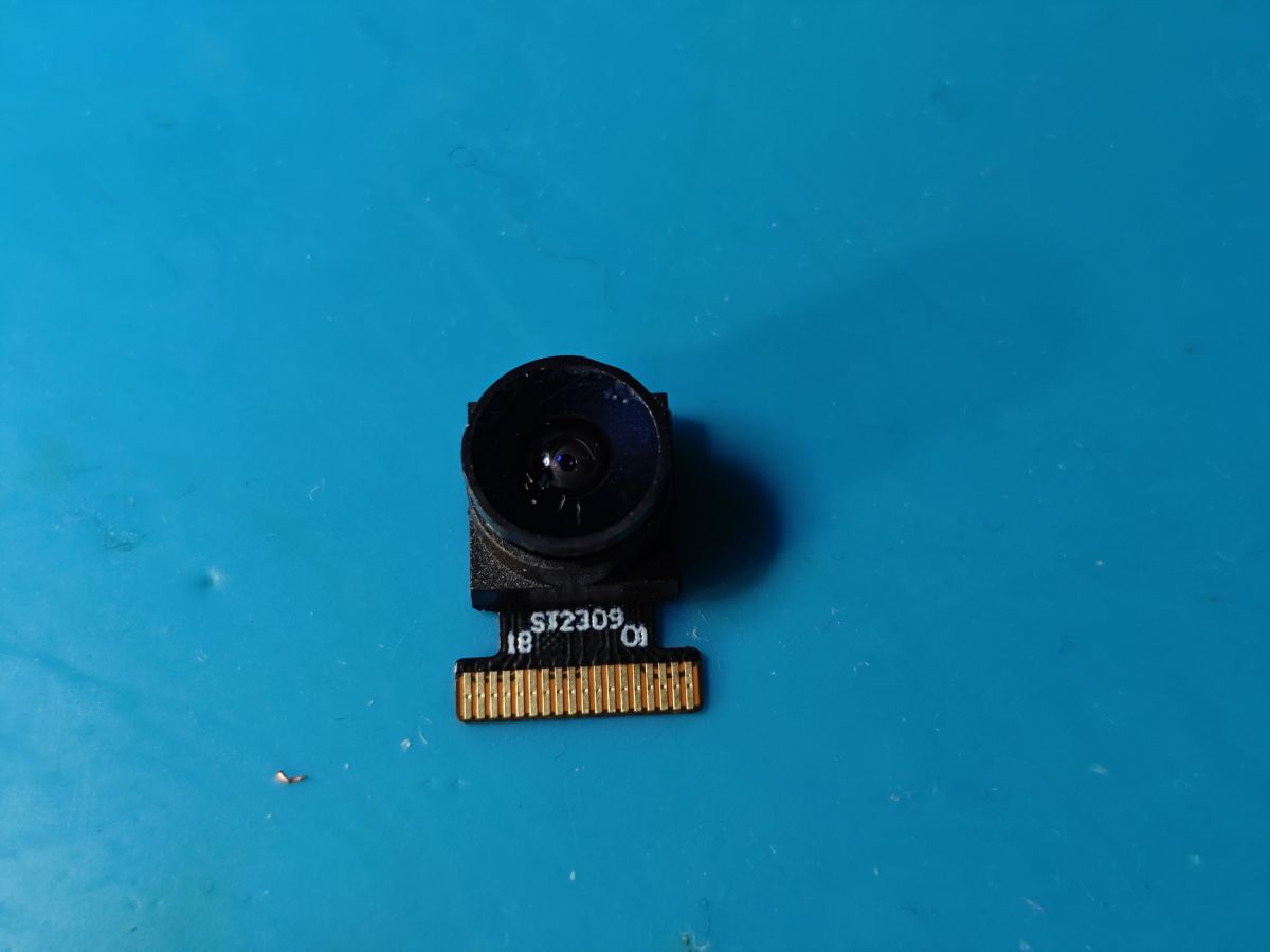

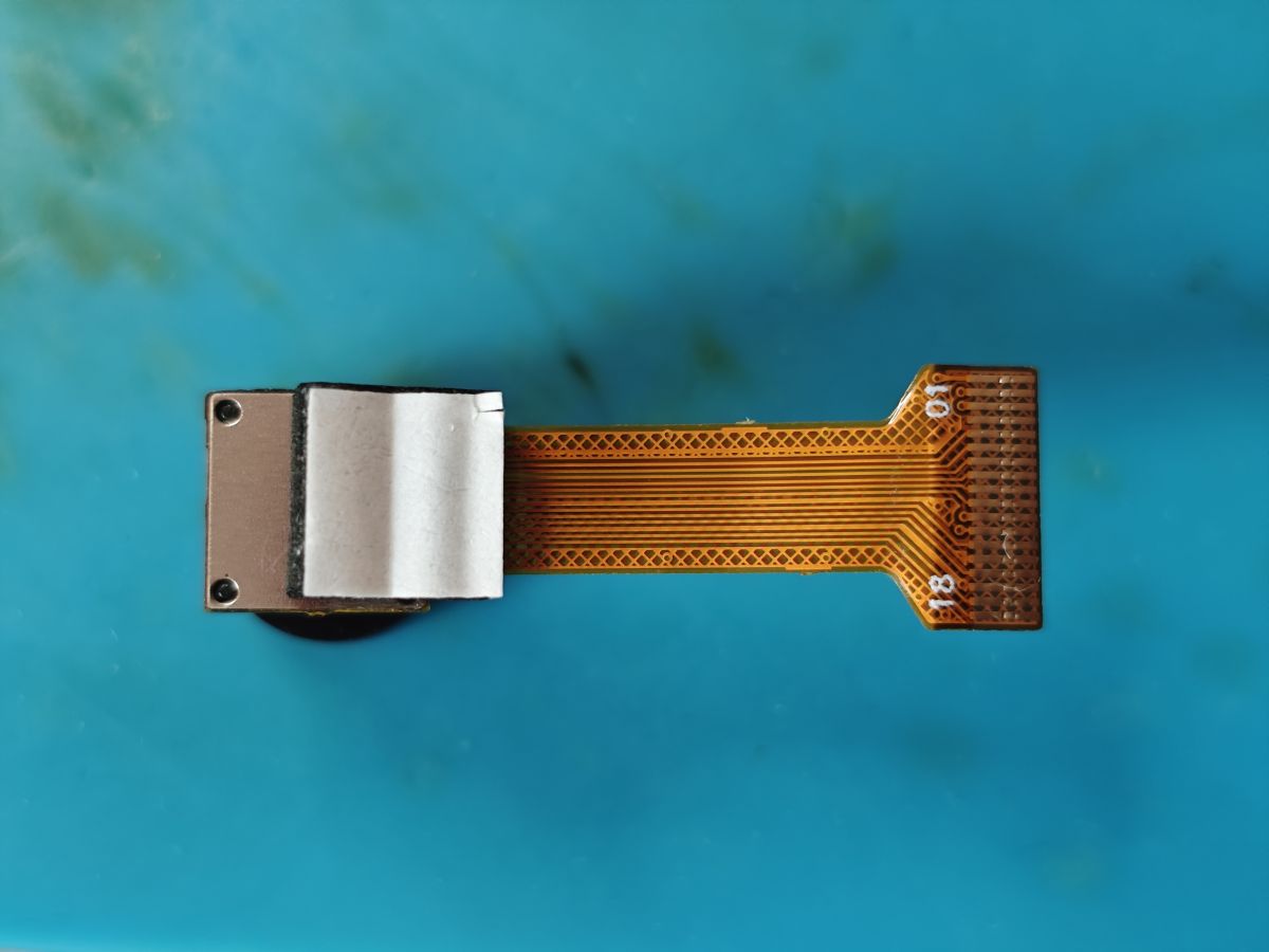

    And from a Tuya mini doorbell (not this one but very similar). Contacts are on the opposite side of ribbon for this one as the cam points back through a hole in the PCB.
    GalaxyCore GC0309 SI2309 ST2309 -M7-39-V1
    Camera module with lens and electronic connector on a blue background. Metal electronic component with M7-39-V1 marking on a blue background.
    Init

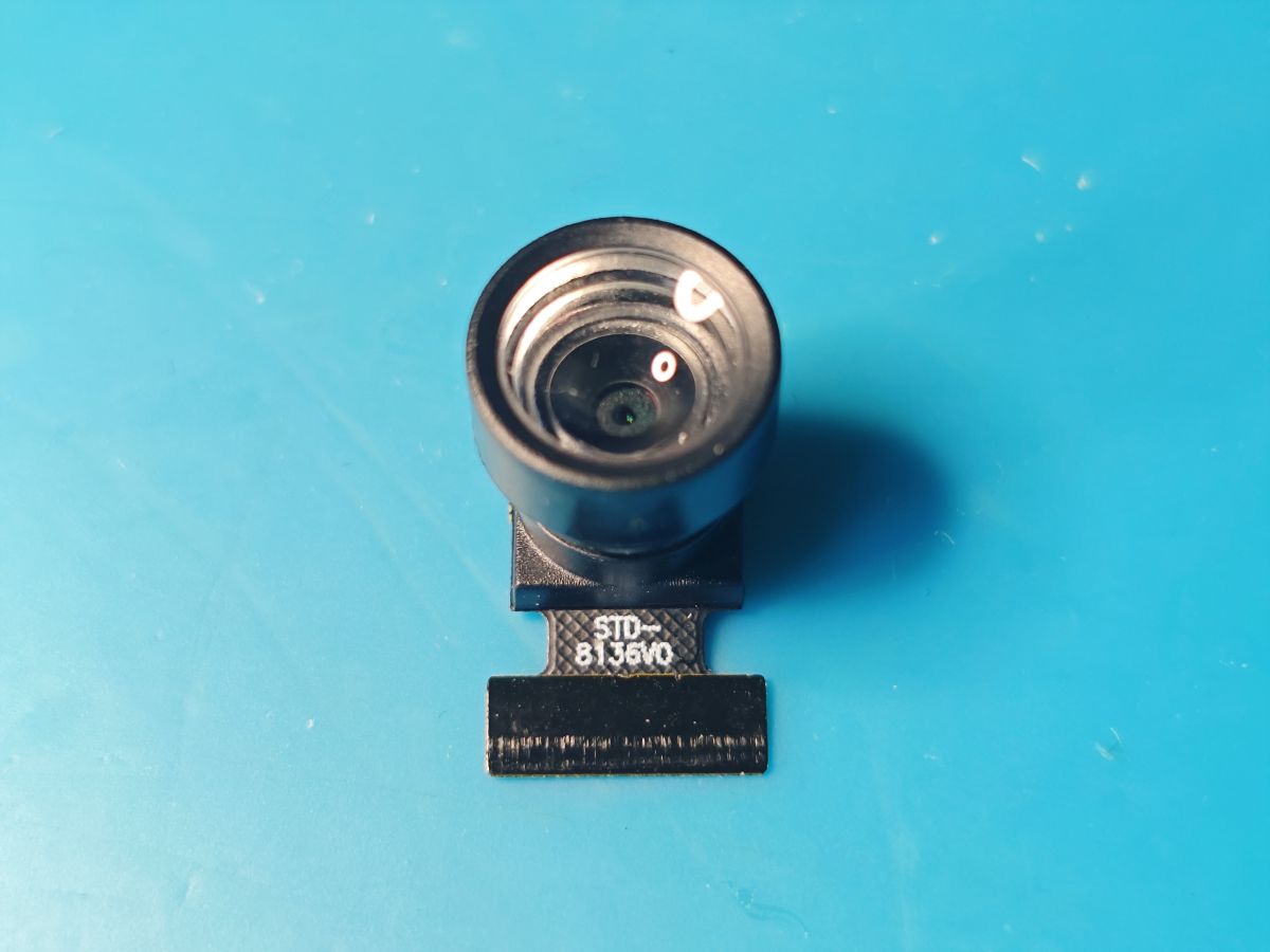

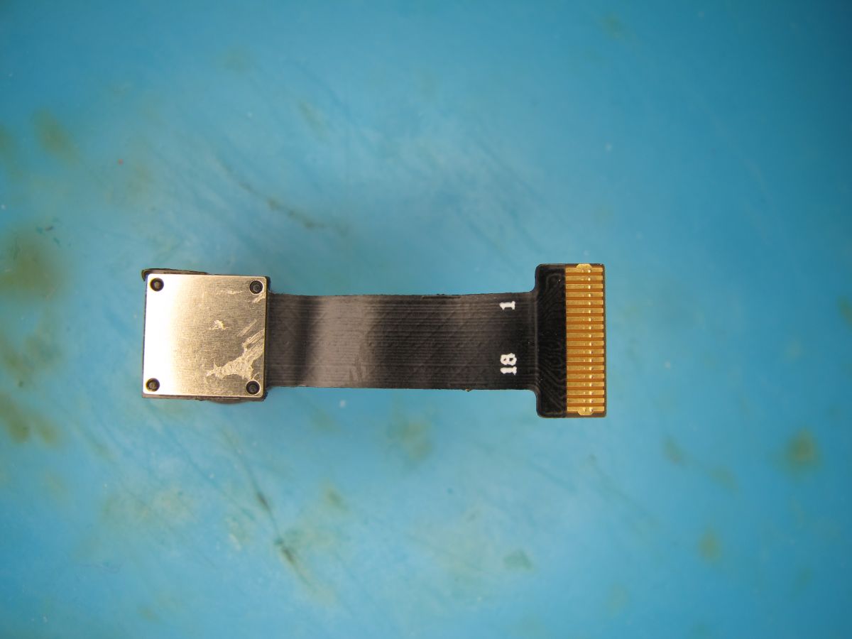

  • GC0312 detected on BK7252UQN48 device
    #3 21583310
    Posts: 5208
    Help: 446
    Rate: 914

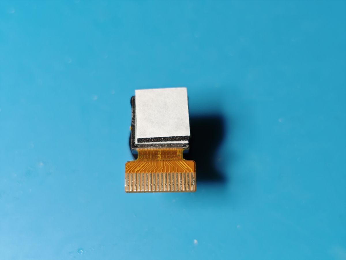

    from a new BK7252UQN48 device
    GalaxyCore GC0312 STD-8136V0 STD-8136VO
    Identifying Mini Cam Modules: Hynix HI704 - GalaxyCore GC0329,GC0309,GC0310 - SuperPix SP0A19,SP0828 Identifying Mini Cam Modules: Hynix HI704 - GalaxyCore GC0329,GC0309,GC0310 - SuperPix SP0A19,SP0828
    Init

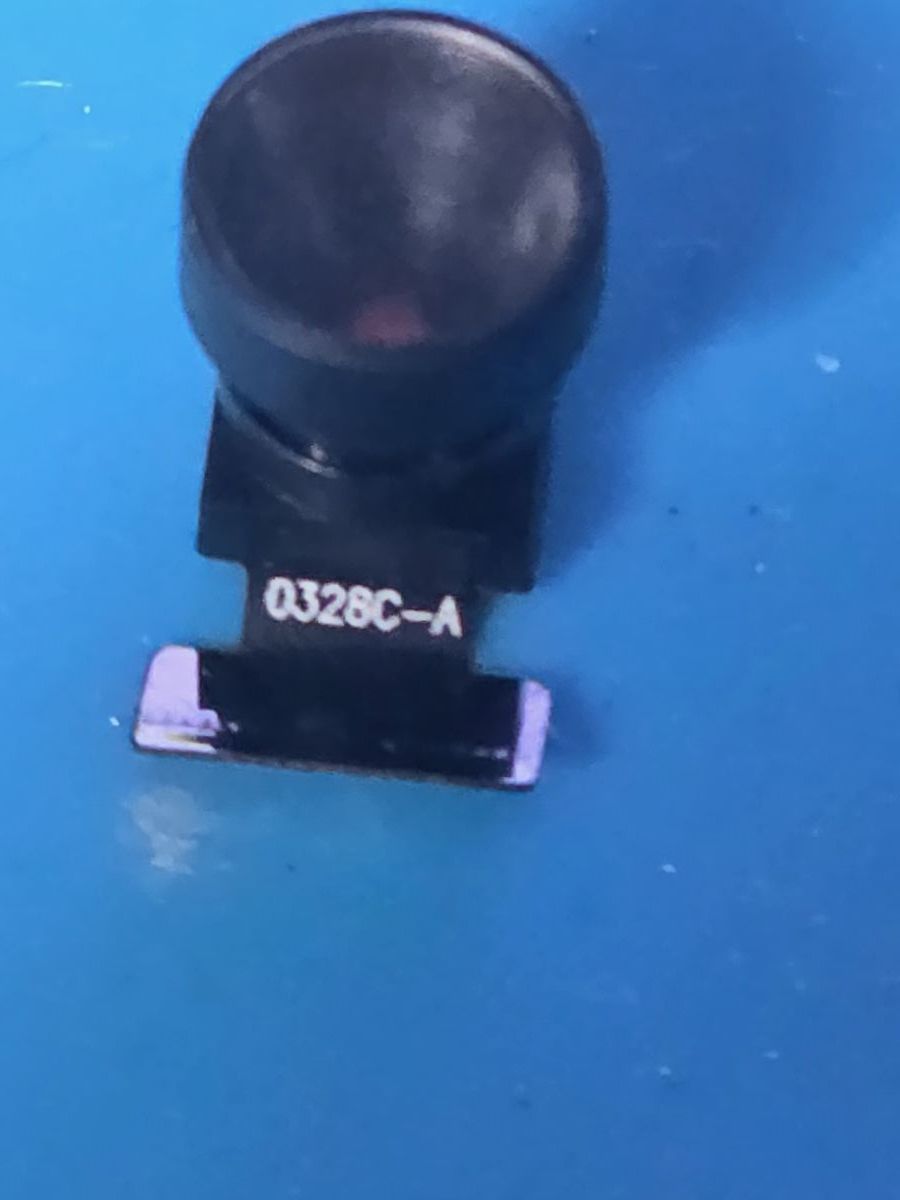

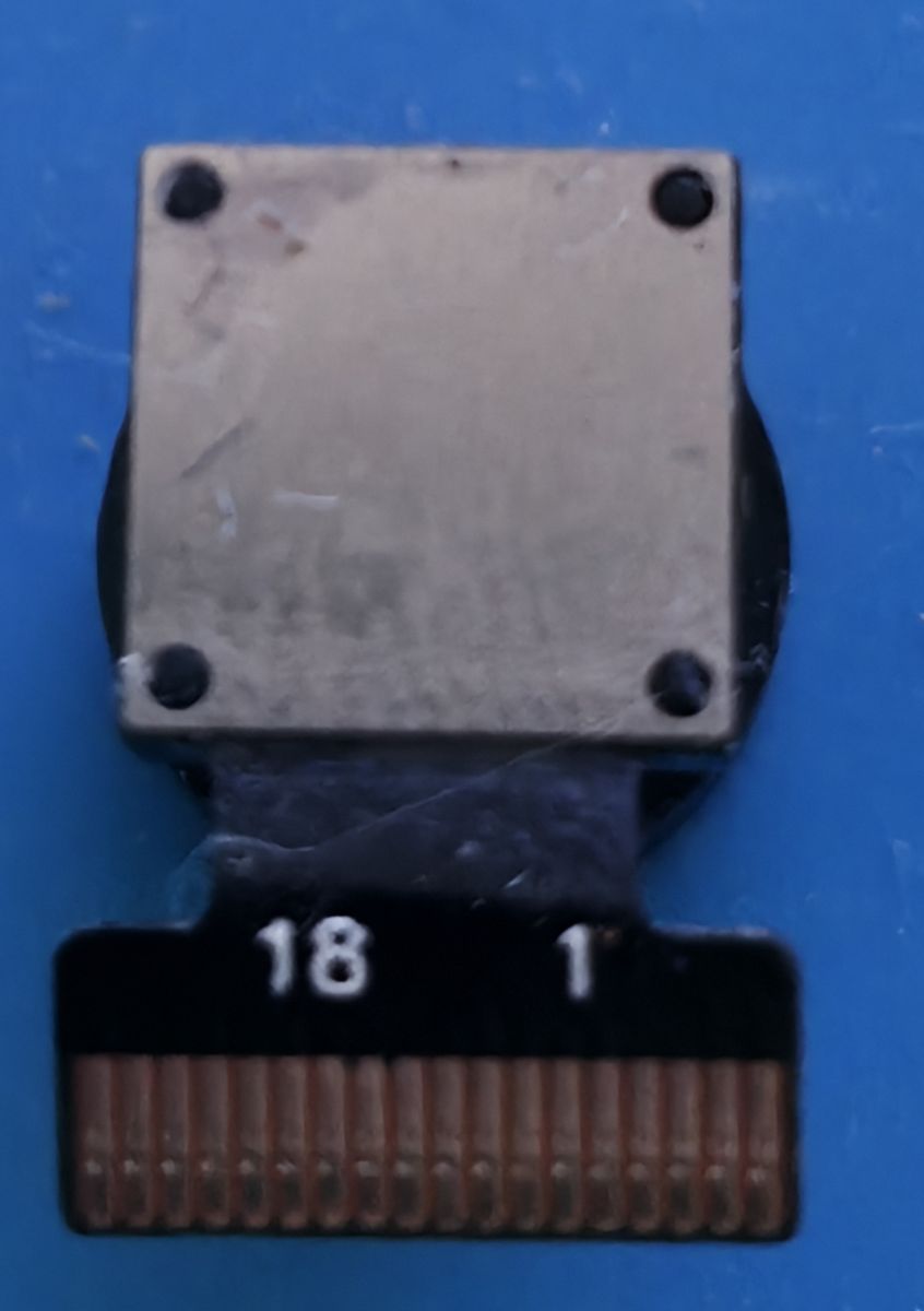

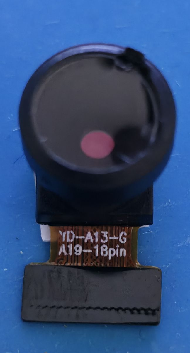

  • GC0328C module identified by init logs
    #4 21607771
    Posts: 5208
    Help: 446
    Rate: 914
    from user @LuckyLuca | see https://github.com/daniel-dona/beken7252-opencam/issues/16
    GalaxyCore GC0328C YD-A13-GA19-18pin
    Init
    GalaxyCore GC0328C 0328C-A
    Init

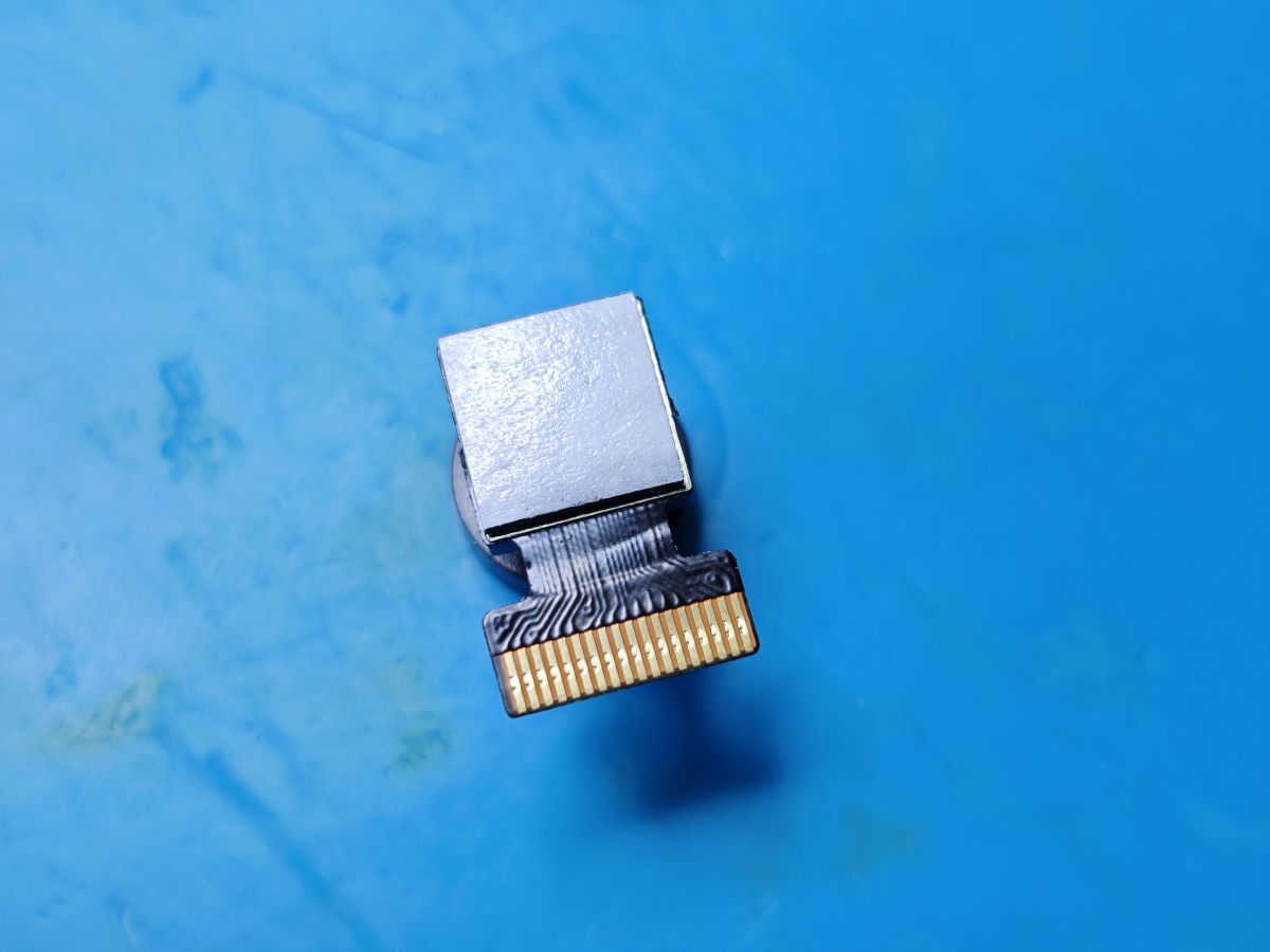

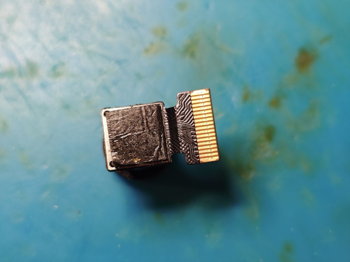

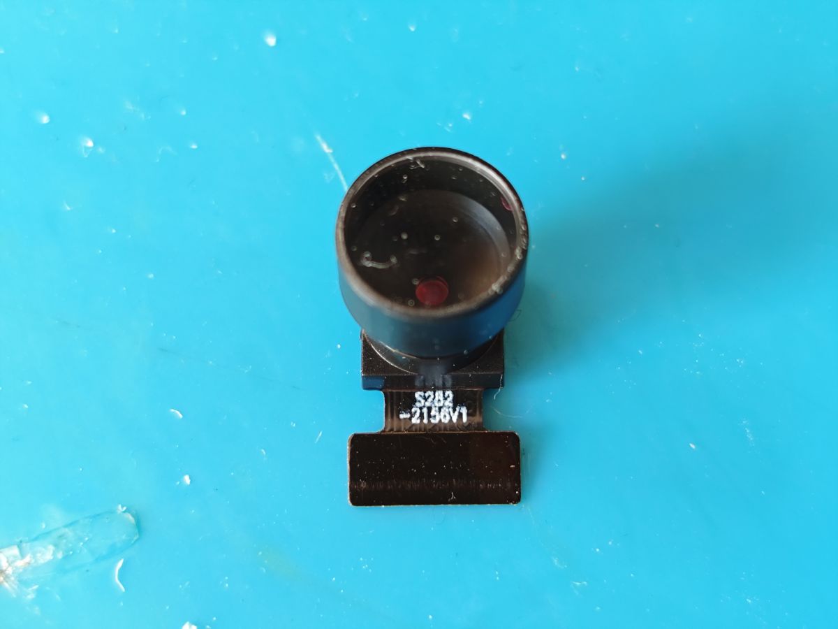

  • SuperPix SP0828 init register dump
    #5 21710596
    Posts: 5208
    Help: 446
    Rate: 914
    SuperPix SP0828 S282-2156V1
    Init

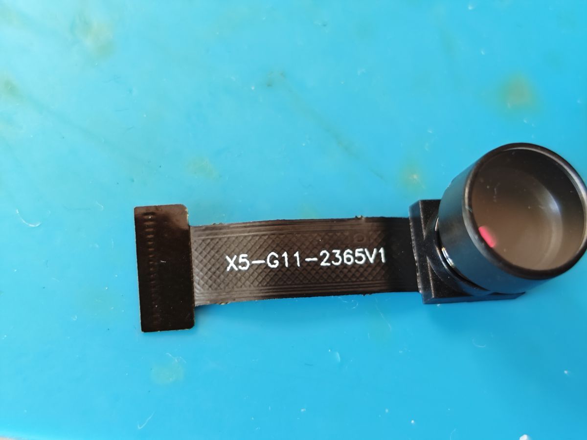

    Added after 30 [minutes]:
    GalaxyCore GC0311 X5-G11-2365V1
    Init

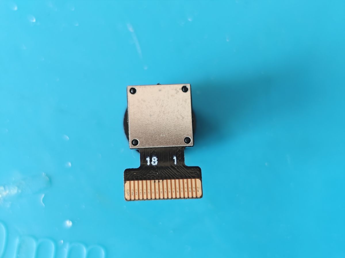

    Added after 17 [minutes]:

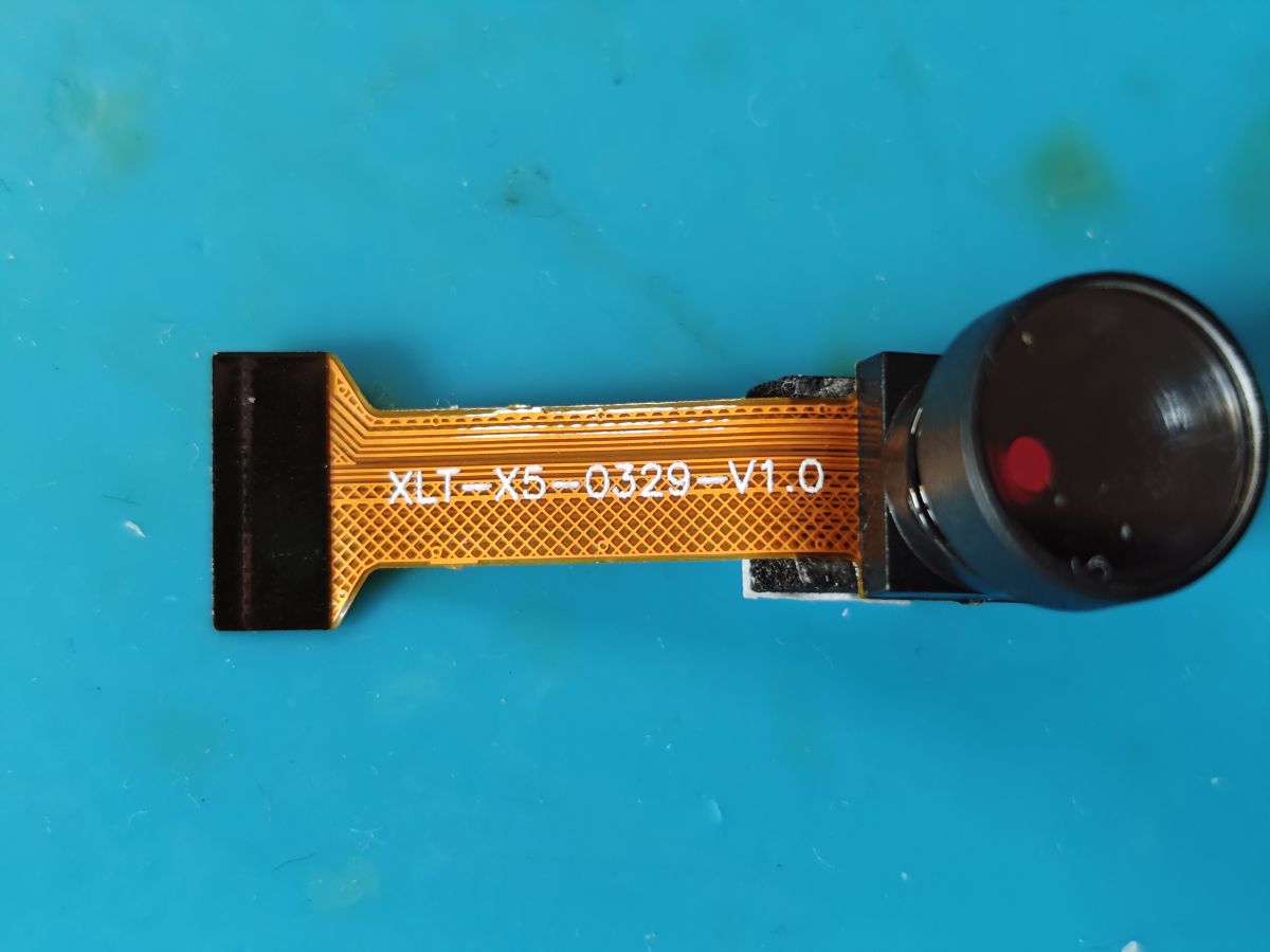

    GalaxyCore GC0329 XLT-X5-0329-V1.0
    Init

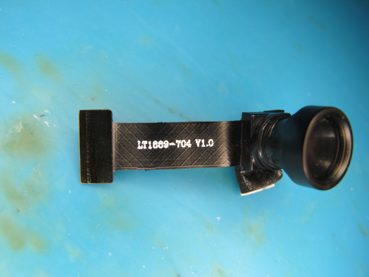

  • HI704 chip ID read success 0x96
    #6 21712521
    Posts: 5208
    Help: 446
    Rate: 914
    Hynix HI704 LT1888-704 V1.0 LT1889(?)
    Camera module with LT1868-T04 V1.0 cable on blue background FPC ribbon cable with gold-plated connector and metal end on a blue surface

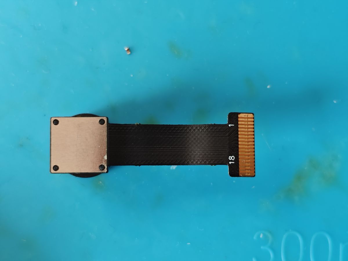

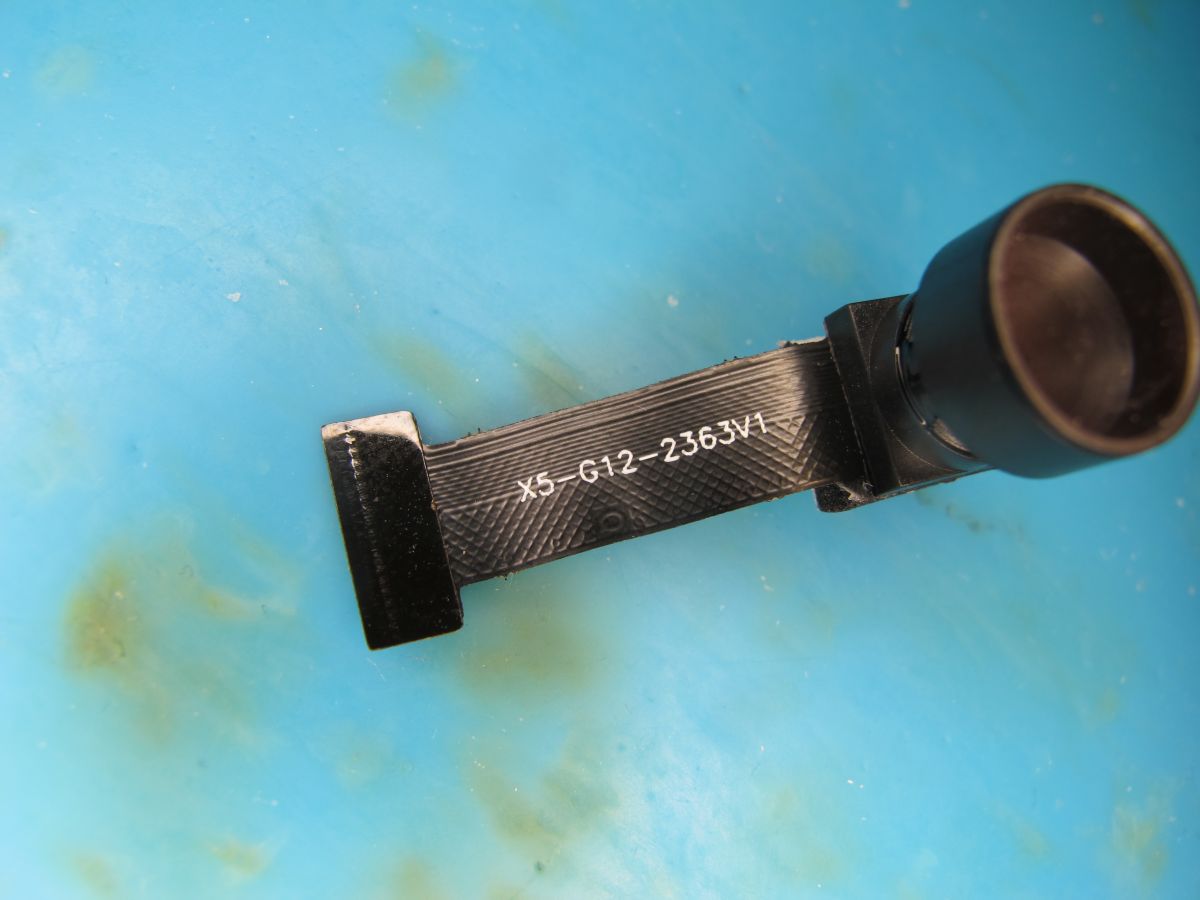

  • GC0312 chip id read success on X5-G12-236V1
    #7 21713076
    Posts: 5208
    Help: 446
    Rate: 914
    GalaxyCore GC0312 X5-G12-236V1
    Black camera with X5-G12-2363V1 marking on a blue background Flexible flat cable (FFC) with gold-plated contacts and mounting clip on a blue surface
    Init

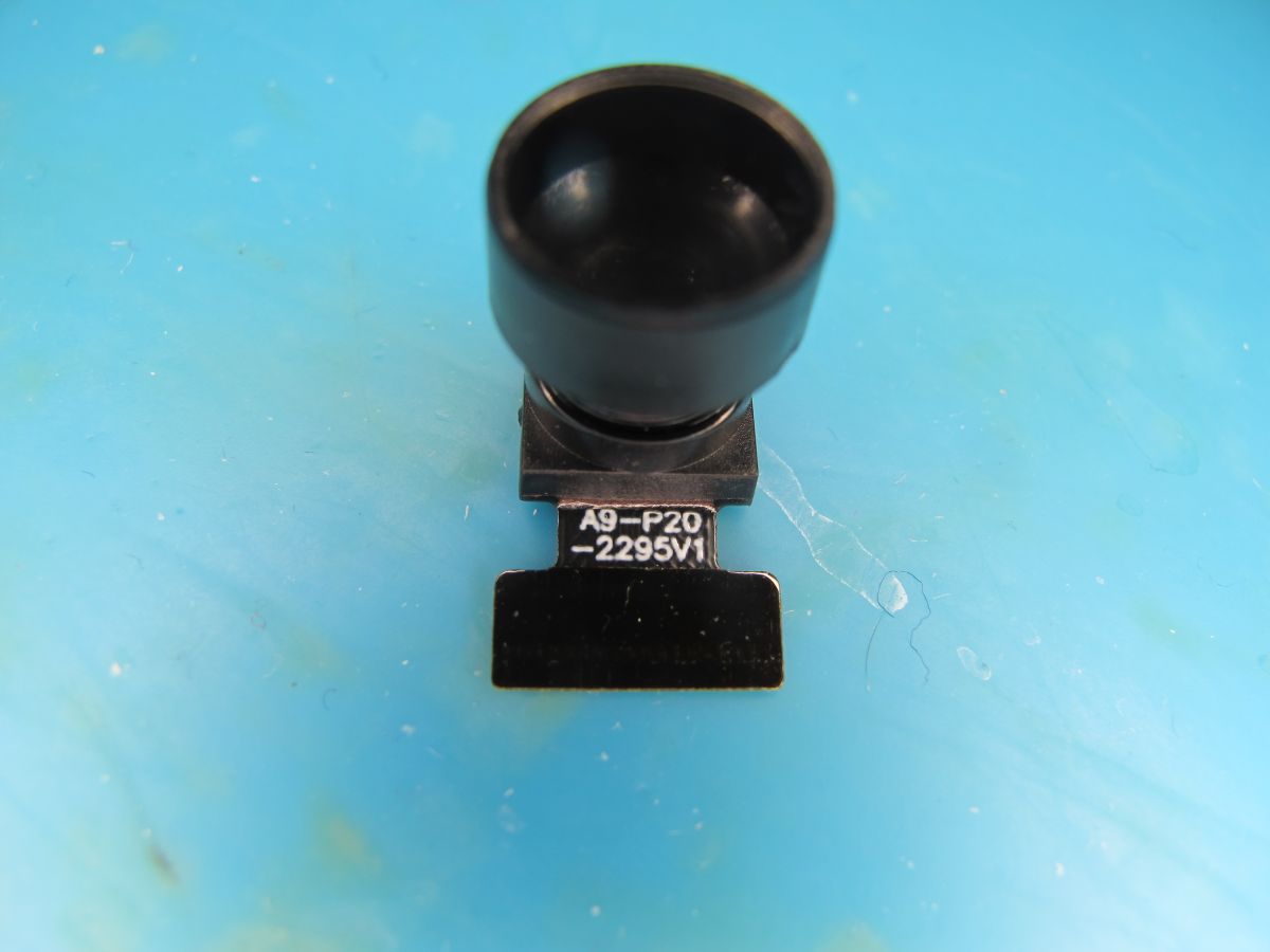

  • SP0A20 sensor identified with 640×480 init logs
    #8 21714889
    Posts: 5208
    Help: 446
    Rate: 914
    SuperPix SP0A20 A9-P20-2295V1
    Camera module labeled A9-P20-2295V1 on a blue surface Electronic module with metal shield and contact connector on blue background

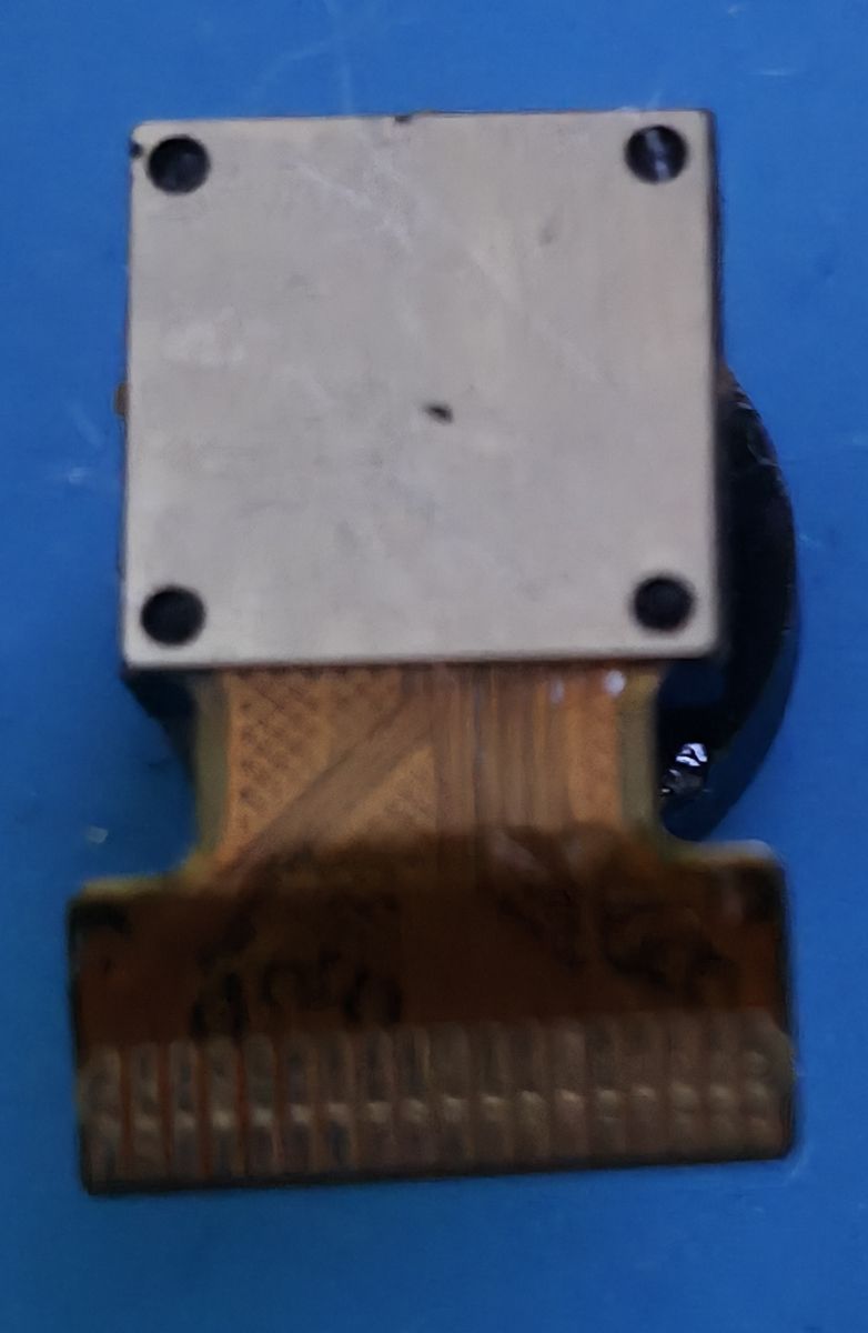

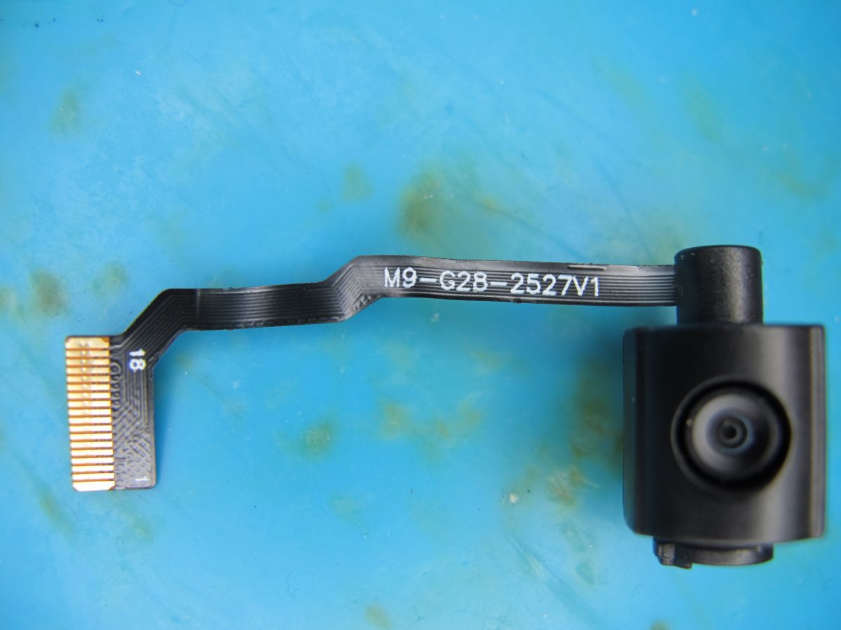

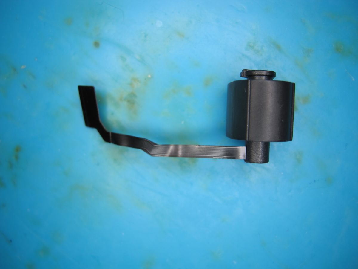

  • GC0328C identified by 0x9d sensor ID
    #9 21721711
    Posts: 5208
    Help: 446
    Rate: 914
    GalaxyCore GC0328C M9-G28-2527V1
    Camera module with ribbon cable and marking M9-G2B-2527V1 Black camera module with ribbon cable on a blue background
    Init

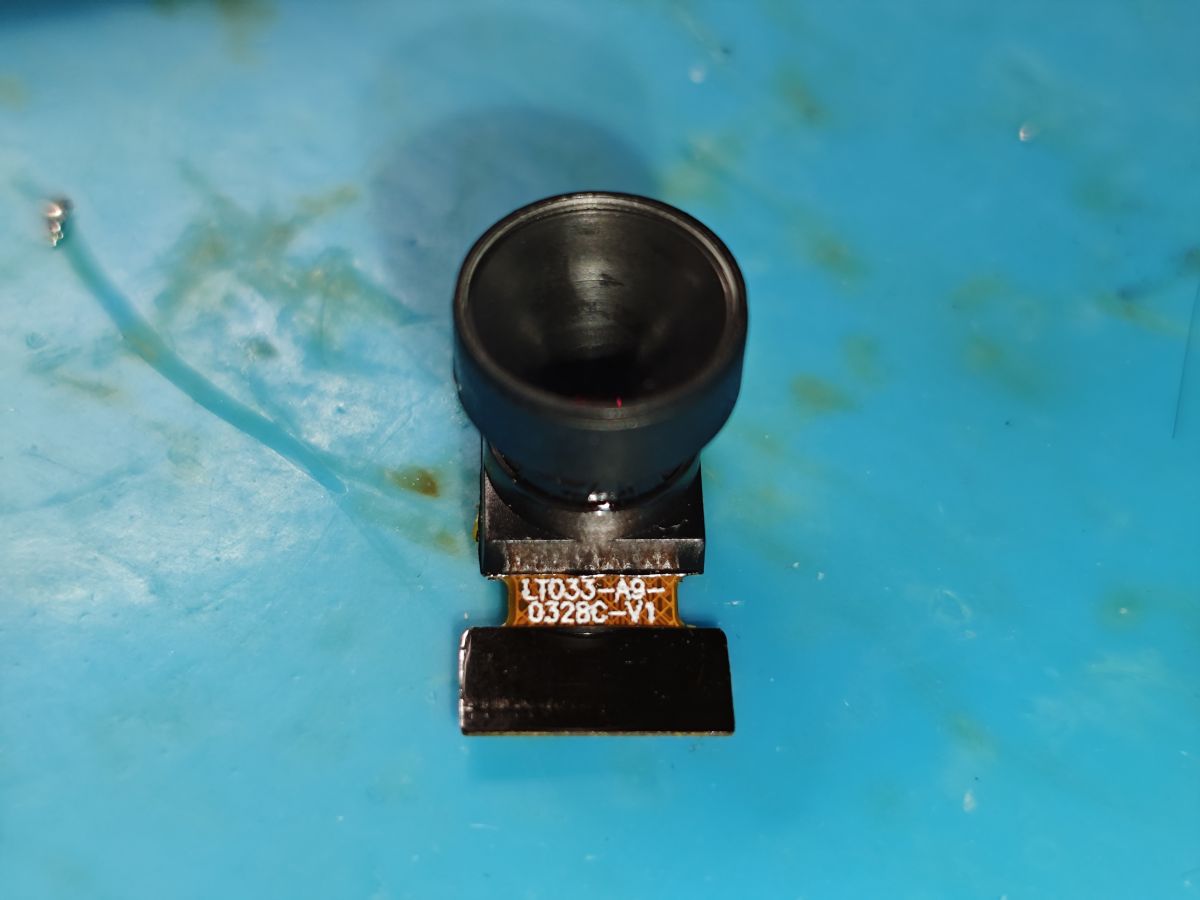

  • GC0328C sensor identified with 640x480 init log
    #10 21733459
    Posts: 5208
    Help: 446
    Rate: 914
    GalaxyCore GC0328C - LT033-A9-0328C-V1
    Camera module with large lens on a blue surface Electronic module with ribbon connector on a blue background

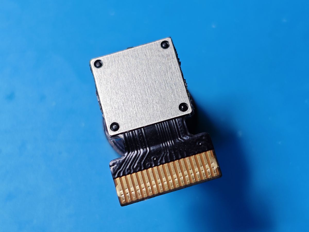

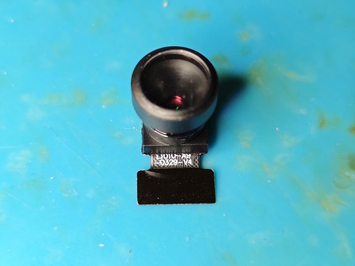

  • GC0329 identified at 0x31 with 0xc0 sensor ID
    #11 21741973
    Posts: 5208
    Help: 446
    Rate: 914
    GalaxyCore GC0329 LT010-A9-0329-V4
    GalaxyCore GC0329 camera module on a blue surface Camera module with flexible ribbon and connector on a blue surface

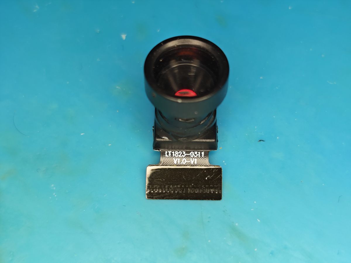

  • GC0311 chip id read success at 0xbb
    #12 21762384
    Posts: 5208
    Help: 446
    Rate: 914
    GalaxyCore GC0311 LT1823-0311 V1.0-V1

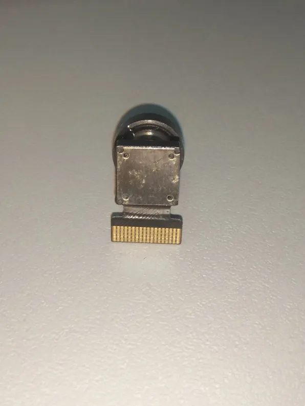

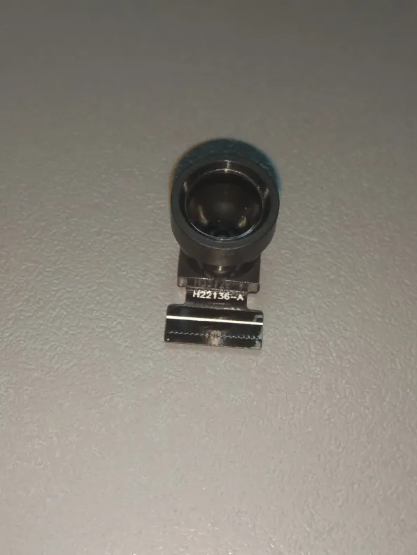

  • OV7690 identified by I2C readId 145
    #13 21832957
    Posts: 5208
    Help: 446
    Rate: 914
    OmniVision OV7690 H22136-A
    Small camera module with a front-facing lens on a light surface Small metal part with a flat gold contact connector on a light background
