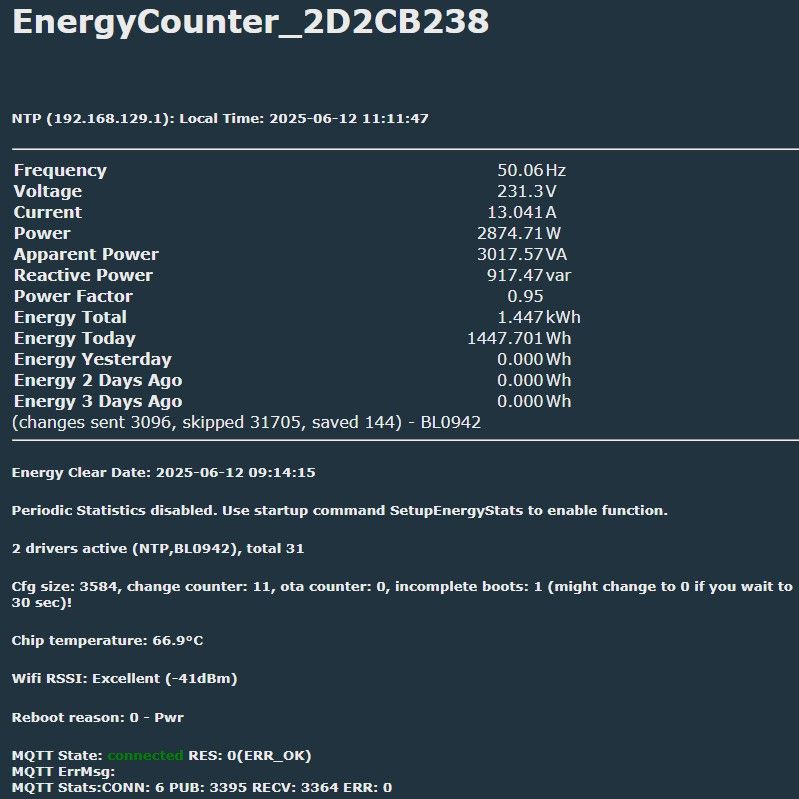

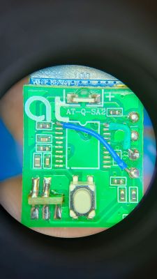

    So, I spent a few minutes thinking about which path to choose — trying to reverse-engineer the Tuya protocol or resorting to surgical methods. Taking into account that such research carries the risk of fire and electric shock (and my apartment is not insured), and to make matters worse, the first guy who started investigating this device in the thread has vanished without a trace... I decided to take the path of least resistance :)
    The 8H3K64S2 chip was removed as the root of the problem. The BL0942 and BK7231N chips were connected directly via UART (as shown in the photo). Nothing else needed to be done. In OBK, I simply enabled the BL0942 driver.
    I believe that if someone is capable of flashing OBK onto this device, then soldering two wires shouldn't be a big challenge either.

    Good job. Did you also calibrate?

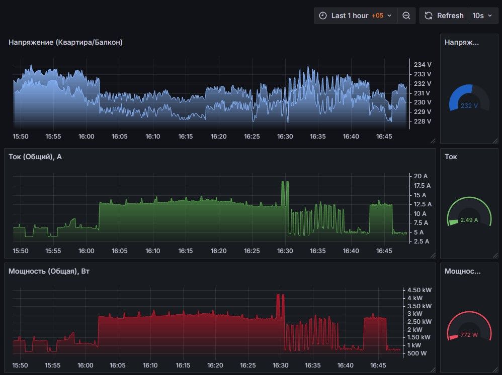

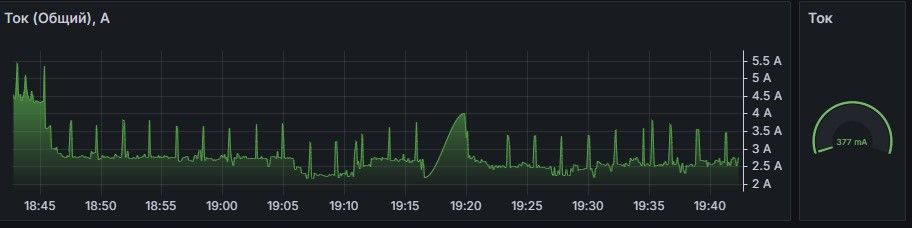

    Now I'm puzzled by something else. I'm seeing current spikes of about 1.2 amps on the graph, and I can't figure out where they're coming from. I've already tried turning off almost every device in the apartment — except a few that I currently can't access. I'm starting to suspect that maybe I ended up with some "special" version of the BL0942 😄 Has anyone seen this kind of behavior before?
    Tongou TO-Q-SA1 WiFi Smart Energy Meter – Anyone tried flashing it?
    Added after 25 [minutes]:
    False alarm! 😄 I found the source of the current spikes — it's the floor heating near the balcony, installed by the developer.
    What’s strange is that it was supposed to be just a self-regulating heating cable, but this one clearly uses some kind of pulse-based control.
    Looks like the developer just embedded the control unit somewhere in the concrete — I couldn’t find it anywhere 😅
    Yes, everything calibrated perfectly using a 60W OSRAM incandescent bulb.

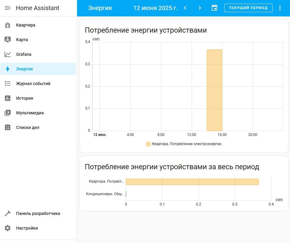

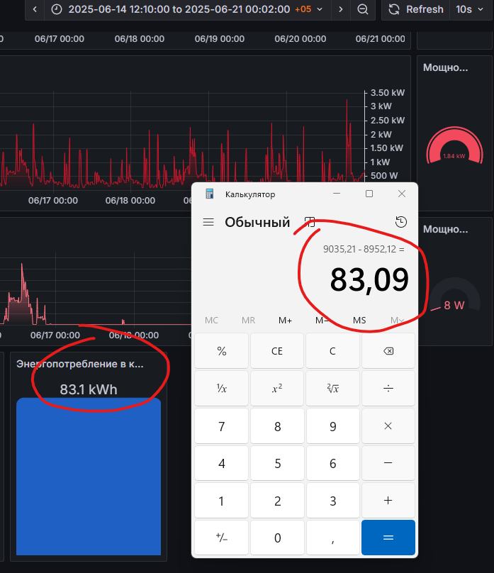

    The accuracy of the device is surprisingly good. On the screenshot: on the right — the readings from the certified apartment energy meter, on the left — the energy calculation in Grafana using the integral of the power measured by the device. Over six days, the difference came out to just 0.012%.

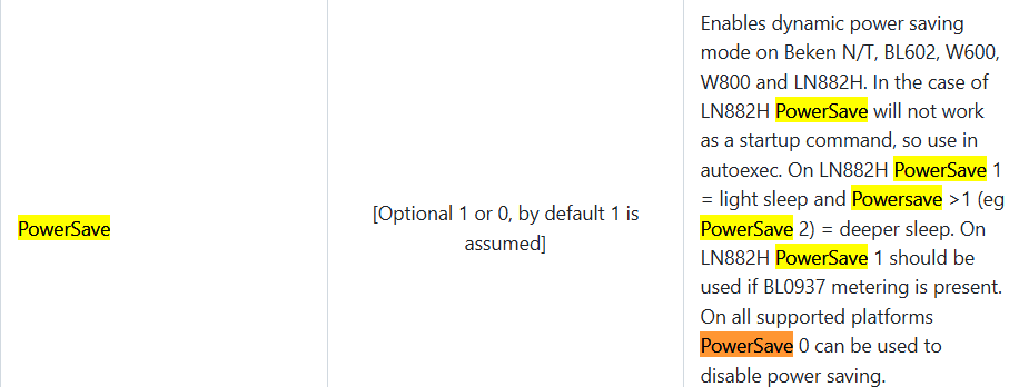

    Posts: 5220
    Help: 449
    Rate: 918
    We need to update docs to reflect that, feel free to help if you have some spare time
    how about
    Added after 4 [minutes]:
    https://github.com/openshwprojects/OpenBK7231T_App/pull/1564#issue-2913777986

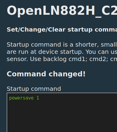

  • LN882H powersave works in startup command
    #46 21611552
    max4elektroda
    Posts: 758
    Help: 49
    Rate: 189
    divadiow wrote:
    In the case of LN882H PowerSave will not work as a startup command, so use in autoexec.
    Hm, I'll have to check, but didn't we change that for LN882H to work in any case? Iirc the actual turning PowerSave on was delayed until WiFi is working. Didn't that count for startup, too? If no one is faster, I'll try in the afternoon.
    Added after 3 [hours] 29 [minutes]:
    Unbelievable, faster than @divadiow ;-)
    In fact, "powersave" can be set in startup command of LN882H

    Powersave 2 on beken?
  • #52 21611843
    insmod
    Posts: 1432
    Help: 168
    Rate: 455
    >>21611840
    From what i see, there is no powersave 2. It only check if BL0937 pin is configured, and skips MCU sleep if true.
  • #53 21611861
    Posts: 5220
    Help: 449
    Rate: 918
    Oh dear. That's so obvious too. Dunno where I got powersave 2 from. K

    But at the end I ended up with removing STC microcontroller and added jumpers ( as posted by OP ) which I planned originally anyway.
    Now they are working just fine for some time.
  • #56 21734387
    casiopeia80
    Posts: 15
    Confirmed. It works fine with the chip removed.
