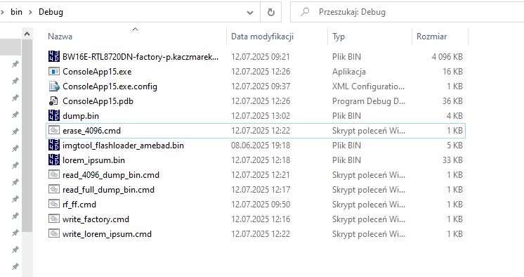

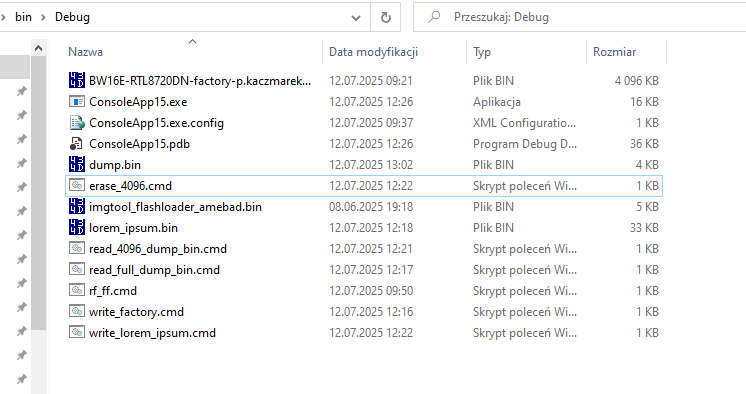

    I can also upload my tool:
    RTL8720DN, RTL8710B, RTL8710BX Compatibility with OpenBeken?

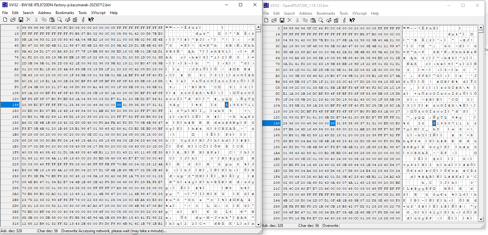

    My port attached. The test procedure I use is simple:
    - I use read_4096 to read 4096 bytes
    - then I use write_lorem_ipsum and do read again to check for lorem ipsum pattern
    - then I try just erase and read to check for 0xFF
    - then i try write back firmware factory version and read again
    Everything works so far, but no checksum, and no flash set as mentioned.
    The only question is why no OBK boot?
    • Debug.zip (1.34 MB) You must be logged in to download this attachment.

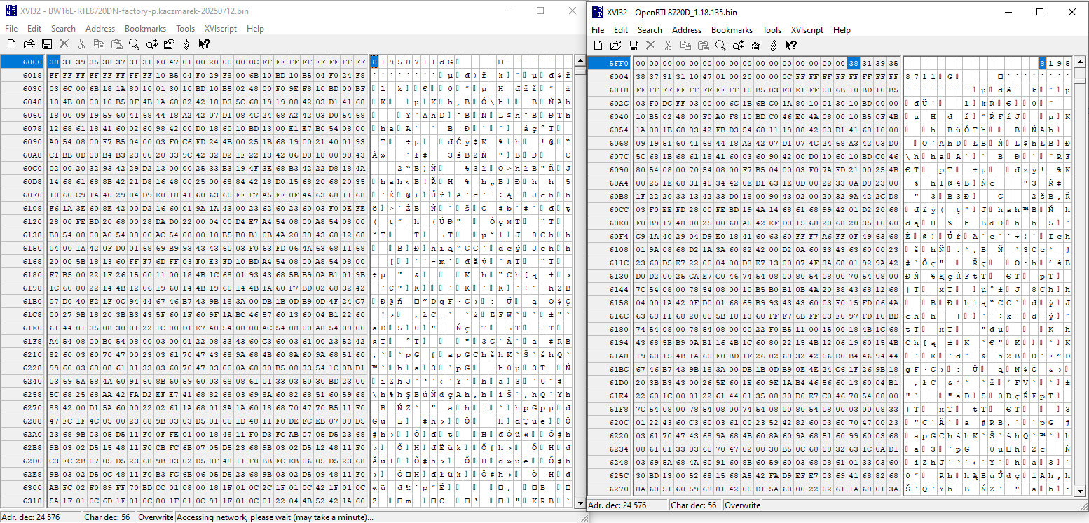

    Currently I write OBK RTL binary from Github to offset 0x0, which is later processed by flasher code:
                int writeOffset = address & 0x00ffffff;
                writeOffset |= 0x08000000;
    So it's flashed to 0x08000000 and that's all I know so far.
    The signature you mentioned appears in both factory and OBK firmwares at the same offsets.

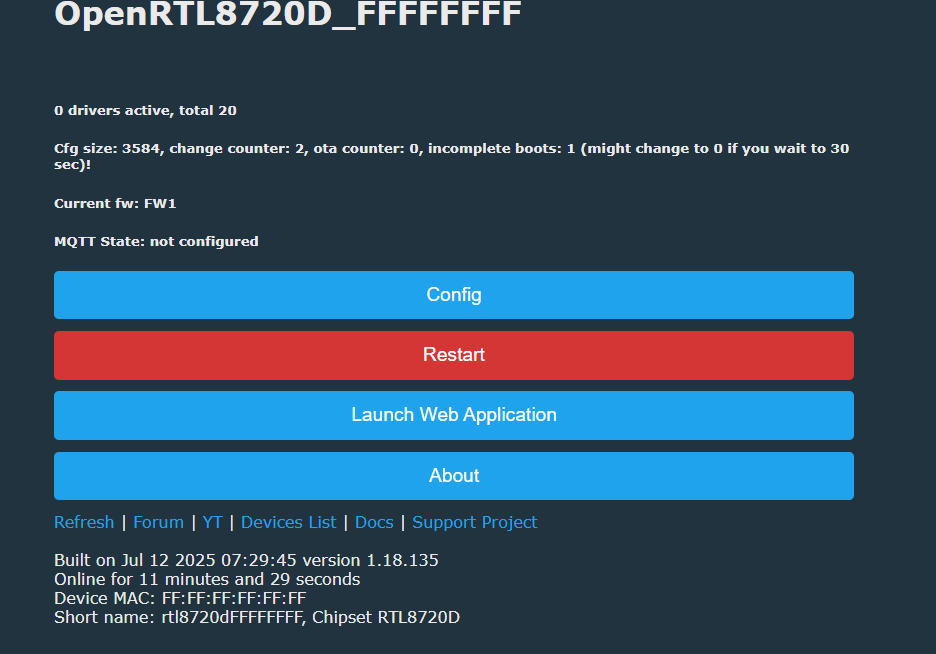

  • #308 21604688
    Posts: 14580
    Help: 654
    Rate: 12604
    Ahh, sorry, I misread - I read "easyflash" and not "easyflasher". Well, don't worry about Easy Flasher, I will attempt to split it into interfaces a bit and tidy it once I get something to add there. If I manage to get this RTL write/read working now, I may do it even this week.
    We will also need a name change then.
    Oh look, OBK booted.
    So, to sum up:
    Scenario A:
    1. flash original BW16 dump
    2. Flash OBK
    3. No boot, as shown earlier
    Scenario B:
    1. Full erase
    2. Flash OBK
    3. OBK boots

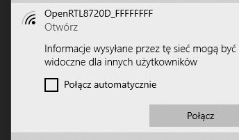

    Added after 10 [minutes]:
    Wait, no MAC
    Added after 33 [seconds]:

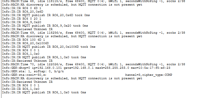

    Ameba IR driver. It doesn't work for me, and i'm not sure if i didn't break beken (because converted main driver code to HALs).
    It receives garbage, and doesn't output anything.
    https://github.com/NonPIayerCharacter/OpenBK7231T_App/actions/runs/16249968244
    irRemoteESP enabled for RTL87X0C, RTL8720D, RTL8721DA and RTL8720E.
    RTL87X0C limit is 960KB, with IR it's 928KB.

    I can try to test it today. We can also call @DeDaMrAz , he likes IR.
    Just to be on the same page - you're aware about current IR problems, right, @insmod ? Basically, we started with Arduino-IRRemote port, which worked more or less acceptable with 50us timer, and then we realized that we have no AC protocols, so vfonov ported IRRemoteESP, but... IRRemoteESP internally used on change interrupt for ESP, and we don't seem to have that on Beken, so we converted it to 50us timer and now it seems a bit unreliable...

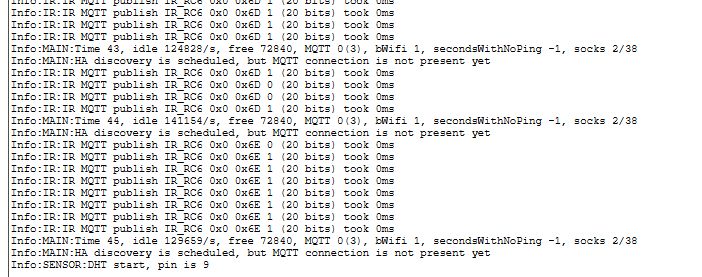

    IR tests, BK7231N, my old dev build:
    Test remote red button:
    Info:IR:IR MQTT publish IR_RC6 0x0 0x6D 0 (20 bits) took 0ms
    Info:IR:IR MQTT publish IR_RC6 0x0 0x6D 1 (20 bits) took 0ms
    Test remote green button:
    Info:IR:IR MQTT publish IR_RC6 0x0 0x6E 1 (20 bits) took 0ms
    Info:IR:IR MQTT publish IR_RC6 0x0 0x6E 0 (20 bits) took 0ms
    OpenBK7231N_1.18.135.rbl - works the same.
    OpenBK7231N_amebair_ec35fc691074.rbl
    works the same
    OpenBK7231N_ALT_amebair_ec35fc691074.rbl - Wait, it will not show ALT here? I guess not...
    Same, works.
    OpenBK7231N_amebair_ec35fc691074_irRemoteESP.rbl
    Not stable, but this is already known on main release

    Just some observations on IR.
    AC is problematic with current implementation of 50uS timer as the strings AC requires are much longer (compared to NEC protocol ie) and timer being fixed as it is produces an error after some length of command string. We tasted this with IR2 and flipper zero at the time, hence why IR2 driver exists.
    insmod wrote:
    Change IRQ?
    What about modifying interrupt on the fly?
    Rising irq triggered - enable falling in callback and vice versa.
    We had a discussion some time ago about IRQ on BK devices and I seem to remember we were lacking that in SDK (granted more than a year ago now).
    But we can certainly test the idea and sending is not the problem per say, receiving is. Flipper zero has that sorted maybe we can use their implementation as an idea - https://github.com/DarkFlippers/unleashed-firmware/tree/dev/lib/infrared

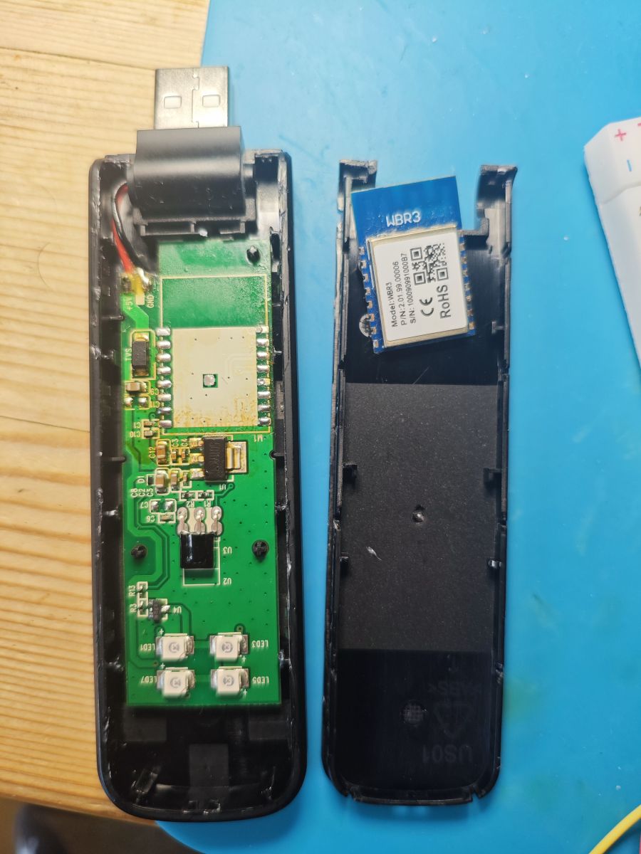

    @divadiow do you have BK7231 at hand? Or NiceMCU|?
    yes
    Added after 12 [minutes]:
    I have this without CB3S (harvested). https://www.elektroda.com/rtvforum/topic4031123.html
    so was thinking I could just put in WBR3 for anything RTL ir testing related.

    >>21605820
    Why WBR3? Just use BW15, because if something happens it can be easily reflashed without desoldering.
    maybe not.
    ir send LEDs get very hot quickly with both BW12 and WBR3 modules. I guess CB3S pin equivalents are default PU or something
    Added after 8 [hours] 47 [minutes]:
    or something else was wrong. This works:

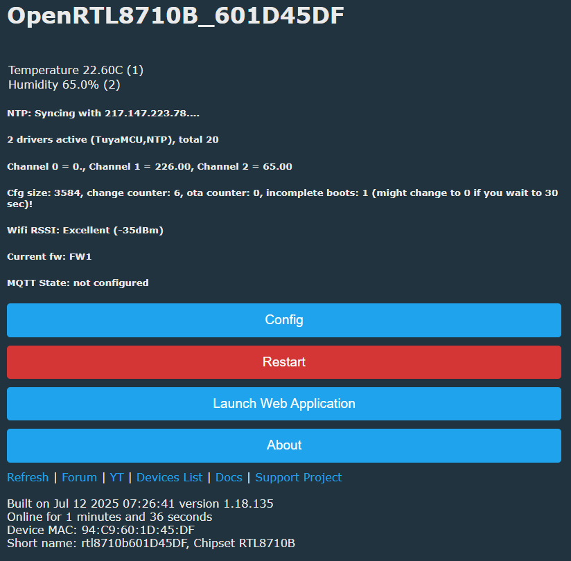

    a resurrected S09 https://www.elektroda.com/rtvforum/topic4035679.html
    shows TuyaMCU working on OpenRTL8710B too
    Spoiler:
