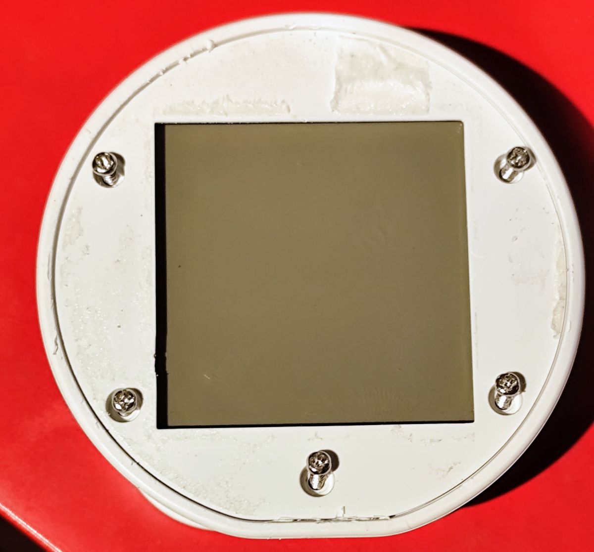

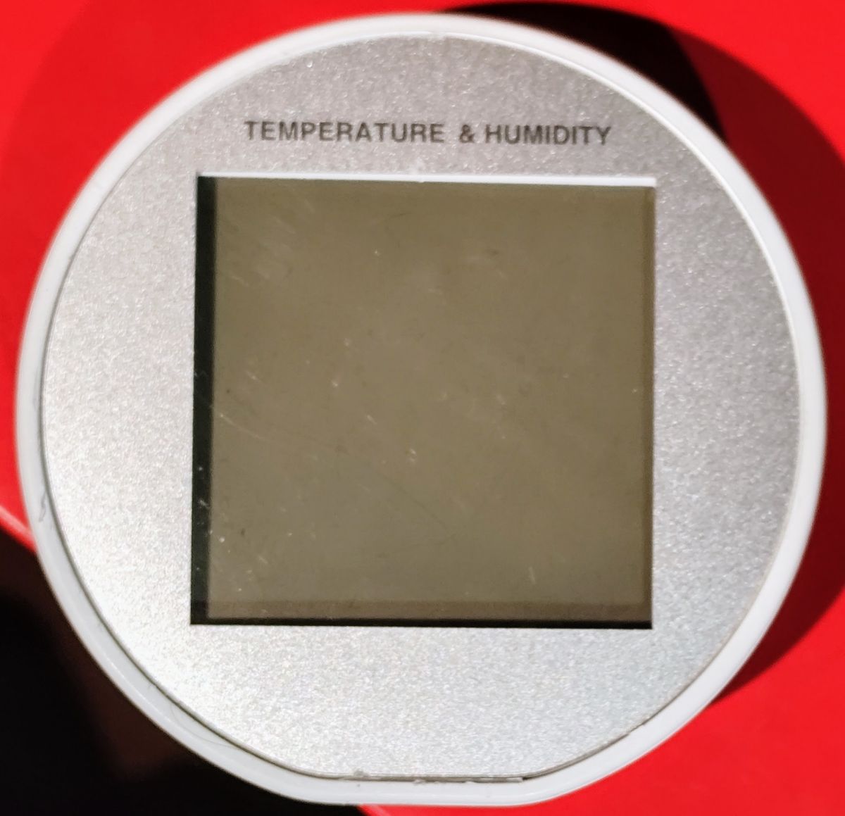

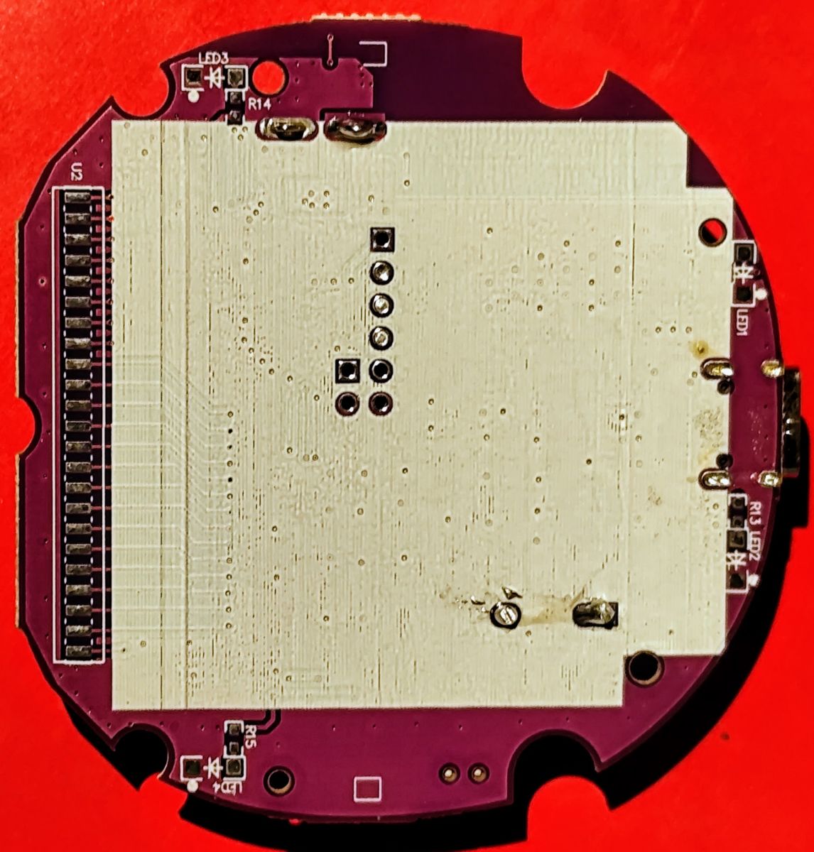

    I have flashed a WSD400H tuya temperature and humidity monitor : https://french.alibaba.com/product-detail/HOT...Desktop-Wall-Mounting-Low-11000008227998.html
    I Buy mine a long time ago on Aliexpress, I don't know if they are the same model now.
    Purple PCB with electronic components, including a Bluetooth module, integrated circuit, and USB-C connector.
    Round printed circuit board (PCB) with visible traces and mounting holes, on a red background.
    Square gray LCD display mounted on a round white base with six visible screws.
    Round electronic thermometer and hygrometer with an LCD display, no visible readings.

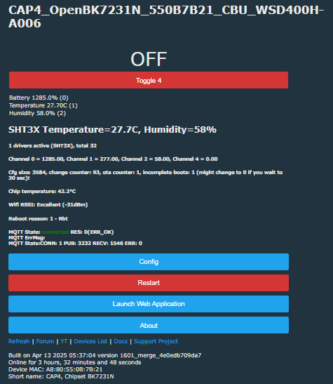

    It' easy to flash like all other CBU board.
    I can receive the Temperature and Humidity with a firmware with SHT3X driver for ht30 sensor
    insmod wrote:
    Control panel of the CAP4_OpenBK7231N device with temperature, humidity, and status readings.

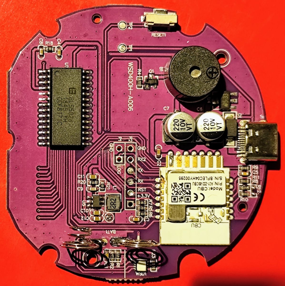

    I do not have the display working, I don't know how to use the BL55028 driver for the display, maybe somebody can help?
    The SDA is connect to P15 and SCL to P17 of the CBU
    I don't use the battery I power the device thru USB

    "command": "startDriver SHT3X",
    AI: Can you tell us what firmware or platform you are using on the WSD400H (like Tasmota, ESPHome, or something else)?
    OpenBK7231N_1601_merge_4e0edb709da7.bin
    AI: When you try to use the BL55028 driver for the display, do you see any error messages or does the display show anything at all (like staying blank, flickering, or something else)?
    Anything, only blank

    Thanks for your help, unfortunately this doesn't help there's not Tuya MCU on the board.
  • #4 21580230
    Posts: 14701
    Help: 656
    Rate: 12748

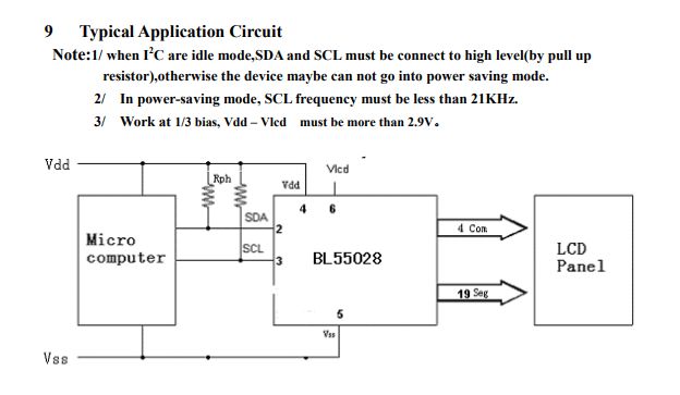

    This is I2C device, it requires a custom driver. I can create one, but i would need to have this device on site.
    WSD400H Tuya Temperature & Humidity Monitor Model Differences Between AliExpress and Alibaba
    Datasheet (BL55028_V1.3_en.pdf):
    BL55028_V1.._en.pdf (233.13 kB)You must be logged in to download this attachment.
