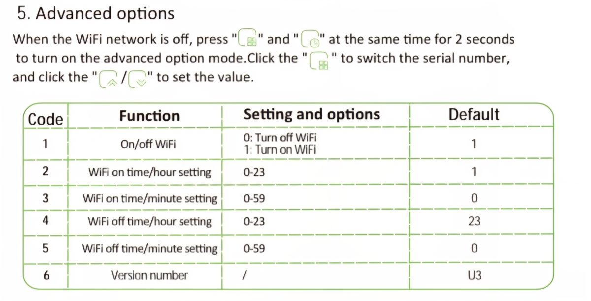

    Second topic : BAF-908 - every night from ~23 is invisible in the WiFi network. Looking for the manual, I came across an extended version with a description of the hidden WiFi menu. Below I paste the table with the description of the hidden WiFi menu:
    BAF-908 CB3S Tuya stopped connecting after SSID dot, nightly WiFi disconnects .
    Can I ask you for help in understanding/setting the whole thing so that WiFi access is 24/7? What I wouldn't change (setting WiFi off time and on time to 00:00) I have no idea how to validate the changes. Do I "do not move anything" after the changes and the device exits the hidden menu automatically, or do I hold the various combinations, I always have a return to the original settings.

    >>21583400 .
    I did as you write - no effect. I changed the phone to a new one that never had Tuya on it and also failed to add the device - add error and no more. I did a test with Smart Life - still the same.
