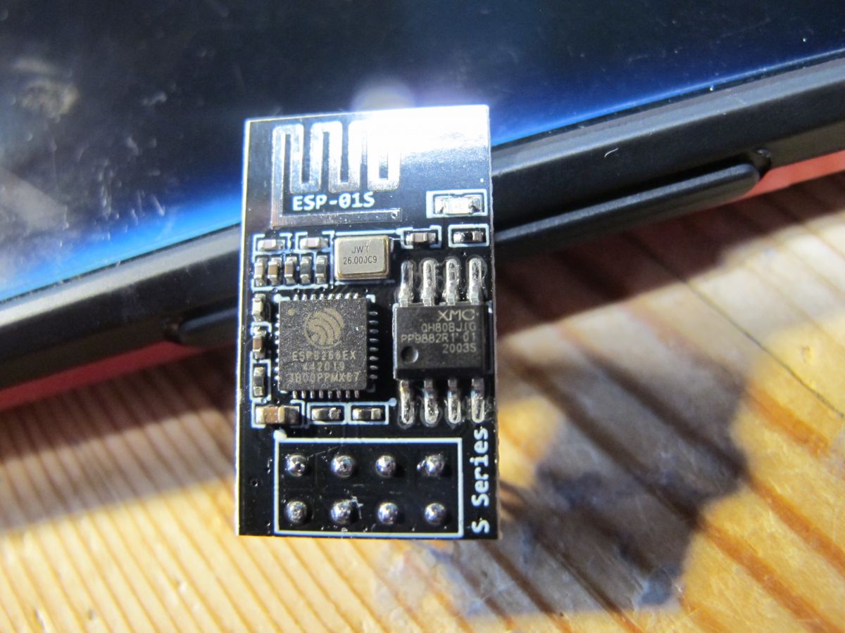

  • ESP-01 flash chip upgrade to 4MB confirmed

    insmod wrote:
    Correct, I have done it once. It was an ESP-01 with 1MB flash, I successfully replaced it for 4MB, which then correctly showed up in esptool flash_id.
    I'm going to stick this on my list of things to try. I've a few spare flash chips that would do the job.

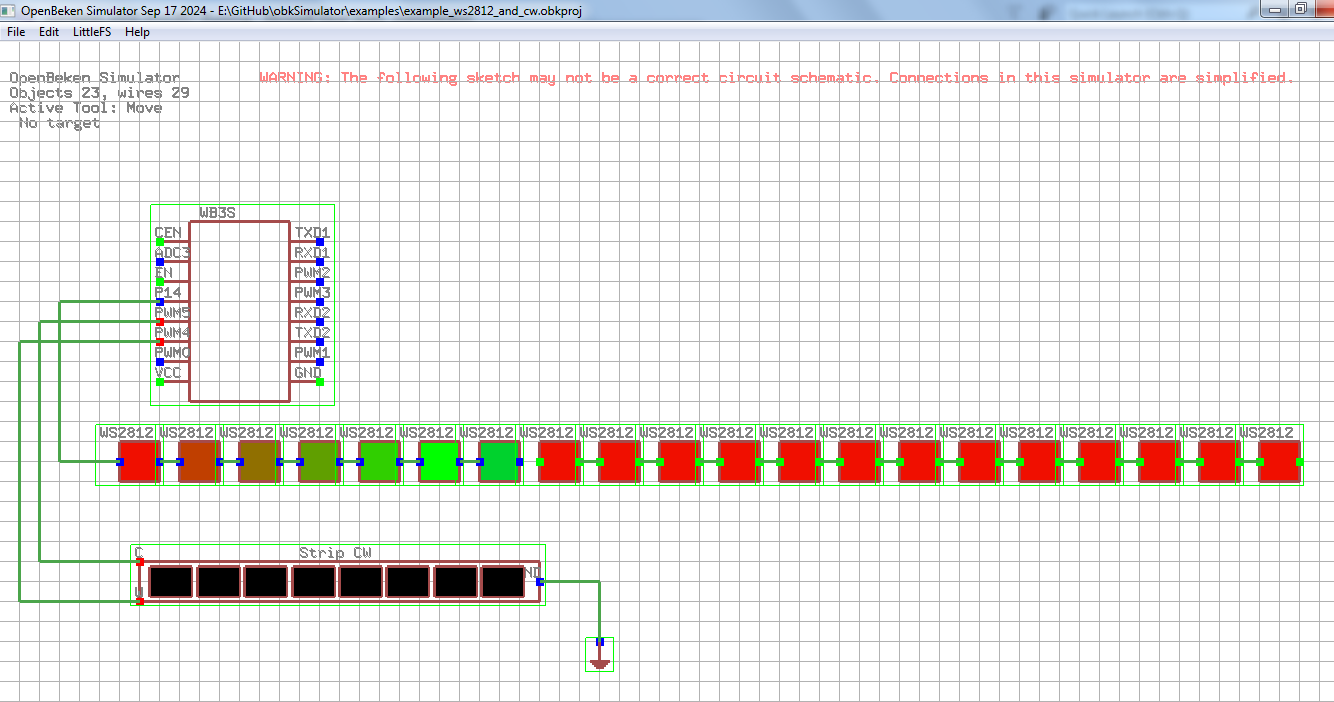

  • Need new driver for Beken-only LEDs
    #101 21229729
    Posts: 14763
    Rate: 12896
    insmod wrote:
    which are beken n only. I will have to write a new driver to make those work.
    Maybe we could use this occasion to rewrite the per-pixel LEDs backend. It shouldn't be that problematic, especially now that we have automatic self tests for LED features:
    https://github.com/openshwprojects/OpenBK7231T_App/blob/main/src/selftest/selftest_ws2812b.c
    When ran, they should ensure that API works as expected....
    I can extend them also a little.
    We can also test strips in simulator:
    Screenshot from the OpenBeken simulator showing the LED WS2812 connection schematic.
    It works well on Windows, it could also work on Linux (it's using multiplatform SDL), but I would need some help with porting,

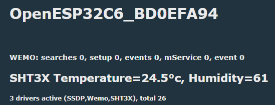

    Added after 8 [hours] 43 [minutes]:

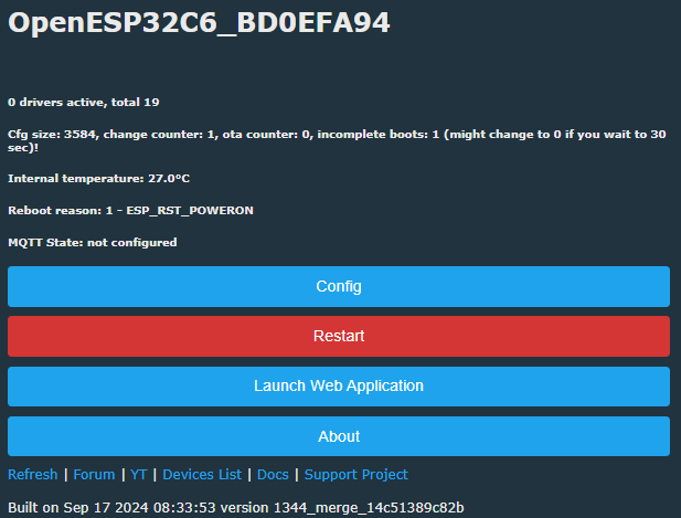

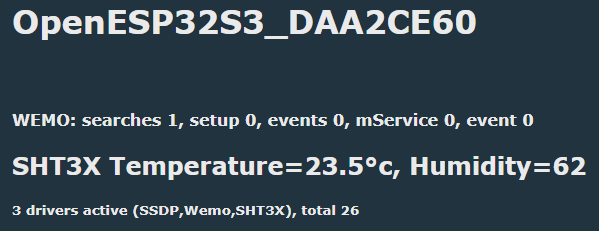

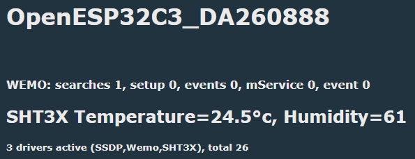

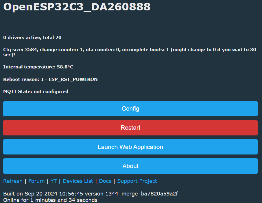

    new toys
    ESP32-C6-WROOM-1
    OpenESP32C6 user interface with device information.
    ESP32-S3-WROOM-1
    bootloops

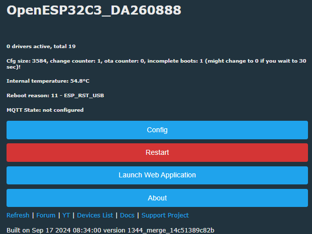

    ESP32-C3 SuperMini
    OpenESP32C3 system interface with system data.
    Added after 7 [hours] 55 [minutes]:
    - CHT8310 on ESP32-C3 SuperMini
    Added after 1 [hours] 49 [minutes]:
    1344_merge_ab1a59d9ca19 C3 SuperMini loops
    Added after 3 [hours] 45 [minutes]:
    ESP32-C3 SuperMini is back in business with 1344_merge_ba7820a59a2f
    Screenshot of the OpenESP32C3 user interface.

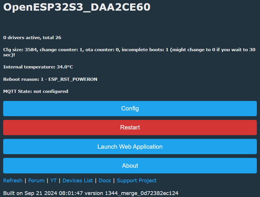

  • ESP32-S3 boots successfully with 16MB flash layout
    #105 21234047
    Posts: 5215
    Help: 448
    Rate: 917
    1344_merge_0d72382ec124 ESP32-S3 - success
    User interface of the OpenESP32S3 system showing status and management options.
    Spoiler:

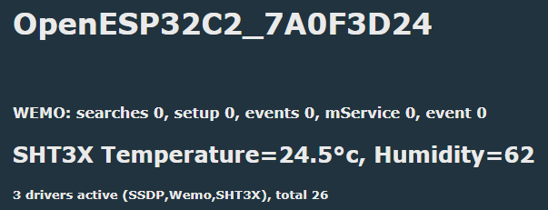

    Added after 38 [minutes]:
    1344_merge_0d72382ec124 - SHT3X driver tests
    Screenshot showing test results for ESP32-S3 using the SHT3X driver, displaying temperature and humidity. Screenshot showing readings from OpenESP32C2 system, indicating a temperature of 24.5°C and humidity of 62 from SHT3X sensor. Screenshot displaying data from ESP32C3, including SHT3X sensor readings of 24.5°C temperature and 61 humidity. Screenshot showing test results on ESP32-C6. ESP32 interface with temperature and humidity readings from SHT3X sensor without a humidity unit.
    curious the SHT3X driver doesn't give a decimal for humidity or have a "%" unit

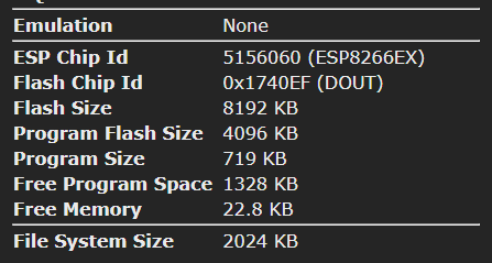

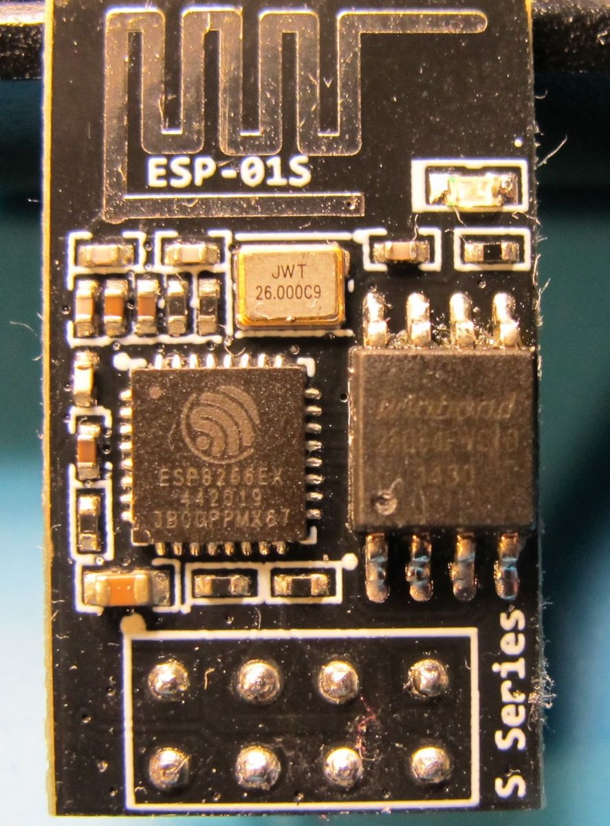

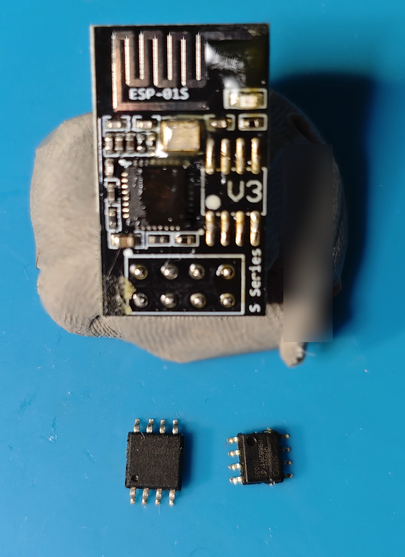

    ah yeh. that was easy. swapped 1mb XMC on this ESP-01S for an 8mb Winbond from a dead router
    ESP-01S with replaced memory chip against a laptop background.
    ESP-01S module with a replaced chip, placed next to two smaller chips. Close-up of an ESP-01S module featuring an ESP8266EX chip and replaced 8MB Winbond memory chip.
    Screenshot showing hardware specifications of ESP8266EX, including 8MB flash memory capacity.
    ready for OpenESP port testing 😉

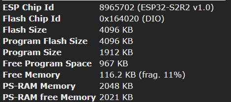

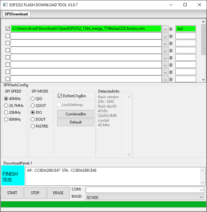

    insmod wrote:
    Additionally have 2 of the fake ESP32-S2 Mini
    couldn't see a screenshot of your S2 mini with OBK. Did you get it running? I've WinUSB/DFU flashed the S2 factory.bin
    Screenshot of ESP3252 Flash Download Tool V3.9.7 with firmware file loaded.
    but im not seeing any AP. Not log out either on the USB/WinUSB com port, but maybe that's the USB-CDC thing that needs enabling.
    I flashed Tasmmota32 S2-CDC in case my unit was duff. I get some logs and:
    Screenshot showing technical details of ESP32-S2R2 microcontroller.

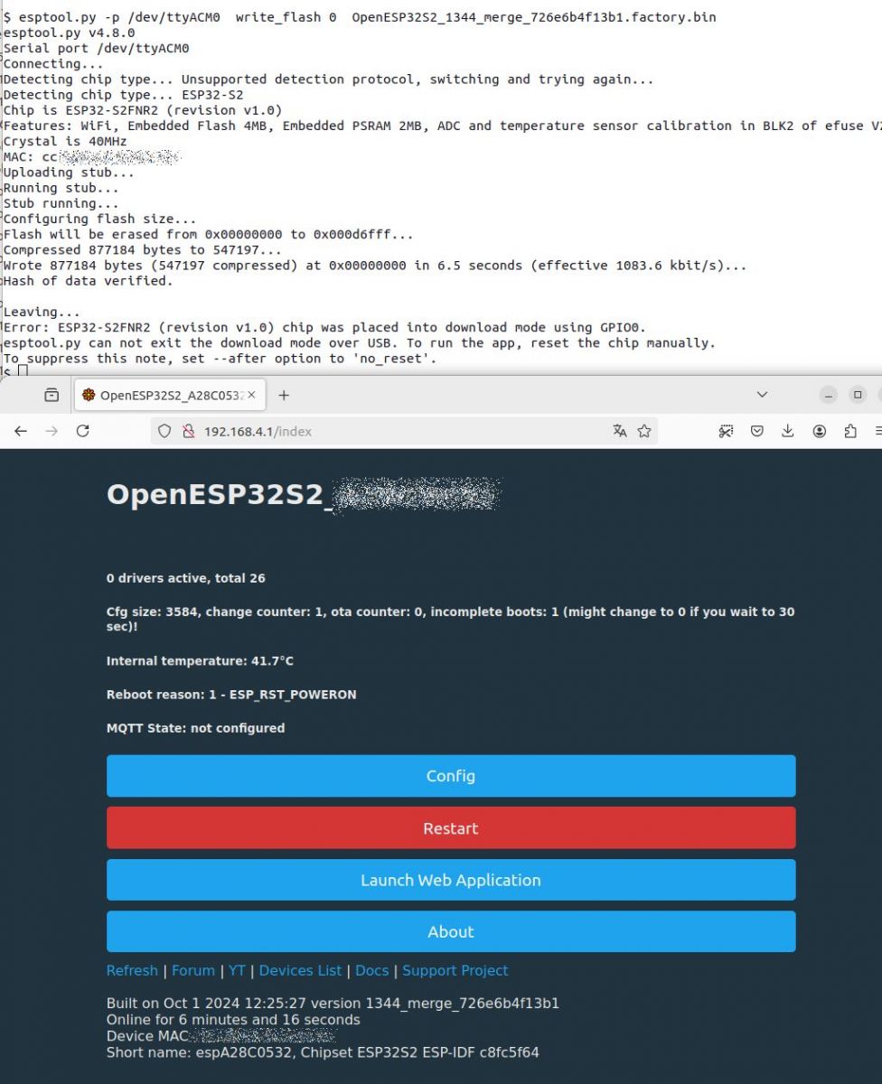

    I flashed my (probably fake) S2 mini "ages ago" #44
    But I don't remember exactly how, iirc it was quite simple (on Linux):
    Press"RST" and "0", release "RST" and the device "ttyACM0" came up.
    In my command history I found:
    esptool.py -p /dev/ttyACM0  write_flash 0  OpenESP32S2_dev_20240910_131614.factory.bin

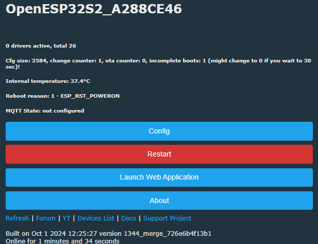

    Just retried - it works like that
    Screenshot showing the firmware upload process to ESP32S2 and the OpenESP32S2 web interface.

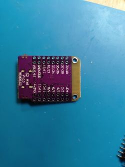

    oh. duh. must have zoomed past it.

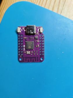

    :D OpenESP32S2 user interface displaying system information and configuration buttons.
    I think I might have the whole set now.

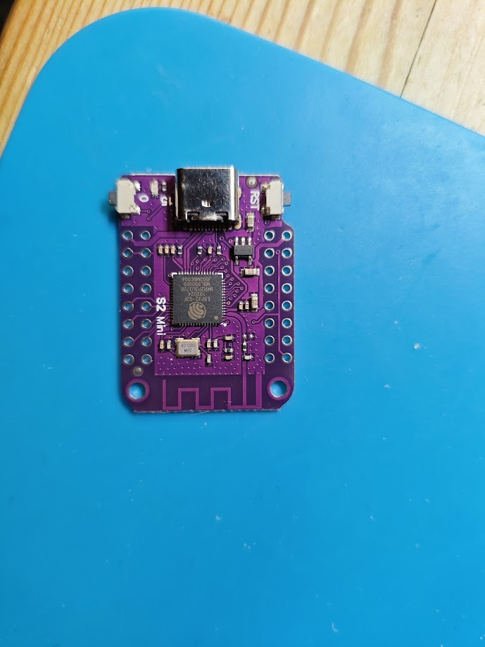

    dunno if mine's fake
    Purple printed circuit board with USB-C port and chip on a blue background. Printed circuit board with labels on a blue background.
