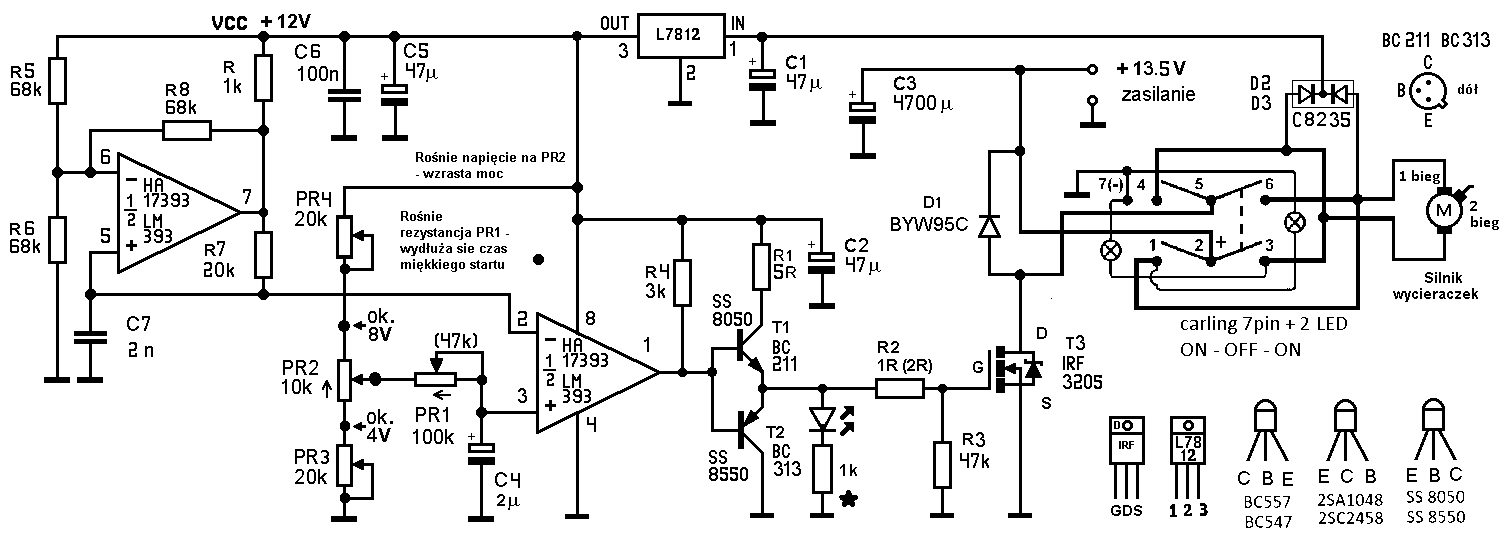

Ultrasonic PWM speed controller with soft start was built for a VAG automotive wiper motor driving a knot-toaster shaft through a 2:1 gear ratio.
The design uses a 555 triangle-wave generator feeding an LM393 comparator, with transistor current sources and discrete diodes replacing the original op-amp-based oscillator parts.
The regulator runs at about 16000 Hz, with PR2 for PWM, PR3 and PR4 for minimum start speed, and PR1 plus C4 for soft-start timing.
It removes audible squeaks and jerks, while the ATX supply was raised to 13.5V and the motor brush was isolated from ground to allow rotation in both directions.

LM393 improves edges but needs pull-ups and driver
The circuit in the diagram above will have rise and fall times of about 25 µs, so is suitable for about 1 kHz. Changing the LM358 to an LM393 will improve the slopes, but requires a resistor pulling up each OC output to plus and adding a MOSFET driver. And this is mainly the difference between the schematic from bestengineeringprojects.com
On the linked bestengineeringprojects.com page the MOSFET driver with T1 and T2 is, if not wrong, at least suboptimal (low efficiency, cross currents).
jarek_lnx , so far I have only added the second half of the LM393 to my solution quickly. From preliminary calculations it should generate about 18 kHz.
As for the MOSFET driver, to a non-professional it also seemed kind of odd - I haven't come across one on the web yet. In mine operating on collector resistor R1 (5 ohms) I measured the voltage drop with an oscilloscope. After counting it gave a current of about 0.3 A in the ipulse. I will leave it that way or slightly rework it.

If you would like, the softstart can still be modified because as it is now, it depends on the speed potentiometer setting and gives a delay.
heniek07 wrote:
After conversion it gave a current of about 0.3 A in the ipulse. I will leave it like that or slightly rework it.
You can look at the edges at the gate and at the output, the rise and fall times should not be longer than 5% of the period so as not to increase the power loss in T3, but there is also no point in making it ultra fast because it increases the noise emission.
1. Thank you jarek_lnx for the information. If you have a link to a simple soft start solution, please feel free to post. The existing solution satisfies me. I was more concerned with ensuring that when switching right-left the ATX power supply would not switch off, which I have achieved. The wiper motor has a worm gear and the acceleration of the whole mechanism is hardly noticeable.

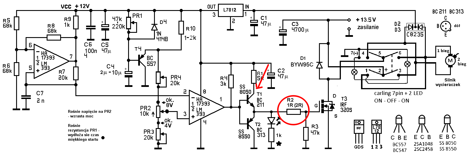

Ultrasonic PWM generator with soft-start layout shown
Ultrasonic PWM with soft start for speed control of a DC motor.
Version 2. - thanks to advice from colleagues. Not yet soldered and tested.
Brief description based on:
https://bestengineeringprojects.com/pwm-dc-motor-speed-controller-circuit/ The left comparator acts as a generator of an almost sawtooth waveform (with non-linear slopes, as in the diagram of charging and discharging a capacitor through a resistor).
https://bestengineeringprojects.com/wp-content/uploads/2022/05/pulse-width-modulation.jpg In this application it is of minor importance.
Resistors R5, R6 and R8 are supposed to be equal to each other (R5 = R6 = R8).
The frequency depends on C7 and R7. It can be calculated from the formula:
f = 1/(1.388-C7-R7). For C7 = 2 nF and R7 = 20 kΩ - f = 18011 Hz
The voltage on capacitor C7 varies from 1/3 to 2/3 of VCC.
If any electronic engineers can help with anything else - I would appreciate it.

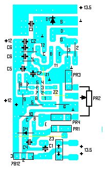

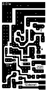

Board:
Component layout:
Soft start capacitor C4 will also affect the speed of the speed response. Also, a short break in the power supply will cause the soft start not to work.
Just add a PNP secondary with RC circuit and diode, four elements and you have an independent soft start circuit.

I have something like this in mind:
The voltage at the emitter is about 0.7 V higher than the voltage at the base. The input resistance of the secondary is large, so changes in the divider with potentiometers do not significantly affect the operation of the RC timing circuit.
The presence of the diode accelerates the discharge of the capacitor after a power failure.
Yes, it looks good. You might still consider reducing the top 30 k resistor to 2.2-4.7 k and adding series resistors to the PR3, PR4 potentiometers and reducing the resistance of these potentiometers so that you have more accurate adjustment. Because, for example, you may find that you get the required parameters within a narrow range of rotation of the PR mounting potentiometers at the current values.
For example, you would get the best values for the top PR4=4k and the bottom PR3=6k, in which case you would give a 3k3 resistor and PR 2k2 at the top and 5k1 and PR 2k2 at the bottom.
Fellow acctr , thanks again for the hints. I gave the resistor (now R10) even smaller. I don't know if I'm thinking correctly, but just to keep the last rising voltage spike small. As for the precision PR. The only parts shop in the area didn't have the values I was interested in at the time of purchase: 4.7 - 5k, even 10k. So I bought what was there. I set the 20k PRs to about 10k so that 1/3 of the supply voltage was deposited on each cascade, then tuned as needed and stayed that way. The accuracy was enough and I didn't include extra resistors on the board. When I will redesign the board and do the experiments - I don't know. (Huge holiday renovation works and lack of time.) The first described version works and there is nothing pressing to redesign. I am posting the schematic after the changes.

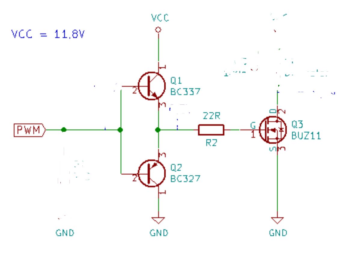

The extreme on/off speed of the transistor is not so necessary because the limitation anyway is the rate of rise and fall of the current in a rather large motor index.
For example, in automotive applications a 1K resistor in the gate of a traistor is used to control the primary winding of the ignition coil....
Gate resistor needed to avoid linear-region overheating
The extreme on/off speed of the transistor is not so necessary because the limitation anyway is the rate of rise and fall of the current in a fairly large motor index.
E.g. in automotive applications a 1K resistor in the gate of the traistor is used to control the primary winding of the ignition coil...
Extreme at the nanosecond level, is detrimental because it generates more RF interference, but with a 1k resistor in the gate circuit and a frequency of ~20kHz the transistor would operate mainly in the linear region and would probably burn out.
Special driver and Darlington transistor can tolerate heating
Nowadays, new solutions tend to use a specialised IGBT.
The STGB18N40LZT4, for example, has a built-in 1.6k series resistor, and in the actual application there is another external one.
NGD8201B - this one does not have a built-in series resistor, but its default application is a 1k Rg resistor and the timing parameters are given for such. Of course, they are not impressive because it is a specialised transistor and they are only what they need to be.
And it is also known that the self-induction voltage of a coil depends on the rate of current decay in the coil, yet the aim is not to use the fastest possible transistors because it is not the transistor that is the limitation here. The limitation is the inductance and capacitance between the windings on the secondary side.
Here, however, I would increase this gate resistor To some 47-100Ω.

Soft-start regulator board revised and corrected to 115%
Thanks, guys! Unfortunately, I don't know if I'll be reworking anything at all. As a rule of thumb: if something works well, you don't have to mess it up. The circuit from the first version behaves correctly and I am satisfied with it. It works, the MOSFET does not heat up. I flicked the right-left switch for a minute at different motor speeds, about a minute, and not once did the short-circuit protection of the ATX power supply trip. Now, in addition, there is a lack of time. I'm still a bit tempted to check the new soft start solution, but that's future.

Hello forum community!
After an extended evening, I am posting the board of the latest version of the regulator with soft start implemented on the emitter secondary. If anyone of Was finds time to check this version then please do.
There are also holes to reposition capacitor C2 as suggested by a colleague Macosmail . The board is visually checked once with component placement and ready for thermal transfer.

I apologise to Mates for my mistake. I took the wrong element file for the design. All the boards were too small. I have replaced all of them. If anyone has downloaded the design of any tile beforehand, it should be enlarged to 115%.

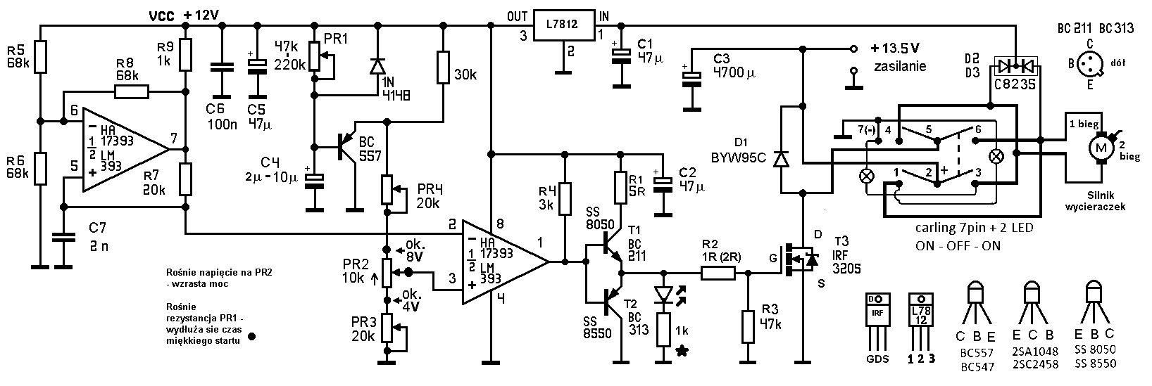

Hello!
I still have a question for my colleague acctr , the author of the Soft Start on the emitter secondary, or any of you more experienced. Is it possible to increase the values of the PR4, PR2, PR3 divider to e.g. 75k, 50k, 75k. Will this improve the performance of the soft start. I understood that when the voltage on the base of T4 increases, it will stop conducting and the voltage will jump a little.

Can the divider values of PR4, PR2, PR3 be increased to e.g. 75k, 50k, 75k. Will this improve the soft-start performance.
The function of this secondary is to separate the RC soft start timing circuit from the divider you normally set the motor speed with.
So you can change their resistances, but this will not affect the soft start.
The voltage at the base will rise and at the emitter too, but not in a stepwise fashion, just in line with the capacitor charge curve.
And if you wanted, for example, it to rise linearly, then instead of a resistor in the soft start you can give a current source on one transistor, diode and resistor.
