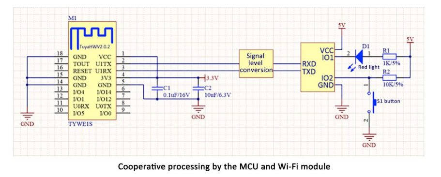

Block diagram of MCU and Wi-Fi module cooperation.
Here I will show you step by step how to configure a TuyaMCU device, how to get dpID list, how to map dpIDs to channels and publish them to Home Assistant and how to create custom page for the device. This topic will cover most of TuyaMCU topics required to get your Tuya device running cloudless with HA.
But first of all - do not flash device first, start with reading this guide. This is because one of dpID extraction methods requires an unflashed device

1. Check is your device using TuyaMCU
Now you need to know is your device using TuyaMCU. So,
tTry to answer the following questions:
- when you open device case, is there an extra MCU in SOIC or TQFP case (or similiar) near WiFi module?
- is WiFi module connected to MCU via RX1/TX1 (UART1) lines?
- when you do a config extraction with our flasher, does it find a baud setting in the flash?
- when you have flashed your device already, does your device has still functional buttons, even without configuring them in OBK?
- does your device has a screen?
If you answered YES to some of the questions, there is a chance your device is TuyaMCU.

The main issue with changing firmware of TuyaMCU devices is that TuyaMCU uses the same port as the flashing.
This means, that you will have to done something to sever the connection of MCU for the time of the flashing, at least in the most cases.
There are multiple ways to do it:
- cut the traces (RX and TX) leading to MCU and repair them after flashing
- disconnect board with TuyaMCU (if possible, if boards are separate)
- desolder either TuyaMCU or WiFi module (sometimes it's possible)
- desolder resistors on RX/TX traces (if present, some devices don't have them)
Alternatively, you could also try to look up the datasheet of the MCU and check whether it's possible to put it into the RESET state via pulling it low or high.
Futhermote, there are also OTA flashing solutions, but they are not reliable and most of the new devices are patched.
