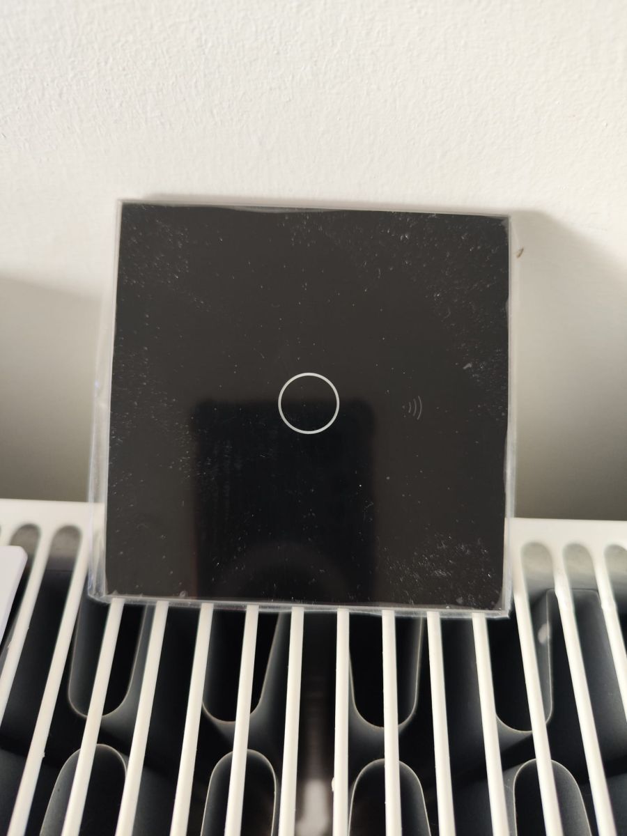

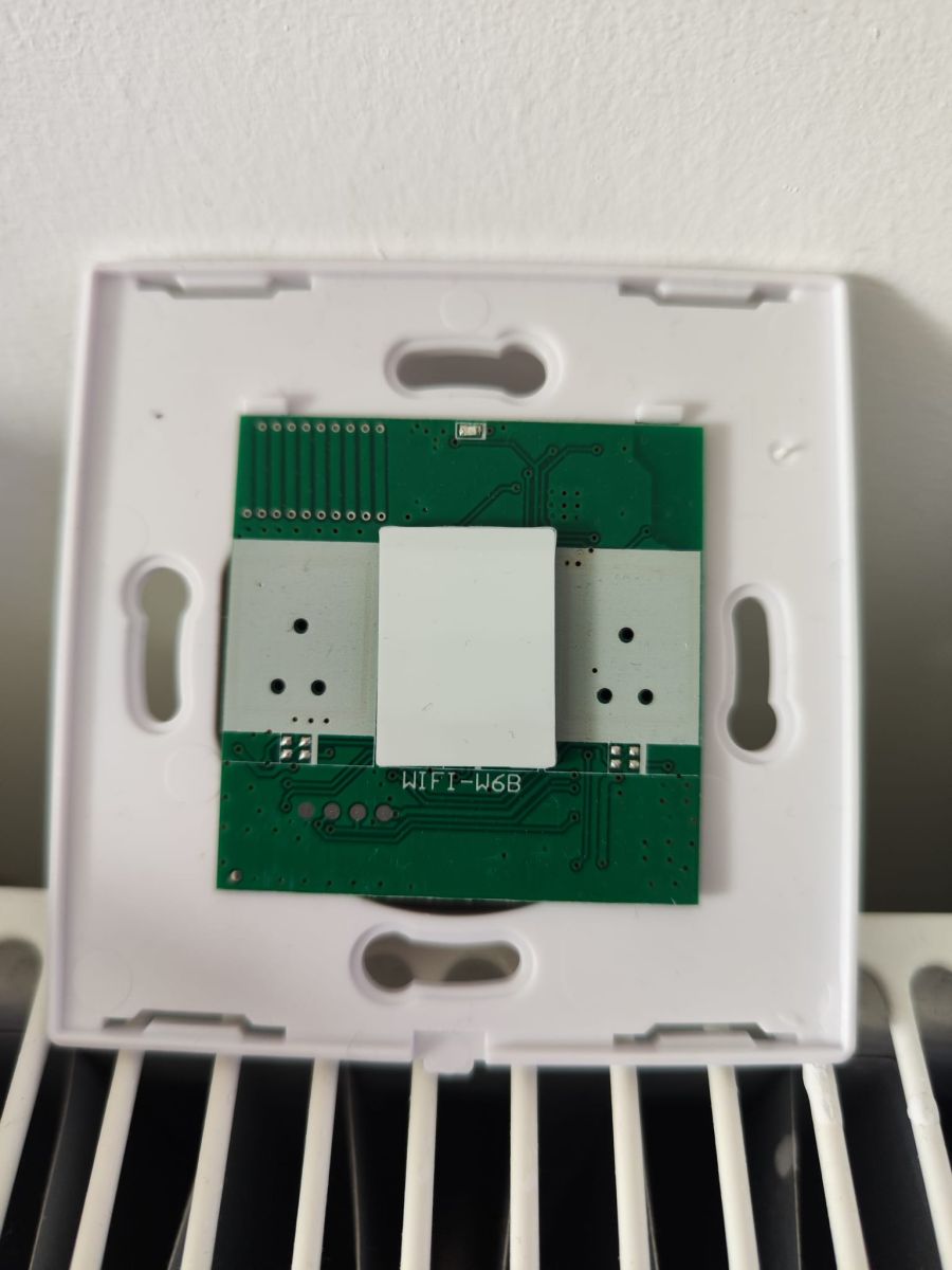

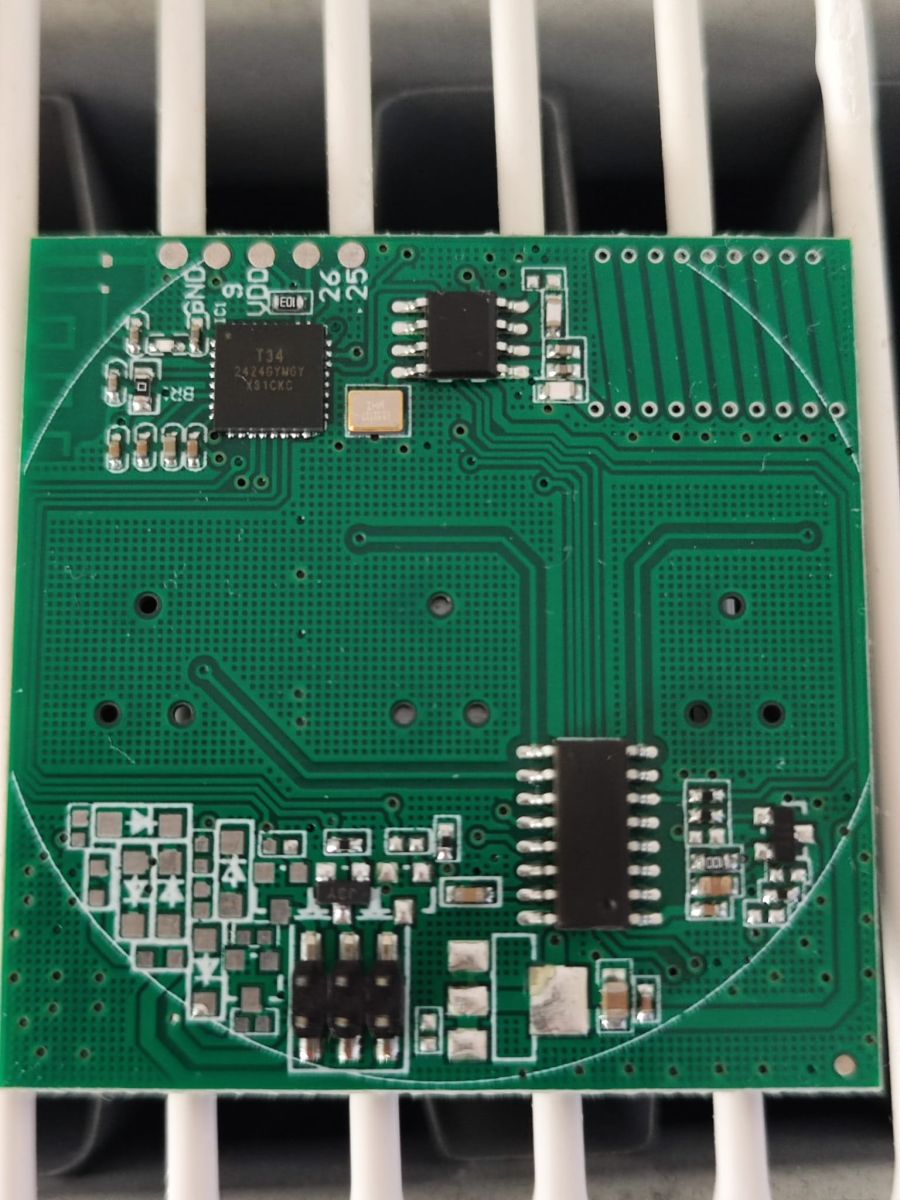

    Hi there I am new here and want to learn more so I have a light switch that I purchased from AliExpress Called AXUS Wifi smart switch.
    It has the BK7231N
    Pin out for Flashing
    VCC - VCC
    Gnd - Ground
    25 RX - Uart TX
    26 TX - Uart RX
    I have dumped the firmware and attached it but it won't read the OBK what advice could u give me to find the pin outs to set it up properly please
    Thank you

    Everything works correctly apart from the relay as when turning the light on it makes a click and reboots
    TglChanOnTgl unsuitable for touch buttons

    #10 21615366
    Posts: 14795
    Rate: 12952
    If relay works and clicks, but device reboots, then problem is in the power supply. Relay requires more power on toggle and power supply is not able to provide it. First enable PowerSave 1 on device and retry.
    I don't think that changing roles can help in this case, altough toggling on LED at the same time can also take some small extra current.
