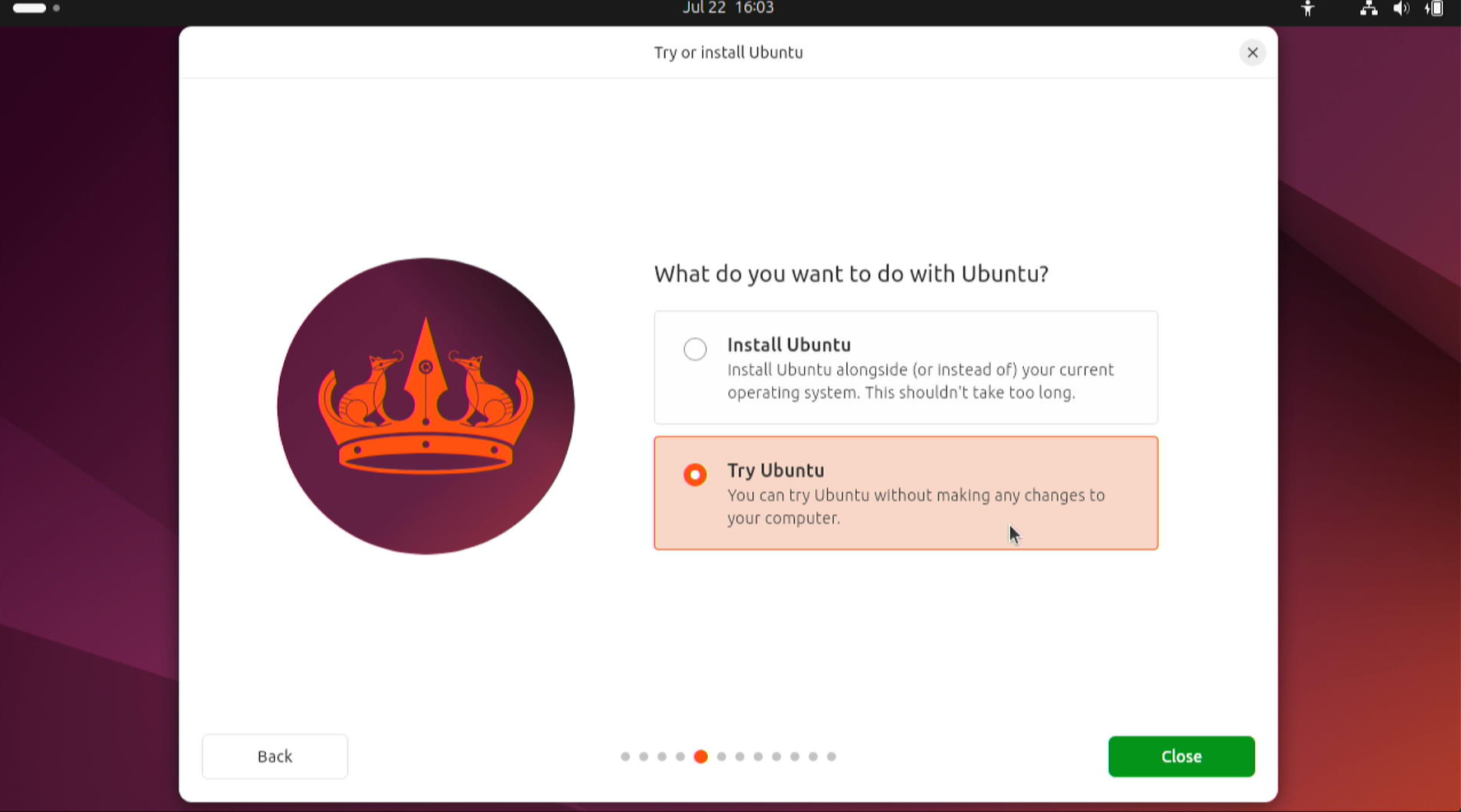

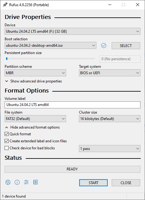

    My journey starts by burning the full Ubuntu 24.0.2 LTS desktop ISO to a 32GB memory stick with Rufus. There are probably smaller distributions that would do the job we'll need it for but this is easy and has a desktop GUI and Firefox.
    Rufus setup for creating a bootable USB with Ubuntu 24.04.2 LTS
    Boot off the memory stick and choose to "Try or Install Ubuntu". Go through the initial steps (I chose not to connect to internet) until you can choose to try Ubuntu, where it'll drop the wizard for the desktop.

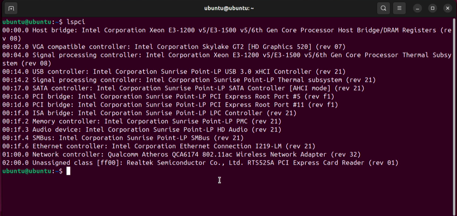

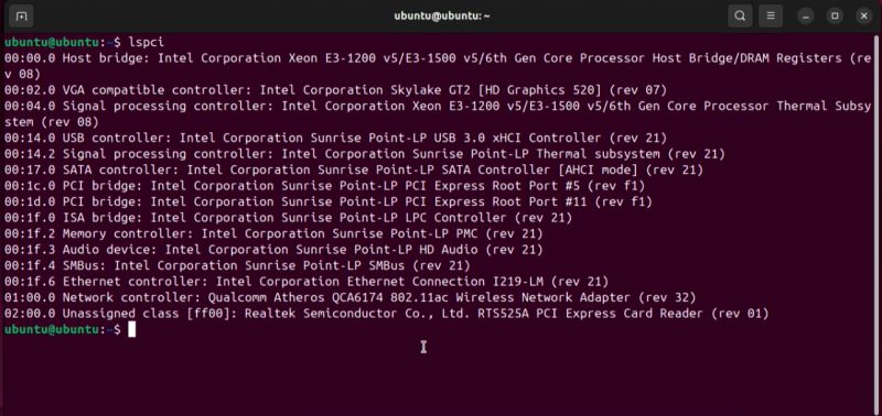

    I couldn't remember what the wireless NIC was in this at first. It can easily be identified with command lspci in terminal
    Ubuntu terminal showing lspci output with devices, including Qualcomm Wi-Fi adapter
    Qualcomm Atheros QCA6174 802.11ac Wireless Network Adapter (rev 32)

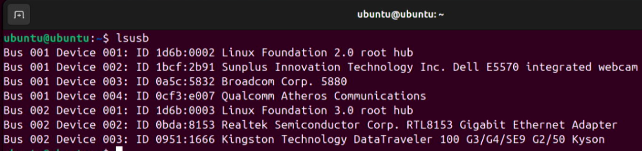

    The onboard Intel adaptor is e1000 compatible so the drivers built into the OpenWrt base image already cater for that. As mine is dodgy I need to know what my cheap USB NIC is. I already know what is it from Windows, but command lsusb is run to confirm.
    “lsusb” command output in Ubuntu terminal listing connected USB devices
    Realtek Semiconductor Corp. RTL8153 Gigabit Ethernet Adaptor. OpenWrt base image does not include drivers for this.

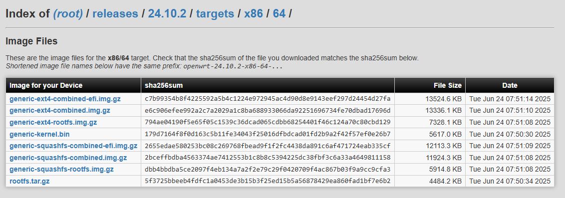

    Download the EFI or non-EFI (depending on your device age and if UEFI boot is selected in BIOS setup) generic combined images from the latest stable release under x86/64 targets - eg https://downloads.openwrt.org/releases/24.10.2/targets/x86/64/
    OpenWrt x86_64 image file listing with checksums, sizes, and timestamps
    generic-ext4-combined-efi.img.gz for me.

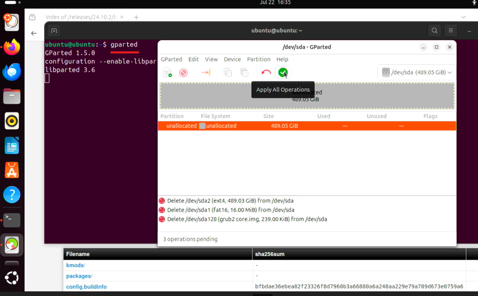

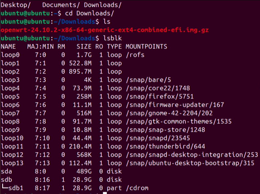

    I ran GParted to delete partitions on the SSD. I'll be cloning the .gz file onto the drive.
    Ubuntu terminal and GParted window showing 489 GB unallocated disk space

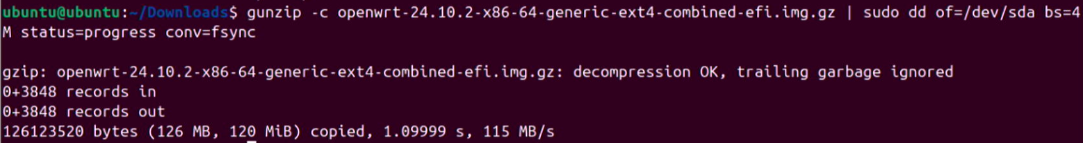

    CD into the Downloads folder or wherever you saved img file to. Command lsblk to check main drive name - sda
    Ubuntu terminal showing device list and OpenWrt image in Downloads folder

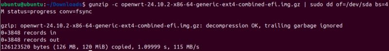

    To clone to drive (adjust filename and destination to suit)
    Linux terminal running dd to write OpenWrt image to SSD drive

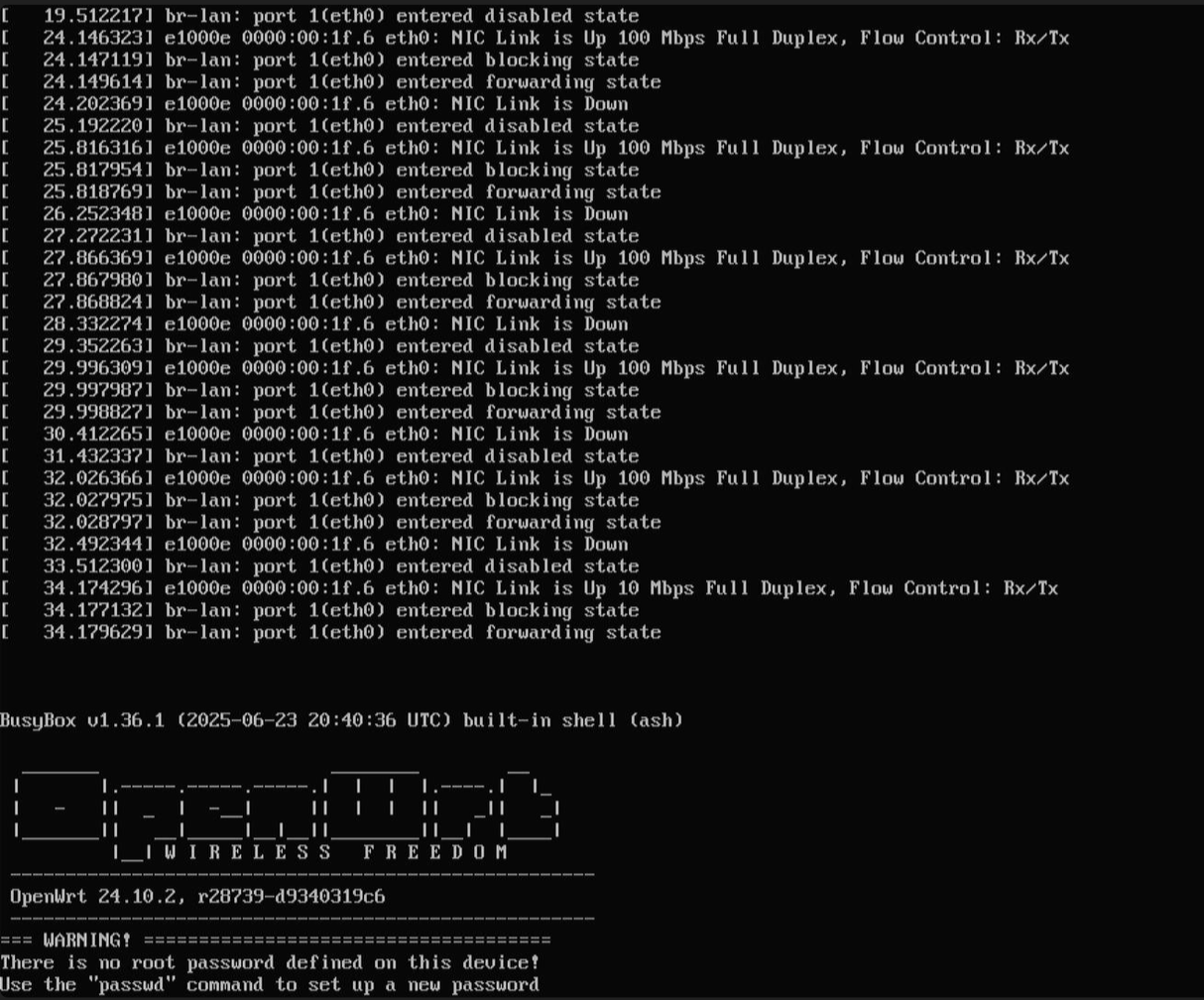

    terminal reboot command to reboot. Ensuring Secure Boot is disabled in the BIOS, OpenWrt should begin to boot.
    Screen of OpenWrt console with eth0 network interface state messages
    Image shows my dodgy NIC going up and down.

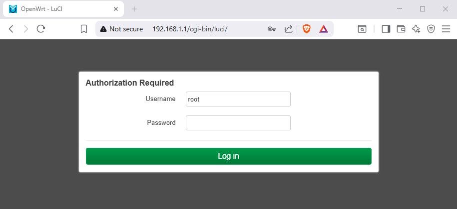

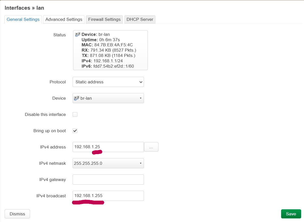

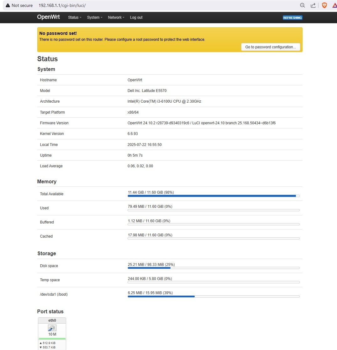

    The default IP is 192.168.1.1, which conflicts with my router. After isolating it on its own network (or disconnecting router), access can be gained through the browser from another device in the same subnet.
    LuCI OpenWrt login screen with username and password fields visible

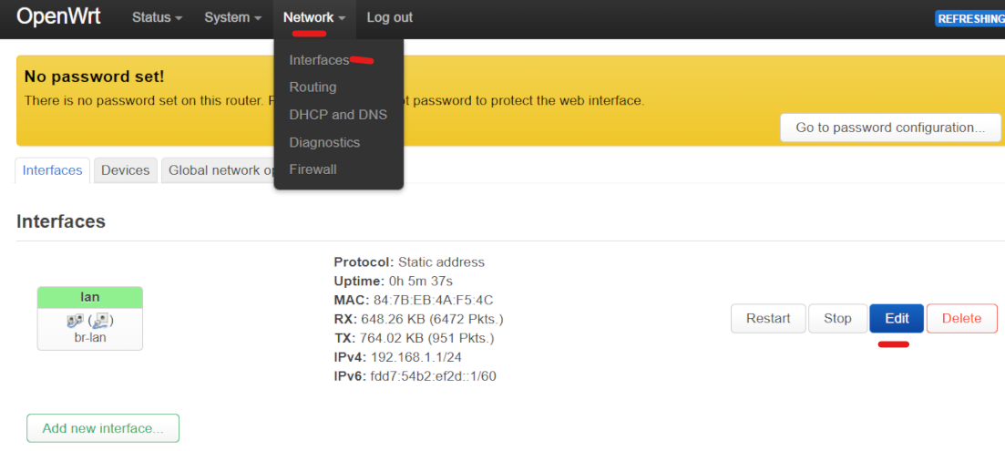

    Screenshot of Luci OpenWrt interface with Dell Latitude E5570 system summary
    through Network -> Interfaces -> Edit
    Screenshot of OpenWrt interface showing Network menu and LAN interface edit panel

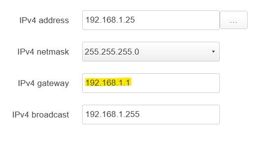

    change the IP to something free on your network. Add the subnet mask - 255.255.255.0 in my case - to be expressed as 192.168.1.255 in OpenWrt. Save
    OpenWrt LAN interface screen with static IP address configured.
    I had to go back in to add gateway because it was in the first edit already assigned the interface - 192.168.1.1
    Screenshot of IPv4 settings showing IP address, netmask, gateway, and broadcast address

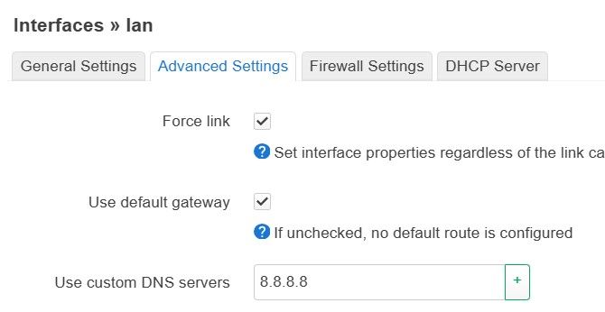

    Under Advanced Settings specify a DNS server. 8.8.8.8 = Google.
    OpenWrt LAN interface Advanced Settings tab with DNS address set to 8.8.8.8

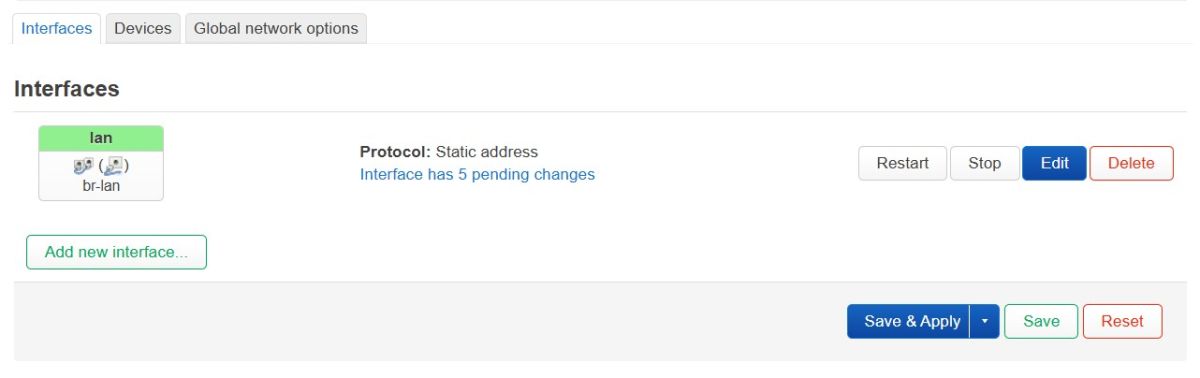

    Under General Setup check the "Ignore interface" box to disable DHCP.
    Save & Apply pending changes
    Screenshot of OpenWrt interface showing LAN interface configuration

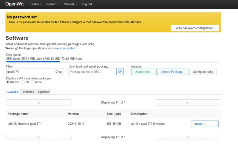

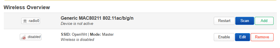

    If the wireless interface was detected there would have been a "Wireless" menu option under "Network". There wasn't. I need to install packages for the Qualcomm and the Realtek.

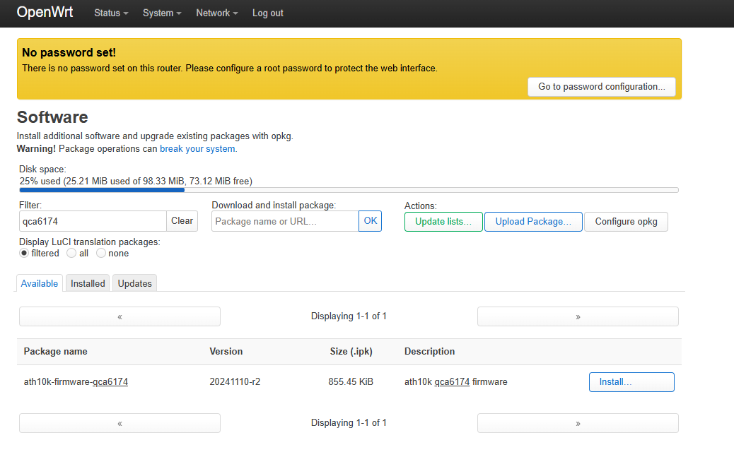

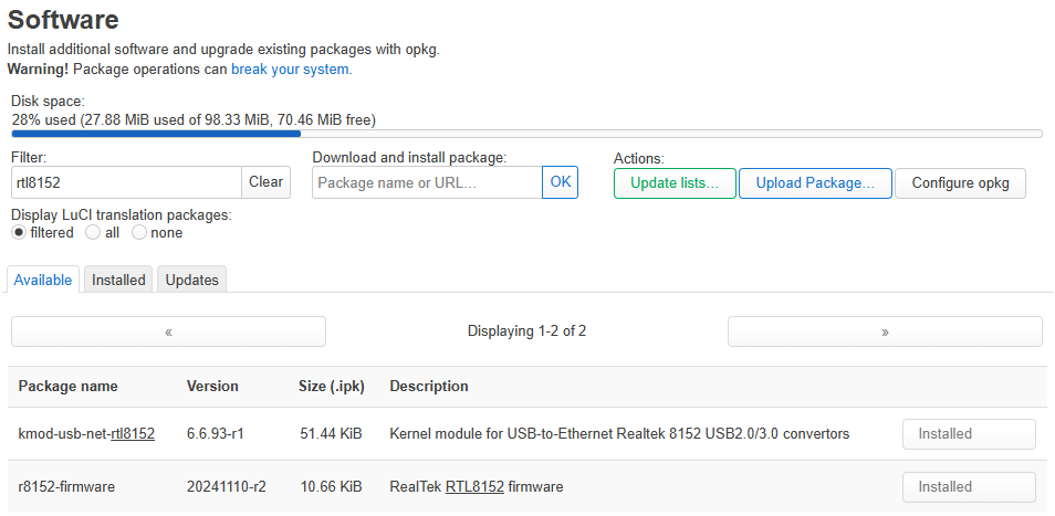

    Navigate to System -> Software and "Update Lists".
    Use search filter to find relevant packages to install
    OpenWrt screen showing qca6174 package search and install in LuCI interface
    For the Realtek rtl8153 produced no results, but rtl8152 driver is valid for 8152 and 8153. As mine is the USB variant, I installed kmod-usb-net-rtl8152
    OpenWrt LuCI screen showing installed rtl8152 USB Ethernet packages
    If command line is preferred, SSH into OpenWrt. These commands will achieve the same results as GUI package installs.

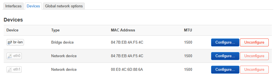

    After reboot we can see 1 new eth1 network interface
    OpenWrt screenshot showing network devices: br-lan, eth0, and eth1 interfaces
    but no wireless. It turns out an accompanying package "kmod-ath10k" is needed.
    https://openwrt.org/packages/pkgdata/kmod-ath10k
    and for WPA3 Personal support we'll also add wpad-basic-mbedtls from the command line with

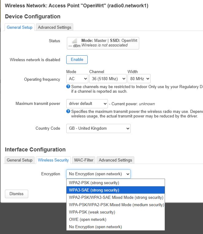

    And now after reboot the wireless menu and interface is visible
    OpenWrt interface screenshot showing inactive radio and disabled wireless network

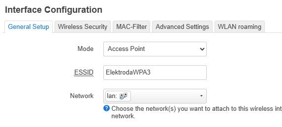

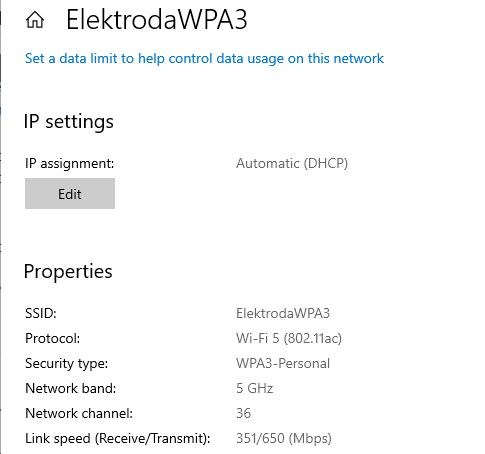

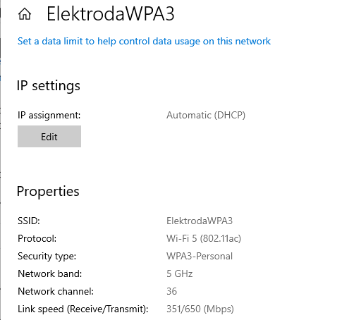

    Edit the wireless interface to customise the ESSID and set desired security. I found I had to set country code and set preferred channel or the wireless would disable itself shortly after enabling. Don't forget to save and apply pending changes.
    Wireless interface in Access Point mode with ESSID ElektrodaWPA3 selected in OpenWrt
    OpenWrt Wi-Fi configuration with WPA2/WPA3 encryption selection dropdown
    Wi-Fi network list showing secured “ElektrodaWPA3” WPA3 network selected
    Wi-Fi network details showing ElekrodaWPA3 SSID and WPA3-Personal security type

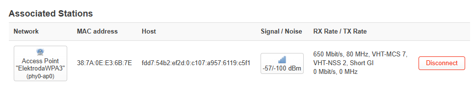

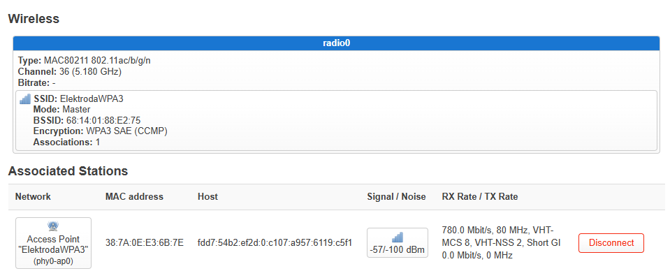

    and in OpenWrt connected devices will show
    Client station table connected to OpenWrt WPA3 access point
    And on the overview page
    Screenshot of OpenWrt interface showing WPA3 access point with one connected client

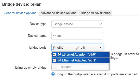

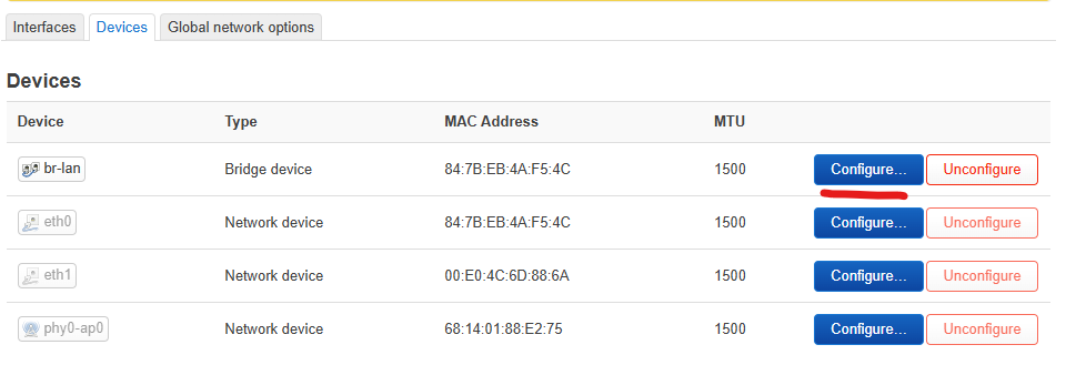

    One extra thing I needed to do, because I wouldn't be using the Intel LAN, is add eth1, the Realtek, to the bridge
    OpenWrt network devices list with configure and unconfigure buttons visible
    Selected eth0 and eth1 adapters in br-lan bridge configuration in OpenWrt

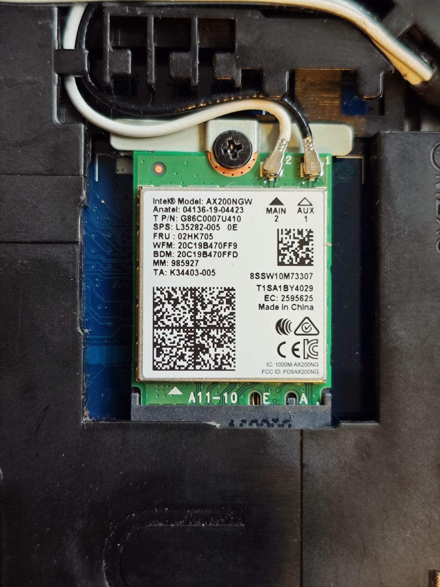

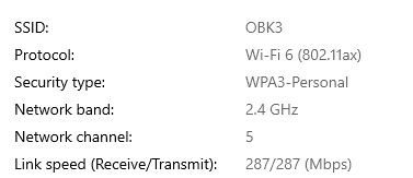

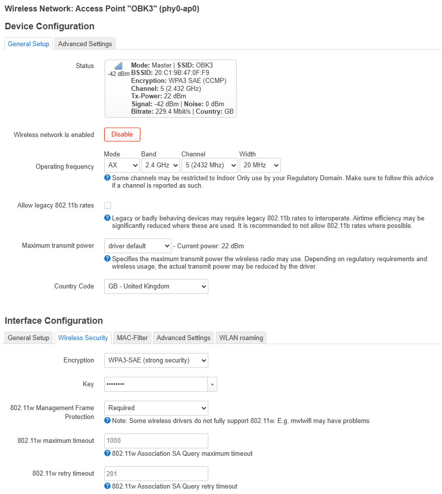

    Swapped the Atheros/Qualcomm QCA6174 802.11ac module for an Intel AX200 802.11ax.
    Intel AX200NGW Wi-Fi module with antenna cables connected to MAIN and AUX ports

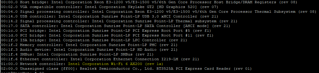

    confirmed presence with lspci command after installing pciutils over SSH/PuTTY
    Terminal view showing Intel Wi-Fi 6 AX200 detected via lspci command
    Installed Intel firmware and kernel module

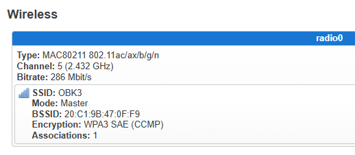

    reboot

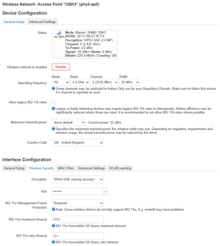

    Wi-Fi details: MAC80211 802.11ac/ax/b/g/n type, channel 5, bitrate 286 Mbit/s
    switch to AX/2.4Ghz
    Wi-Fi access point settings with 2.4 GHz band and AX mode (Wi-Fi 6)
    Confirm Wi-Fi 6 on Windows client
    Wi-Fi details showing Wi-Fi 6, 2.4 GHz band, WPA3, and 287 Mbps link speed
