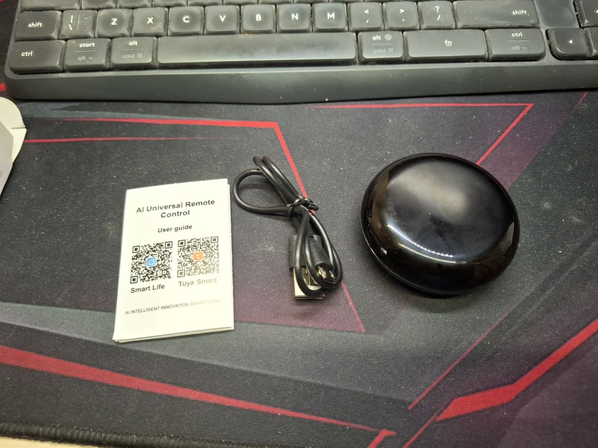

    From this it appears that OpenBeken is running on your device. Can you give me (I'll use for the tutorial) an accurate and clearer picture of this module and information where the device comes from, pictures of the case, any info you have?
    Bought: https://pl.aliexpress.com/item/10050078048597...in.11.2e2e1c24Xufr2H&gatewayAdapt=glo2pol
    Opened white box with IR marking and QR code on the side. Tuya Wi-Fi universal remote, user guide, and USB cable on mouse pad .

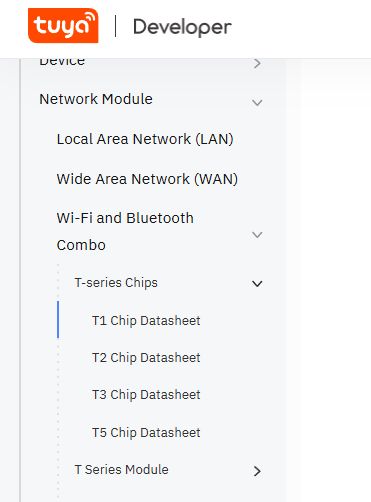

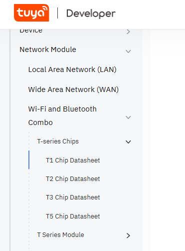

    Interestingly enough, Tuya lists T chips up to 5 here:
    Sidebar menu on Tuya Developer site showing T-series chip datasheets
    I wonder if they are all Beken? T2 pins looks like Beken...
    T3 says: 32-bit Armv8-M STAR-MC1 MCU , it also has P40 and P41...
    T5 is similar. Both T3 and T5 has WiFi 6.
  • #40 21621725
    insmod
    Posts: 1432
    Help: 168
    Rate: 455
    >>21621714
    T1 - BK7238
    T2 - BK7231N
    T3 - BK7236
    T5 - BK7258

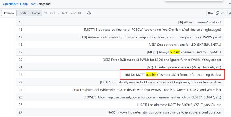

    From the HA, it is easy to send a remote control command via MQTT.
    However, I cannot figure out how to receive commands in HA.
    There are commands in the OpenBK logs, but nothing reaches the HA via MQTT.
    #45 21621837
    Posts: 14755
    Rate: 12878

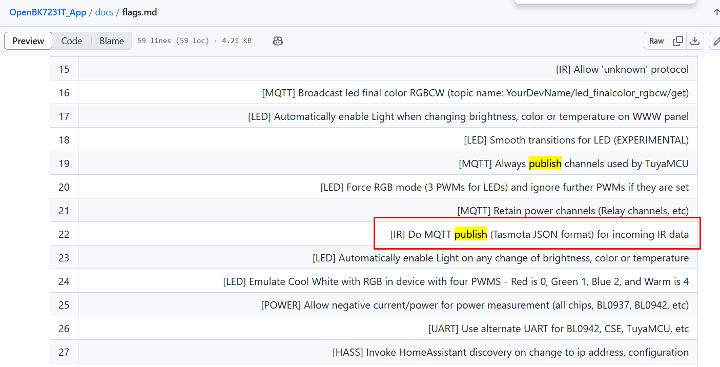

    Activate flag 22
    Line 22 describes publishing incoming IR data via MQTT in Tasmota JSON format .

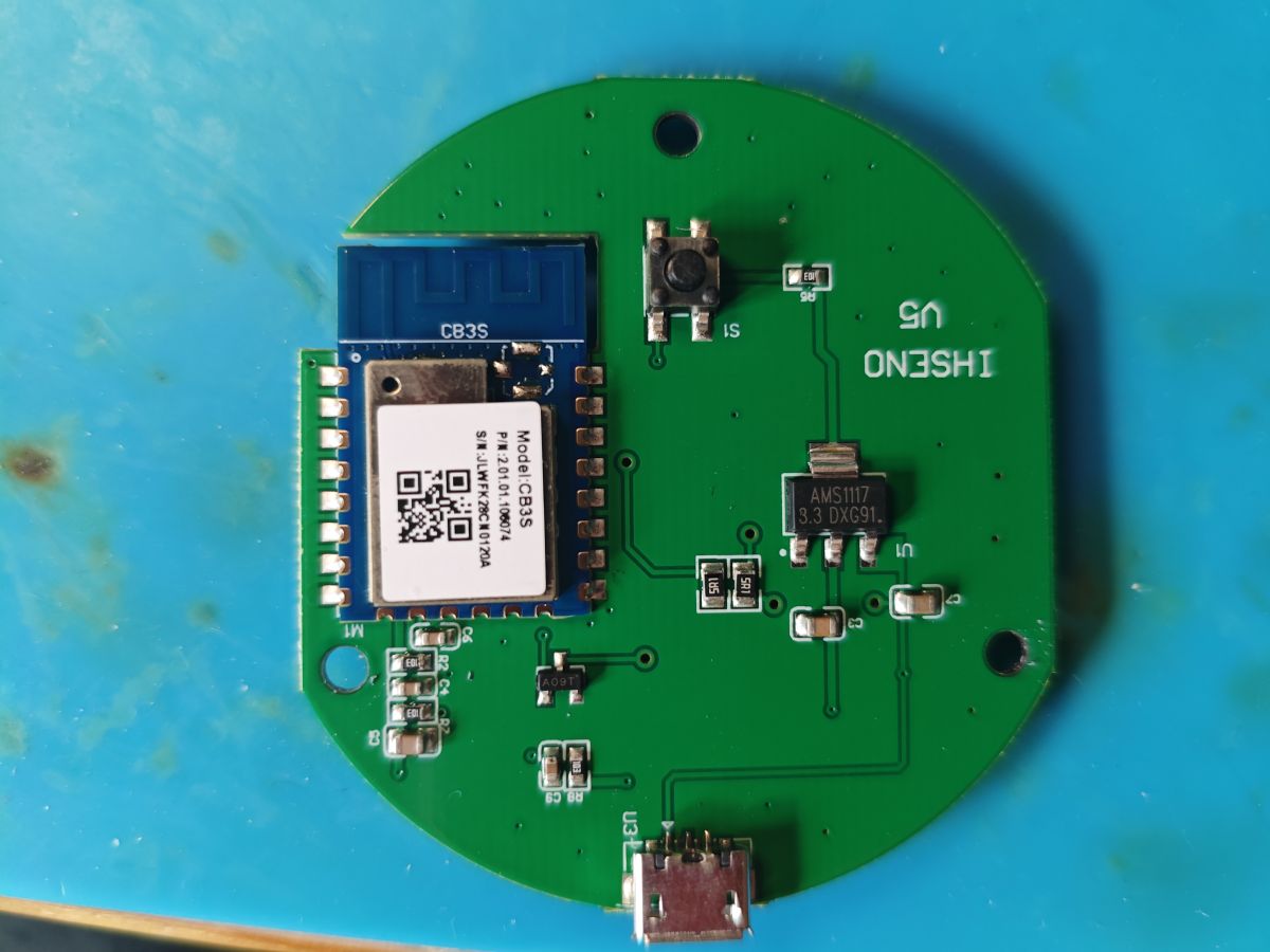

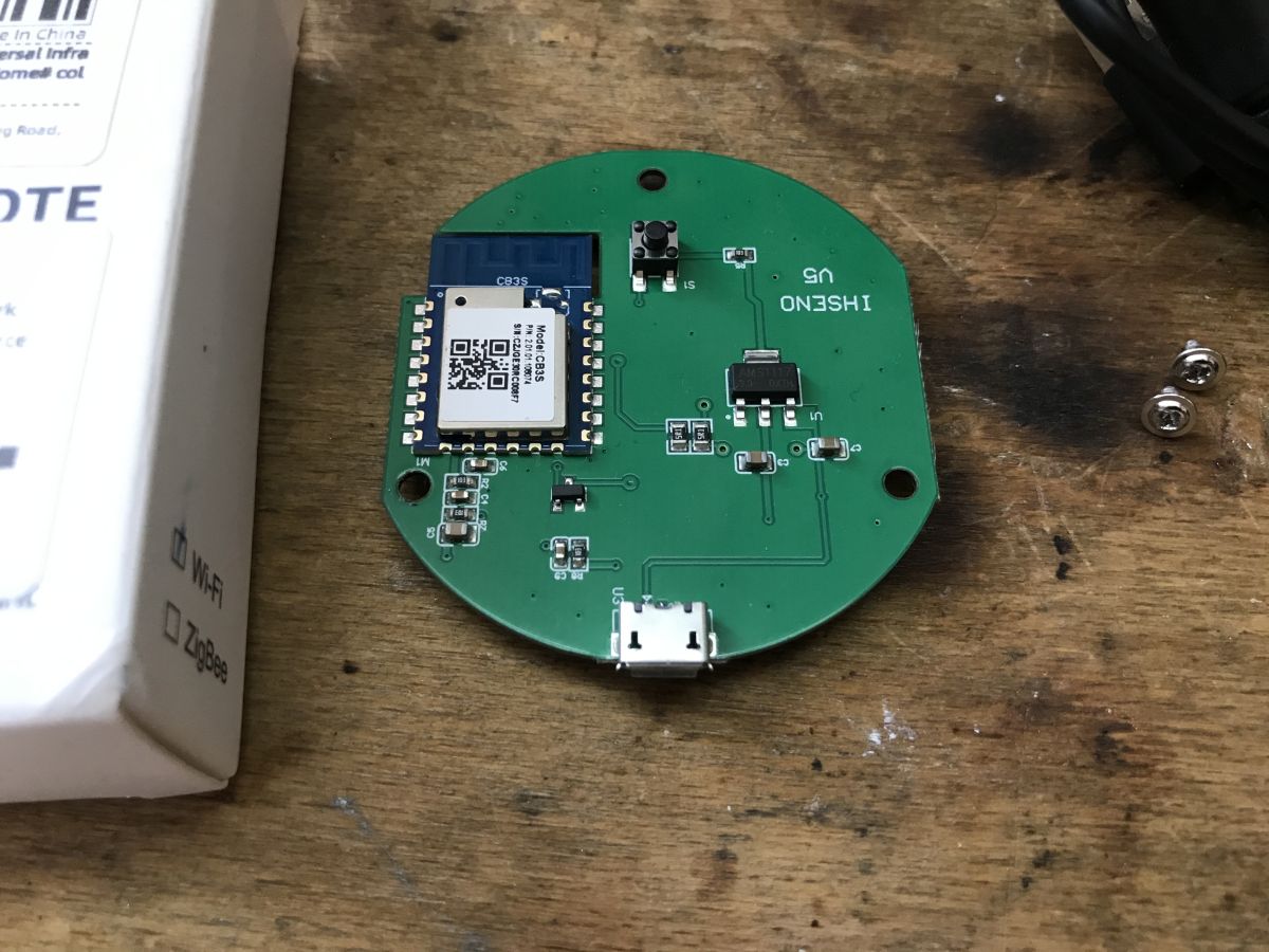

    Posts: 5209
    Help: 446
    Rate: 914
    no T1 for me
    Round green PCB with CB3S module and micro USB port

    Posts: 14755
    Rate: 12878
    Same here:
    Round PCB with ESP8285 Wi-Fi module and micro USB port

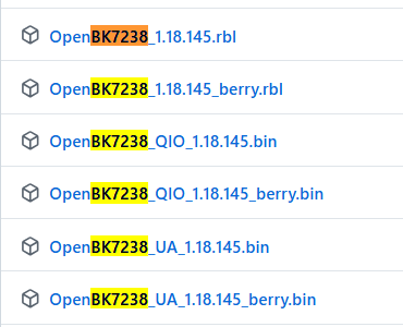

  • #55 21628306
    Posts: 5209
    Help: 446
    Rate: 914
    It actually is not, is it, @divadiow ?
    nope
    List of files named BK7238 with .rbl or .bin extensions

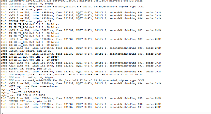

  • IR codes collapse to the same PulseDistance value
    #59 21628330
    duceduc
    I think the pins are the same. Though I was not able to send code to AC unit successfully. Also, the led I use is WifiLED. LED did not work.
    "pins": {
    "6": "IRSend;3",
    "8": "IRRecv;2",
    "9": "dInput;1",
    "26": "WifiLED;2"
    These 3 codes are for turn off unit, turn on AC, turn on heater. All produced the same code. My ac unit is a Mitsubishi Electric (Japan). Why it says PulseDistance. No idea. Also, my Toto toilet is showing PulseDistance with duplicate codes. As reference, I am currently using Broadlink RM3 & RM4 for these units with no issues.
    Info:IR:IR IR_PulseDistance 0x819 0x809 0 (40 bits)
    These are the url links I have tried, but did not work.

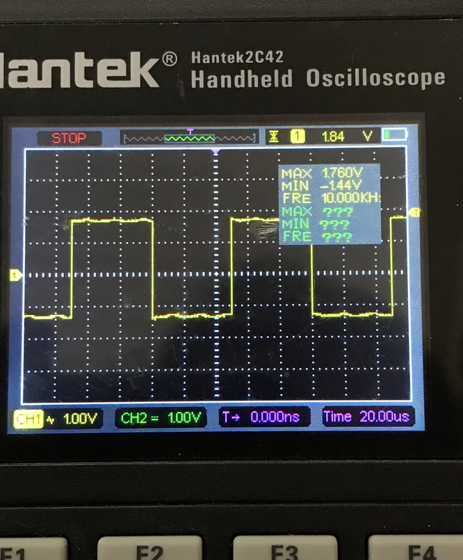

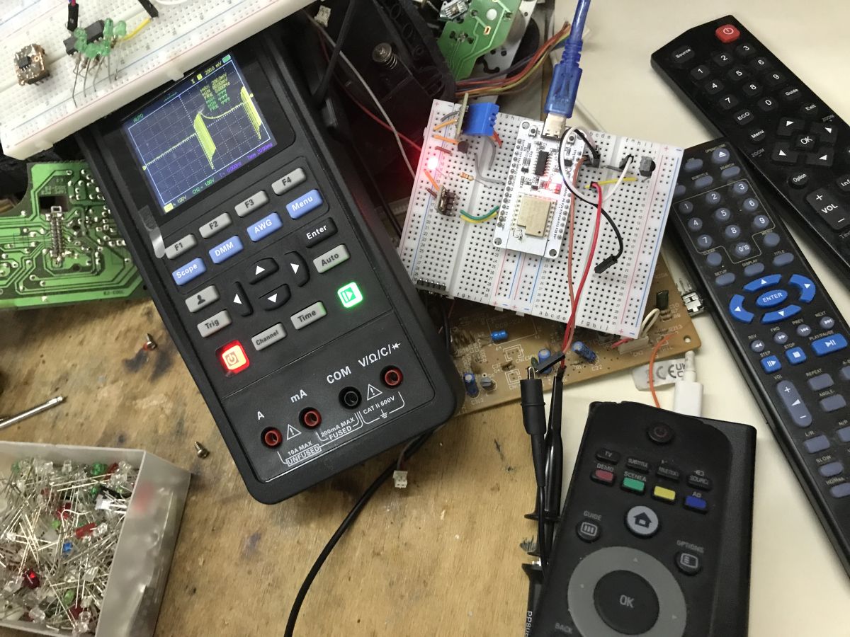

    #60 21630410
    Posts: 14755
    Rate: 12878
    @divadiow @insmod

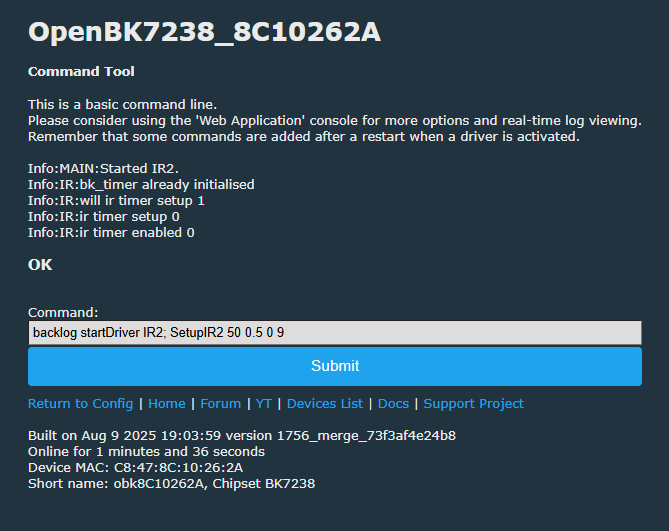

    I'm checking IR for BK7238 (T1) on NiceMCU
    IR2 driver with enabled DEBUG_WAVE_WITH_GPIO
    https://github.com/openshwprojects/OpenBK7231T_App/pull/1756
    OpenBK7238 web interface with IR2 driver running and configuration command entered
    Oscilloscope screen showing 10 kHz square wave up to 1.76 V
    Well so far the timer seems correct
    10kHz frequency = 100us period = toggle every 50us
    Code: C / C++

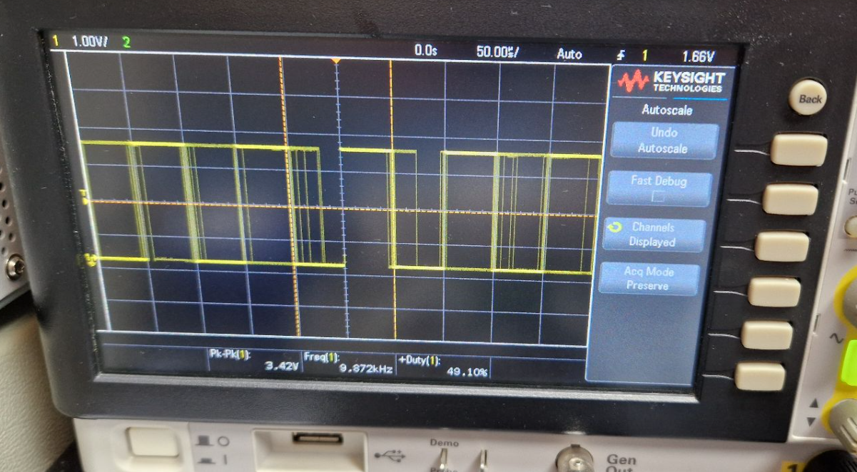

    Added after 3 [minutes]:
    That was from Beken timer, unmodified, so it's same as on BK7231.
    10kHz is the same what @DeDaMrAz saw with me when we were creating IR2 driver back in July 2024:
    9.872 kHz waveform with 49.10% duty cycle on Keysight oscilloscope screen

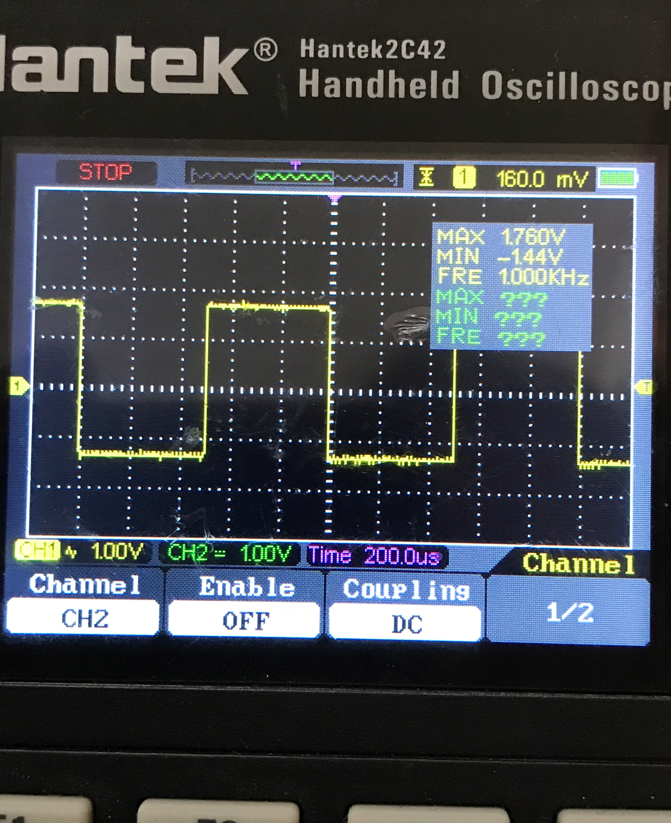

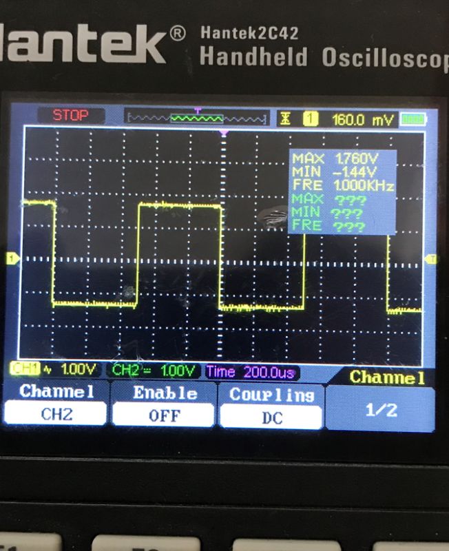

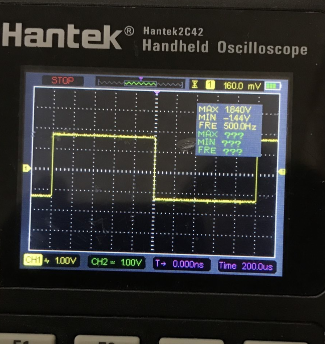

    Ok, what about PWM? Default frequency, 50 value in channel, BK7238 P9:
    Square wave signal at 1 MHz shown on Hantek2C42 oscilloscope screen
    Also seems ok.. default PWM in OBK is 1 kHz.

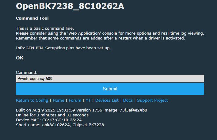

    Let's change to 500Hz:
    Screenshot of OpenBK7238 interface showing PwmFrequency 500 command submitted
    Ok...
    Hantek2C42 oscilloscope screen showing a 500 Hz square waveform
    Added after 15 [minutes]:
    Seems to work out of the box on NiceMCU? However, I noticed that my previous IR receiver was faulty. Hmm.
    OpenBK7231T system logs displaying received IR RC6 signals
    Digital oscilloscope with waveform and breadboard setup testing BK7238 IR circuit
    Added after 8 [minutes]:
    Events are working for RC6 (out of the box). NiceMCU config:
    Script:
    startDriver IR
    addEventHandler2 IR_RC6 0x0 0x1 led_basecolor_rgb FF0000
    addEventHandler2 IR_RC6 0x0 0x2 led_basecolor_rgb 00FF00
    addEventHandler2 IR_RC6 0x0 0x3 led_basecolor_rgb 000FF0
    Video:
