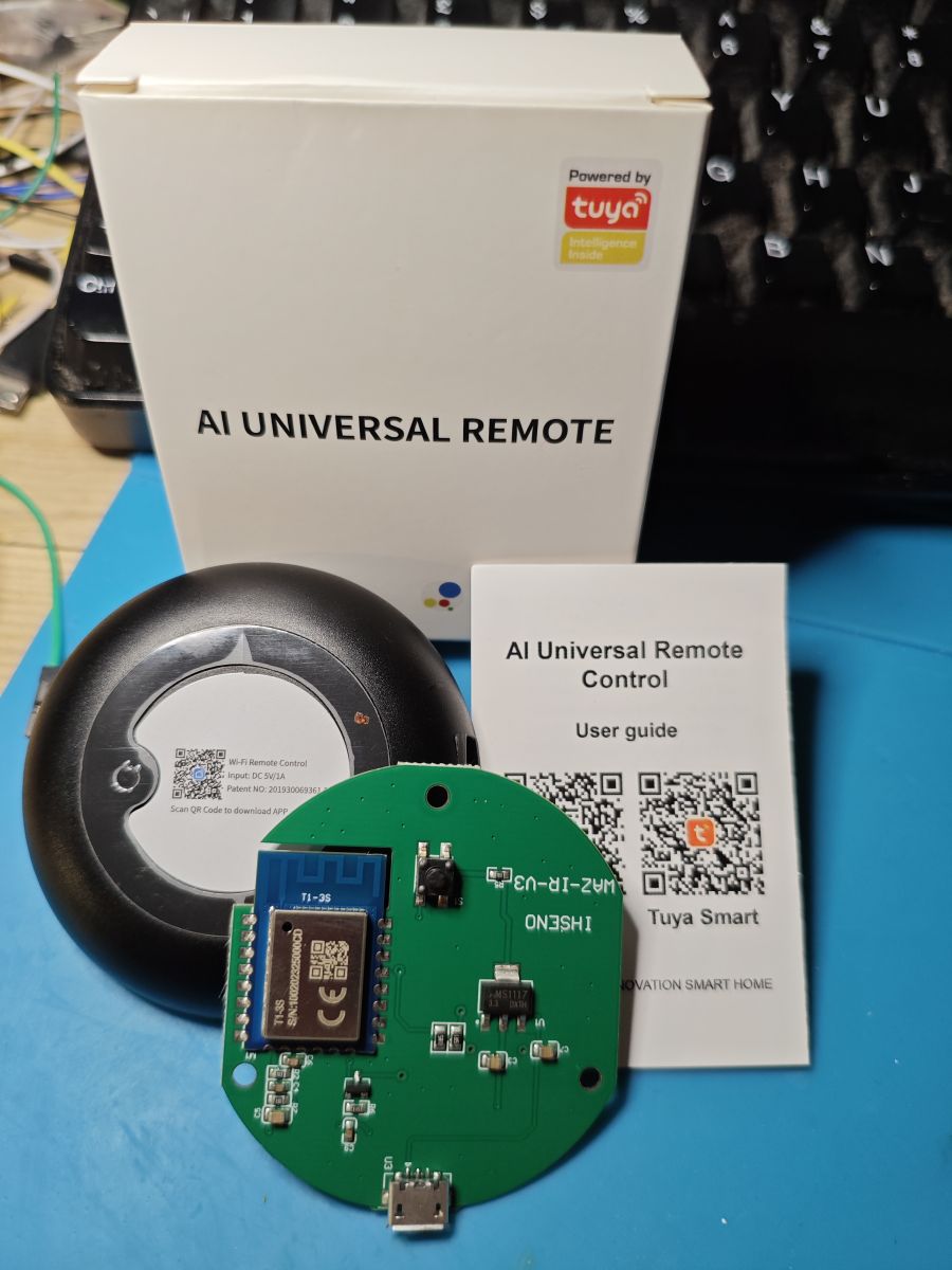

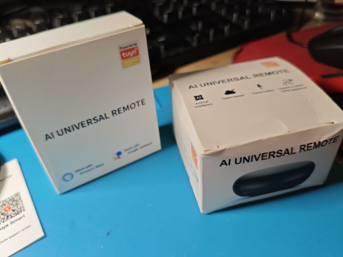

    T1-3S type now.
    AI Universal Remote with box, user guide, and PCB featuring T1-3S module
    T1-3S comes in different box (left)
    Two different AI Universal Remote packages on a blue surface

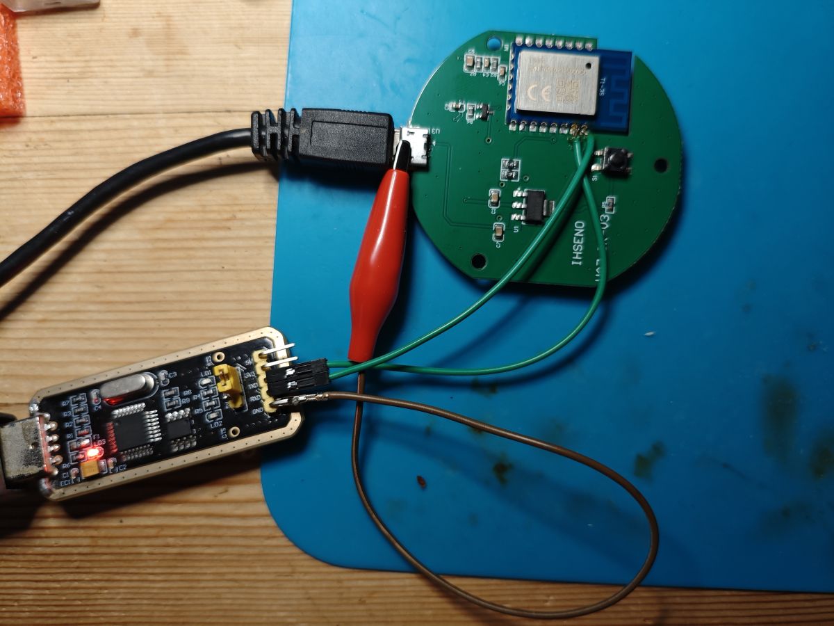

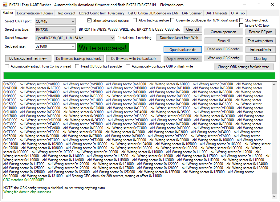

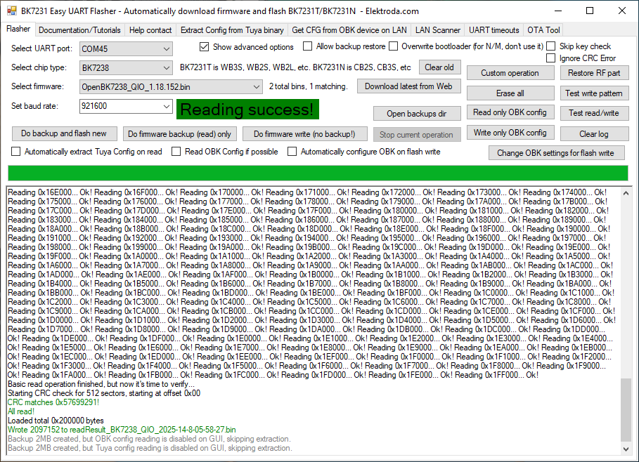

    Is EasyFlasher working for you?
    yes. only soldered TX1/RX1. Clippy GND. USB powered.
    ESP module connected to USB-TTL adapter and circular PCB via jumper wires
    BK7231 Easy UART Flasher interface with Reading success! message
    BK7231 Easy UART Flasher window showing Write success! message and write log.

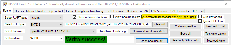

    regarding submitted template, I think P26 would be better as WifiLED instead of LED and P9 as BtnScriptOnly (and some scripted use) instead of dInput
    Added after 33 [minutes]:
    OTA is not successful if you keep Tuya bootloader. I think users need to be aware they might need to overwrite bootloader. or a variant is released that caters for Tuya download partition, if standard (not looked).
    BK7231 Easy UART Flasher window with “Write success!” message displayed
    It's also not obvious how users can choose a variant solely from Easy Flasher. They would need to know to go to second releases list and to copy file to \firmwares folder in EF first.

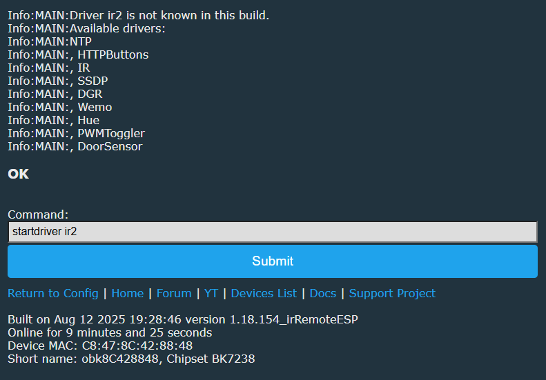

    IR1 driver - Toshiba DVD/VHS device remote power button
    IR2
    doesn't seem to exist in 1.18.154_irRemoteESP
    ESP config screen showing message that ir2 driver is not known in this build

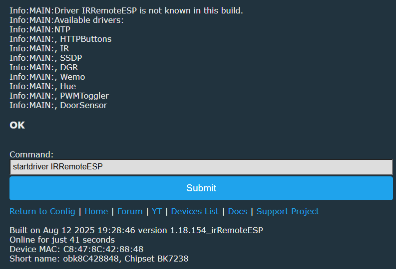

    Added after 1 [hours] 10 [minutes]:
    wait, standard IR driver in irRemoteESP release is the irRemoteESP8266 library?
  • IR2 driver experiment and T1 flasher suggestion

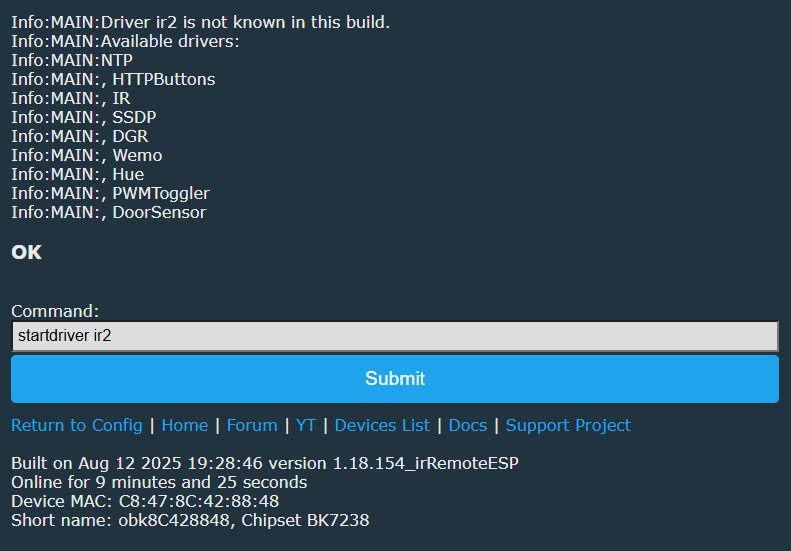

    #65 21634532
    Posts: 14770
    Rate: 12913
    In IrRemoteESP, the IR driver is IRRemoteESP. In original OBK, IR driver is Arduino-IRRemote.
    IR2 driver is just a little experiment I made with @DeDaMrAz and it was presented in my IR tutorial:
    https://www.elektroda.com/rtvforum/topic4062643.html
    https://www.elektroda.com/rtvforum/topic4063469.html

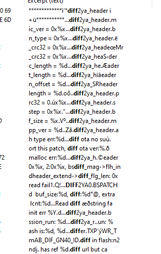

    Why original bootloader is not working with our OTA RBL? So.... we probably can just add "T1" option to flasher and then silently enable bootloader overwrite?
  • Factory bootloader blocks OTA RBL updates
    #66 21634539
    Posts: 5220
    Help: 449
    Rate: 918
    hmm
    OpenBK7238 web interface showing IRRemoteESP driver not known in this build
    Added after 10 [minutes]:

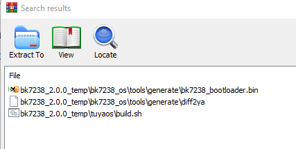

    unsure yet. OpenBK7238 does OTA to 132000. Can't yet see obvious rbl header or 01PE partition information in pain-text in bootloader in factory dump.
    OTA fail with factory BL was same with Tuya soil tester with T1
    OpenBK7238 flashed over the top of factory firmware. I chose to overwrite the bootloader because keeping the factory BL meant OTA updates were not successful.
    https://www.elektroda.com/rtvforum/topic4133895.html
  • #67 21634550
    Posts: 14770
    Rate: 12913
    I meant... when you have IrRemoteESP build, then when you do:
    startDriver IR
    Then this IR driver is infact IRRemoteESP.

    lol ok ok. that clears that up. thanks
    so for comparison to standard IR driver, with IRRemoteESP driver - same Toshiba power button:

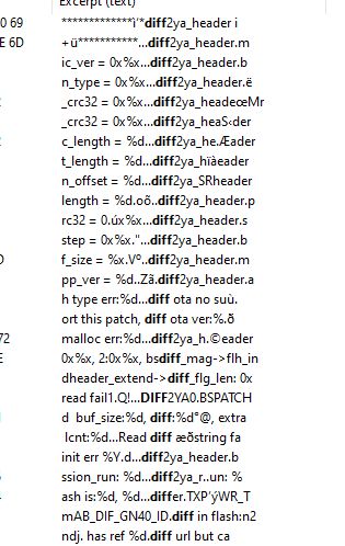

    not expecting rbl but diff2ya something?
    Archive manager window showing three firmware tool files for bk7238
    Screenshot showing fragment of source code text with “diff2ya” headers visible.
    so maybe T1 needs to have bootloader overwritten as standard?

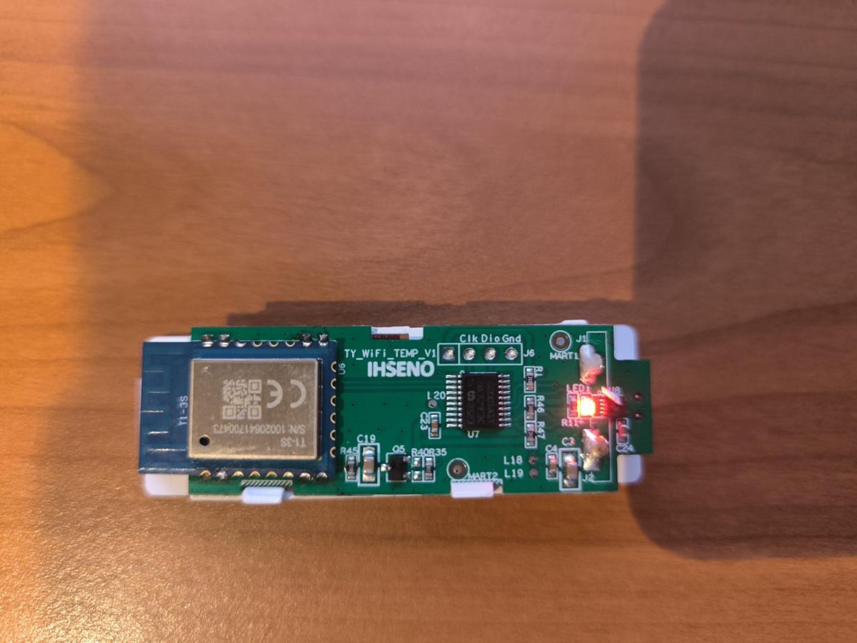

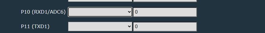

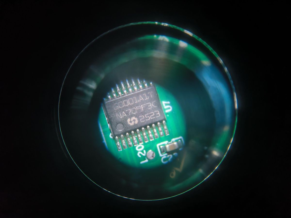

    #69 21747038
    everglade
    Posts: 13
    @p.kaczmarek2 I have bought a new deivce, IHSENO TY_WIFI_TEMP_V1 wifi controlled temperature and humidity sensor. It had a T1-3S. I have attached photos of the board and the unknown microcontroller.
    I had to desolder the T1-3S from the board to flash it with OpenBeken - the TX1/RX1 ports are used by the microcontroller. It is now visible in Home Assistant via MQTT. Annoyingly, this device automatically turns on for 15 seconds and then turns off - so you have to work quickly when configuring, unless you desolder again! This is controlled at the base microcontroller level. Pressing the reset button can force it to start.
    Can anyone help me to try and get the temperature/humidity data from the UART stream from the microcontroller (coming into the T1-3S on pin 15 and 16 (which correspond to P10 and P11 on the IC). What I select in the OpenBeken device config page?
    IHSEN WiFi electronic module with red LED indicator lit
    Microscopic close-up of an integrated circuit on a green PCB
    Screenshot of microcontroller pin configuration for P10 and P11
    TuyaMCU driver required; configure dpIDs instead of assignments
    #70 21747714
    Posts: 5220
    Help: 449
    Rate: 918
    that's a TuyaMCU device so you'll not be setting assignments in the config page but rather running the TuyaMCU driver and setting up dpIDs relevant to your device

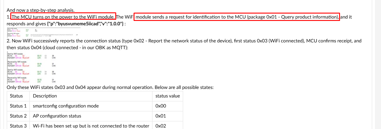

  • TuyaMCU product ID and handshake parsed
    #79 21747791
    everglade
    Posts: 13
    I have got some log stuff here but I can't make heads nor tails of it!!
    Info:TuyaMCU:Skipped data (part) F8 F8 F8 F8
    Info:TuyaMCU:Received: 55 AA 03 00 00 01 01 04
    Info:TuyaMCU:ProcessIncoming[v=3]: cmd 0 (Hearbeat) len 8
    ExtraDebug:TuyaMCU:TuyaMCU heartbeat_valid = 1, product_information_valid=0, self_processing_mode = 1, wifi_state_valid = 0, wifi_state_timer=11
    ExtraDebug:TuyaMCU:Will send TUYA_CMD_QUERY_PRODUCT.
    Info:TuyaMCU:Received: 55 AA 03 01 00 46 7B 22 70 22 3A 22 70 78 72 6D 78 79 35 7A 7A 7A 68 66 6B 6C 78 68 22 2C 22 76 22 3A 22 31 2E 30 2E 30 22 2C 22 6D 22 3A 31 2C 22 6D 74 22 3A 31 2C 22 6E 22 3A 30 2C 22 6C 6F 77 22 3A 31 2C 22 73 6D 22 3A 30 7D D7
    Info:TuyaMCU:ProcessIncoming[v=3]: cmd 1 (QueryProductInformation) len 77
    Info:TuyaMCU:ParseQueryProductInformation: received {"p":"pxrmxy5zzzhfklxh","v":"1.0.0","m":1,"mt":1,"n":0,"low":1,"sm":0}
    ExtraDebug:TuyaMCU:TuyaMCU heartbeat_valid = 1, product_information_valid=1, self_processing_mode = 1, wifi_state_valid = 0, wifi_state_timer=11
    ExtraDebug:TuyaMCU:Will send TUYA_CMD_MCU_CONF.

    #82 21747830
    Posts: 5220
    Help: 449
    Rate: 918
    Tuya reports your device dpIDs to be:
  • OpenBeken autoexec for TuyaMCU temperature and humidity

    #88 21747914
    Posts: 14770
    Rate: 12913
    everglade wrote:
    I sent that command through the command box (nb returned Info:CMD:[WebApp Cmd 'tuyaMcu_sendQueryState' Result] OK) if I reselect all logging. There is no response from this command at all.
    NB also @p.kaczmarek2 stated that the "tuyaMcu_sendQueryState" command is not supported with battery-powered devices??
    There is no such command for battery powered devices and there is no place for that, protocol is strict.
    everglade wrote:
    So, I waited a total of five minutes. Here is what I received:
    Info:TuyaMCU:Consumed 7 unwanted non-header byte in Tuya MCU buffer
    Info:TuyaMCU:Skipped data (part) F8 F8 F8 F8 F8 F8 F8
    Battery powered TuyaMCU devices will never work correctly if you power Wi-Fi module externally.
    Read whole topic:
    https://www.elektroda.com/rtvforum/topic3975583.html
    Documentation fragment showing TuyaMCU Wi-Fi and MCU communication sequence
    As you can see in the image above, the OBK has to boot exactly after MCU turns on it power, and then tmSensor must send a packet. If you have OBK booted at different time (powered externally), it will now know when to send first packet, so transaction will not start.
    Garbage data can happen if you power Wi-Fi module externally.
  • Battery power makes configuration nearly impossible
