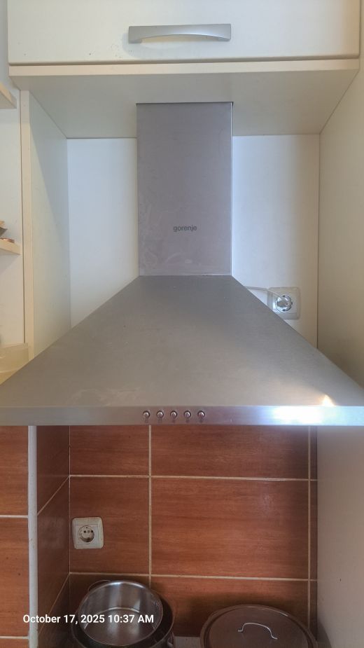

    I wanted to make my kitchen a little smarter by upgrading my regular kitchen hood — three fan speeds and a light — to a smart device I could control via Home Assistant, and later automate with sensors.
    After looking at DIY projects online, most seemed too time-consuming, so I decided to build a simple, practical solution.
    This setup can be used not only for my kitchen hood model but also for any other ventilation hood with 3 fan speeds and a light.
    As long as the wiring layout is similar and the fan speeds are controlled through separate lines, this configuration will work perfectly.

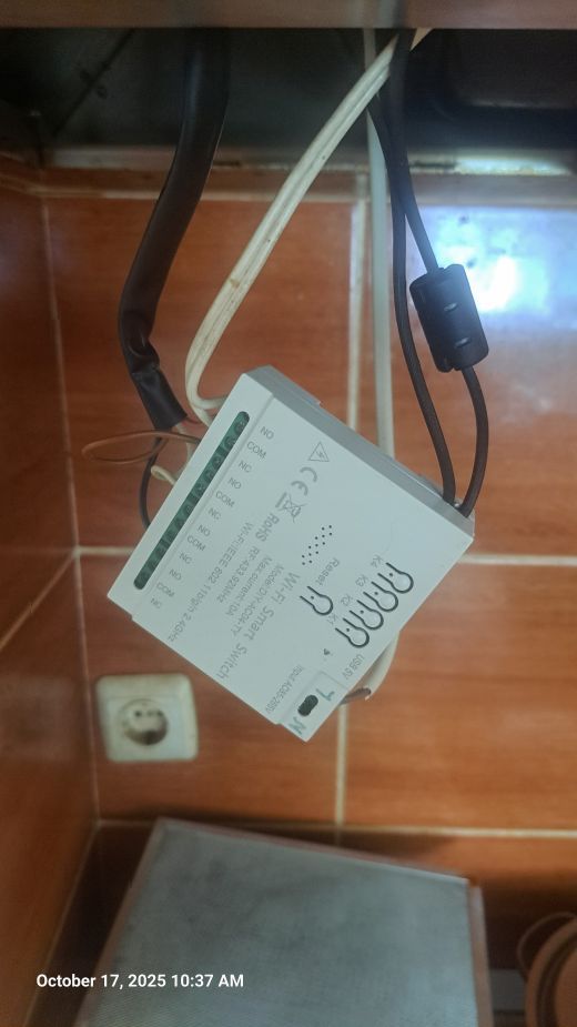

    Stainless steel Gorenje kitchen hood installed above a stovetopSonoff relay module with connected wires in a kitchen setting

    ⚡ Components Used
    🔌 4-Channel Tuya Smart Switch (220V Wi-Fi module) – ( bk72xx / CB3S ) minimal internal modifications required AliExpress link
    🛠️ Relay Module – Reprogrammed to control fan speeds and light. Requires minimal hardware changes.* *Or no changes, if you don't mind a "spaghetti salad" of wires.

    ⚡ Hardware Modifications
    To adapt the 4-channel Tuya relay module for use with the kitchen hood, I made a few simple internal and wiring modifications:
    Phase (L) Bridging: The live wire (phase) from the input was bridged to the common terminals of all relays on the PCB.
    Neutral (N) Connection: On the fourth relay (used for the light), I disconnected the original NC contact (cut the PCB trace) and reconnected it to neutral (N) instead.
    Button Conversion: The original wall switch was replaced with momentary push buttons, which were wired in parallel with the onboard buttons on the relay module.
    LED Indicators: Each speed indicator LED is connected in parallel with its corresponding fan relay, so the LED lights up when that speed is active.
    These small hardware changes allow the module to safely and correctly control all three fan speeds and the light, while also providing visual feedback through the LEDs.
