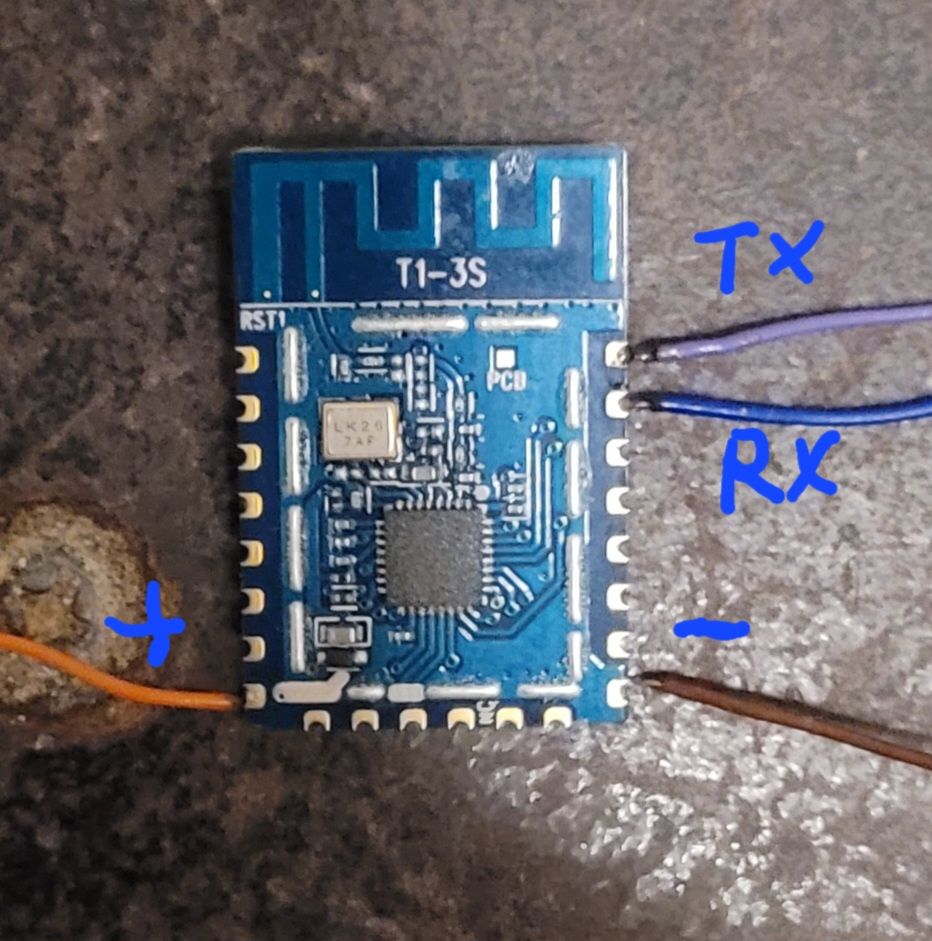

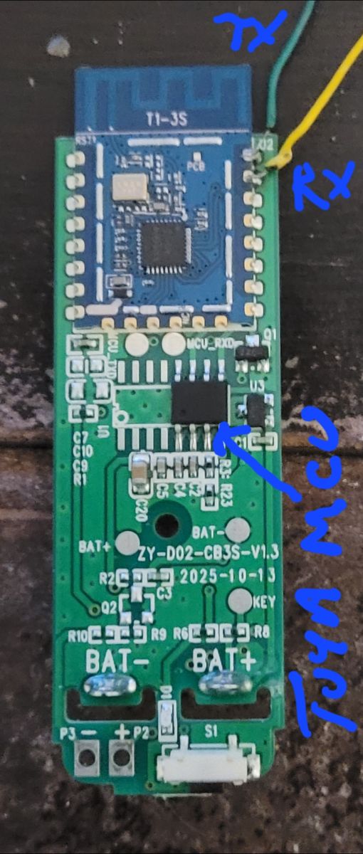

    I purchased some ZY-D02 door sensors from AliExpress.
    Board ID: ZY-D02-CB3S-V1.3
    Wi-Fi Module: T1-3S
    App: SmartLife
    Electronic module with TI-3S Bluetooth chip and labeled TX, RX, and MCU signals.
    I attached wires to the TX/RX pins and used the TuyaMCUAnalyzer to snoop on the communications between the TuyaMCU and the T1-3S module. The TuyaMCU is communicating using version 3 protocol.

    T1-3S communication module with wires labeled Tx, Rx, + and -
    After capturing the information I needed, I used the BK7231GUIFlashTool-v181 to back up the original and flash OpenBK7238_QIO_1.18.229.bin.
    The TX/RX lines used to flash the new firmware are already used to communicate with the TuyaMCU, so either the TuyaMCU or the T1-3S needs to be removed, or the TX/RX lines cut.
    I removed the module (mistake: pulled up pads on the board)

    A problem I have is that the RF information for my T1-3S is at 0x1E3000. I'm not sure if that is where it was supposed to be, but OpenBK doesn't find it, and the MAC address is all messed up. I'd like some suggestions on how I can use the backups I have to "fix" the RF data in the OpenBK firmware.
    Figured it out. In BK7231GUIFlashTool-v181, select "Show advanced options", use "Custom", and restore RF from backup. Start offset 0x1E3000.

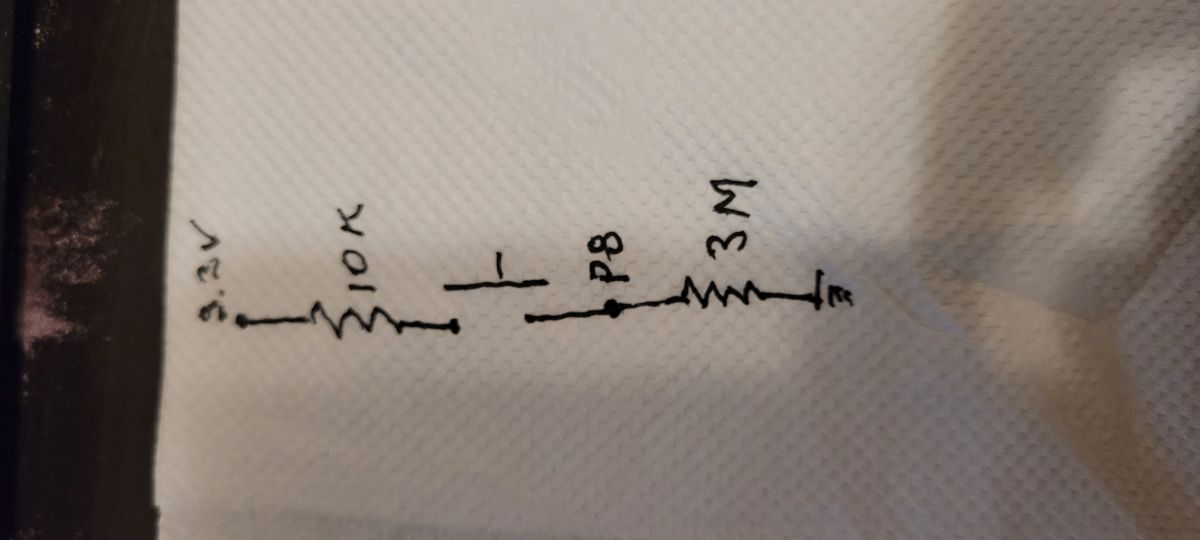

    Hand-drawn electrical circuit with resistors and switch on a white napkin
    This is my chicken-scratch diagram of the sensor connection. Both the _pd and the _nPup drivers seem to work. Which one is the proper one for the diagram I have drawn?
