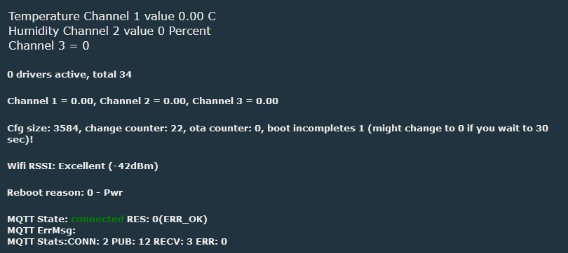

    Hi, I'm struggling with the same device...
    After flashing and getting the config done, I don't get any useful data on any channel... all are set to 0
    [BK7231N] [CB3S] [AHT20] TH01 Generic Temperature and Humidity Sensor Teardown
    Any idea where this effect is coming from?
  • #35 20639749
    Posts: 14750
    Rate: 12866
    Hello, it seems that no drivers are running. What is your current GPIO configuration on the panel?

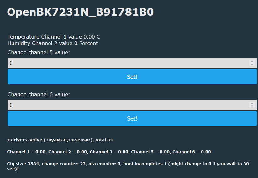

  • #38 20640830
    maxen0815
    Posts: 10
    With the mentioned Autoexec, it seems to load some drivers, but still no values visible...

    #39 20642216
    Posts: 14750
    Rate: 12866
    It is possible that you are approaching it in an incorrect way.
    It seems that you have a TuyaMCU device, a battery-powered one.
    Those devices are always controlled by the MCU. MCU only powers on the WiFi module when it wants to report data, WiFi module then initiates the UART conversation and MCU sends data to WiFi module. WiFi module then reports data to cloud and sends an "I'm finished" packet to MCU, which then turns off the WiFi module again.
    All that is done in order to preserve the batteries.
    If you are powering the WiFi module externally, then you won't get measurement results.
    So I will say this, the approach here is as follows:
    1. Get dpIDs data (or find existing matching config).
    2. Flash OBK.
    3. Power externally WiFi module.
    4. Setup OBK autoexec with dpIDs and channel types.
    5. Pair with Ha, do Home Assistant discovery.
    6. Disconnect external power for WiFi module.
    7. Put in batteries.
    8. Then it should start waking up for itself, for 30 seconds or so, every now and then and report data to your HA.
    Here is my topic about such a sensor:

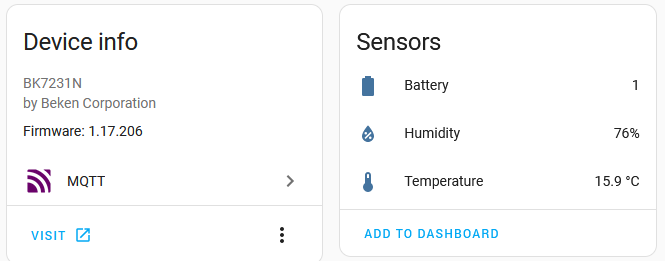

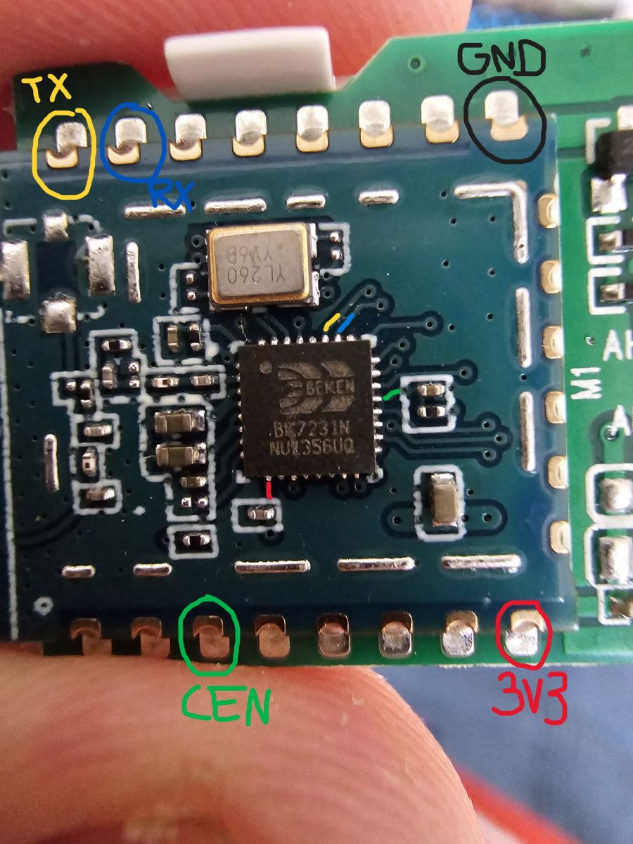

    Hello everyone,
    thank you for this post, which was able to give me the basic information I needed in order to setup this sensor (TH01). With the aforementioned discussion about whether or not to sever some pins or desolder the WiFi module, I want to add some comments.
    I desoldered it for the reason that I was not able to get the device's created WiFi AP up and running long enough to enter configuration - simply because I was not patient enough. It is not necessary, don't do it, you don't need to. It was taking ages to desolder the battery pins, which was necessary in order not to melt the housing for the later-on desoldering of WiFi module with hot air, it's not worth it, I even damaged the housing while desoldering the battery terminals with my iron - a pain. Now, I would like to quickly give you the steps that worked for me.
    I flashed 4 sensors of the same type, and it worked the same for all of them.
    1. have a look at the relevant pins:
    Close-up of a circuit board with labeled TX, RX, GND, CEN, and 3V3 pins.

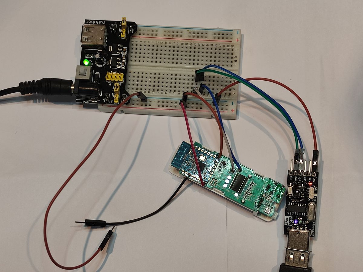

    2. solder 5 indidivual wires to each of those. For TX / RX pins, you can also use the large round test pads on the motherboard, they are easier to access.
    3. connect 4 wires (3.3V, GND, TX, RX) to your USB-UART module, mind the 3.3V setting! make sure to connect TX ---> RX and RX ---> TX! If you want to use external 3.3V power source, connect the ground wire (-) of that source to BOTH our sensor AND USB-UART module.
    4. prepare Windows tool bk7231flasher: download current firmware (7231N!), I also recommend setting "Change OBK settings for flash write", this way you can already enter your WiFi credentials and mqtt data. Also, here you can already set the flags (I only used flag 10) and enter the startup code that is required for this module
    [backlog startDriver tuyaMCU; startDriver tmSensor; linkTuyaMCUOutputToChannel 1 val 1; setChannelType 1 temperature_div10; linkTuyaMCUOutputToChannel 2 val 2; setChannelType 2 Humidity;linkTuyaMCUOutputToChannel 3 val 3; setChannelType 3 ReadOnly;]
    so all that's left to do after flashing is to double check all the name settings and start Home Assistant discovery via the web interface.
    (--> If the startup command doesn't work later on, you need to enter it again via web interface. If there is no button to submit, it might be necessary to clear OBK config via web app command, after that you can re-enter new startup command)
    5. Now connect USB (and then external power if you use it) and wait a moment for it to show up in UART port. Also, give the module few seconds to power on. Don't forget to select "Automatically configure OBK on flash write" if you chose this setting in step 4
    6. Now make sure correct firmware is selected and then start process "Do backup and flash new", confirm dialogue and wait for log window to show waiting status. Now shortly (!) connect the end of CEN-wire to one of your GND terminals (just touch it and immediately release again), it will reset the device and reading/writing should start without any error messages. If you get any crucial error message, make sure to repeat step 5 and wait a minute before you start read/flash process. It worked for all my 4 sensors without exception.
    7. After successful flash, disconnect the module first. Then the important part in order to make the WiFi-connection work: connect only 3.3V and GND (doesn't matter where from) to the wires that are still attached, to power the device on again. Now, wait patiently! WiFi will pop up few times, after few minutes it will be stable! Either way, as AP if not preconfigured, or already in your router with new IP address. Then open web interface, finish configuration (HA discovery, names, startup command etc), and before you desolder the wires, pop in batteries and test if it still works. After disconnecting wires it will be annoying to acces the web interface - yet it is possible by either keeping the module's button pressed or press it down continuosly in 2 second intervals or so.
    Result in HA:
    Device info panel for Beken BK7231N and sensor status: battery, humidity, and temperature.
    (it was raining a lot here today, we can see it 😅 )
    Good luck!

  • #44 20845229
    emrecetinkaya86
    Level 4  
    Posts: 8
    Hi,
    I don’t get any battery state. Is it not a feature of the device or am I missing something?
    Thanks
  • #45 20845231
    Posts: 14750
    Rate: 12866
    What is your device configuration? You will not get battery state entry unless you configure it
  • #46 20845669
    emrecetinkaya86
    Level 4  
    Posts: 8
    Hi,
    I just added those to startup commands, do i need to add anything for battery?:
    Kind regards
  • #47 20845707
    Posts: 14750
    Rate: 12866
    So channel 3 is battery level? As in Low-Mid-High?
    So change:
    To:
    setChannelType 3 LowMidHigh;
    See channel type docs at:
    https://github.com/openshwprojects/OpenBK7231T_App/blob/main/docs/channelTypes.md
  • #48 20845783
    emrecetinkaya86
    Level 4  
    Posts: 8
    Ok i will. Thank you very much!
  • #49 20845795
    Posts: 14750
    Rate: 12866
    Keep in mind that you need to redo HASS discovery after changing the channel type.
  • #50 20845859
    emrecetinkaya86
    Level 4  
    Posts: 8
    I did and also HA discovery. The 3rd channel's value is either 0, 1, or 2. I think it's equal to low-mid-high.

  • TuyaMCU mapping for TH01 temperature and humidity sensor
    #55 20904927
    sevastianovv
    Posts: 8
    startDriver TuyaMCU
    // may be needed, depends on device, some also use 9600
    tuyaMCU_setBaudRate 115200
    // dpID 1 is tempererature div 10
    // dpID 2 is % humidity
    // dpID 3 is battery state - low(0), mid(1) and high(2)
    linkTuyaMCUOutputToChannel 3 enum 3
    setChannelLabel 3 Battery
    // setup dpCache - temperature interval
    // Show textfield for that
    setChannelType 5 TextField
    // setup display name
    setChannelLabel 5 Temperature Interval
    // Make value persistant (stored between reboots),
    // start value -1 means "remember last"
    SetStartValue 5 -1
    // set default value if not set
    if $CH5==0 then setChannel 5 1
    // link dpID 17 to channel 5, the type is val, extra '1' means that its dpCache variable
    linkTuyaMCUOutputToChannel 17 val 5 60
    setChannelType 6 TextField
    setChannelLabel 6 Humidity Interval
    SetStartValue 6 -1
    if $CH6==0 then setChannel 6 1
    linkTuyaMCUOutputToChannel 18 val 6 60
    12:35:37 917		BK7231N_8587000B2/6/get	0.000000
    12:35:36 931		BK7231N_8587000B2/5/get	0.000000
    12:35:35 927		BK7231N_8587000B2/3/get	1.000000
    12:35:34 934		BK7231N_8587000B2/2/get	20.000000
    12:35:33 922		BK7231N_8587000B2/1/get	26.200000
    12:35:32 925		BK7231N_8587000B2/ip	192.168.1.213
    12:35:31 937		BK7231N_8587000B2/freeheap	73024
    12:35:30 932		BK7231N_8587000B2/uptime	12
    12:35:29 935		BK7231N_8587000B2/rssi	-55
    12:35:28 935		BK7231N_8587000B2/sockets	2
    12:35:28 294		BK7231N_8587000B2/ssid	434343434
    12:35:27 734		BK7231N_8587000B2/3/get	1.000000
    12:35:27 526		BK7231N_8587000B2/2/get	20.000000
    12:35:27 310		BK7231N_8587000B2/1/get	26.200000
    12:35:26 951		BK7231N_8587000B2/mac	a0:92:08:89:87:89
    12:35:25 933		BK7231N_8587000B2/build	Build on Jan 4 2024 11:21:20 version 1.17.391
    12:35:24 935		BK7231N_8587000B2/host	obkN_8587000B2
    12:35:24 301		BK7231N_8587000B2/connected	online
