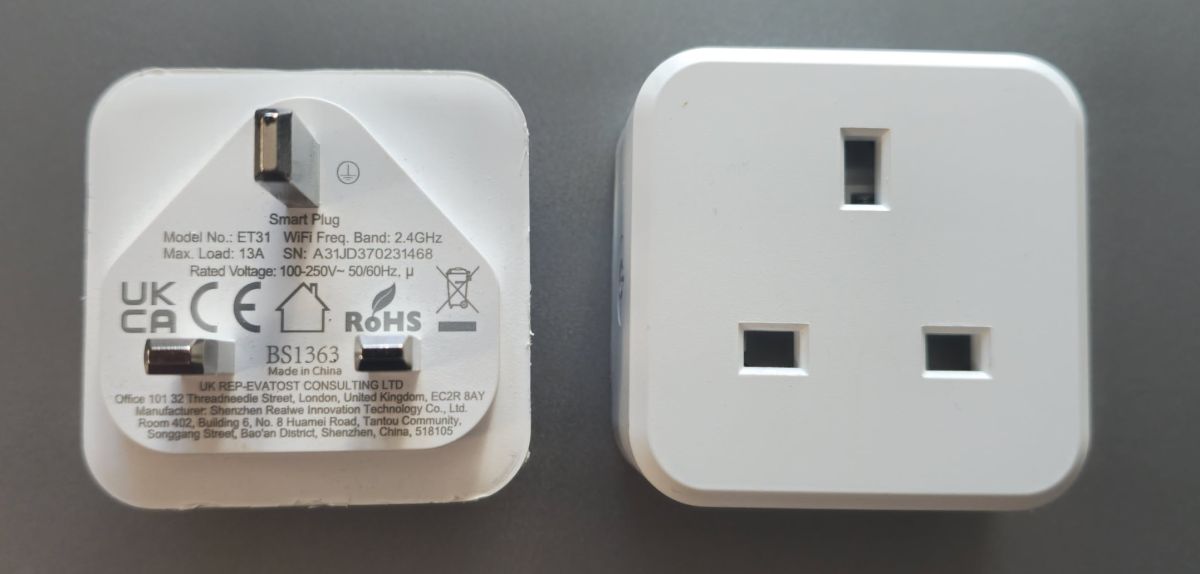

    Two white smart WiFi plugs with UK Type G pins and sockets
    Description
    It plugs into a mains UK socket using the pins to the left in the picture below, then allows plugging in another device into the opposite end, to the right of the picture above.
    You may then switch power off to the tethered device using the relay switch to the left side of the plug, as seen after plugging in. Also, after registering the device in the SmartLife app ("SmartLife - Smart Living" by Volcano Technologies Limited on PlayStore), you may connect the device to your account to trigger it remotely on demand, or on a timer or other events and to monitor power usage. You may then, also, connect the SmartLife account to your HomeAssistant instance for further integration - it works alright, just don't enjoy having to register them through another app. I knew this before purchasing, but have purchased it in hopes of being compatible with OBK, which I've found it was, only after cracking it open.

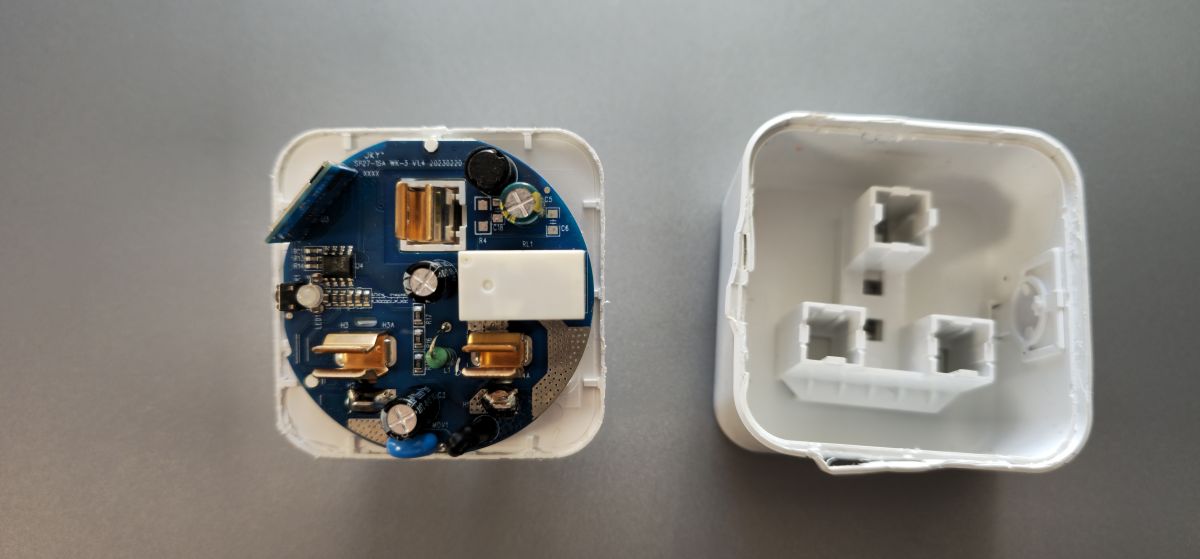

    After making a mess of it and ruining a few blades and my fingers, the assembly separated into the empty shell on the right below, and the electronics attached to the prongs, pictured left below.
    Disassembled electric plug showing a circuit board with electronic components

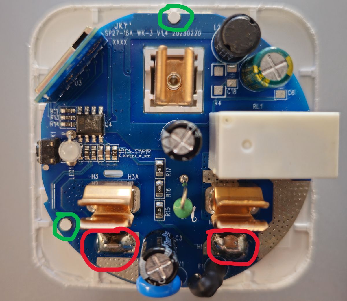

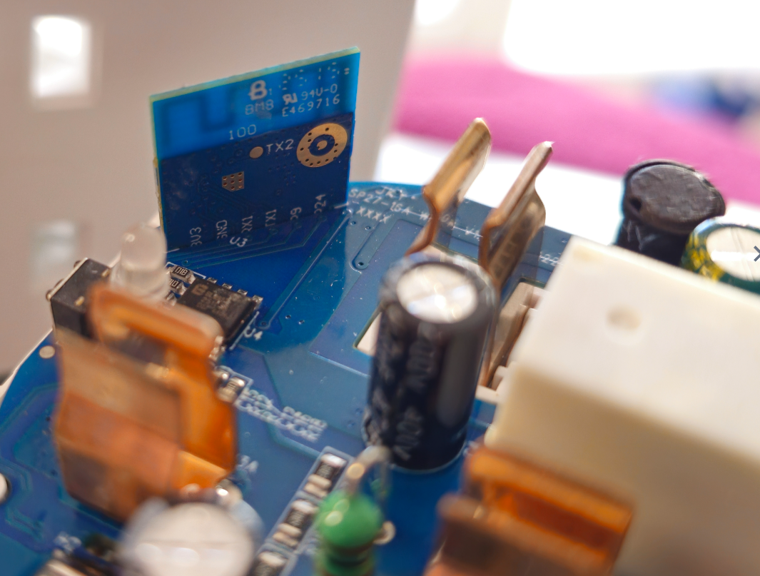

    Once open I could see a mainboard onto which another board was attached, perpendicular to it, let's call it mini PCB. However, to access the pins, the board had to be taken out of the case.
    After warming up and reshaping the plastic rivets out of the way(circled green below), I started by applying heat heavily to the N and L pads (circled red).
    After many attempts with a desoldering pump and copper braid I've managed to wick out the solder from around the two joints, and was able to lift the main PCB out.
    Interior of electronic device showing PCB with marked components and burn marks
    Some of the pin names were partially showing where the main and mini PCBs met, however, the rest of the pins were on the opposite side, covered by a shield, which had to come off the mini PCB.

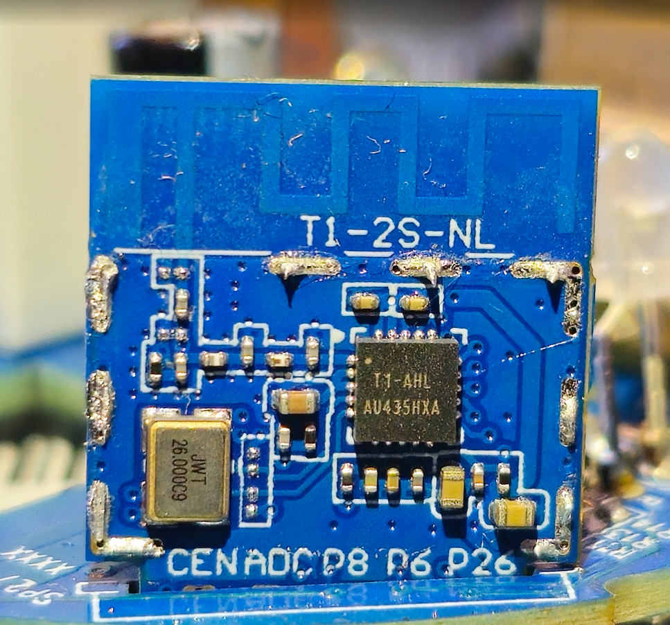

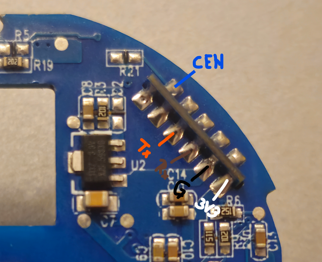

    Pins
    The mini PCB was sticking out through the bottom of the main PCB exposing 6 pins on the inner face, 5 pins on the outer face, in a zipper/staggered pattern between the two faces.
    Inner3V3
    GNDRX1TX1P9
    P24
    OuterP26P6P8ADCCEN

    I then soldered some Dupont male to male wires to the pins underneath: 3v3, GND, RX, TX, CEN(opposite side).
    I have connected the 4 wires to the breadboard: 3v3 to the positive rail, GND to the negative rail, RX, TX to their own ranks.
    The 5th wire, CEN, was left loose for now; I will connect it to the GND rail at some point further down.
    To each individual ranks I have added male to male wires (the serial adapter came with its own female to female dupont "loom").
    I have connected RX(mini-PCB) to TX(serial adapter) and vice versa, then 3V3 to 3V3 and GND to GND.

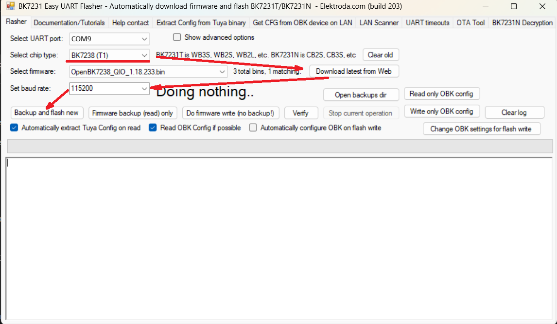

    After launching the flash tool I could see that it was showing the correct COM port (confirm in Windows Device Manager).
    Flashing
    At this point there was a series of struggles either due to connecting the wire incorrectly, having a loose connection(before settling on my rubber bands + breadboard solution), setting the wrong chip type, baud rate. But I have eventually found that the below worked for me.
    I have picked BK7238 (T1) as chip type and baud rate of 115200.
    I was offered to download the latest firmware for the chip from the web; followed the instructions and was ready to flash.
    If you click out of it, you can achieve the same with the button 'Download latest from Web'.
    BK7231 Easy UART Flasher interface with COM9 port and selected firmware for flashing.
    With the serial adapter powering on the mini PCB and hooked up to RX/TX, I have started the process.
    After clicking 'Backup and flash new', the console started showing showing messages and it will also indicate it's time to trigger the device.
    At this point I have connect the loose CEN wire to GND rail and kept it connected throughout the flashing process.
    [size=12]I have read that you are meant to only touch CEN to GND for 0.25s at boot, but that did not work for me, however, keeping it solidly connected throughout worked ok.[/size]
    It should start reading to create a backup, which can take between 3-5minutes, then move onto flashing the new firmware, which can take around the same amount of time.
    If reading or writing stops and appears to not progress for extended periods of time, ensure that you have a solid connection on the wires - this is what drove me to strapping the thing to the PCB with rubber bands.

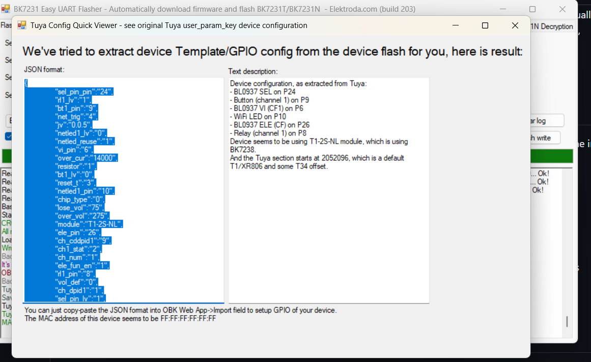

    Once done, I got this screen showing some useful info which helped me configure the device after flashing:
    Screenshot showing Tuya device GPIO config in JSON format using BK7231 Flasher

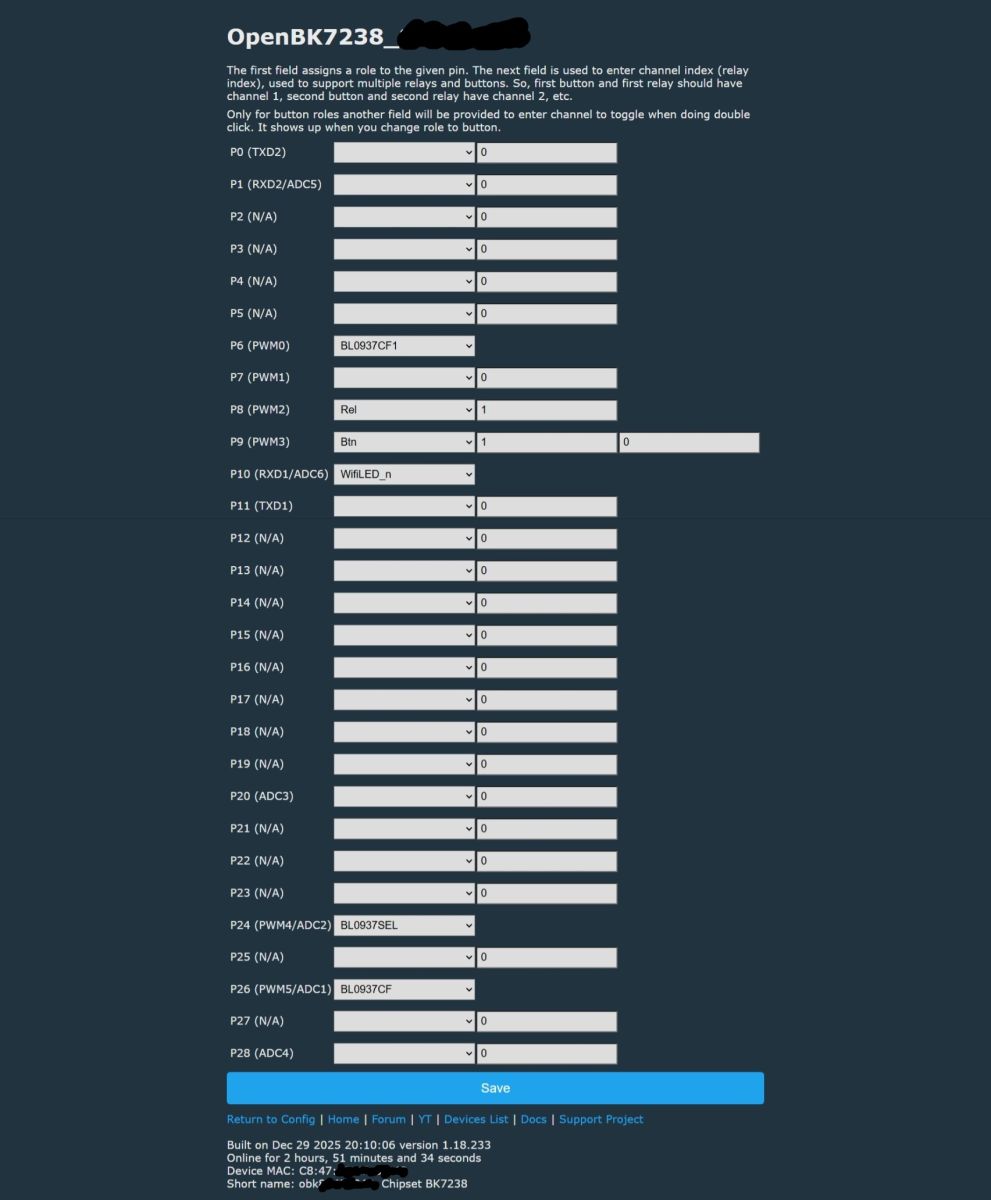

    I have located the device on my main network, and navigated to its config page (i.e. http://192.168.0.189/cfg) where I was able configure the module with the info shown to me at the end of the flashing process.
    OpenBK7238 device pin configuration with assigned roles and channel numbers
    I have then restarted the device (disconnect 3V3, reconnected), saw the LED switched on, still connected to network.

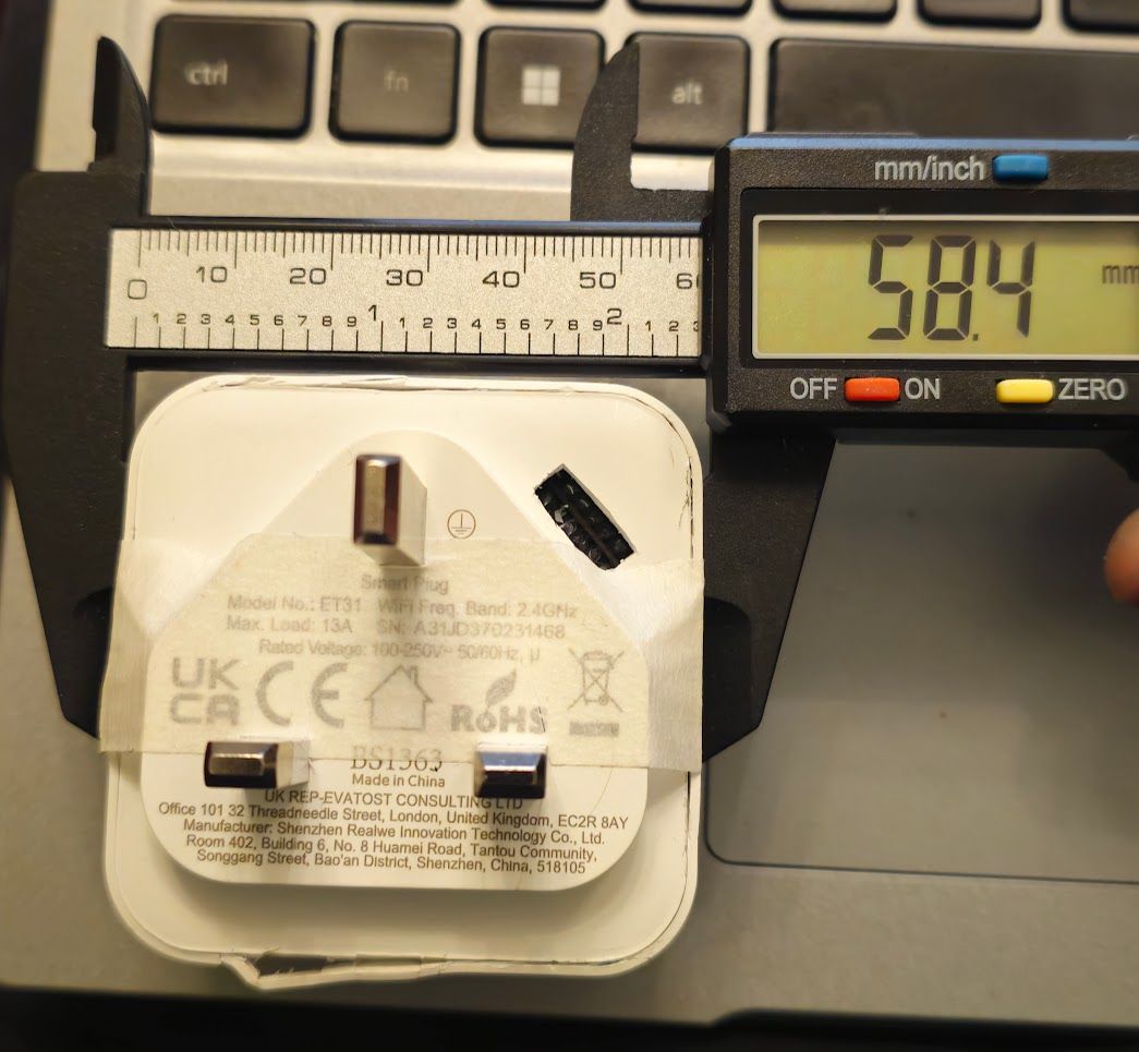

    A less destructive way of doing this
    I have 3 others I am looking to flash, but would prefer not to completely mangle the way I did this one.
    Instead, I plan on cutting a slot that will expose the pins. Ideally, with a heated blade. Cutting it with a cold knife would set bits of plastic loose through the case.
    Knowing the position of each pin, I hope I can simply poke the pins with needles through that slot. With Dupont wires soldered to each needle, I can then flash my device with minimal amounts of mangling.
    I'm not quite there yet, but I'll share should this concept materialise.
    I believe the size of the slot pictured below (to the right of the earth prong).should do as I can see all the pins looking straight down in.
    Hoping the picture below with a scale  next to it will help align the cut better, should anyone decide to try this.
    Measuring a non-mangled unit gives 58.1 mm height and width, whereas, the one I've messed with measures an extra 0.3mm (below).
    UK smart plug measured with digital caliper, display shows 58.4 mm

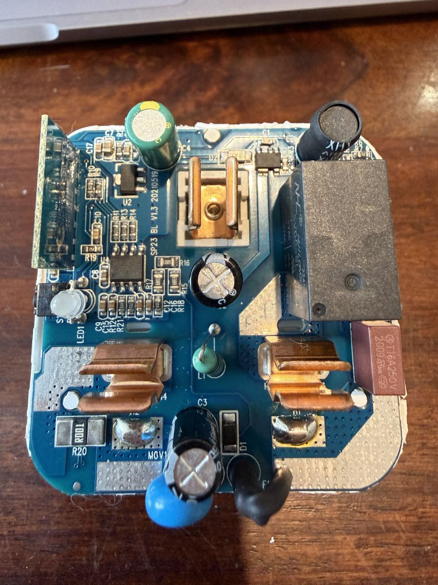

  • Different ET31 internals use SP23 board and RTL8720CF module
    #3 21839208
    RK77
    >>21799097 Hi vargabp, great teardown, thank you. I had a few of these Eightree model ET31s too. Just to note for anyone following, although completely similar externally, the internals of the switch I chose to disassemble are different - a square circuit board, interestingly marked SP23, rather than your round one which I can see is SP27, Eightree some sort of partnership with Teckin?? Unfortunately that would mean that your non-destructive hack wouldn't work in my case (though the same approach with a vertical window slightly to the right of the picture would work). Also the wifi module is marked T112B with a W701 chip which is based on a RTL8720CF. I can get a boot log download but, sadly, I haven't got it to flash yet. This page might also be
    PCB of a smart switch with relay, capacitors and an edge-mounted module, photographed on a wooden table
    helpful for anyone in the same boat! https://www.elektroda.com/rtvforum/topic4040036.html

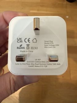

    So the external form of the plug is the same with some different screen printing on the base (photo attached). It still identifies itself as an 'ET 31' and 'Etavost consulting' appear to have made the run, up or down the M4 between my model and yours, so some time must have passed between them. The MAC addresses might be the easiest 'tell' as mine is an RTL wifi board not a 7328, so they should be quite different - I have four and they are all 1C:90:FF etc which is (unsurprisingly) allocated to Tuyasmart. I got the board off the pins without too much trouble and just to make my attempts to flash the device easier I removed the wifi board too. The pins are a completely different arrangement where you have to hold two key pins high, rather than low, to get into programming mode. Pin A13 is on the board would be accessible from a hole cut the the base, but, disappointingly, you also need to rail GPIOA_0 which is only available as a pad on the rear of the card. BTW Have you noticed SmartLife sent through an update for these sockets which removes the 'quickflash' update mode - that's what prompted me begin reprogramming the ones I have. Again, thank you for the resource, it was really useful.
    Back of a white UK smart plug with three pins and printed compliance labels
