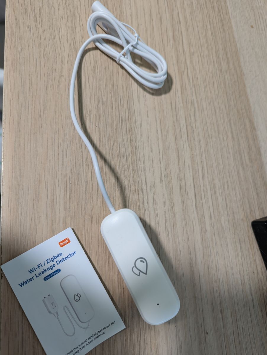

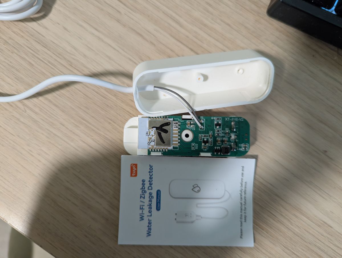

    Hello. Submitting a teardown. Wi-Fi water leakage detector/sensor.
      "vendor": "Tuya",
      "bDetailed": "0",
      "name": "XT-V2",
      "model": "xt-v2",
      "chip": "BK7231N",
      "board": "TODO",
      "flags": "1024",
      "keywords": [
        "xt-v2",
        "wi-fi water leakage",
        "leakage detector"
      "pins": {
        "16": "dInput_NoPullUp;1",
        "17": "BAT_Relay;4",
        "20": "dInput_NoPullUp;2",
        "23": "BAT_ADC;4",
        "26": "WifiLED_n;3"
      "command": "",
    autoexec.bat:
    // Powersave mode
    // powersave 1
    //Battery config
    startdriver battery
    Battery_Setup 2200 3000 1.6 2400 4096
    //measure batt every 2s
    Battery_cycle 2
    //mqtt_broadcastInterval 1
    //mqtt_broadcastItemsPerSec 5
    setChannelLabel 1 Water
    // now wait for MQTT
    waitFor MQTTState 1
    // extra delay, to be sure
    delay_s 1
    // publish water state at least once after boot
    publishchannel 1
    DSEdge 0
    // All good, sleep for 1 day or next water event after 60s
    delay_s 60
    PinDeepSleep 86400
    Images attached.

    groove6j
    Posts: 52
    Rate: 13
    >>21868506
    Oh, yes. Looks like it. At first I thought it is different, but all the pins could be found in its firmware! And turns out they are the same.
