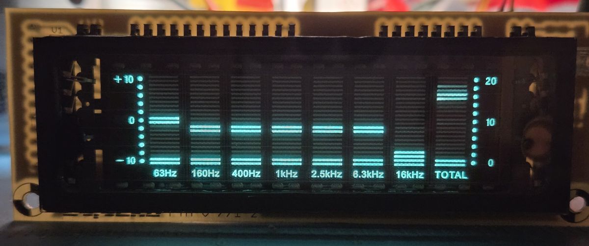

    James596 wrote:
    It works just like in the old towers with VFD displays
    The VFD is a different look though, in my opinion it has a bit more charm.
    Below is my retro fun with the VFD analyser:
    Turquoise-lit VFD display showing an audio spectrum analyzer with side level scales Turquoise-glowing VFD display with spectrum analyzer bars and frequency band labels

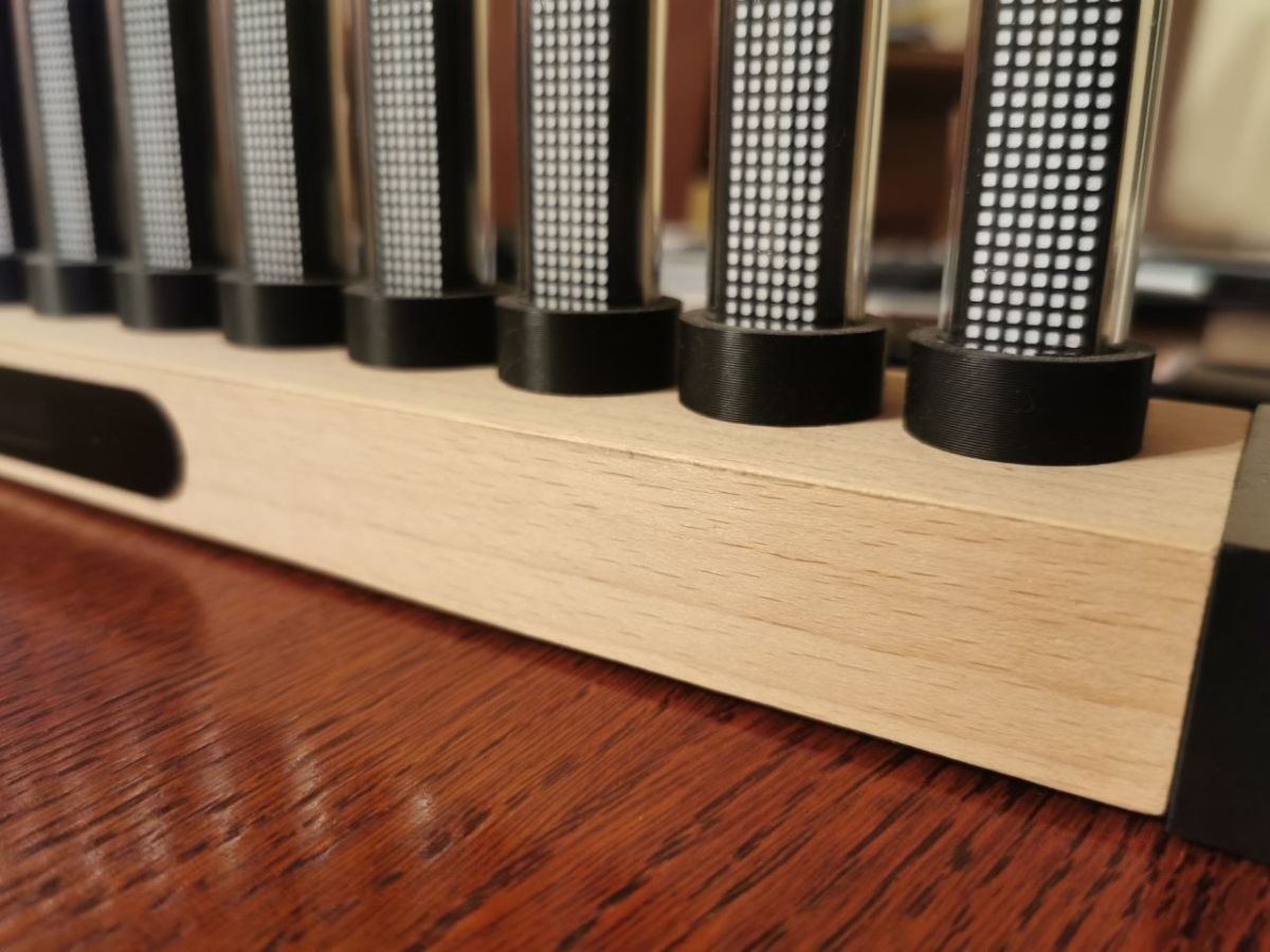

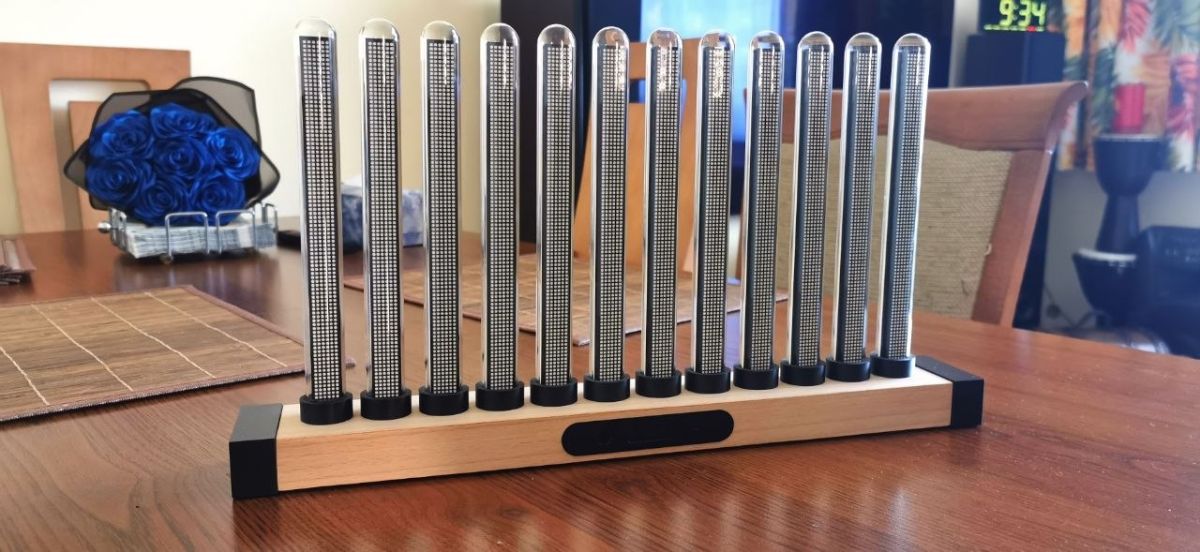

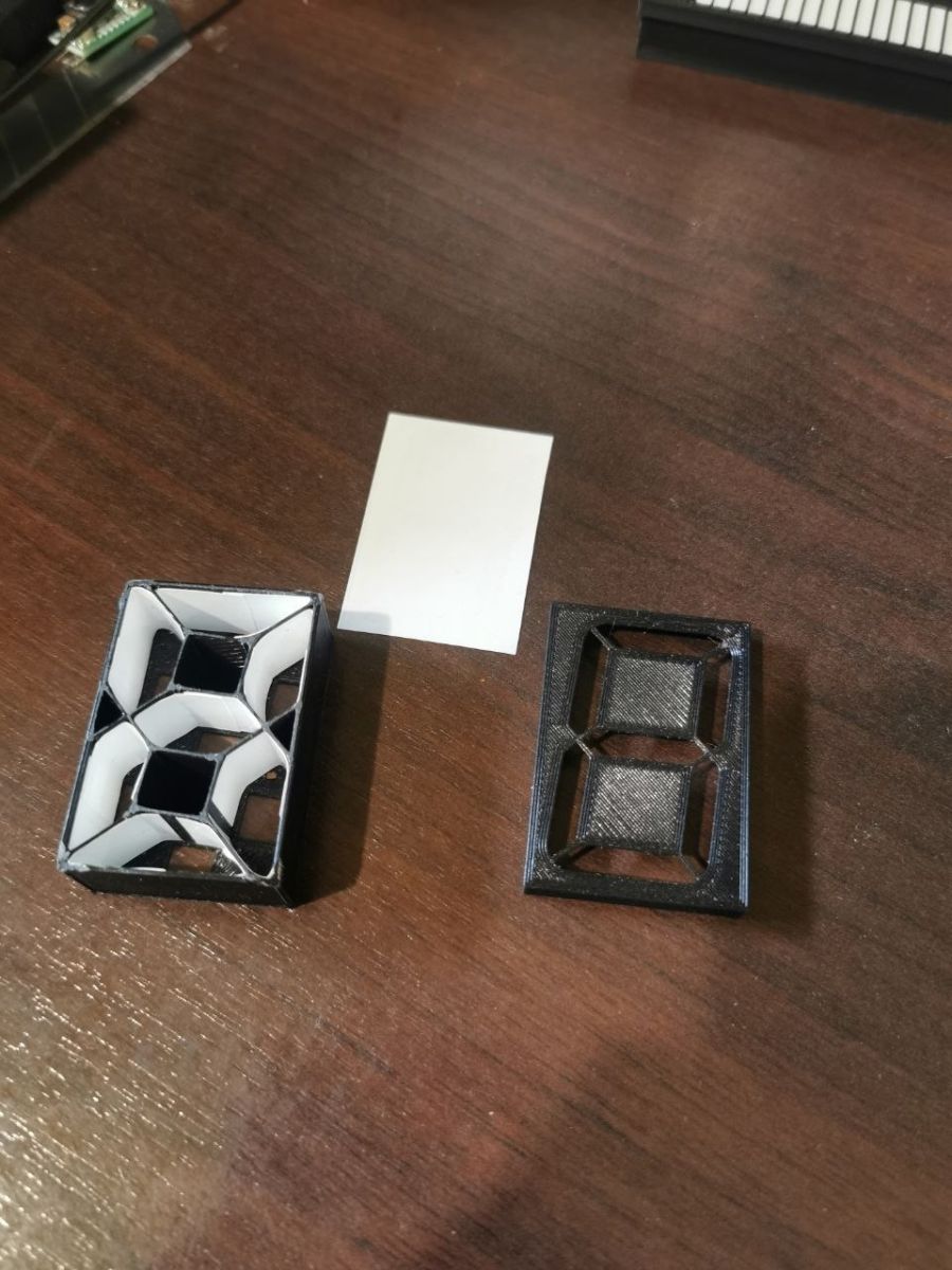

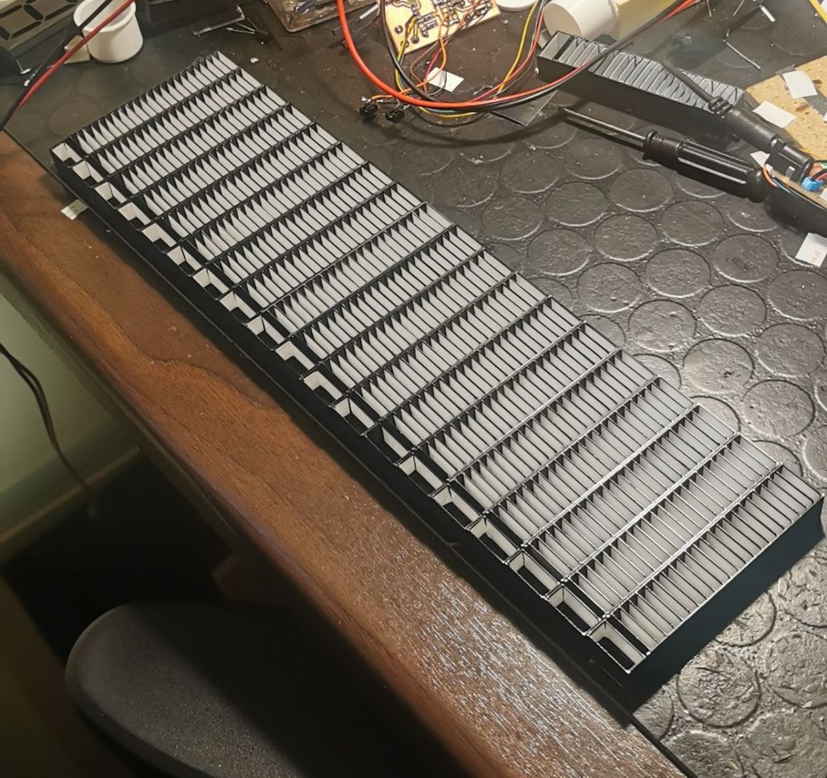

  • 3D-printed enclosure and SK6812 LED spectrum display
    #101 21905489
    efi222
    Level 22  
    Posts: 773
    Help: 12
    Rate: 1212

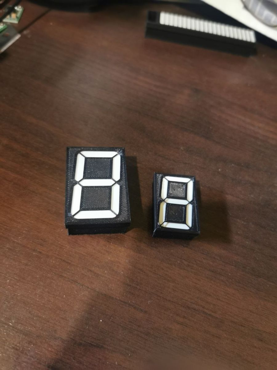

    More and more DIYers are sourcing a 3D printer. This project is a budget device that can be built by anyone with a printer and... an iron :) And as someone wrote here earlier, there's no space technology here. Admittedly, I once encountered a statement on Elektroda that 3D printing is not DIY.... I reply: if this person thinks that such an enclosure will be taken off the printer's table then good luck:)
    VFDs have their charm undeniably. However, there is often a sentimental feel reminiscent of a bygone era. Although these displays seem to be used in current hardware productions too.
    As for the movement of the bar in the spectrum, @398216 Usunięty presented the mathematical dependencies of this movement in some of his articles.
    I set it "by eye" :)
    VFD , TFT and then there is LED. I really like designs with LED. This optoelectronic element is very fast compared to the rather slow TFT. A different approach to animation.
    As an example, I attach a video of a full-size (436mm wide) spectrum on addressable SK6812 mini-E LEDs - for Denon equipment. Yes - I am a post geek :D
    The video is from a later stage of construction. Sorry for the background :)
    And in this case, without a 3D printer, no go. The pole displays need to be (manufactured).
    I don't know why the sound jitters a bit on Chrome PC. On android devices it is ok.

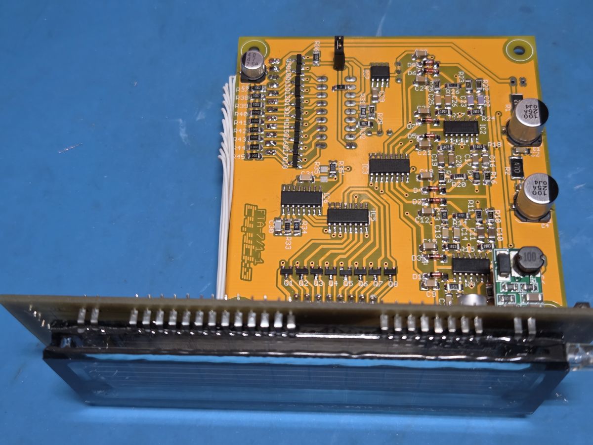

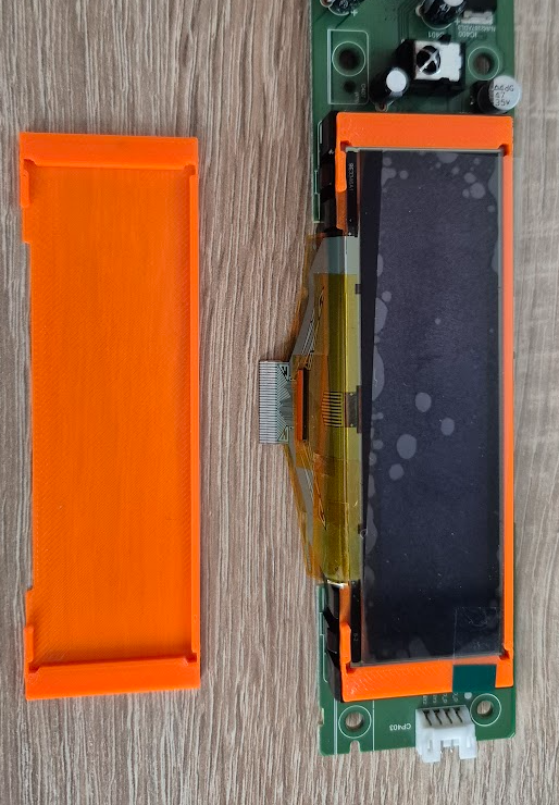

  • Long-owned Sony MD/CD analyser awaiting power-up
    #104 21905668
    ArturAVS
    Moderator
    Posts: 26330
    Help: 2300
    Rate: 7814
    I have had this analyser for over 20 years. Mainly because of the equalizer, the analyser itself is a secondary function. The sentiment remains, and it sits waiting to be rechambered. A Sony MD/CD, it blended nicely with the other components of the set. The only thing I did after getting it was to remove the plastic filters from the display. Last year, just before BN Christmas, I was visited by a friend from whom I had 'acquired' it. -And you still have it! -How much do you want for it! When I get it up and running, (I don't know if it works, it's been a long time since it was switched on) I'll make a video of it working especially for you @efi222.
  • #105 21905673
    efi222
    Level 22  
    Posts: 773
    Help: 12
    Rate: 1212
    ArturAVS wrote:
    specially for you @efi222 , I will record a video of his work
    Super thanks :)
  • #106 21905679
    ArturAVS
    Moderator
    Posts: 26330
    Help: 2300
    Rate: 7814
    You will have a comparison of how the "bars" for the VFD work. The Audio track, is completely analogue, bandpass filters on LM324, + some "digital" to control the display itself (multiplexing etc).
    I haven't modified anything in it (apart from these filters). On the electronic side, factory.

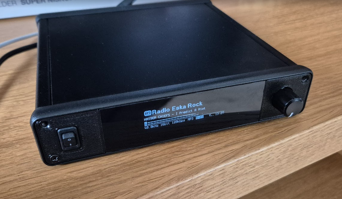

    DIY micro tower (desktop version) DIY micro tower (desktop version)
    >>21905664 Not that much. I have somewhere an old kit for assembling just such an analyser from the TODAKS company. A few amplifiers at a time. Simple design, I will find it to run :)

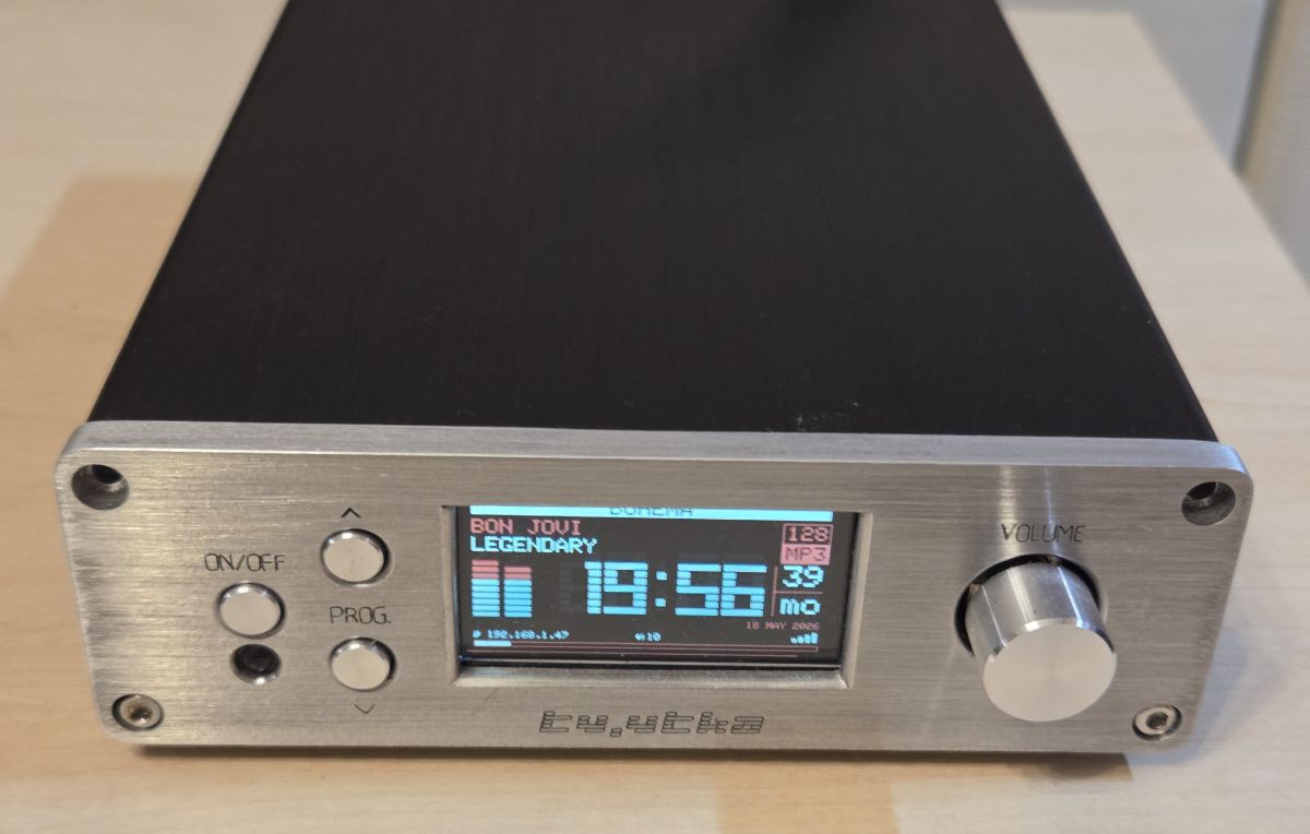

    robgold wrote:
    A rather cool combination is the alu profile enclosure plus its own printed panel front. It is such a combination of a certain amount of elegance and at the same time the ease of making holes for the display or buttons
    It worked out quite nicely for you,
    I, however, would still stay with the combination of aluminium and aluminium. It is more difficult to make, but it is doable.
    Below is a working photo of my design.
    Brushed aluminum device front with 19:56 display, three buttons, and a volume knob
    And let me assure you that my experience with the prints is unfortunately not off the mark.

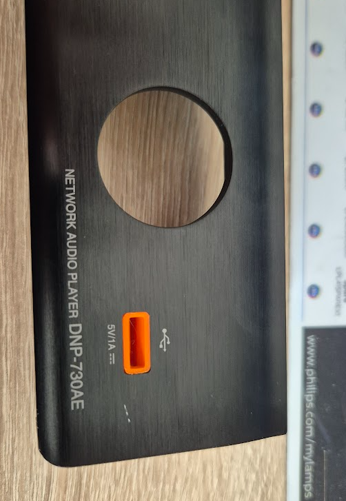

    #109 21905827
    robgold
    Posts: 724
    Help: 10
    Rate: 290
    >>21905784 I'm not saying that alu is bad, because I did exactly the same as you, well maybe only the front would not have gone through with me. It had to be anodised on the spot or it had to be milled in such a way as to preserve the original. But time, playing around with the G-code, then setting up the milling machine. I guess as I got older I realised that you can live with print quality. I used to be very annoyed by layer marks. Nowadays, proper textured plates mask a lot and printers with closed heated chambers allow a lot more.
    I need to dust off that CNC and maybe do at least one Evo version in full Alu. You have encouraged me ;)
    Unquestionably being made in 100% aluminium gives a greater sense of prestige to the machine and quality. There is not even anything to discuss here.
    One more option that the 3D printer has given is the ability to print all the technical mounts in these aluminium housings. You make yourself a mount for an encoder or for a display out of PETG and with a good glue you attach it to the alu front. I think most professional equipment just combines such techniques. Only the simple front is made of brushed aluminium and behind it is a plastic support.
    I have, for example: such a Denon DNP to convert into an Evo. The printer allows you to make the entire SD card slot in a few minutes. The colour is specially designed for prototypes so that any flaws or shortcomings can be seen.
    DIY micro tower (desktop version) DIY micro tower (desktop version) DIY micro tower (desktop version)
    The OLED display has also been whisked away by someone and since it sits there at 3.55 inches and not 3.12 the printer is invaluable for making a proper conversion.
    I'm throwing this in as inspiration, combining multiple processing techniques and materials always gives interesting results.

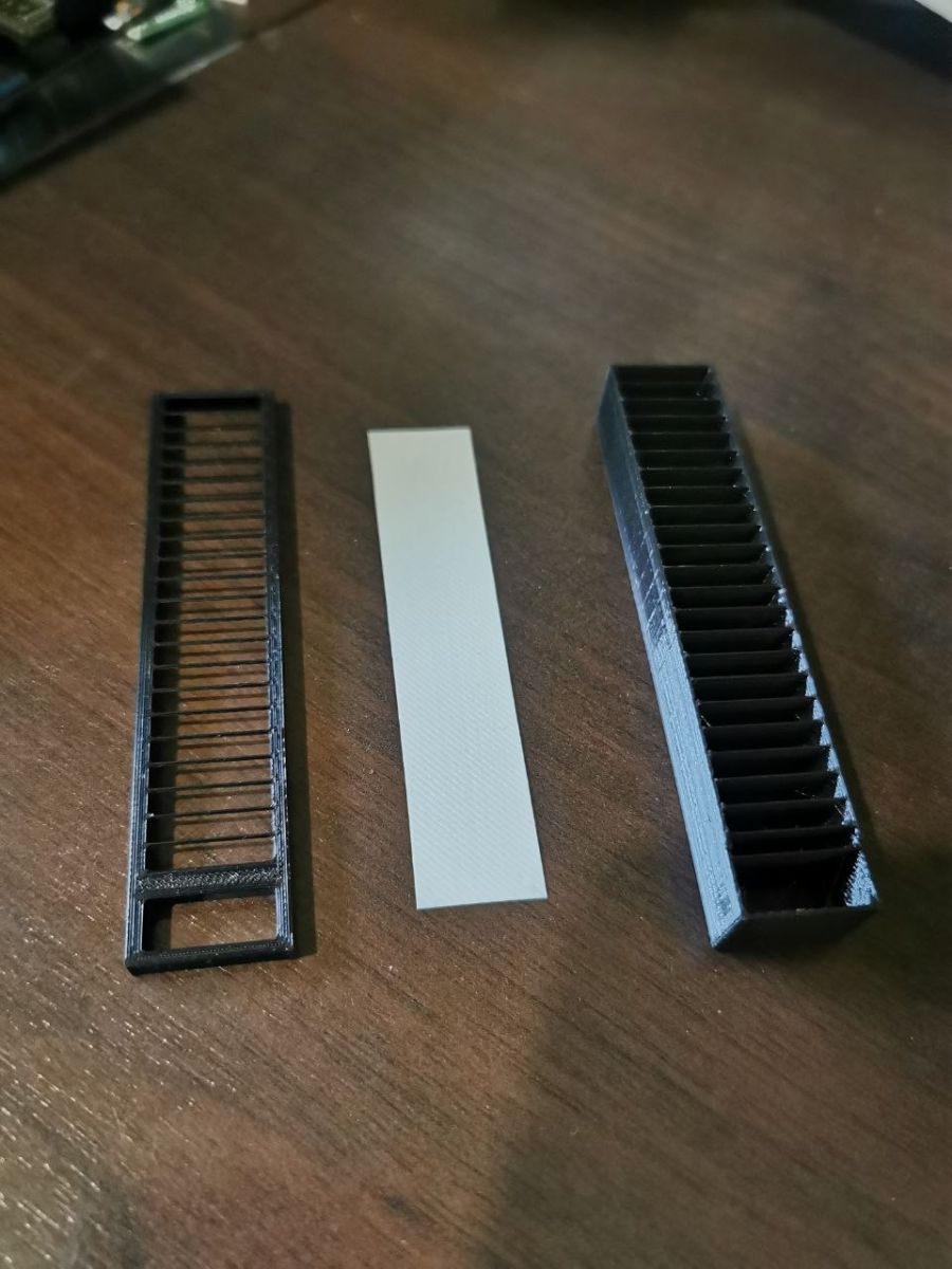

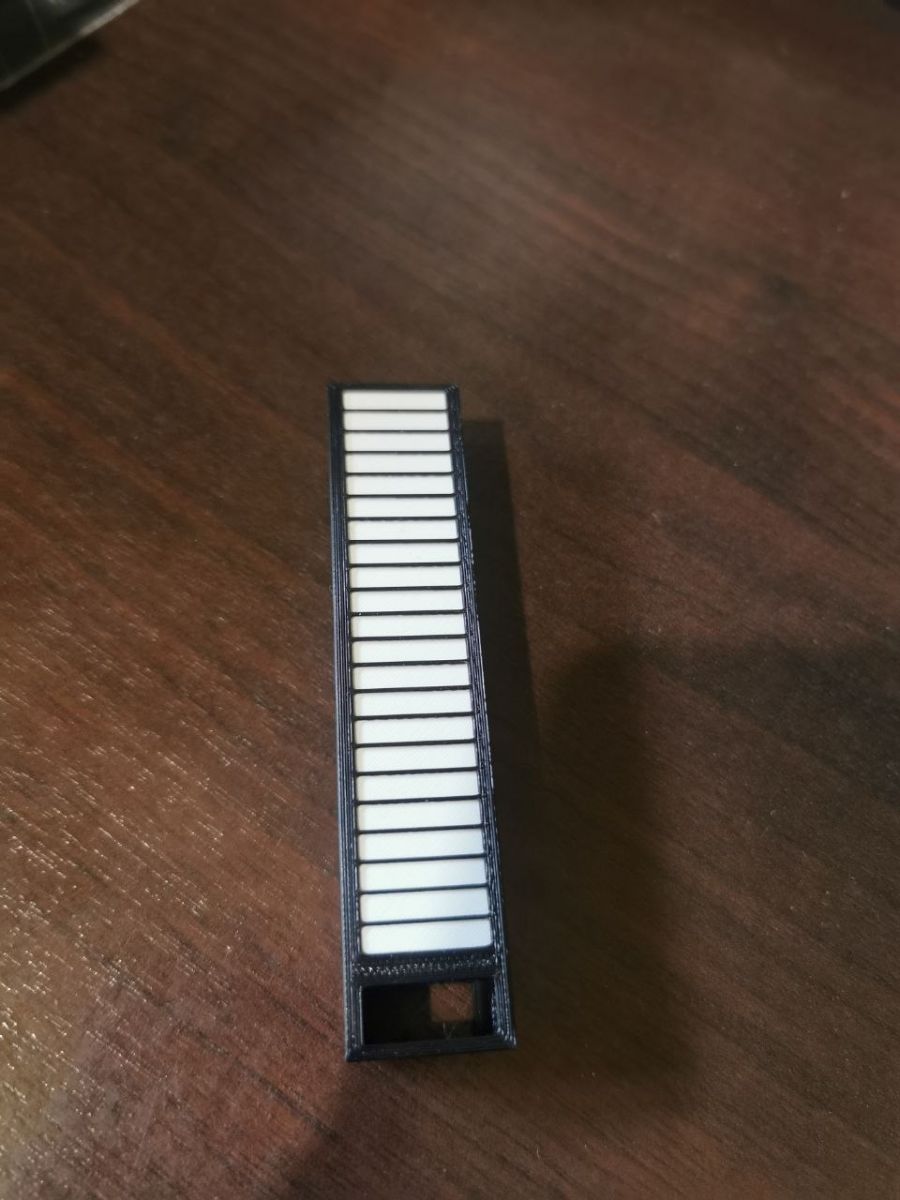

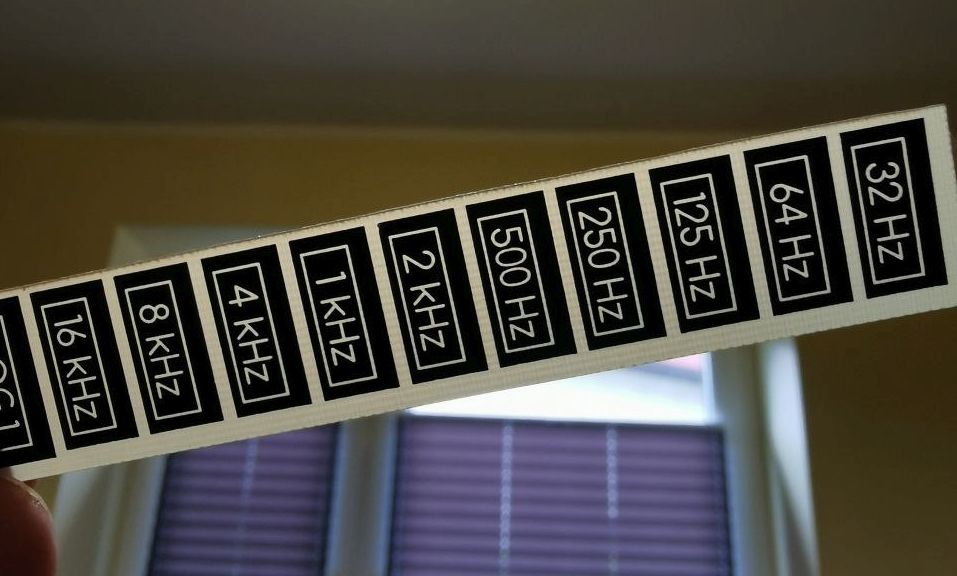

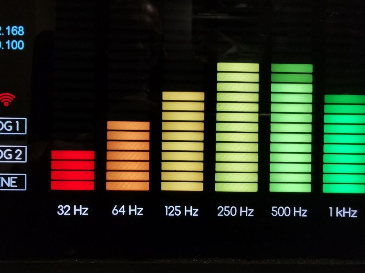

    #110 21905850
    efi222
    Level 22  
    Posts: 773
    Help: 12
    Rate: 1212
    tytka wrote:
    Any move? Are you sure?
    Sorry, but as far as I'm concerned, that's a 3D printer user's opinion though.
    With a bit of ingenuity it is possible to do something similar without printouts.
    Well perhaps I have expressed myself badly. I had already thought about building such a spectrum before I acquired the printer. I am not afraid of various manual works. But unfortunately I had no idea how to make something like this homemade.
    Or else, to achieve this LED masking effect. Pixel size 2.6x14mm
    Colorful graphic equalizer bars labeled 32 Hz to 1 kHz on a black display
    The printer got the job done. This is the effect of the printed LED mask. A fragment of the spectrum presented it above.

    tytka wrote:
    I, however, will still stay with the combination of aluminium and aluminium. It is more difficult to make, but it is doable.
    Beautiful work. In my opinion it would be even more beautiful with a larger window for the display. A larger margin around the display.
    robgold wrote:
    A rather cool combination is the alu profile type enclosure plus its own printed panel front. It is such a combination of a certain amount of elegance and at the same time the ease of making holes for the display or buttons
    Very cool form.

    ArturAVS wrote:

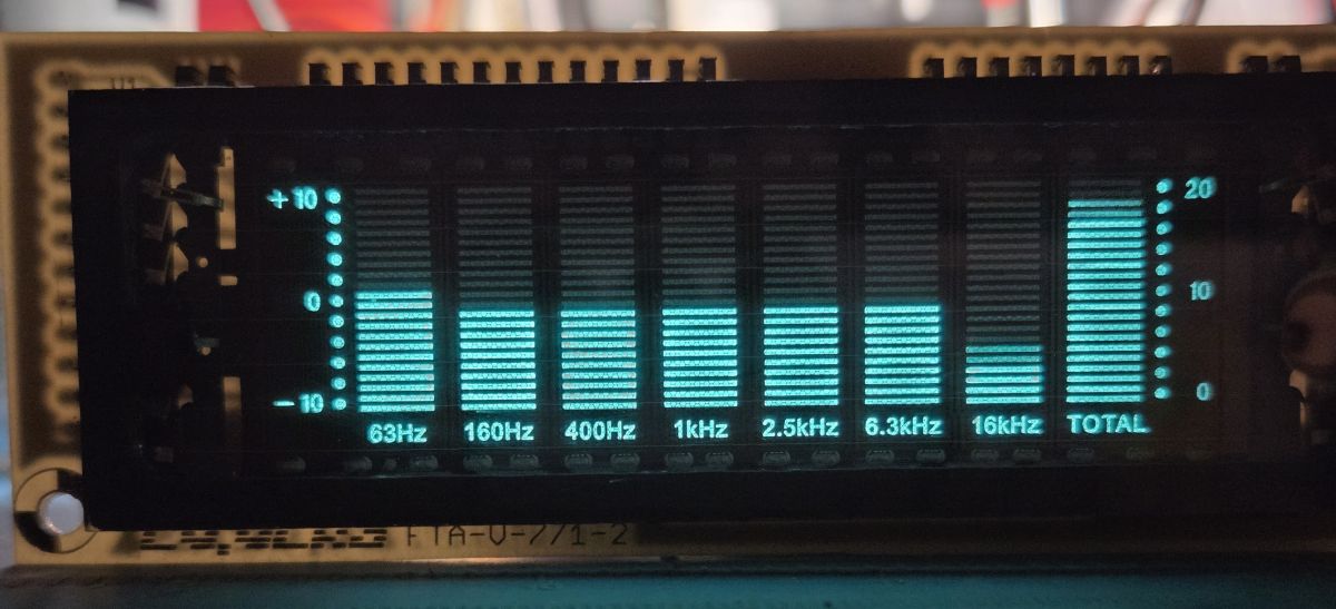

    @efi222 Try making a "lamp" a'la VFD/Nixie on addressable diodes in some kind of test tube.
    As far as the spectrum is concerned, this is the kind of test I was doing (for a colleague):
    Finishing the base with natural veneer:
    And in movement:
    Still, I found a photo of the shut-offs for the LED Spectrum on LED. The compartments had to be lined with white veneer to diffuse the light. Anyone have any idea how to do something like this without 3D printing technology?

    >>21905850 All in all, a lot of work with this decking. Haven't you thought about printing it white and only the fronts possibly painted black or printing the overlays black?
    And how to do it without 3D printing...matchboxes. Such a first thought :D
    Probably some of us have such parts drawers ;)
  • Black filament needed to block light between chambers
    #113 21906104
    efi222
    Level 22  
    Posts: 773
    Help: 12
    Rate: 1212
    robgold wrote:
    Have you not thought to print it white and only the fronts possibly painted black
    The fenders have to be made of black filament. White lets light into the adjacent chamber.
    Pictorial images of one post.

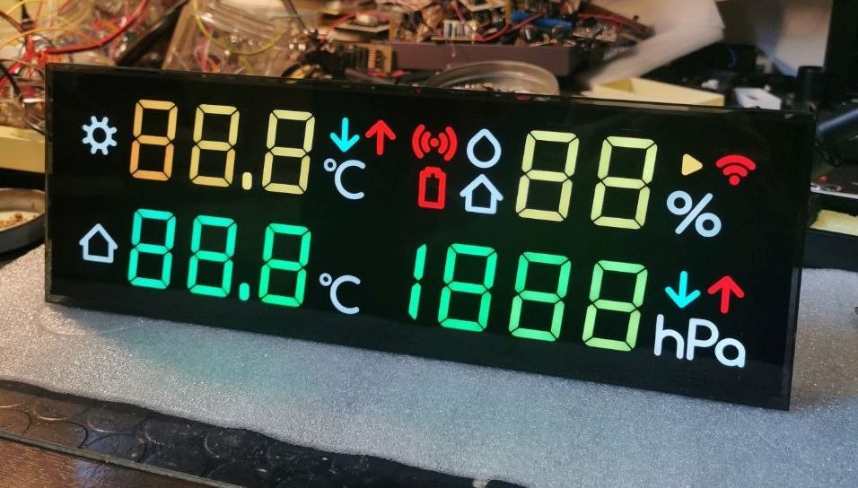

    7 segment digits can also be made
    Two black seven-segment digit modules with white segments on a wooden tabletop
    Weather station made of such figures. Demo mode.
    LED weather-station display with multicolor 7-segment digits and icons on a cluttered electronics workbench
    Illuminated lettering is etched thin laminate.
    Strip with black framed labels and white frequency text (e.g., 16 kHz, 500 Hz, 32 Hz)
    robgold wrote:
    And how to do it without 3D printing...a matchbox. That was my first thought
    Well not that size :D The post chamber is 3x17mm .
    This is often the case, although sometimes the internal support front plate is metal.
    In diy constructions, it can be made from laminate. With this, you can also make the necessary brackets and even mounts for the display. I have personally practised this.
    efi222 wrote:
    Have anyone an idea how to make something like this without 3D printing technology?
    I used to make something similar, but not quite as sizeable. And I made it out of thin laminate and thin copper sheet. At the end it was spray-painted. Unfortunately I don't have pictures of this construction of mine.

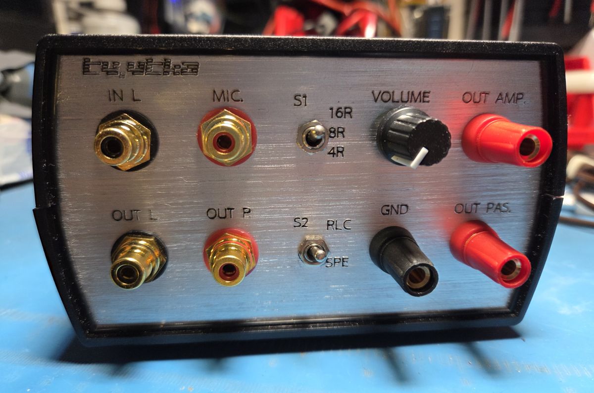

    And regarding applying descriptions to the front panel.
    Below is my attempt today.
    A working device, so it didn't have to look perfect. Universal housing made of ABS. Spray-painted front and laser-burned descriptions. A very soft and fusible material for such a method, but I think it came out tolerably well. Judge for yourself.

    >>21906504 Did you give primer to the plastic under the paint proper? You can see just what you wrote, that the material is very fusible and made mountains from the laser but for a working device it is very decent!
    I've recently become interested in UV printers that can print complete descriptions of fronts. For example: eufyMake UV E1 ...only the price :/
