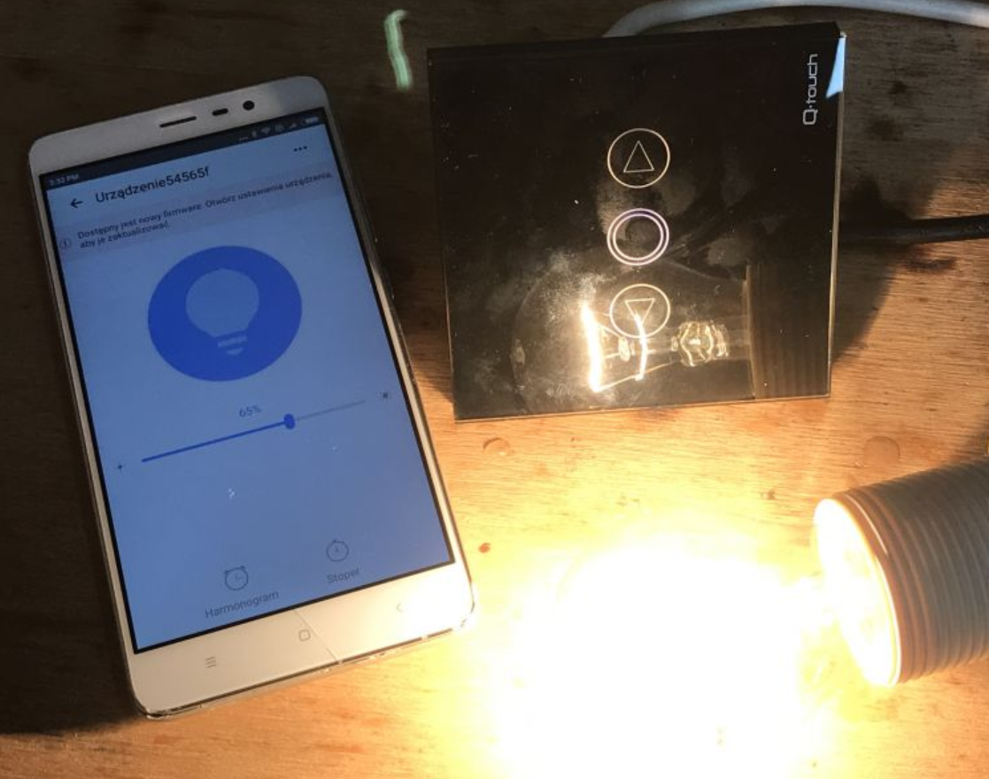

First commissioning .
After assembly (according to the instructions from the website, not the one from the box):
The buttons are illuminated, in my opinion the whole thing is quite aesthetically pleasing and I like it.
The buttons respond quite slowly, but the dimming is smooth, but not from 0.
Pairing with eWeLink app and phone control .
Before pairing, put the unit into RESET mode by pressing the button for a long time (until it starts flashing rapidly in blue).
Pairing works in "Quick Pairing" mode.
Pairing requires the SSID and password of our WiFi (2.4GHz only supported).
I have covered the Smart device applications in detail in previous topics in this series.
Step-by-step screenshots of the pairing:
The application offers an interface as below (you can control the brightness with a bar, from 1% to 100%):
