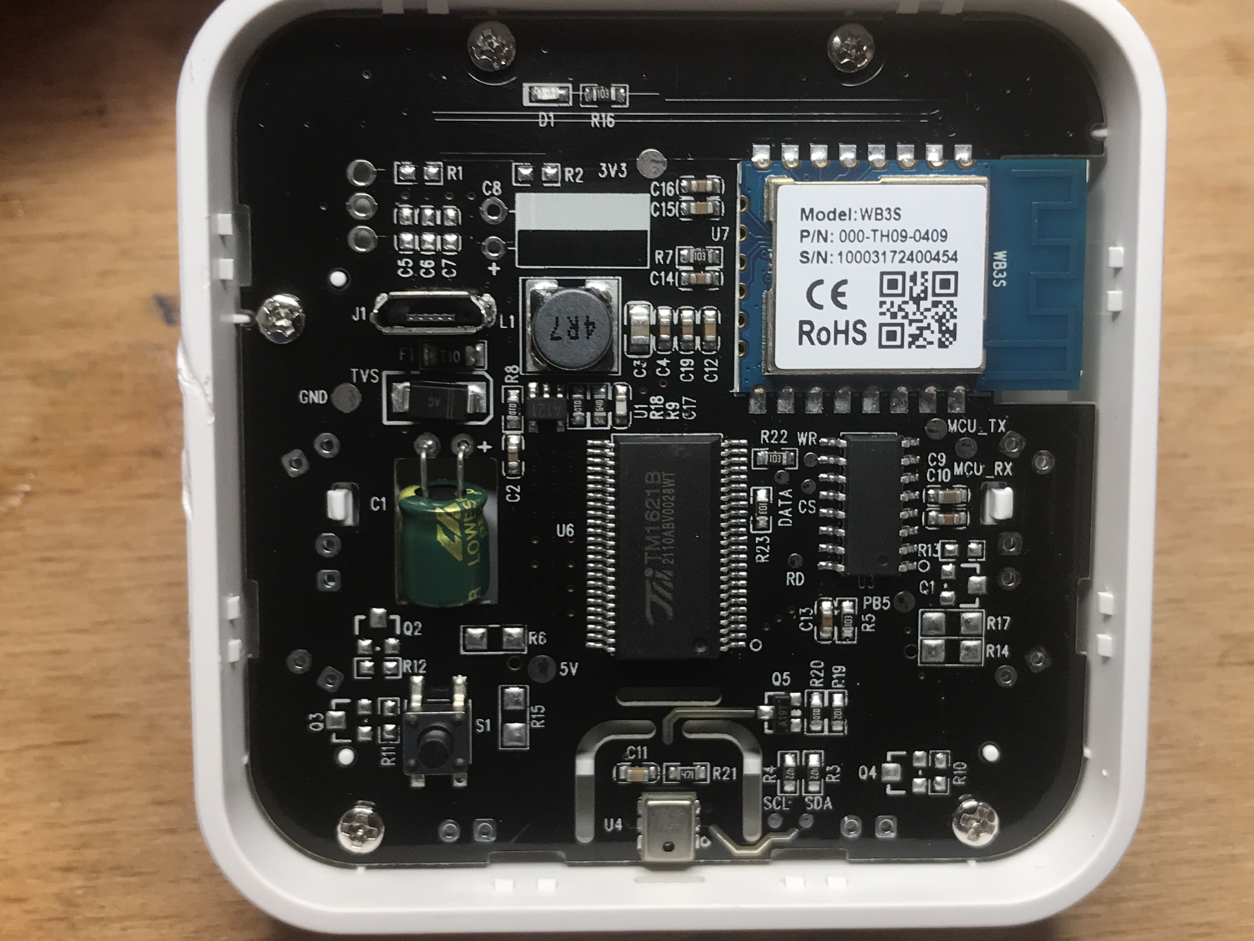

Interior of the TH06
The housing is latched. It must be undermined:
There is quite a lot of electronics inside:
Circuit board with mounted electronic components and a module labeled WB3S.
The heart of the device is the Tuya WB3S WiFi module:
Unfortunately, it is not based on ESP. We will not be able to upload Tasmota (although you can convert it to ESP12F, desolder and solder ESP ...)
The WB3S is based on the 32-bit BK7231T. WB3S offers 1T1R WLAN module, 256-KB SRAM, 2MB flash memory and rich peripherals.
However, the WB3S itself does not support this device. Next to it is a chip in SOIC that looks like a microcontroller, but unfortunately is not signed.
In addition, we have the LCD driver, TM1621B:
The production system of Titan Micro Electronics. It is powered with the voltage of 2.4-5.2V. Here in the SSOP48 housing. Supports a display up to 32 by 4 segments.
Internal diagram:
Pin Roles:
Of course, there is also a temperature / humidity sensor on the board. This is a very popular AHT10:
Communication with AHT10 takes place via I2C:
AHT pins:
The AHT10 can also be purchased as a separate module. It can be easily used, for example, with Arduino.
Next to AHT10 you can see a transistor signed A19T.
Maybe it's AO3401? I can see it is very popular:
This transistor is probably some part of the AHT10 circuit, I see a similar element on the modules with it.
There is of course also the power section. The characteristic large element marked 4R7 is a choke (not a resistor), it proves that there is a step down converter that converts 5V to 3.3V for the WB3S. There is also no LDO regulator in the vicinity, which also confirms the presence of a step down converter. The step down converter is more efficient than the regulator.
The step down controller is signed A121.
It's probably SY8008A / SY8008B / SY8008C. I can see that someone from the Radiokot forum was already looking for it.
It is a highly efficient, synchronous step down converter:
Pinout top view:
Sample application and charts showing efficiency:
It is also worth noting that the manufacturer has placed a large low ESR electrolytic capacitor.
Only the button remains (I do not know what these unpopulated place under Q2, Q3 are for):
Now a glance from the front.
This protruding part of the WB3S module is not a coincidence. This is where the antenna is on the board. It shouldn't be covered:
Tuya strongly recommends not to cover the antenna with a PCB. This would reduce the range / quality of the WiFi signal:
There is also a place for a mysterious element with three pin, which in my opinion would undoubtedly be an IR receiver:
So probably the second version of this product with IR uses the same board, but has an additional receiver soldered here.

- the product cannot be changed to a 24h system (but the seller warns against it)
- the product is based on WB3S, there is no ESP inside, so we will not upload our own firmware
As for the pluses, I can praise the product for using a step down converter instead of LDO, always a bit more efficient. And at least the seller gave the USB cable in the set.
I am enclosing catalog notes for the elements inside and related materials, including its manual in PDF format and the UART packages I have collected (but be warned that there is some glitch at the end of the file).
Do you use this type of smart products, and if so, what specific model and in what environment? Zigbee, WiFi, Home Assistant or the manufacturer's application?

Hi, nice post. I have a new version with the infrared stuff. But I did a big error. I desoldered the WB3S IC before trying to find this info. I have flash and solder an ESP12F to the board with tasmote... [Read more]
p.kaczmarek2 30 Dec 2022 14:00
The quoted command looks like indeed like a temperature and humidity. We have a tool for that: https://obrazki.elektroda.pl/7697004000_1672404402_thumb.jpg The command you are looking for is in... [Read more]
juan3211 30 Dec 2022 14:14
Thanks a lot, after reading your source code, I have sent with tasmota this command, but.... not luck: serialsend5 55 AA 00 1C 00 08 01 16 0C 1E 0C 1A 00 05 8F (it is supposed to be 2022/12/30 12:28:00... [Read more]
p.kaczmarek2 30 Dec 2022 14:20
According to my packet analyzer the packet you have entered seems correct: https://obrazki.elektroda.pl/6198498700_1672406135_thumb.jpg although I didn't check checksum... let me see: https://obrazki.elektroda.pl/4208625300_1672406288_thumb.jpg... [Read more]
juan3211 30 Dec 2022 14:54
Ok, I will need to check how or when the device ask for the time, may be is it before tasmota boots up? any key? [Read more]
p.kaczmarek2 30 Dec 2022 15:09
I don't think that it may be before Tasmota boots up, because there is a whole process where the device first queries the WiFi state, etc. We have that in OpenBeken and it seems to work. I don't know... [Read more]
juan3211 30 Dec 2022 15:32
That is the problem, I have already desoldered the wb3s IC. It may be not work I will try to see your source code trying to see the order of dust command you are sending. May be tuya ic is waiting for... [Read more]
p.kaczmarek2 30 Dec 2022 15:43
How did you desolder WB3S? Hot air? Also, by the way, is the IR connected in that version of device to WB3S or to TuyaMCU? [Read more]
juan3211 30 Dec 2022 15:53
Yes I have desoleder with a "type" of hot gun, but even that little piece of metal that it is over internal chips of wb3s has fallen off. So I don't know if wb3s will work or not, again. About infrared... [Read more]
p.kaczmarek2 30 Dec 2022 16:49
The entire file, especially the TuyaMCU_RunFrame and TuyaMCU_ProcessIncoming handles the Tuya State Machine. Certain messages are sent in a reaction to a received messages, and some messages are sent periodically... [Read more]
juan3211 30 Dec 2022 19:02
I am not using TUYA (54) in tasmota as configuration module. It gets into a boot loop and reset the configuration. I am just using serial comms with TuyaMCU. I have checked about IR, reciever is connected... [Read more]
p.kaczmarek2 30 Dec 2022 19:15
I am sorry, but I am unable to provide support for Tasmota. I can only get it working for you in OpenBeken. It would be ironic if you had to solder back WB3S, but from what you said, pads are broken so... [Read more]
juan3211 30 Dec 2022 23:02
Hi, S09 yes. I have get managed to get SETTIME working, command is correct, for example this one: 2022/12/30 12:26:00 Friday serialsend5 55 AA 00 1C 00 08 01 16 0C 1E 0C 1A 00 05 8F But TuyaMCU doesnt... [Read more]
juan3211 31 Dec 2022 17:24
Sorry, mistake. These pins are now confirmed that works (I am using tasmota firmware, IRrecv gets data, and with IRsend GPIO14 I have managed to change my TV volume ;) ) Reciever: GPIO5 IRrecv Emiter:... [Read more]
p.kaczmarek2 01 Jan 2023 15:16
Thanks, I also see you had to solder extra resistor for ESP8266? Did you get TuyaMCU working with Tasmota? Btw, If you have other devices, please post teardowns here as well, we're building a database:... [Read more]
juan3211 02 Jan 2023 07:55
Yes, I solder two resistors, one for gpio15 to GND, and one for gio0 to 3.3v. I can't get tuya mode working, I get an automatic config reset because boot loop. I will try to ask in Tasmota why. ... [Read more]
p.kaczmarek2 02 Jan 2023 09:47
Please tell us here once you have it resolved. Good luck. [Read more]
