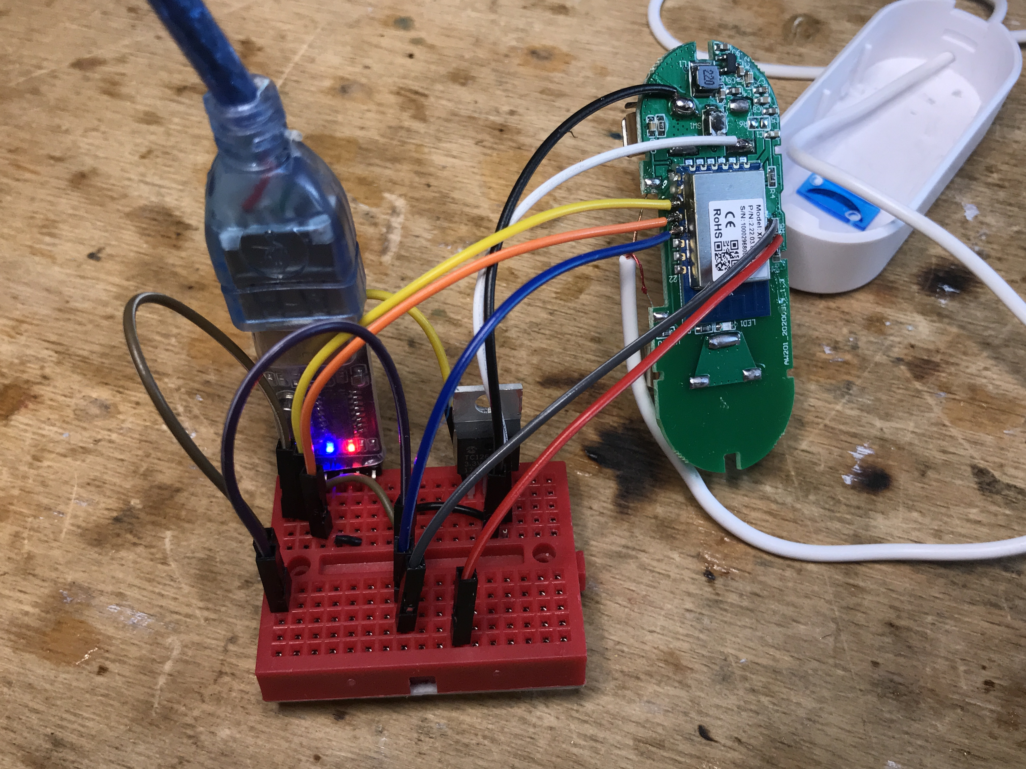

Uploading the firmware to the XR809
The firmware upload process is the same as in the previous XR809 topic:
Open source firmware for XR809 compatible with Tasmota HTTP/Home Assistant
Please see the topic above for details.
Soldering and programming (LDO TC1264-3.3V provides power, USB to UART is in 3.3V mode):
You can get the latest binary from here:
https://github.com/openshwprojects/OpenBK7231T_App/releases
Programming success:
