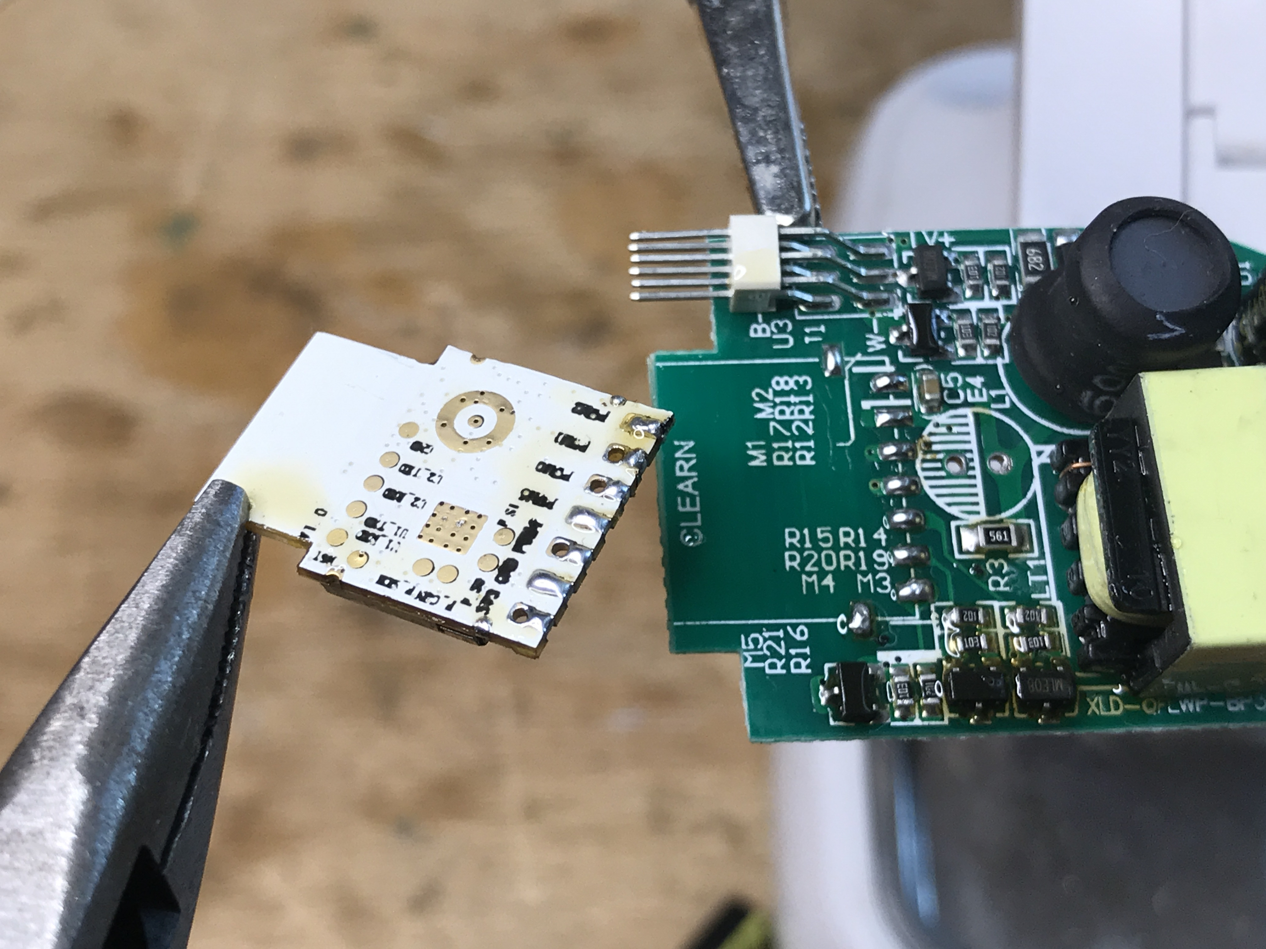

In order to desolder the module, I added flux and fresh Pb solder (Pb solder has lower melting point) to its pads and started to gradually heat them with hot air:
At the bottom of the module you can see the desired UART interface for programming:
Obviously, this module is going to come back into place. You need to clean the pads with a braid:
I also washed the plate, I have an IPA cleaner for it.
Programming the module - as in the previous topics in the series:
The module returns to its place - I put a fresh solder on one pad, placed the module properly, and then soldered the remaining pads:

Here, too, the programming pads are obscured. You have to unsolder.
First, I removed one electrolytic capacitor because it was too close to the pads and I didn't want to overheat it.
Additional Pb solder, flux and heat:
Bottom of the module:
Programming:
The module returns to its place:
