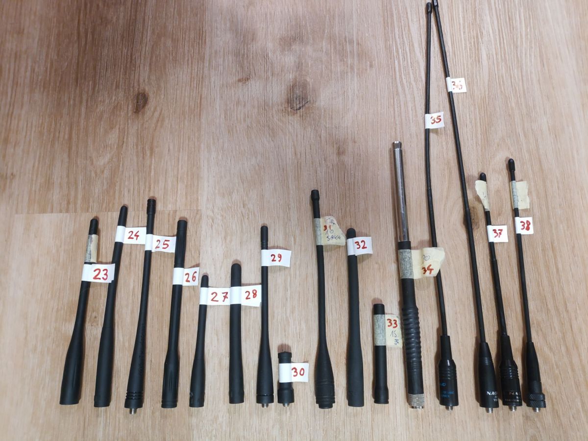

Recently, I have measured several dozen handheld antennas and 3 car antennas in the amateur 2m and 70cm ranges in an amateur way.
Here is the list:
01 Retevis RHD771 (2.15dBi) Aliexpress RETEVIS Official Store
03 Nagoya NA-771 (2.15dBi) Aliexpress?
07 Yaesu VX-6R Factory attached to the radio
08 Wouxun KG-UV8D Factory attached to the radio
09 Harvest RH660S (3.0 / 5.0 dBi) Aliexpress BlueRadio store
09skr as above but it was only extended to work at 70 cm
partially so that the SWR is approx.
as above
10 Self-made on the pattern 771 Sam robilem
11 Diamond NR-770H (3.0/5.5dBi) InRadio
12 Nagoya NL-770H (3,0/5,5 dBi) HamRadioShop
13 Nagoya NL-770R (3,0/5,5 dBi) HamRadioShop
14 Nagoya NA-666 (2.15 dBi) ?
15th Nagoya NA-771 (2.15dBi) ?
16 Baofeng BFG-A-3 ?
17 Baofeng UV-3 Fabryczna dołączona do radiotelefonu
18 ICOM FA-S270C Factory attached to the ICOM E90 radio
19 Baofeng DM5 Factory attached to the radio
twenty Baofeng UV5 Factory attached to the radio
21 Nagoya NA-771 ?
22 Kenwood KRA-23M factory included with the NX-200 radio
23 Kenwood TH-D74 Factory attached to the radio
24 Yaesu FT-5D Factory attached to the radio
25 Anytone 878 Factory attached to the radio
26 Alinco DJ-G7 Factory attached to the radio
27 Yaesu VX-2 Factory attached to the radio
28 ICOM MARINE? Factory attached to the marine radiotelephone
29 Kenwood NX-320 E2 (KRA-27?) 70cm Factory attached to the radio
thirty ? Miniature something at 70cm Aliexpress
31 Sagem 70cm ?
32 Yaesu Standard Horizon CAT-460 Factoryattached to the radio
33 MDVM HS DUAL Factory attached to the hotspot
35 Diamond RH-771 ?
36 Nagoya NA-771 ?
37 Nagoya NA-701 ?
38 ? without description, base similar to Wouxun ?
While the originality of the antennas included in the factory with the equipment does not raise any doubts, it can be different with each other. If I was sure that a given antenna is a counterfeit, it would be marked.

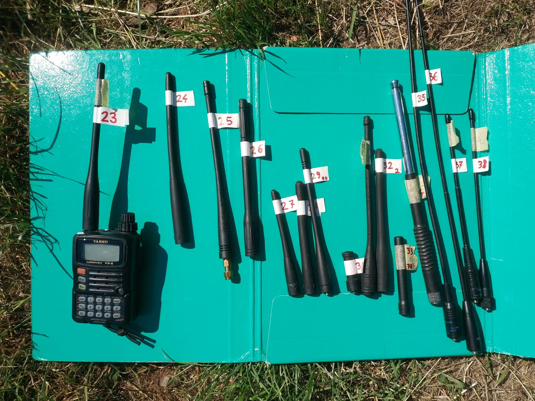

The measurement was carried out in 4 rounds, in which I measured the S1P parameters (including SWR) and the signal level emitted from each of the antennas under field conditions.
S1P measurements with the NanoVNA-H4 analyzer:
1. Antenna placed directly on the NanoVNA-H4, and measurement with the Analyzer in the hand, close to the head, held like a handheld transceiver.
NanoVNA calibration took place directly on its socket in the frequency ranges 120 to 170 MHz and 400 to 470 MHz
2. Antenna on the base with counterweights and NanoVNA measurement.
NanoVNA calibration was done on the base slot, eliminating the influence of the adapters used to connect the base. Ranges as above. If the antenna required an additional adapter, then this adapter was not calibrated, so the SMA barrel extends the line by 155 picoseconds, and the SMA - UC1 socket is 327 picoseconds, and this UC1 adapter has 43 ohms of wave impedance. The influence of these adapters is noticeable in the 70cm band, especially on the Smith chart, but it is not big and for the purposes of this test it can be omitted.
Signal level measurements:
3. Antenna on Yaesu VX-6 handheld radio and signal level measurement on base station.
4. Antenna on a base with counterweights and a base on a Yaesu VX-6 and measuring the signal level on the base station.
Measurements 3 and 4 were carried out at a distance of 185 meters from the base antenna, in an urban area, in a densely built-up housing estate, but in the field of optical visibility of the antennas. I walked about 15 meters with the PTT pressed at full power and the device at my head, just like I would normally use it to make communications. I tried to keep the device as vertical as possible so that the polarities of the antennas were consistent. There were no obstacles on the walking route in the immediate vicinity. In the case of walking with the counterweight base, these counterweights were placed a few cm above the head, so then the antenna was about 30cm higher than when broadcasting without counterweights, which could have a false positive effect in favor of the counterbalance system.
At the base station, the signal was picked up by a Diamond X50N antenna installed about 10 meters higher than the towel rail, giving an angle of 3.1 degrees. The signal came through a 10 dB attenuator, an RTL-SDR tuner working with the SDR ++ application, set to minimum gain, all AGC off, sampling 1536 kHz, division / 8 giving 192 kHz. The spectrum was recorded to an IQ .wav file. The center frequency of the SDR was set 50 kHz higher than the handheld transmitter, and as a result, the recording showed a carrier signal with a frequency of 50 kHz. The recording was filtered with a 49 kHz - 51 kHz bandpass filter. After such a cleaned recording, the noise level was -59 dB. 0dB is the SDR overload level, so the results are in the range of -59 dB is the minimum level to 0 dB is the maximum level (they are negative).
Each antenna transmitted for about 15-20 seconds, and from this time the average RMS level expressed in dB was calculated.
An example recording chart opened in an audio processing program looks like this:
There are clear differences between the individual antennas. I've already selected sample 35 on it, then zoom in:
and I mark precisely the beginning and the end. You can see here that the signal level fluctuates as it travels. Then I use the statistical analysis function which gives me this information:
Screenshot from signal statistics software showing average RMS power indicated at -18.99 dB.
I am writing back Average RMS Power.
The measurements with the hand towel were performed on the frequencies 144.9875 MHz and 434.9875 MHz.
Measurements made from antenna No. 14 took place only without counterweights.

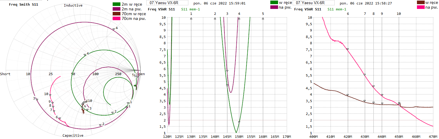

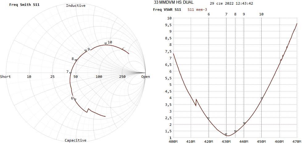

Finally, here are the Smith and SWR charts:
01 03 07:
08 09 10:
11 12 13:
14 15 16:
17 18 19:
20 21 22:
23 24 25:
26 27 28:
29 30 31:
32 33 34:
35 36 37:
38:

The receive chain used an RTL-SDR with a 10 dB pad; 0 dBFS equals tuner overload, so values show relative power, not absolute watts [Elektroda, djbpm, post #20083940]

Every 3 dB equals double power. With a 23.72 dB deficit, the weakest whip would require 236 W to equal 1 W from the best whip [Elektroda, djbpm, post #20083940]
Do counterpoise radials really help handhelds?
Yes. Adding four 17 cm wires raised 2 m signal levels by up to 9 dB on short whips—roughly tripling effective range [Elektroda, djbpm, post #20083940]
What’s the edge-case failure to avoid?
Long telescopics crack internally; the author’s 1 m Astro 320 snapped after light use, dropping gain to –15 dBFS [Elektroda, djbpm, post #20083940]
Can I beat store antennas with a DIY quarter-wave wire?
A tuned 50 cm wire plus four radials often rivals commercial whips, but without radials it underperforms badly (SWR > 5 : 1) [Elektroda, djbpm, post #20091994]
How do I measure an HT antenna with a NanoVNA?
  1. Calibrate at the SMA port for 120–170 MHz and 400–470 MHz. 2. Hold the analyzer close to your head like an HT. 3. Log S11 (SWR) then walk 15 m while TXing to record dBFS at a fixed receiver [Elektroda, djbpm, post #20083940]
Cable testing ruined my readings—why?
A feed line becomes a random counterpoise. A 0.91 m RG402 boosted the RHD771 reading by 7 dB, while a 5.9 m RG223 killed that gain [Elektroda, djbpm, post #20110340]
Is there a simple way to improve my stock rubber duck?
Yes. Clip a 50 cm stranded wire to the ground ring (counterpoise). Users report 4–6 dB stronger reports on 2 m without spending a cent [Elektroda, djbpm, post #20083940]
Why do 70 cm results look better than 2 m?
Handheld whips are closer to quarter-wave on 70 cm, creating efficient radiation and SWR near 1.5 : 1; 2 m requires impractically long elements [Elektroda, djbpm, post #20083940]
What is the downside of car antennas on a handheld?
NR-770H weighs 140 g and creates leverage that can snap the SMA jack during a fall—an expensive failure scenario [Diamond Data, 2023].
How repeatable are low-cost whips like RHD771?
Three factory-sealed RHD771 samples differed by up to 2 dB and 0.2 SWR, which is acceptable for field use [Elektroda, djbpm, post #20090214]
Does measuring S21 with two antennas help?
Not for handhelds; the feed cables act as unintended counterpoise, corrupting the pattern. The author abandoned this method after unusable plots [Elektroda, djbpm, post #20090214]
