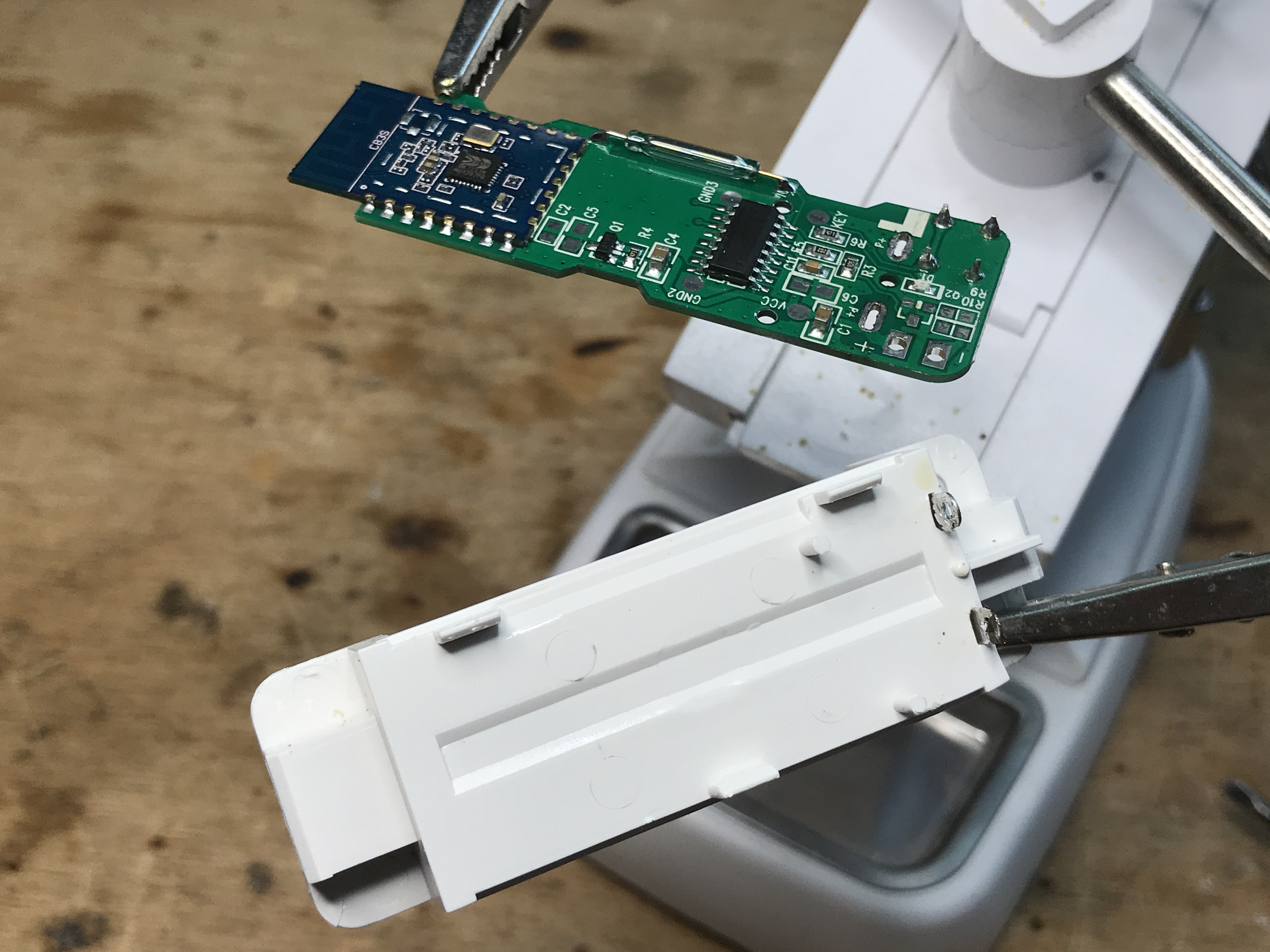

Interior of D06
It is enough to pry the housing with a knife:
Inside there is a CB3S WiFi module (BK7231N) and a microcontroller (no marking):

In order to analyze the tile in more detail, I first removed the binder with the braid and then removed it from the plastic base:
However, there is not much on the bottom:
On the basis of the collected knowledge, I have prepared a sketch of the connections:
This door / window opening sensor works quite differently than the one I described in the past sensor realized on XR809 (XR3) . Here, the WiFi module is normally turned off - only the microcontroller is still working. The microcontroller can only turn on the power CB3S through the MOSFET transistor with P channel A19T when needed. This microcontroller communicates with the CB3S via the TuyaMCU protocol, but in the version for battery-powered devices, i.e. 0x00 and not 0x03.
Simply put, the connection looks like this:

Finally, I did a test in OpenBeken - both systems powered separately from 3.3V, the microcontroller awakened, the strange 00 00 00 in the tuyaMCU buffer appear when the microcontroller is asleep (its UART is turned off) and the WiFi module works in an artificial way (we additionally powered it):
OpenBeken is able to receive the MCU Identification packet.
However, if we send the 0x02 configuration package ourselves (in the screenshot by the uartSendHex command), then CB3S will also send us the 0x08 package with the variable states:
Summarizing, the above data shows that two variables TuyaMCU (data points) in the package 0x08 are used in these sensors:
- dpID 1 - sensor status, 0 or 1 (for a door sensor it is open / close, for a moisture sensor it is wet / dry)
- dpID 3 - battery status, from 3 (full) to 0 (or 1 - not checked).
These data are reported by TuyaMCU after the WiFi module has been identified.

This door / window opening sensor is indeed different from the sensor discussed earlier, which is based on the XR809. Adding a microcontroller that turns on the WiFi module whenever you need to send new information to the server certainly allows to save energy to some extent and extends battery life, but also complicates the system itself and makes it difficult to add its support to my firmware.
My measurements show that the current consumption in MCU sleep mode is about 5 uA. It is worth mentioning that then the MCU even turns off its UART (I checked - it does not respond) and only waits for a signal from the sensor or sensor.
As soon as the signal is received, the WiFi module is on and the power consumption is up to 70mA or more, depending on what the WiFi is doing.
These 5uA is a rather good result - I looked at the ESP8266 datasheet (there is no ESP here, only BK7231N, but I think it's worth comparing) and depending on the sleep mode, the ESP8266 consumes the following currents:
so the manufacturer could actually gain something from this addition of the MCU.
Interestingly, the 5uA result is similar to the ESP32 power consumption in hibernation mode (based on its catalog note):
Of course, the power consumption is also influenced by the power consumption during the operation of the WiFi module - only that it is difficult to judge how much impact it is, because we do not know how often the door will be opened.
The same product also acts as a flood sensor - the system and protocol are identical, the only difference is that a different sensor is soldered.
The sensor itself has already been pre-processed for mine OpenBeken (I added support for it in my firmware) but it's not the final version, so I'll detail it another time.
