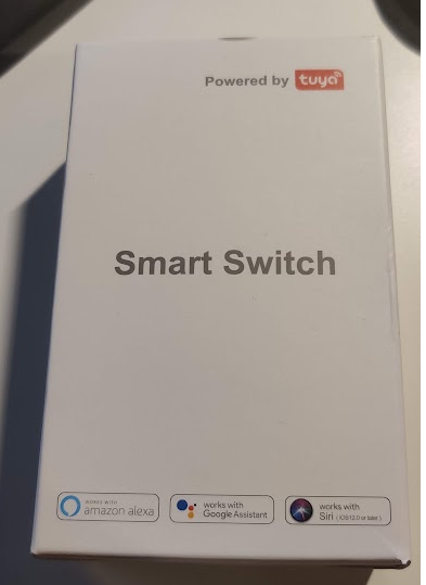

In this post, I will share teardown of Tuya Smart switch for boiler water heater and flashing it with OpenBK7231N.
The switch was bought on Aliexpress, the major reason to buy this device is it’s advertised high power, 20A 4400W !! (I have very bad experience with cheap Sonoff 16A switches that nearly burned my entire house after few weeks of operation).
after discovering this forum... i had to give Tuya a try ;)
I was really hoping to get an old device with either ESP chip or at least WB2S, however the switch came with CB3S and BK2731N, which made the process a bit more educational (aka complicated).
Teardown:
The front glass cover is easily removed, and the 1st PCB layer with the LED and CB3S module are exposed.
This PCB is connected with 4 pins socket to a 2nd PCB which contains the relay and power circuit. In between there is a thin film layer (like in other switches from Tuya).
For the firmware upgrade there is no need to disassemble the 2nd PCB. Just remove the 1st PCB from its housing.
