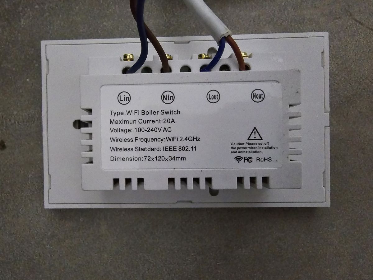

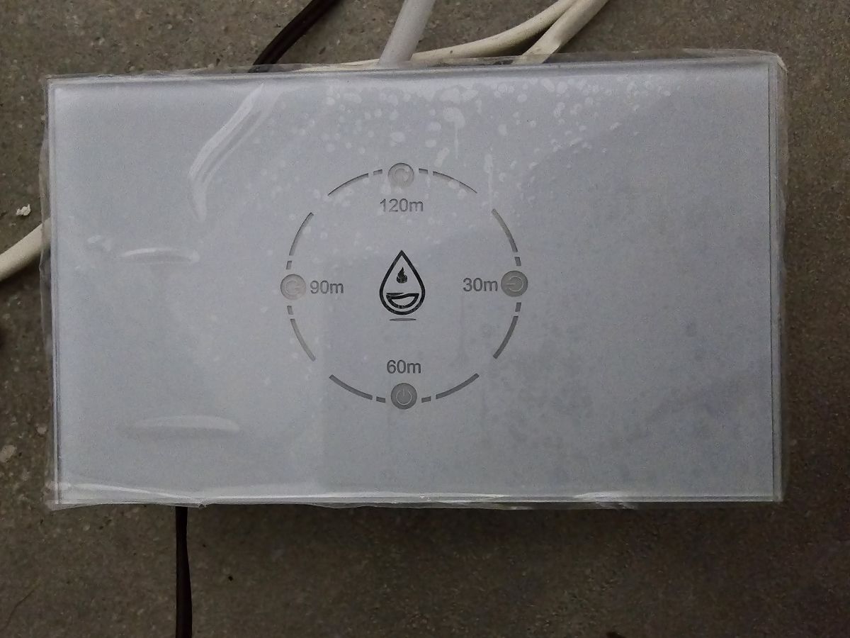

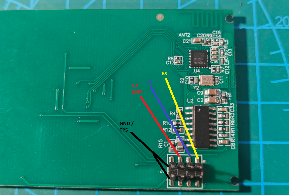

    Water Boiler switch with 4 touch buttons and 20Amp relay

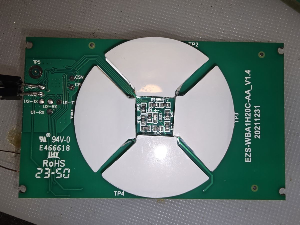

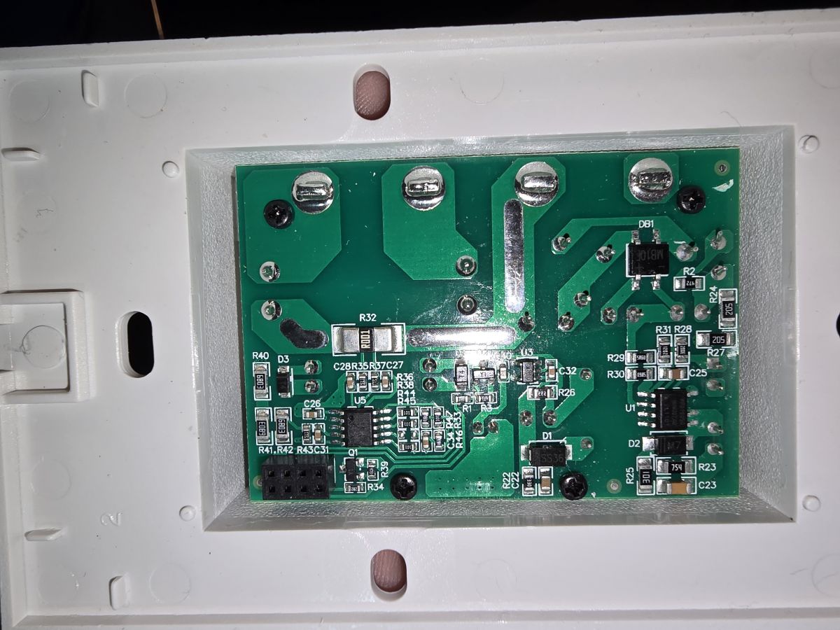

    Markings on the board: EZS-WBA1H20C-AA_V1.4
    20211231
    Water boiler switch with four touch buttons, time markings, and a drop symbol in the center.
    Printed circuit board with electronic components and traces.
    Electronic board with markings and connection elements.
    Printed circuit board in a plastic casing with electronic components and screw terminals.
    Close-up of an integrated circuit on a printed circuit board with markings.
    WiFi boiler switch with labeled connections and technical details.
    link to item Link

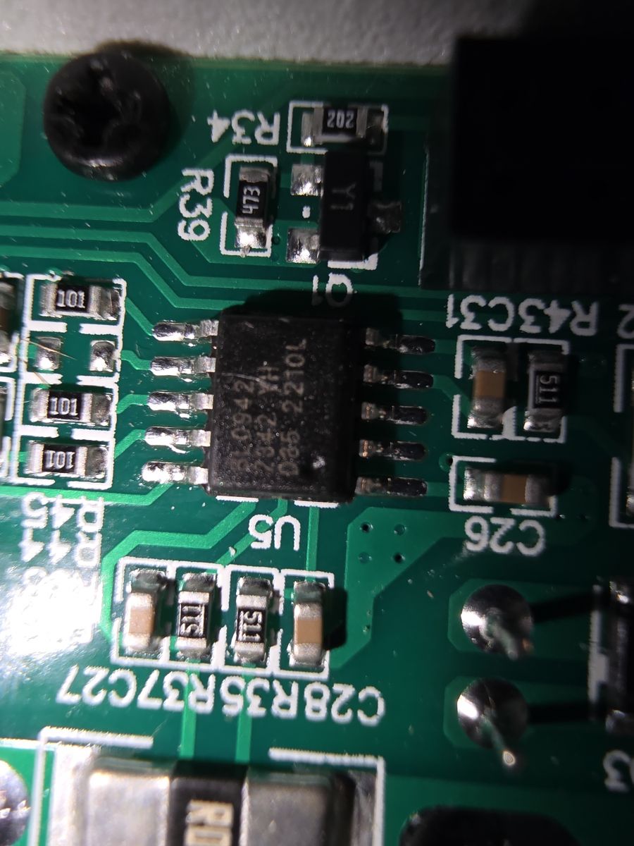

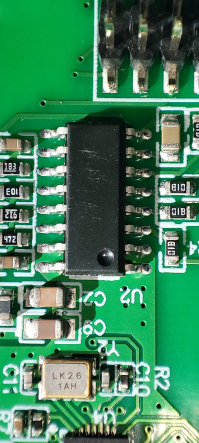

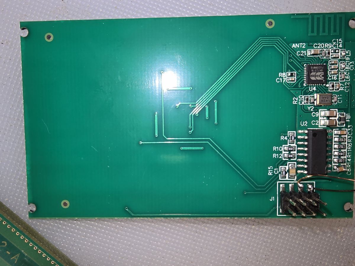

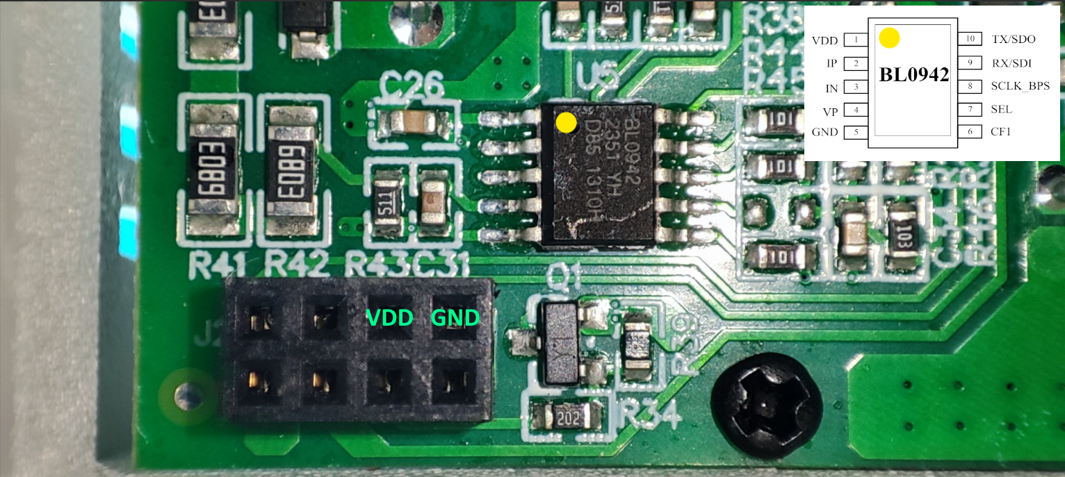

    Managed to map some pins, like all the LEDS the weird Relay and one capacitance button,

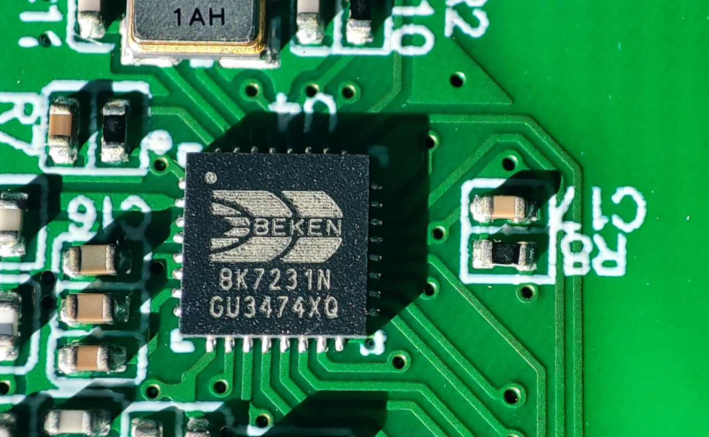

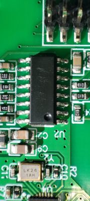

    There is a mystery MCU on the board that is connected only to P28 and apparently sending high and low signals when touching 2 of the pads
    There is also BL0942 chip but I was unable to config it to see any packets of info from it,
    Also the relay is magnetically held.

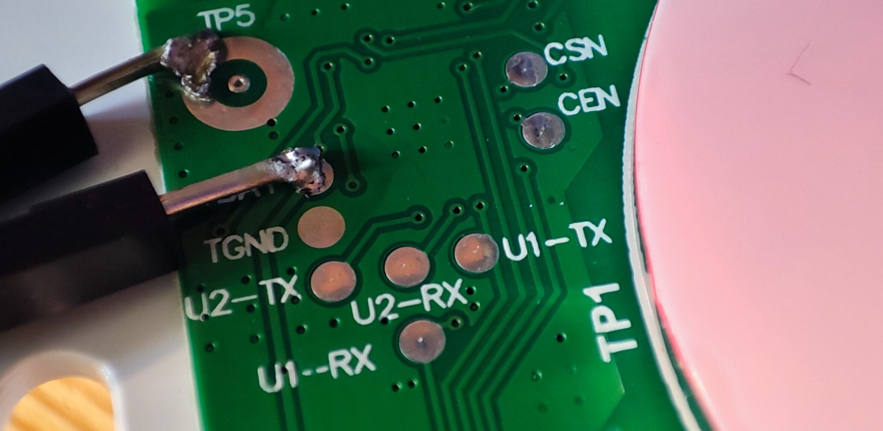

    P24 - Relay - High to turn on
    P26 - Relay - high to turn off
    P7 also goes into the power board, no idea what it does.
    Any help will be appreciated.

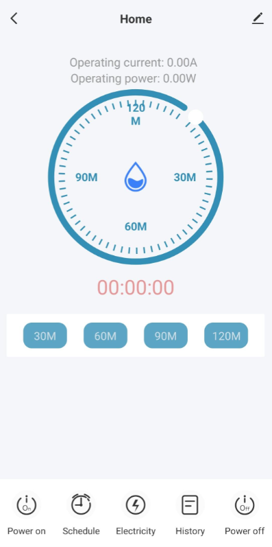

    Notification of successfully added device named Boiler.
    A mobile app screen with a timer displaying time and functional buttons related to the device.

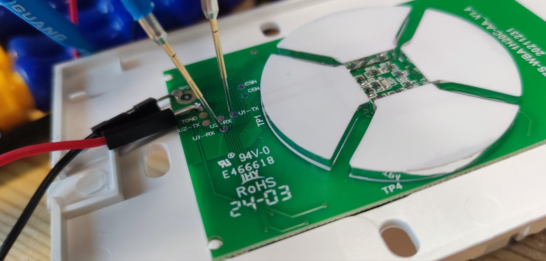

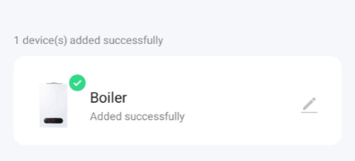

    Added after 58 [minutes]:
    tuya api
  • BL0942SPI checksum errors at 9600 and 115200

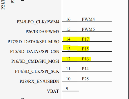

    I'm getting nothing from tuyaMcu_sendQueryState at 115200 or 9600 baud following this https://www.elektroda.com/rtvforum/topic4049908.html#21053452
    but it seemed in continuity check that two of the main PCB connector pins looked like they were going roughly in this area of the BK IC with SPI pins (I couldn't really see which pins I was touching)
    PCB connector diagram with highlighted pins 12, 13, 14.

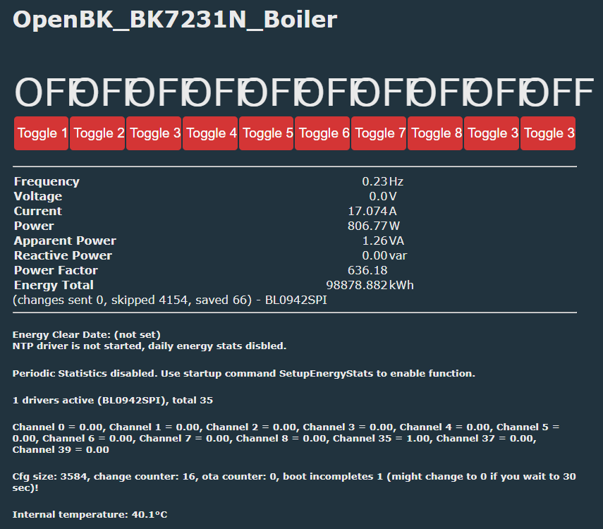

    then I remembered there was a BL0942SPI driver. so started that
    Screenshot displaying OpenBK_BK7231N_Boiler parameters.
    but like @uchristo device in here
    these are seen with startdriver bl0942spi 9600 and startdriver bl0942spi 115200
    so not really sure what's next. don't know what role the MCU is playing.

    Whoa, I'm glad you bought one too, I too haven't made much progress, my guess the MCU probably is a touch controller for the buttons on the faceplate

    On Pin 28 the chip that is connected is the touch-sensing chip with 4 outputs to DAC ladder, which Pin 28 interprets as 4 distinct analog levels.
    I was not able to find a firmware version that supports AB_MAP (tried compiling from source, using Docker; nothing works).
    For me the values for the buttons are:
    ~25 on Pad 1
    ~1810 on Pad 2
    ~2685 on Pad 3
    ~3623 on Pad 4
    ~4000 idle

    BL0942 pinouts:
    J1 - Pin1 - GND
    J1 - Pin2 - GND
    J1 - Pin3 - 3.3V
    J1 - Pin4 - REL on/off
    U1-TX -> J1 - pin5 - Pin9 - BL0942
    J1 - pin6 - REL on/off
    U1-RX -> J1 - Pin7 - Pin8 - BL0942
    J1 - Pin8 - Pin6 - BL0942

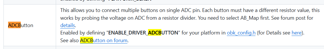

    seeindarkness wrote:
    Small update,
    There is a driver for that, see:
    https://github.com/openshwprojects/OpenBK7231T_App/blob/main/docs/drivers.md
    Documentation fragment about ADCButton function with highlighted text
    We have a dedicated solution for compiling firmware online with just few clicks. Just enable this driver by defining "ENABLE_DRIVER_ADCBUTTON" for your platform in obk_config.h and follow this guide:
    https://www.elektroda.com/rtvforum/topic4033833.html
    No toolchain required, not even code download - with OBK, you can build your firmware version (or even develop your driver from scratch) fully on GitHub. That's the recommended solution. And it even automatically runs self tests - so you get feedback telling whether everything is still ok in OBK core. And it checks for memory leaks... etc.

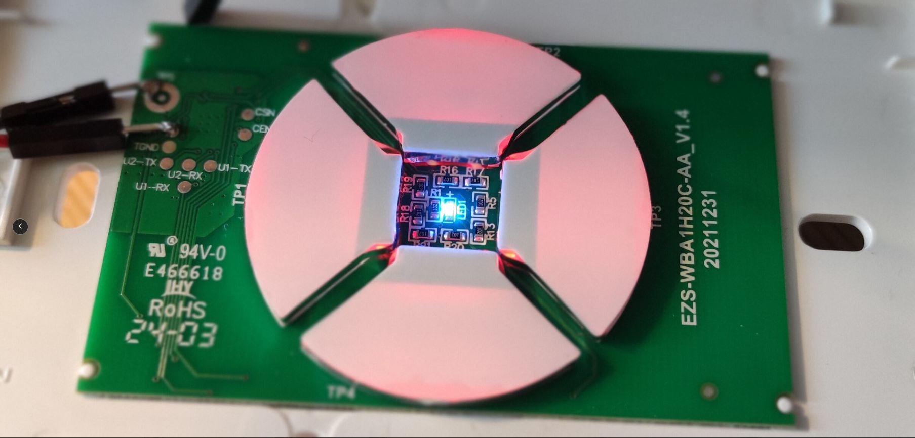

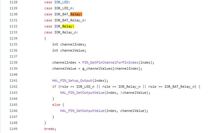

    ainoretho
    If it helps anyone, I (also have one of those, was watching this thread for a while. First OpenBeken usage - so thanks a lot!):
    https://github.com/yehoshuapw/OpenBK7231T_App/actions/runs/20718534966/artifacts/5025369763 - A build with the define mentioned here for the ADC driver.
    (Also, for some reason, when I have the top red LED as LED it stays on regardless of the channel, but when I put it as REL it does what I want it to)
    Here are some helpers which I just created to try and write some autoexec which will be usable without Wi-Fi working

    startDriver ADCButton
    AB_Map 910 2250 3150 3860
    addEventHandler OnADCButton 2 backlog led_up_blue_on; SetChannel 40 7200; addRepeatingEvent 0.5 1 led_up_blue_off
    Are you sure, can you double check? I think that internaly Relay and LED handling is the same. For example:
    C code snippet handling pin roles for LEDs and relays with syntax highlighting
  • GPIO page not reading pin state correctly
    #18 21800488
    ainoretho
    >>21800017 I don't know _why_, so this most likely is some misunderstanding on my part, but:
    When powering on, the upper red LED is on, and doing `setchannel` does not fix it; also when first doing 1. and some of the LEDs also don't do anything when I do a `setchannel` to them,
    This is all fixed if I change from LED to REL or opposite (see in the script above I swap them all back and forth).
    I suspect the `HAL_PIN_SetOutputValue` call from the func you attached is the reason this helps, which brings the question about what can be seen without any "hack" fixes in the GPIO config page.
    Checked that again just to make sure, and after a clean boot red up LED was on, so pin 15, channel 8. `getchannel 8` gave that it is 0.
    And in GPIO finder page was low. When set to high then back to low went off (which causes the change from LED to REL in this UI, which is the reason I tried that).
    So, either the GPIO page does not "read" the right value being put out - or it does not touch it, assume it is 0 but it is 1. I don't understand enough to know more.
    But triggering a set pin to 0 works, and the method of changing the pin type works. (and I don't find a command to set a pin value)
    tl;dr: yes, but it isn't about being REL or LED, it is about _switching_

    That device seems to be very problematic.
    after flashing many devices in the past, i loved the mainboard's JP1 socket, all pins we need for flashing are easily accessible via it (see image). you only need to ground CEN point once for the flashing.
    However, when i uploaded the firmware i run into many random network problems; sometimes the hotspot didn't work, sometimes the device failed to connect to the router.
    at some point, i clicked "Erased all" in the Esay UART Flasher gui, and since then the wifi seems to be gone. the device is only accessible via USB.
    of course, i did try to `Restore RF part` but that didn't solve the issue.
    This is the output from the restore rf...
    Code: Bash
    After that, i uploaded the latest firmware, but as mention, i can' see the device (neither hotspot nor router connectivity are happening).
    Code: Bash
    Is there anything i can do to make wifi work again?

How do I map the BL0942 metering IC pins on this board?
Use the shared J1 mapping: Pin1 GND, Pin2 GND, Pin3 3.3 V, Pin4 relay, Pin5 BL0942 via U1‑TX, Pin6 relay, Pin7 BL0942 via U1‑RX, Pin8 BL0942 SCK/line. This enables UART/SPI access for power data. [Elektroda, seeindarkness, post #21771967]
Why does BL0942SPI show bad checksum at 9600/115200?
Users observed repeated "bad checksum" when starting BL0942SPI at 9600 or 115200. It suggests wiring, mode, or clock mismatch, or that a mediator MCU gates traffic. Try verifying the interface mode and lines before debugging firmware. [Elektroda, divadiow, post #21071623]
How can I start trying the BL0942 driver anyway?
From OpenBeken console, run: startdriver bl0942spi 9600. If checksums fail, retry at 115200 and inspect continuity to the BL0942 pins. Quote: "started that ... Warn:EnergyMeter:Failed to read reg" logs confirm attempts. [Elektroda, divadiow, post #21071623]
