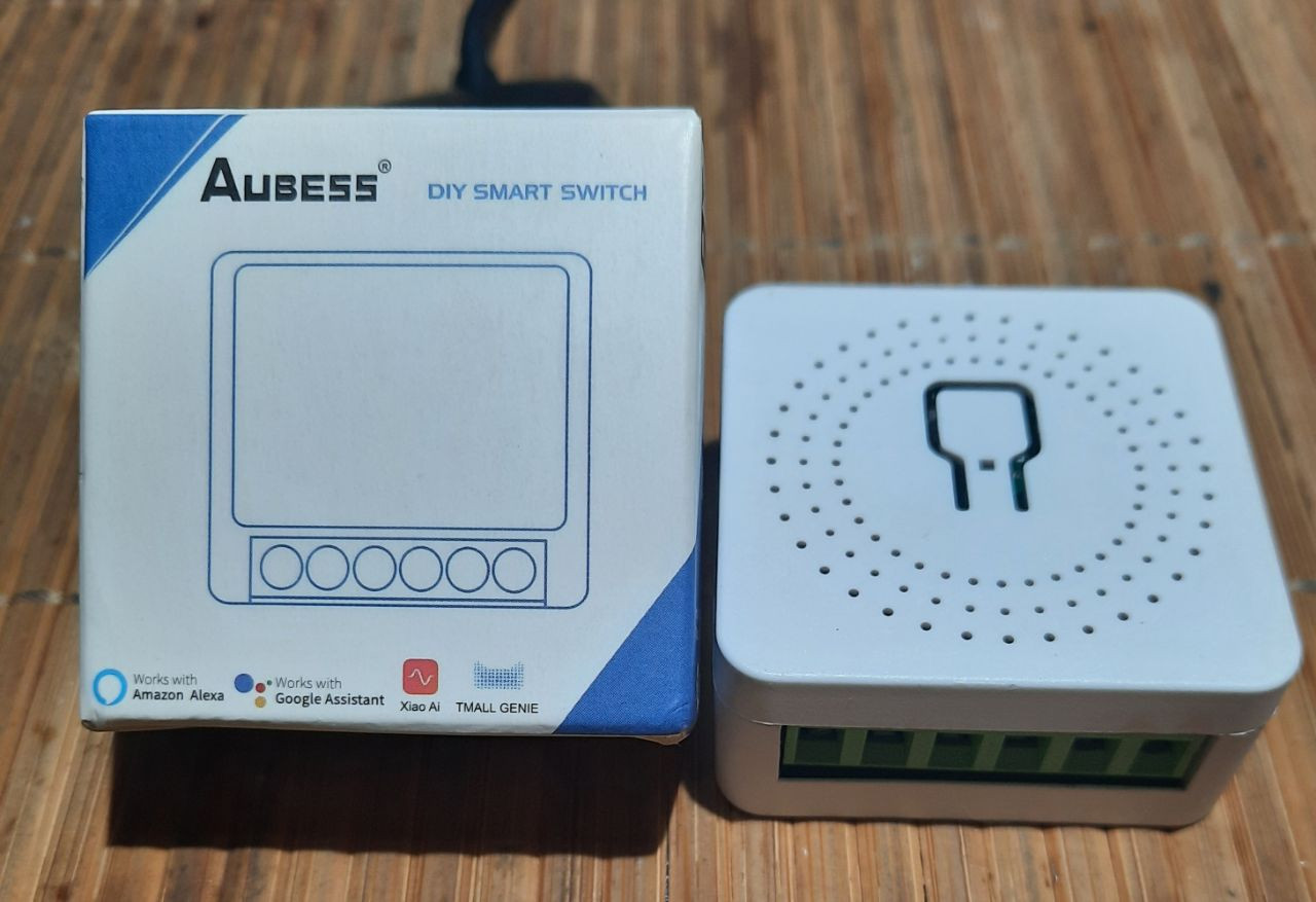

mini smart switch - Native module firmware for working without a cloud, via mqtt service.
In the application from Tuya, it looks like this:
The case is assembled on 4 latches, it is opened with a mediator or a plastic card or nails :-) we start from the slot from the corner with contacts.
Inside is a quite decent 16 amp relay and an unknown module a la Tuya
The module has a chip from Belon BL2028N
