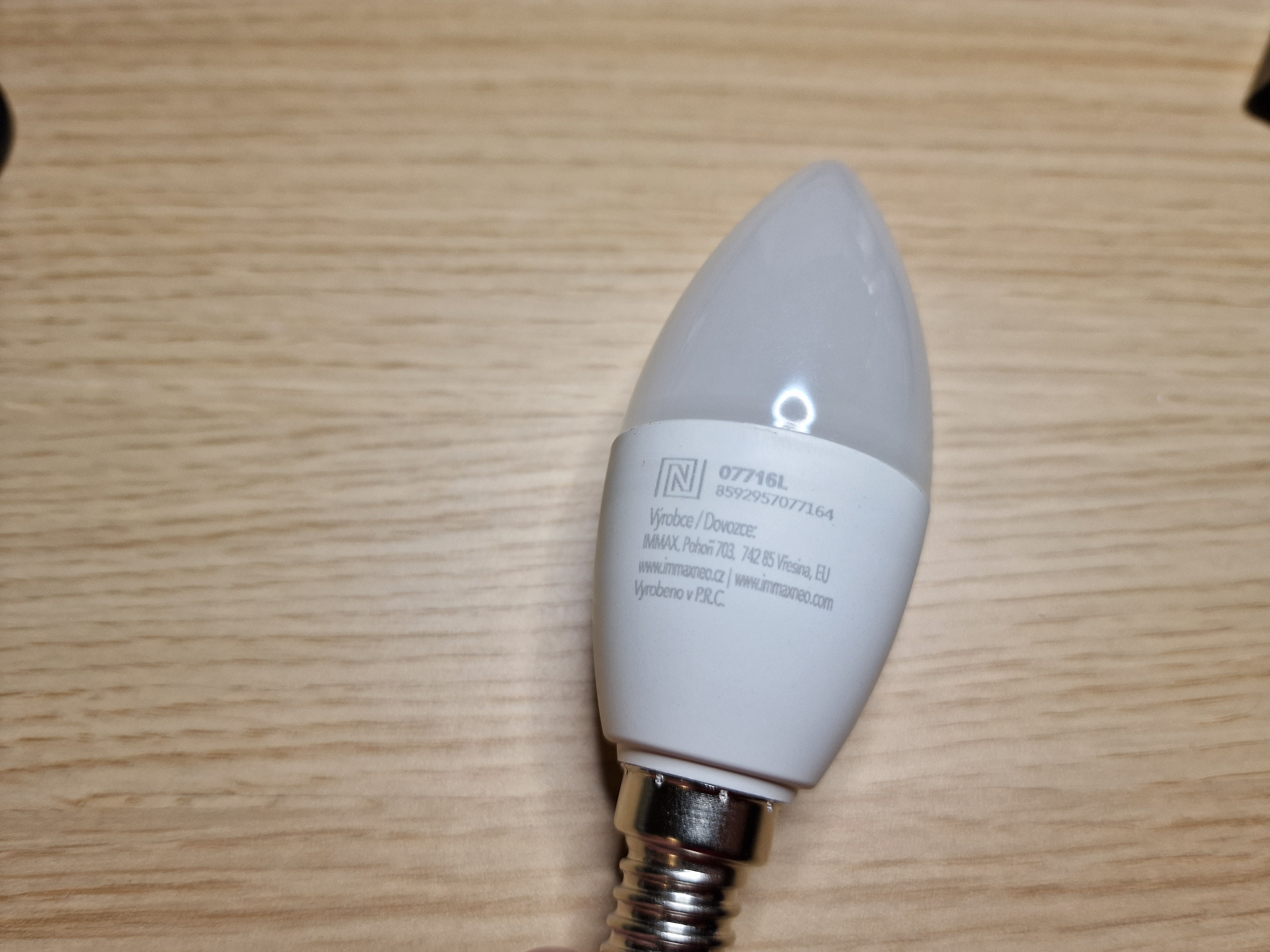

I've got 3 of these bulbs and wanted to throw Tuya where it belongs. So I bought one more for disassembly, because I didn't know if I'll be able to reassemble it again. I dumped the FW, sent profile request for Cloudcutter and waited. Glad I bought one, because it was impossible to reassemble. If you disassemble it the wrong way.
After a month of waiting, I've lost my patience with Tuya and finally decided to flash it manually. I bought one more for another test and sure enough I found a way to not destroy it.
You will need point tip soldering station and steady hand.
Here is the bulb:
Opening it is quite easy. You can press around the seal and this will loosen it, once you can rotate it, just pop it off.
