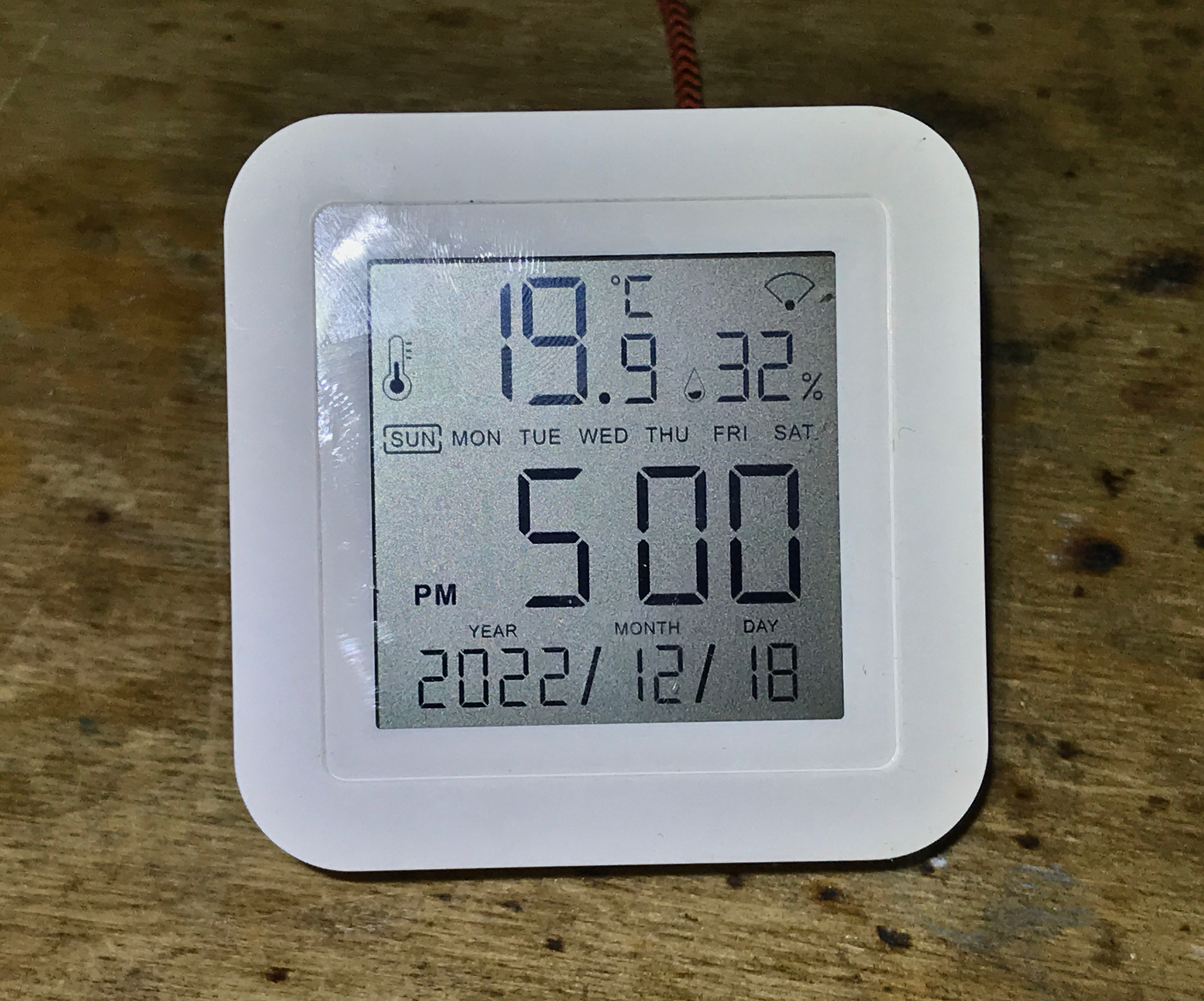

I will show you how to connect a calendar/thermometer/hygrometer model TH06 with the Home Assistant LCD. This calendar is based on the WB3S/BK7231T WiFi module connected to an additional microcontroller that communicates with the WiFi module via the TuyaMCU protocol. The WiFi module is responsible for providing the microcontroller with the current time from the Internet (obtained via NTP) and for receiving temperature and humidity measurements from it.
In order to connect to Home Assistant, we will change the BK7231T firmware - we will upload it OpenBeken . At OpenBeken, we will properly configure the TuyaMCU and NTP driver so that it works with the calendar.

This calendar, like other devices using TuyaMCU, connects to the microcontroller through the same UART port (TXD1, RXD1) that is used for programming. In order to change the firmware, you need to cut off the paths going to the MCU, then you can normally change the batch through bkWriter 1.60, as in similar topics from the series.
Photos before the operation and a description of the plate are in the previous topic, previously linked.
This is what mine looks like after surgery:
I did the programming as follows:
- cut off RX/TX from MCU
- I connected my USB to UART converter to TXD1 and RXD1, additionally I connected its mass
- in bkWriter 1.60 I started writing the batch
- when bkWriter 1.60 was waiting for the module to reboot, I cut off and connected it to the power supply through its USB connector
- the batch has been uploaded correctly

After reboot we get:
I will improve the display of these variables even further.

I like this calendar very much - one of its advantages is that it is powered via USB. No problem with changing the battery.
The disadvantages of this product include the inability to change the time display to 24-hour mode - that is, we will always have AM/PM.
In addition, the display is not very clear from certain angles, especially when it is not well lit.
