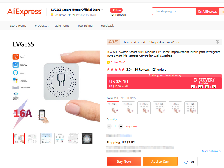

I came across another product which has diferrent internals but with CB2S/BK7321N.
Software version was V1.3.8
