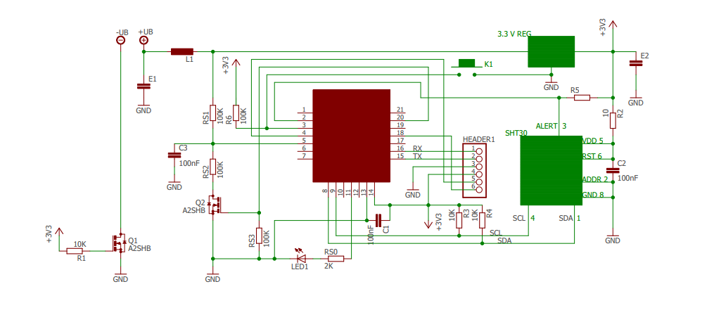

Some IoT devices are powered by electric battery and rely on ADC pin to do the battery measurement.
The issue is that the voltage value generally exceed voltage reference of Beken ADC pin who is by default 2400mv.
So to bypass that issue Tuya implement some voltage divider activated by a relay pin. here's an example on CBU:
thanks @nelliug54 for the schema :)
in this example BAT_ADC is on pin 5 and BAT_Relay on pin 20. when relay is activated it will divide the voltage on pin 5 by ~2.3 (it's mostly the case 2 or 3 AAA power sensor) on schema. but in real the divider was 2.29 so the vdivider really need to be adapt on each sensor (depending on the quality of resistor)
OpenBeken has a driver to capture that and publish the value in voltage and battery mqtt topic of the device.
If BAT_ADC pin is assign Battery driver will launched automatically and take measurement every 10sec.

p.kaczmarek2 24 Feb 2023 19:25
@dheenhasty do you think this solution is also used in those door sensors: https://www.elektroda.com/rtvforum/topic3959677.html https://www.elektroda.pl/rtvforum/viewtopic.php?p=20448552#20448552 The... [Read more]
dheenhasty 24 Feb 2023 20:25
Certainly on schema we see a transistor on gpio16 so it has a divider. A good way to test is to assign ADC to a channel and a rel to gpio16. Then you can try to switch the relay to check the value. Then... [Read more]

DeDaMrAz 15 Apr 2023 16:51
@dheenhasty Have you run across the battery reading issue, where the battery reading will be jumping from 2.5 (sometimes lower) to 3V while connected to a PSU? This is my autoexec.bat: Battery_Setup... [Read more]
dheenhasty 15 Apr 2023 17:10
Strange.... Not really. There's something strange in the log regarding the battery setup .... On which version you are ? [Read more]
DeDaMrAz 15 Apr 2023 17:47
Ok, this is what I've noticed on the bench so far. Measuring BAT_FET pulse with the oscilloscope (still trying to save images from it, so sorry no pictures right now). Measurement interval varies... [Read more]
dheenhasty 15 Apr 2023 19:19
The first version included a delay. But after some test i have removed it and trust the beken..... But seems like we might need to had some delay between the switch and the measurement. [Read more]

DeDaMrAz 16 Apr 2023 18:11
With 10mS pulse reading is much, much better. I've tested it on the entire working range (2.20 - 3.00V) with the latest 1.16.4 build. Here are some of the results: https://obrazki.elektroda.pl/6817990200_1681661421_thumb.jpg... [Read more]
