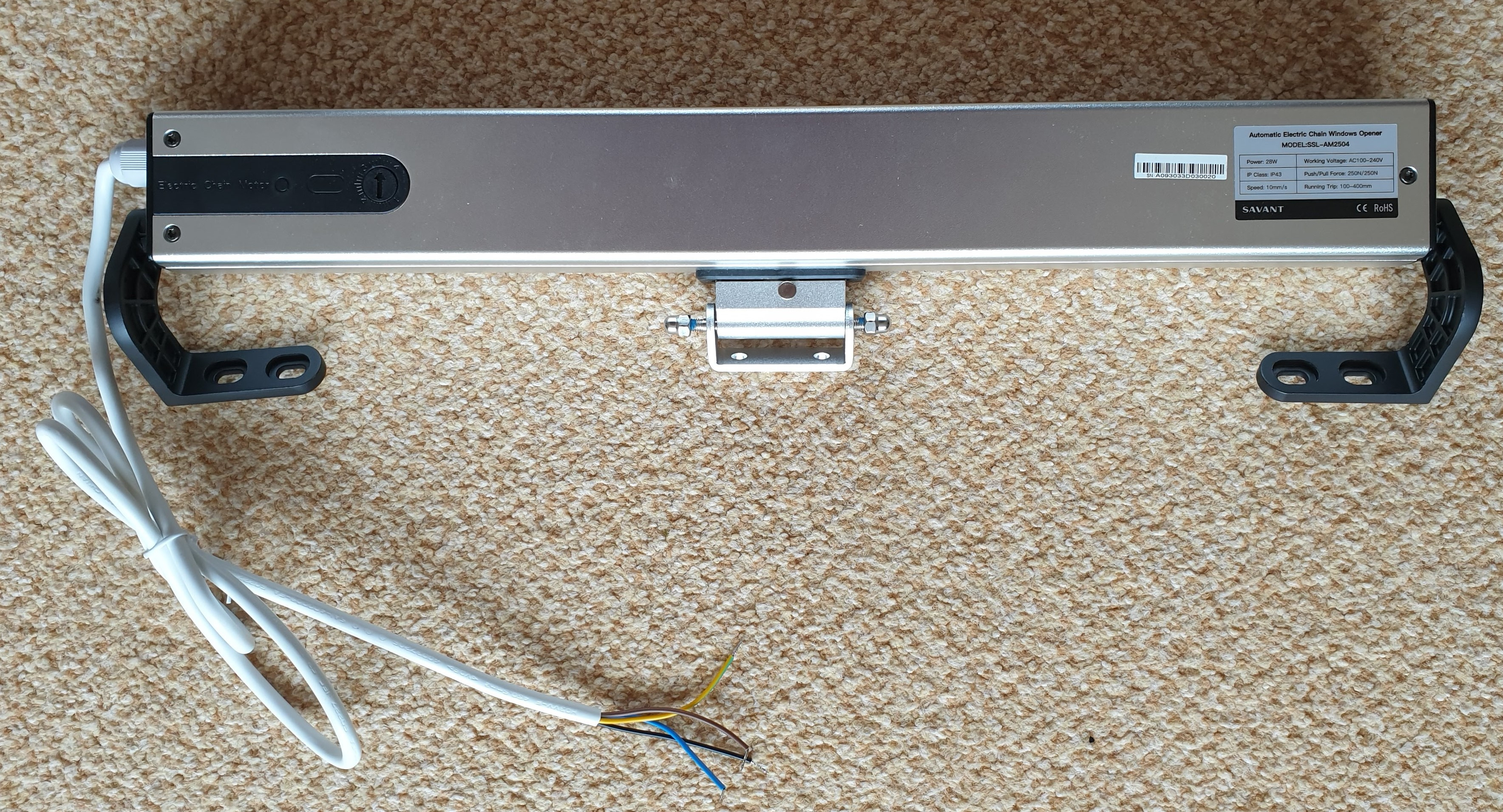

https://www.elektroda.com/rtvforum/posting.php?mode=editpost&p=20547099#I bought this Skylight opener and switch from AliExpress Link with the EU Wifi Switch. My skylight is out of reach and I have to get a ladder from that garage to open it! My original intention was to use it with Local Tuya (this would have been my first) within Home Assistant (HA) as I'd read manufacturers had moved away from ESP8266 boards; I'd flashed plenty of those with Tasmota. But then I came across OpenBeken so thought I'd give it a go.
First off, the opener itself is a 4 wire mains device. Green/Yellow - Earth, Blue - Neutral, Brown - Live Open and Black - Live Close.

Everything worked as expected but not how it needed to function so don't connect the actuator at this point!!!!!

I hid the default buttons since they could be used to turn both relays on at the same time and I don't know how the actuator would cope with that! After lots of testing, pressing buttons at random, I was satisfied the code worked ok so connected the actuator.

The skylight actuator wiring was 4-wire mains: Earth, Neutral, Live Open, and Live Close. [#20547099]
