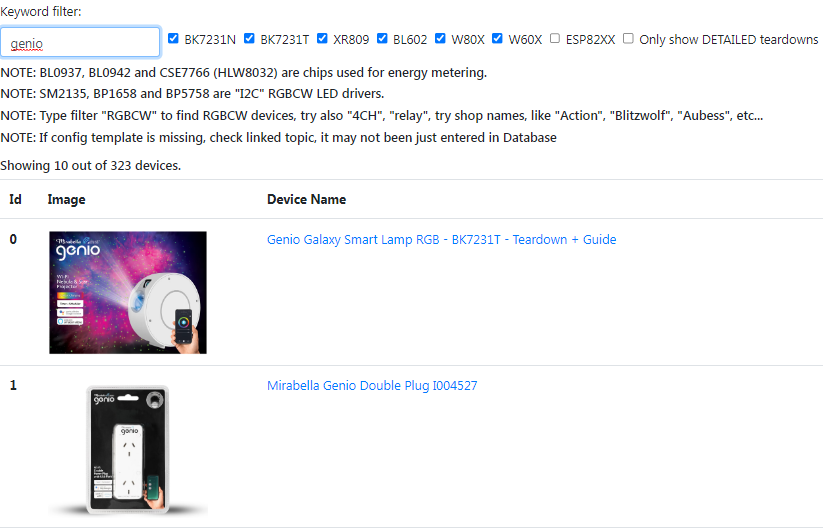

First, you can search our detailed teardowns list, here:
Here you can use various filters to browse devices list effectively, you can also click device name to get more or less detailed guide and discussion topic open:
