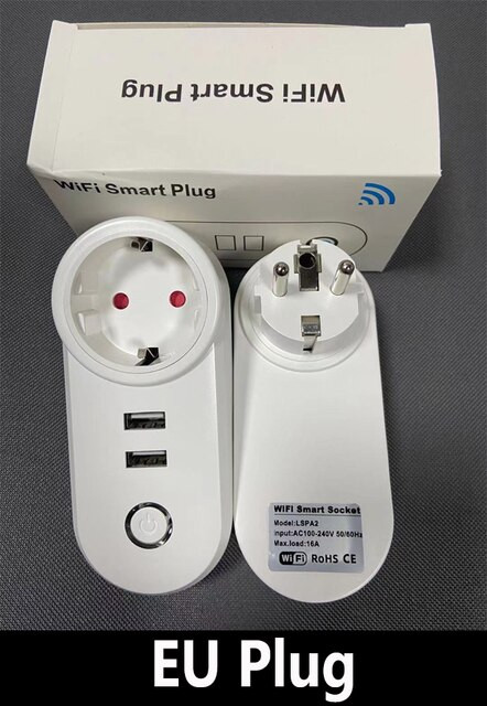

  • Tuya LSPA2 Wi‑Fi Smart Plug 16A ЕС AU UK with 2.1A dual USB, independently controlled USB ports, is converted to OpenBK7231N firmware on a BK7231N chip.
  • OpenBK7231N was installed with tuya-cloudcutter on a Raspberry Pi 3 using the '1.1.8 - BK7231N / oem_bk7231n_plug' exploit.
  • GPIO 6, 7, 10, 24, and 26 are assigned to two relays, a toggle button, a master relay channel, and the Wi‑Fi LED.
  • After flashing, the plug looks broken because LEDs and buttons stop responding, but it still works and can be configured at http://192.168.4.1/.
A new version of a similar BSD31 smart socket. It differs in that both USB ports are controlled independently and the BK7231N chip is used, not T.
When buying, the firmware version 1.1.8 is installed on the smart socket.
I installed the OpenBK7231N firmware using tuya-cloudcutter installed on Raspberry 3 with Raspberry PI OS.
I chose hack "By firmware version and name": "1.1.8 - BK7231N / oem_bk7231n_plug"
or download last firmware file OpenBK7231N_UG_1.17.135.bin to /tuya-cloudcutter/custom-firmware and run:
sudo ./tuya-cloudcutter.sh -r -p "mirabella-genio-i004527-double-plug" -f "OpenBK7231N_UG_1.17.135.bin"
Hacking occurs according to the instructions, from the second pass. After that, the device gives the impression of being broken, the indicators are not lit, the buttons are not pressed, but it is working. You can connect to the OpenBK7231N_MAC Wi-Fi network and configure the device by URL http://192.168.4.1/.

AgranBox wrote 5 posts with rating 2 . Been with us since 2023 year.
p.kaczmarek2 14 Jun 2023 09:01
That's the first device with independent USB port control that I've ever seen. Have you considered using: setChannelLabel 1 USB1 to give them some better display names on UI? See our docs: https://github.com/openshwprojects/OpenBK7231T_App/blob/main/docs/commands.md Also,... [Read more]
AgranBox 14 Jun 2023 09:37
setChannelLabel 1 USB1 setChannelLabel 2 USB2 setChannelLabel 0 Plug https://obrazki.elektroda.pl/3617296500_1686727717_thumb.jpg Added after 8 [minutes]: BK7231N_TuyaConfig_obk51F8744A.bin ... [Read more]
p.kaczmarek2 14 Jun 2023 09:43
Here's what I extracted: Device configuration, as extracted from Tuya: - Relay (channel 3) on P7 - Pair/Toggle All Button on P10 - WiFi LED on P26 - Relay (channel 2) on P6 - Relay (channel 1) on P24 Device... [Read more]
AgranBox 14 Jun 2023 10:41
https://aliexpress.ru/item/1005002741792619.html https://obrazki.elektroda.pl/3897225400_1686731086_thumb.jpg By the way, I bought here, but I came across similar models under other brands in local... [Read more]
