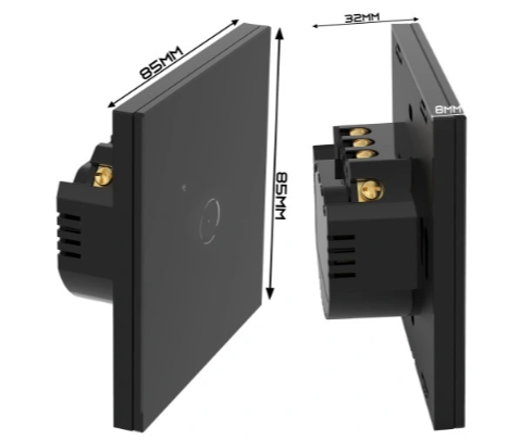

Black square WiFi light switch SmartLED 8044, 85x85x32 mm, shown front and side view.
I will present here the process of changing the firmware of another product popular on the Polish auction site, this time the WiFi-controlled light switch model SmartLED 8044. The purpose of changing the firmware will be to free it from the cloud and pair it with Home Assistant, this time 100% locally. I will put here the full GPIO template of this device generated by my flasher based on the Tuya configuration partition.
Product purchase
The product was bought in several pieces by one of our forum members, for whom I only changed the firmware in this switch (actually: in the switches, because I got some to rework) the firmware, so that he could connect them locally with HA. Thank you for sharing your play equipment. Below is a screenshot of the auction:
