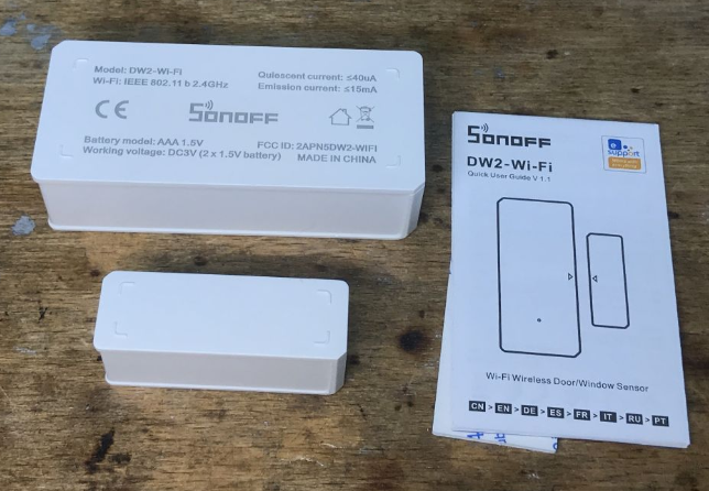

Here's what I got:
Box with Sonoff DW2 Wi-Fi door/window sensor. Sonoff DW2-Wi-Fi sensor packaging on a wooden surface.
Contents:
Sonoff DW2-Wi-Fi sensor set with user guide on a wooden table.
Case information:
- Quiescent current: <=40uA
- Emission current: <=15mA
- Model: DW2-Wi-Fi
- FCC ID: 2APN5DW2-WIFI
The sensor can be paired with the eWeLink app, then it works flawlessly, but this I already described in the case of the first reviewed door sensor:
