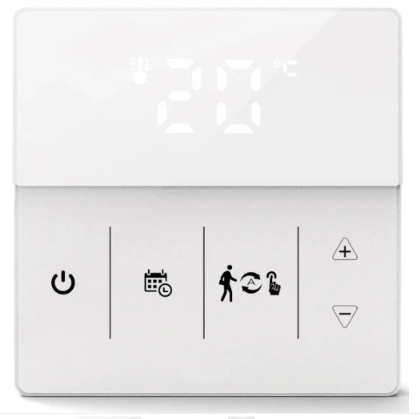

Today I invite you to a brief analysis of the interior of a rather expensive product - a room thermostat with touch buttons and LED temperature display, also offering control via WiFi. This product can be found in stores under the model name KHY609 or HY609-WE, it is available in two colors (white and black) and a variant with Zigbee communication is also on sale. Here, however, I will focus on its WiFi version, briefly test it in the Tuya application and then analyze its interior, including details of the TuyaMCU protocol used inside. Here I will show examples of the packets it exchanges over the UART and define the roles of the dpIDs used, which are TuyaMCU variables.
Purchase HY609-.EC and contents of the kit
Thermostats of this series were installed at the home of my friend, and I was temporarily given one piece just for a few days to test and play with. The thermostat itself can be purchased from various places on the web, both in our country and directly from China:
White room thermostat with LED display and touch buttons on the panel.
The product is quite expensive, 160 zloty for the WiFi version, and I've seen Zigbee versions even a hundred zloty more expensive. Let's see what the seller himself wrote about them:

Well, and the thermostat itself:
Back of a room thermostat with several labels and wire connectors. White room thermostat with touch buttons on a wooden background.

Received packet:
55 AA	03	00		00 01	01	04
HEADER	VER=03	Heartbeat		LEN	01	CHK
On the main menu - setting 30.5 temp:
Received packet:
55 AA	03	07		00 08	02 02 00 04 00000131 		4B
HEADER	VER=03	State		LEN	fnId=2 Val V=305	CHK
Received packet:
55 AA	03	07		00 05	04 04 00 01 03 		1A
HEADER	VER=03	State		LEN	fnId=4 Enum V=3	CHK
After a while, the fire icon appears - the heating is turned on:
Received packet:
55 AA	03	07		00 05	66 01 00 01 01 		77
HEADER	VER=03	State		LEN	fnId=102 Bool V=1	CHK
Changes power on application (on off):
Received packet:
55 AA	03	07		00 05	01 01 00 01 00 		11
HEADER	VER=03	State		LEN	fnId=1 Bool V=0	CHK
Received packet:
55 AA	03	07		00 05	01 01 00 01 01 		12
HEADER	VER=03	State		LEN	fnId=1 Bool V=1	CHK
Received packet:
Received packet:
Changing HighTem Protection to 44:
Received packet:
55 AA	03	07		00 08	70 02 00 04 0000002C 		B3
HEADER	VER=03	State		LEN	fnId=112 Val V=44	CHK
Changing LowTemp protection to 6:
55 AA	03	07		00 08	71 02 00 04 00000006 		8E
HEADER	VER=03	State		LEN	fnId=113 Val V=6	CHK
Change device power on state to Keep previous state:
55 AA	03	07		00 05	75 04 00 01 00 		88
HEADER	VER=03	State		LEN	fnId=117 Enum V=0	CHK
Change program type to 6+1:
Received packet:
55 AA	03	07		00 08	02 02 00 04 00000032 		4B
HEADER	VER=03	State		LEN	fnId=2 Val V=50	CHK
Received packet:
55 AA	03	07		00 05	76 04 00 01 01 		8A
HEADER	VER=03	State		LEN	fnId=118 Enum V=1	CHK
Changing program type to. 5+2
Received packet:
Received packet:
55 AA	03	07		00 05	76 04 00 01 00 		89
HEADER	VER=03	State		LEN	fnId=118 Enum V=0	CHK
Changing program type to 7:
Received packet:
Received packet:
55 AA	03	07		00 05	76 04 00 01 02 		8B
HEADER	VER=03	State		LEN	fnId=118 Enum V=2	CHK
Changing indoor temperature difference to 1.5:
Received packet:
55 AA	03	07		00 08	6E 02 00 04 0000000F 		94
HEADER	VER=03	State		LEN	fnId=110 Val V=15	CHK
Changing mode to manual:
55 AA	03	07		00 08	02 02 00 04 000000FA 		13
HEADER	VER=03	State		LEN	fnId=2 Val V=250	CHK
Received packet:
55 AA	03	07		00 05	04 04 00 01 00 		17
HEADER	VER=03	State		LEN	fnId=4 Enum V=0	CHK
Changing mode to Program:
Received packet:
55 AA	03	07		00 08	02 02 00 04 00000096 		AF
HEADER	VER=03	State		LEN	fnId=2 Val V=150	CHK
Received packet:
55 AA	03	07		00 05	04 04 00 01 01 		18
HEADER	VER=03	State		LEN	fnId=4 Enum V=1	CHK
Changing mode to Holiday:
Received packet:
Received packet:
55 AA	03	07		00 05	04 04 00 01 02 		19
HEADER	VER=03	State		LEN	fnId=4 Enum V=2	CHK
Based on this, you can determine what dpID any variable has and what format it is stored in (e.g. temperature is stored as an integer which has to be multiplied by 0.1 to get the result, i.e. for example 255 is 25.5°C.
