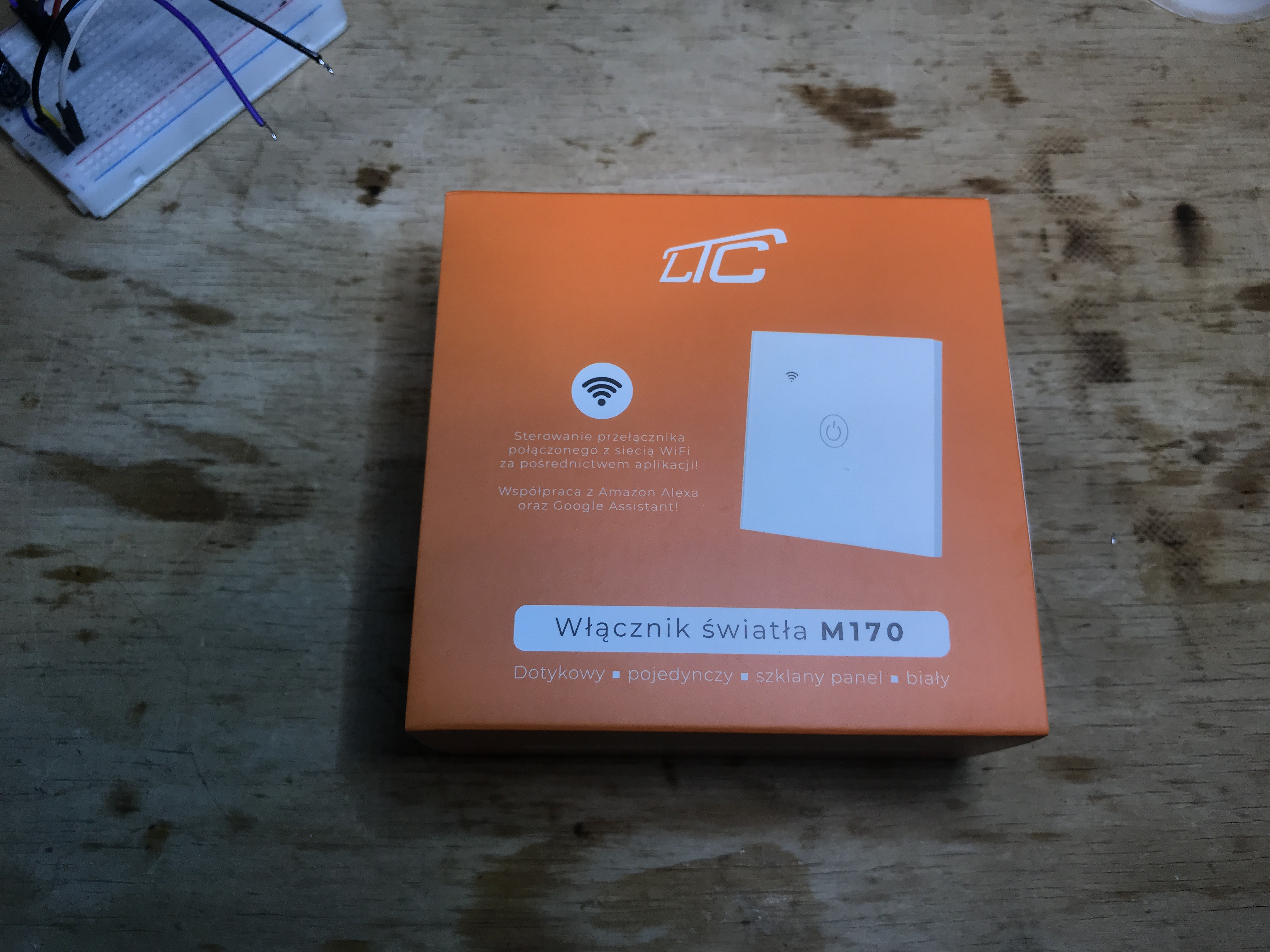

Hello, today I will show you another firmware change guide for a WiFi light switch popular in our country. Device will be flashed with OpenBeken , futhermore, we will also automatically detect GPIO configuration for this device with our BK7231 Easy Flash Tool.
Purchase of LXM170
I did the flashing for the reader, who sent me this device, But I know where the switch was purchased:
Advertisement for the Lamex LXM170 touch switch with price offer.
60 zlotys (about 15$) for the switch, it's not that bad, especially since it's in our country....

Packaging:
Packaging of M170 light switch. The packaging of the WiFi light switch M170 on a wooden table. Packaging of the LXM170 light switch with technical specifications.
