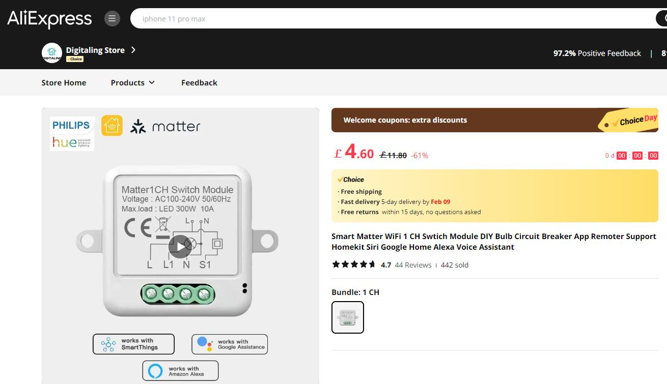

I grabbed this from Ali to have a play. https://www.aliexpress.com/item/1005006155824101.html
Image of an AliExpress product page showing the Matter1CH switch module.
It comes with a CB3S module which is BK7231N.
The VCC was just about accessible with a pin, so no soldering.
