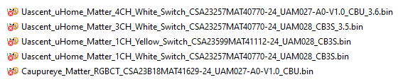

    To be sure - does it run on single uascent device, or on multiple pieces?
    Is OTA working? I guess not, as you mentioned earlier/?
  • Uascent dumps boot on one CB3S module
    #62 21466663
    Posts: 5223
    Help: 449
    Rate: 918

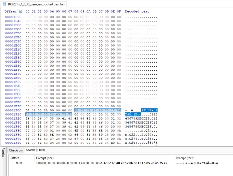

    I have only tried on 1 Uascent CB3S so far, but apart from the ZemiSmart dump, all other Uascent dumps have booted on this one CB3S - taking this as an indicator of consistency with Uascent keys.
    Nope.

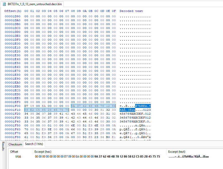

    >>21466663 OTA is working on my device is because i kept stock bootloader.
    Btw, the keys(coeffs) in that topic are probably wrong, obk and lt failed to boot with them. Only ota worked.
    I still have it disassembled, if someone can extract proper keys i can test 1.0.1 bootloader on it.
    Actually, does unencrypted 1.0.1 bootloader contains partitions? I remember when playing with 1.0.13 that partitions had to be inserted into it before encryption.

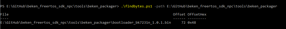

    TLDR: we're encrypting the standard Tuya BL BK7231N_1.0.1 with the Uascent coeff and adding CRC using a newer encrypt.exe. So we have a bootable QIO and OBK for Uascent devices, but no OTA. Looking in the BL of the Uascent coeff QIO the "01PE" partition section is also encrypted by the new encrypt.exe but it is plain text in the normal Tuya BL, so maybe this is why OTA doesn't work (?)
    Added after 12 [minutes]:

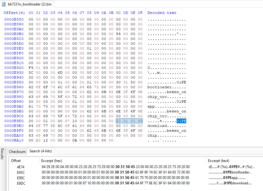

    seems to. https://github.com/openshwprojects/OpenBK7231...231n_os/tools/generate/bk7231n_bootloader.bin
    Screenshot showing a hex editor with an open binary file named bk7231n_bootloader (2).bin.
    Added after 3 [minutes]:
    latest https://github.com/openshwprojects/OpenBK7231...b03dd95/platforms/bk7231n/bk7231n_os/build.sh
    which I've just run into my own PR https://github.com/openshwprojects/OpenBK7231T_App/pull/1557

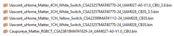

    is the file created here retrievable somehow after each build?
    Added after 2 [hours] 45 [minutes]:
    in an attempt to confirm coeff is consistent across the Uascent devices, I have flashed the OpenBK7231N_UASCENT_QIO_1.0.0.bin to the CB2L/UAM022 module on this bulb https://www.elektroda.com/rtvforum/topic4032988-30.html#21231617 and it does boot.
    so do these other Uascent dumps
    Screenshot showing Uascent and Capureye binary files.

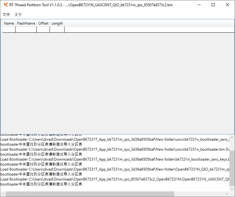

    Use rt_partition_tool on already encrypted bootloader to readd partition table
    Either figure out how to use it in cli, or use gui tool (https://github.com/NonPIayerCharacter/beken_freertos_sdk/tree/master/tools/rt_partition_tool)

    hmm. I can never get it to show anything apart from when it gets fed the pure ones that come with the SDKs.
    RT-Thread Partition Tool window with empty partition table and log messages

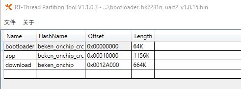

    modified bootloader_bk7231n_uart2_v1.0.15.bin to required partition sizes (partitions_modifiedbootloader_bk7231n_uart2_v1.0.15.bin)
    Partition table for BK7231N showing bootloader, app, and download regions

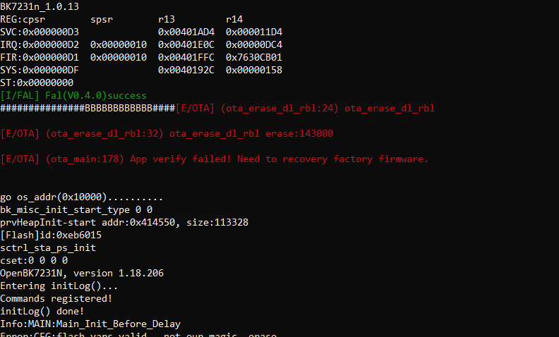

    boots but:
    OTA not work.
    https://github.com/divadiow/OpenBK7231T_App/commits/UASCENT/

    well, I've tried all sorts of things at this point, even replacing all keys with Uascent one in ALT SDK. I have QIOs from ALT SDK but none boot - I suspect it's because the older encrypt is used, which is why we tried cmake_encrypt_crc.exe in the old because that at least booted. No change: booting is possible but never OTA.
    https://github.com/divadiow/beken_freertos_sdk/commits/uascent/

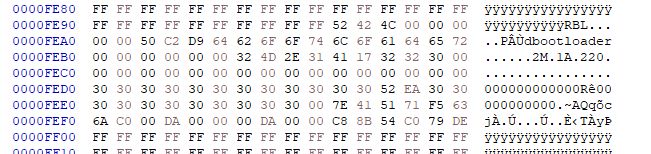

    posting what I've done before I forget.

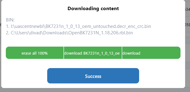

    Take BK7231N_1.0.1 from Tuya SDK. strip off 192 bytes of wrong partition info. Encrypt what's left with
    Add standard OBK partition with rt tool json import
    Remove new 192 bytes, save to file and add crc with
    Code: Python
    add CRCd partition bytes to encrypted and CRCd 1.0.1 BL. Flash to Uascent - boots. Add OBK RBL to 12a000 - OTA appears to run but then next boot freezes:
    Flash previous QIO from PR build that boots (non-working OTA), flash BL above to 0, boots into OBK. Try OTA - same result as above.
    Take BK7231N_1.0.13 from Uascent device dump. Uncrc. Remove partitions, add CRCd partitions as above, flash to 0, flash rbl to 12a000 - OTA begins but fails, as above.

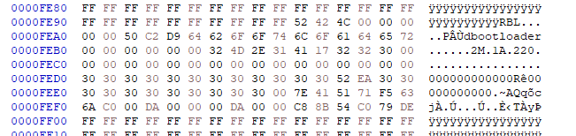

    Note: Uascent factory BL has RBL header at FE9A
    Hex editor screenshot showing binary data with the text bootloader

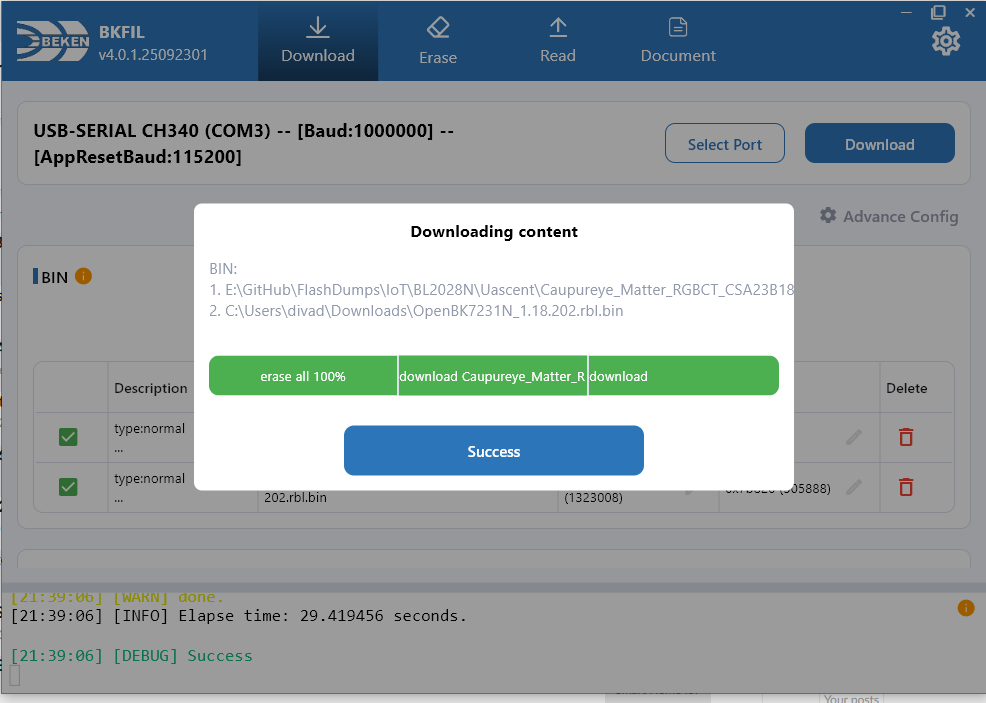

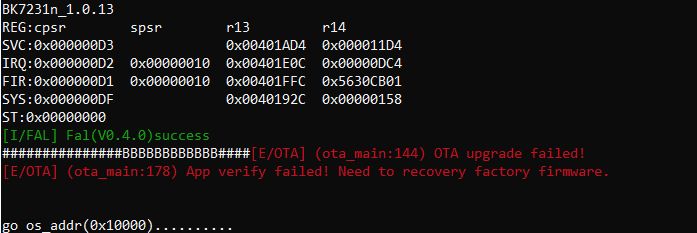

    tested flashing entire Uascent factory and flashing OBK rbl to 143000 and, as expected, OTA successful and OBK boots (but of course BL thinks ota is 143000)
    BKFIL software window showing completed binary file download message
  • OTA fails on Uascent QIO after booting from flash

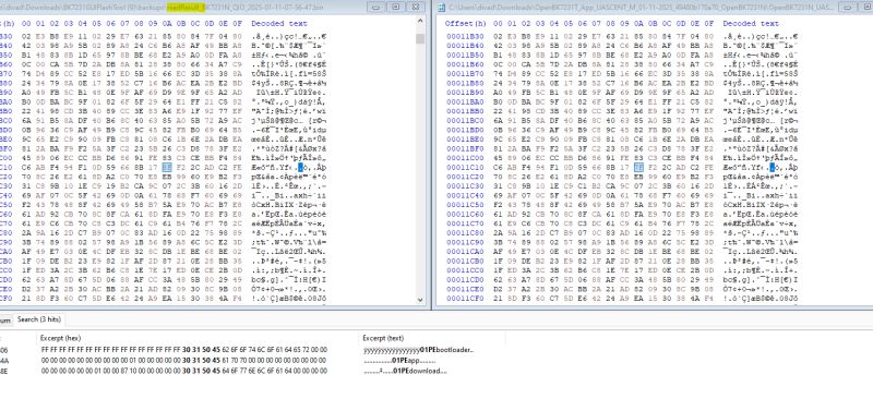

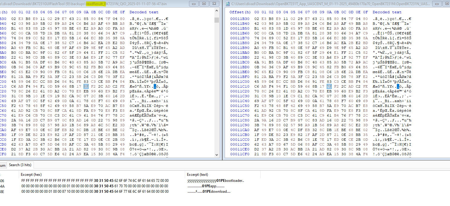

    https://github.com/divadiow/OpenBK7231T_App/commits/UASCENT_M_01-11-2025/
    https://github.com/divadiow/OpenBK7231N/commits/UASCENT_M_01-11-2025/
    OpenBK7231N_UASCENT_QIO_UASCENT_M_01-11-2025_49480b170a70.bin is in OpenBK7231T_App_UASCENT_M_01-11-2025_49480b170a70_OpenBK7231N.zip and it boots. OTA from OBK starts correctly but then dies, wdt reboot, no log. bricked, requiring re-flash.
    but if you flash UASCENT QIO to blank and rbl file to 12a000 in one write session, it'll complete OTA and boot fine. So that's where I'm at right now.
    If you compare the bricked dump to the QIO build the first difference isn't until 11C1A
    Comparison of two binary files in a hex editor with highlighted differences

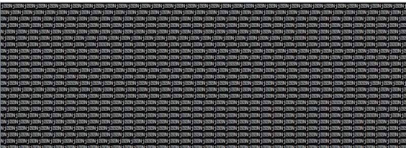

    trying v15 BL - bootloader_bk7231n_uart2_v1.0.15.bin
    -replaced x48-x57 with Uascent 9A 37 62 48 4B 78 12 86 58 E2 C5 85 28 45 75 75 (4862379A 8612784B 85C5E258 75754528)
    -removed 192byte partition info
    -encrypted with

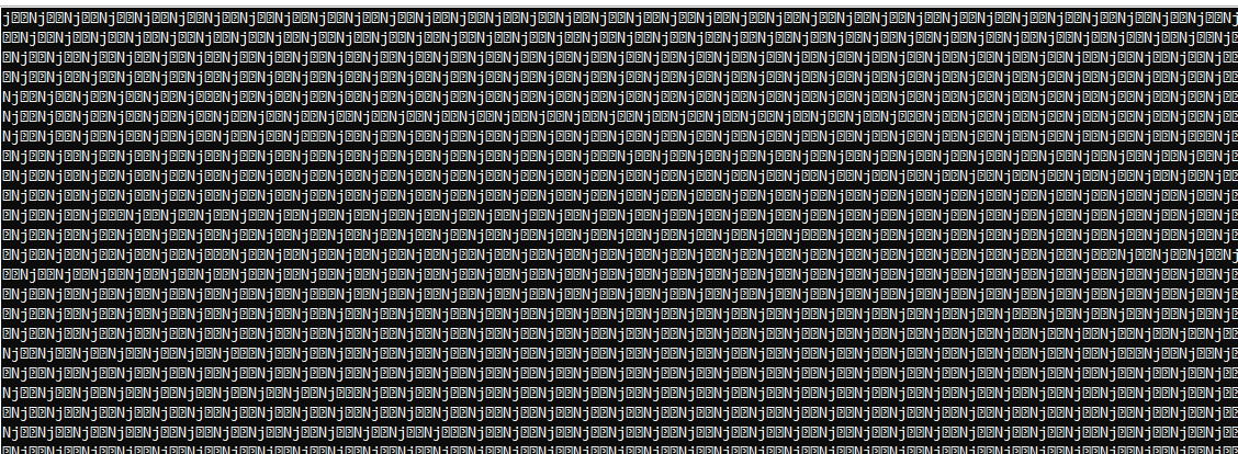

    added partitions to bootloader_bk7231n_uart2_v1.0.15_enc.bin then put through the PR for crcing with beken packager.
    getting this currently when QIO boots. same if crcing manually outside of build
    Terminal screen showing repeating “BIN&gt;” prompt in multiple rows
    @insmod I've been through your posts from last night several times but I'm still missing something. what have I missed?

    >>21737907
    0x48-0x57 bytes are only in 1.0.1 bootloader.
  • #82 21738142
    Posts: 5223
    Help: 449
    Rate: 918
    so it is! ok
    PowerShell screenshot showing output from running findbytes.ps1 script

    this is interesting https://github.com/mildsunrise/bk7231_key_calculator
    we should be able to get coeff from Beken dumps with it. In the zip file in the 1 issue there is a decrypted Uascent bootloader
    We see the little-endian Uascent key 9A 37 62 48 4B 78 12 86 58 E2 C5 85 28 45 75 75 at 1F2D alongside the ota key and iv
    Screenshot of a hex editor with highlighted little-endian Uascent key

    i'm still on the case of the no-OTA Uascent situation.
    BK7231n debug screen with OTA update failure message and processor register dump
    Screenshot of firmware tool showing BK7231N firmware download progress and success
    OTA seems to finish but then nothing on boot. dead.
    Added after 7 [minutes]:
    but I guess not finishing. this takes longer and doesn't have upgrade error. this is full Matter dump flashed + OBK rbl at 143000
    OTA error on BK7231N console with message requiring recovery firmware

    @insmod this now boots and OTA works on Uascent device. Uses uncrcd N_1.0.13 from decryption EF build.
    https://github.com/openshwprojects/OpenBK7231...OpenBK7231T_App:refs/heads/UASCENT_16_11_2025
    https://github.com/divadiow/OpenBK7231N/tree/UASCENT_M_01-11-2025
    ignore bootloader_1.0.13_4862379A_8612784B_85C5E258_75754528.bin that was for testing dd overwrite
    shall I do PR, any suggestions? or are are you about to drop a load of SBER and Uascent variants anyway? Not sure what your plans were, if any.
