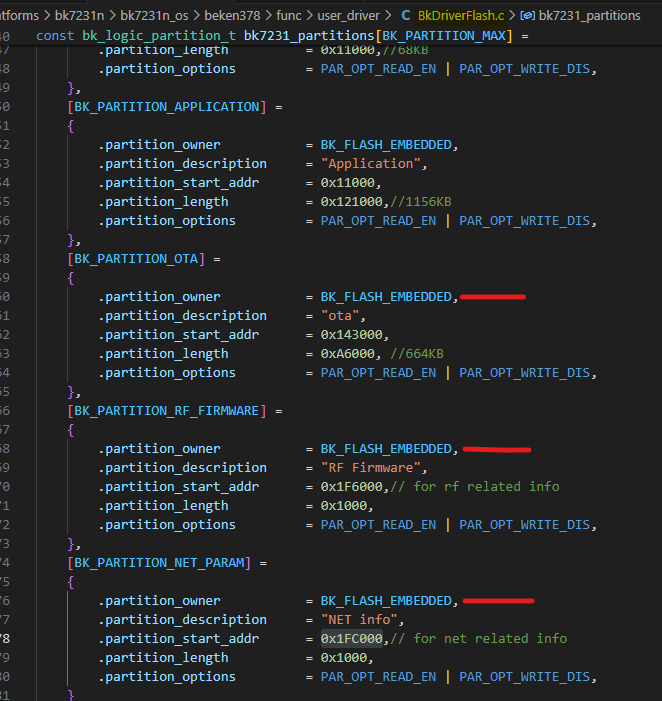

    Ah, I see. Nope. I haven't actually deployed that many smart devices for real use 😂. It's more about exploring and understanding electronics and everything OpenBeken of course
  • RF partition address change improves SSID detection
    #32 21138630
    Posts: 5223
    Help: 449
    Rate: 918
    a small step forward
    Screenshot of system logs showing network settings and SSID.
    more promising SSID after changing the RF partition address to match where it is in the uHome firmware. Also updated OTA to 0x143000.
    Source code fragment with memory partition configuration for Beken BK7231 device.
    Still no AP broadcasting and no mac address showing in boot log. Was hoping net info on these was at 0x1FC000 but that's not worked. flashing a Tuya net info partition to Tuya and uHome addresses used in PR builds has made no diff.
    https://github.com/divadiow/OpenBK7231N/commit/ce8def14c48f8f4eaafbeb7da80d93ef9d2040c8
    https://github.com/divadiow/OpenBK7231N/commit/aac9ed278a2cc15ef6f3652f71d8a0a92dc56c47

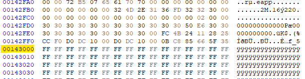

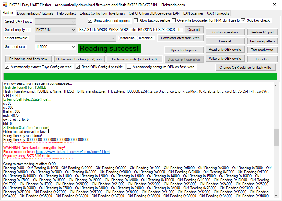

    No progress has been made, but I did get a "Tuya" Matter RGBCCT bulb that turned out to be another Uascent/RT-Threads device. UAM022-V1.0 (CB2L) module. Coeff key read-out disallowed, as it is with the others. Same bootloader/log
    Screenshot of the BK7231 Easy UART Flasher tool showing Reading success! status.
    UAM022-V1.0 module in a smart RGBCCT bulb
    same 0x143000 OTA address where rbls can be flashed directly for flashing to OBK on reboot
    Screenshot of a hex editor showing memory data with hex values visible. Screenshot showing hexadecimal and ASCII data from device memory.

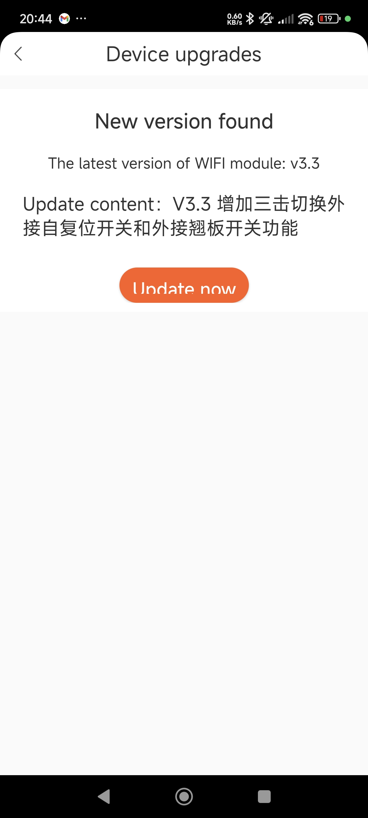

  • Factory firmware OTA also triggers ota_erase_dl_rbl error

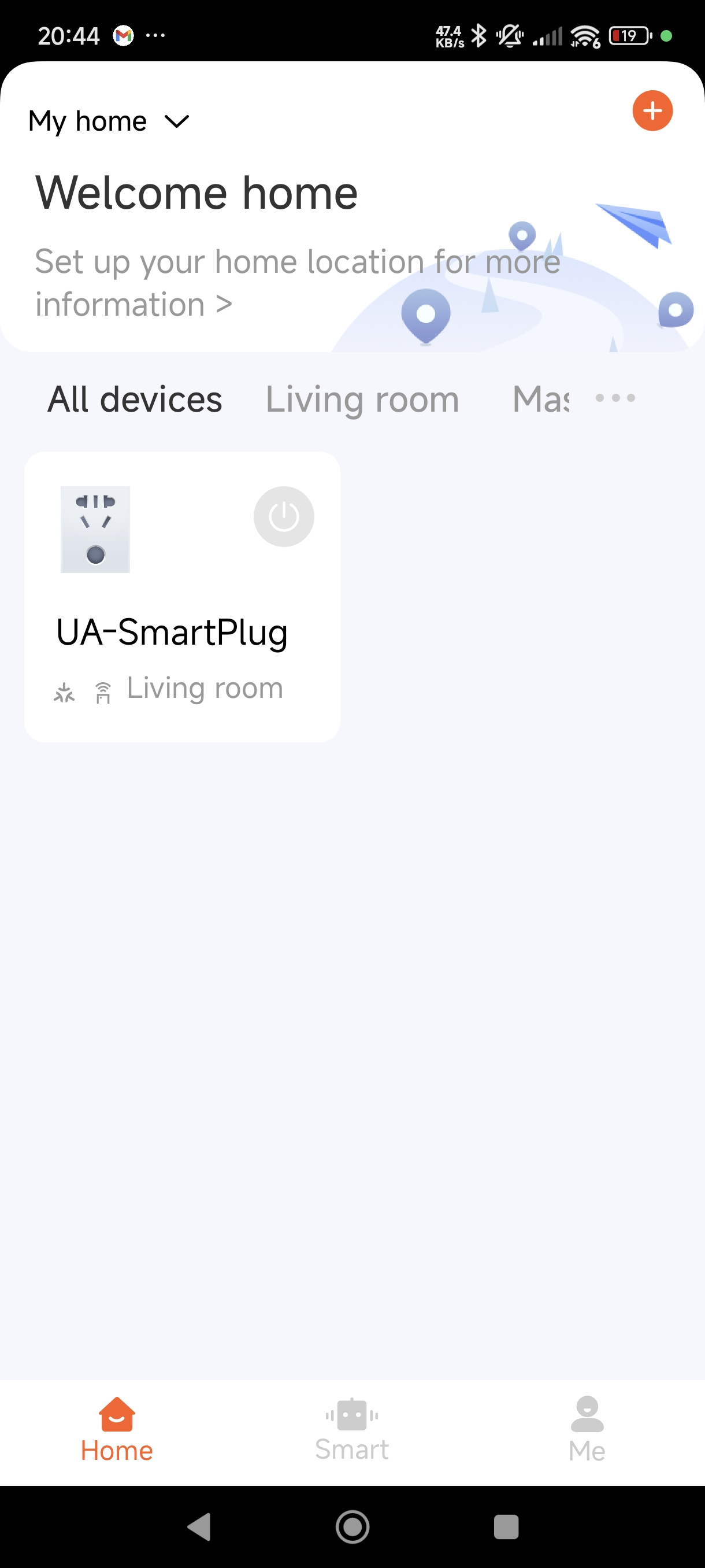

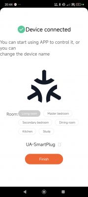

    #36 21425126
    Posts: 5223
    Help: 449
    Rate: 918

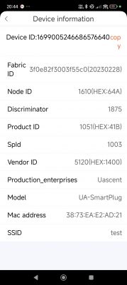

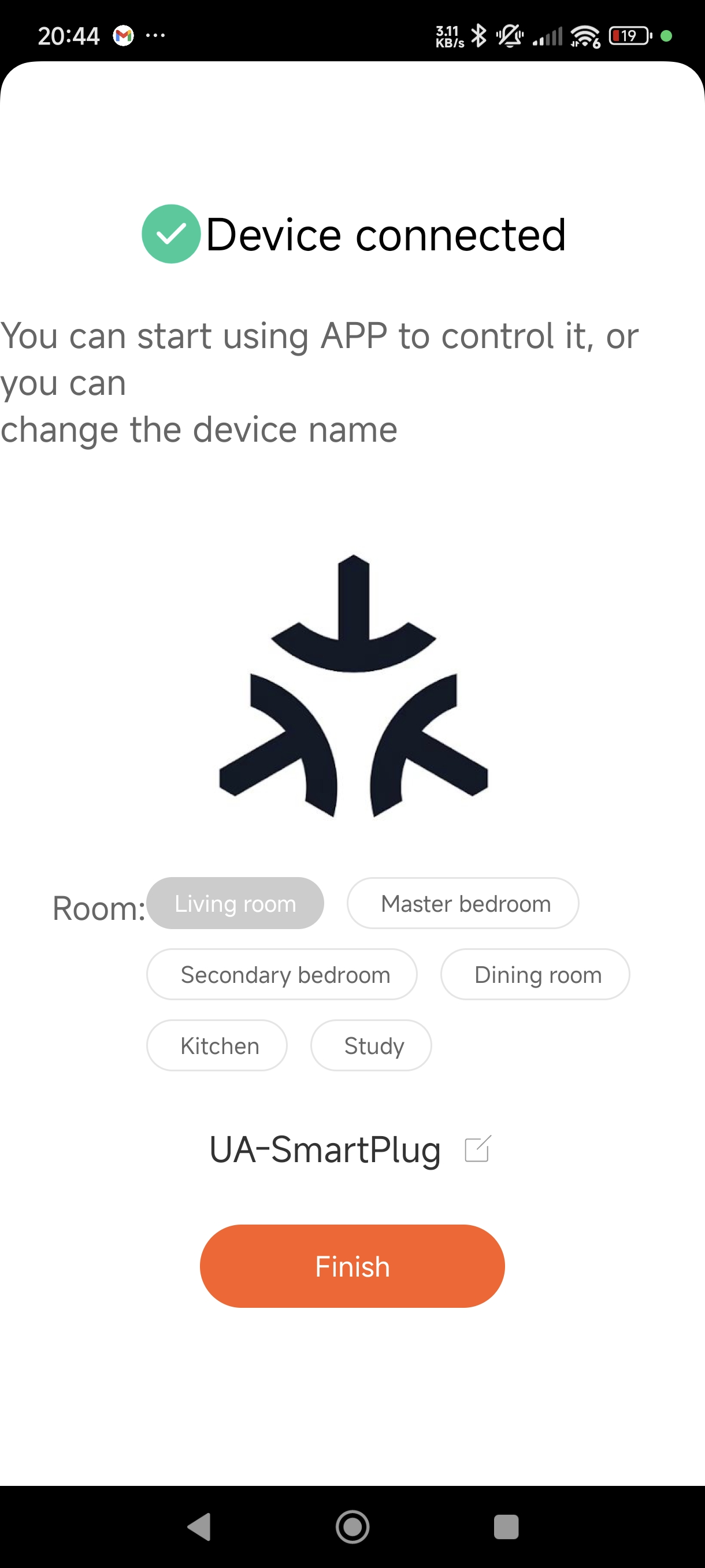

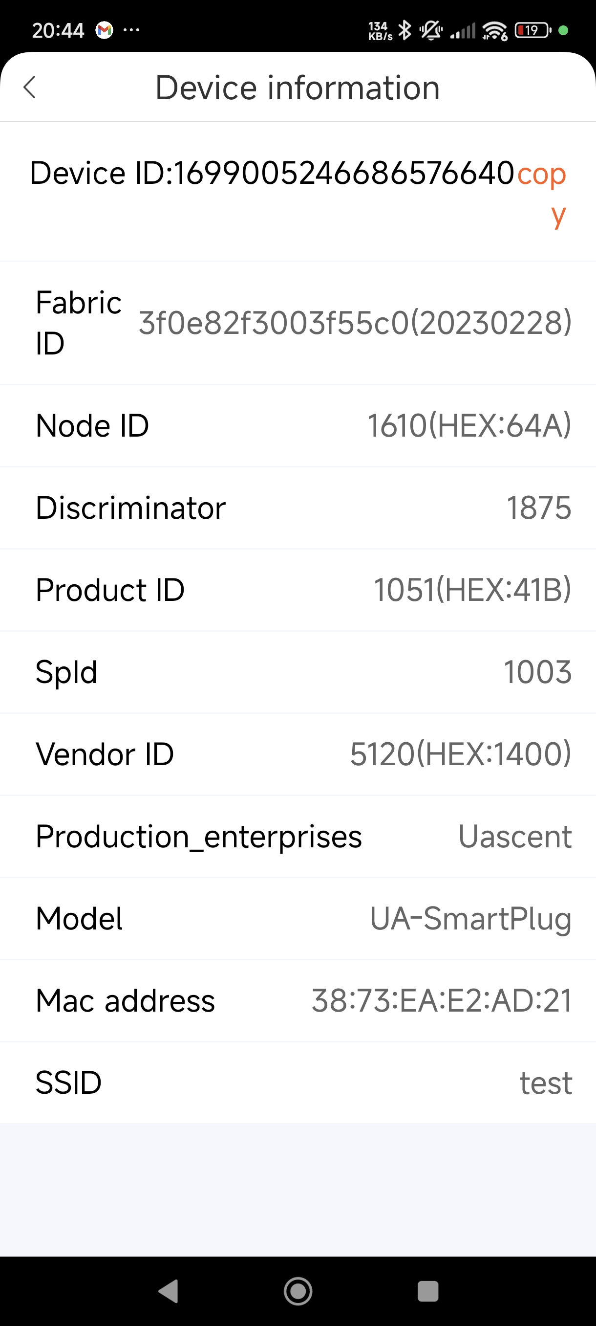

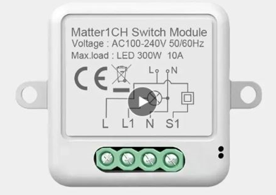

    interesting to note that a factory firmware upgrade of the original 10A 1CH mini Matter switch module also gives the ota_erase_dl_rbl errors after successful OTA
    Matter1CH switch module with voltage and load markings.
    uHome app pairing, device info and OTA offer
    App screen showing connected smart device information. Smart home app interface showing UA-SmartPlug device in the Living room. Device upgrade screen showing new software version. A screenshot displaying device information on a smartphone.

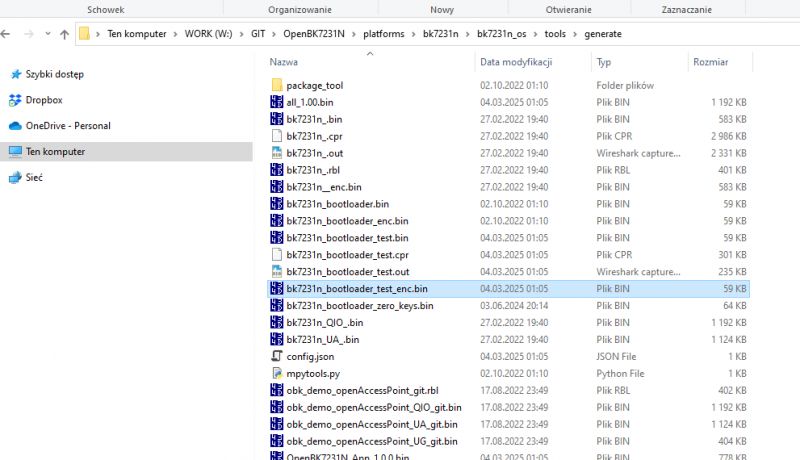

    Check this out, this generates encrypted bootloader for given key:
    cp ${APP_BIN_NAME}_${APP_VERSION}.bin ${APP_BIN_NAME}_${APP_VERSION}_zeroKeys.bin
    cp bk7231n_bootloader.bin bk7231n_bootloader_test.bin
    if [ "$BUILD_MODE" = "zerokeys" ]; then
       echo "Using zero keys mode - for those non-Tuya devices"
       ./${ENCRYPT} ${APP_BIN_NAME}_${APP_VERSION}.bin 00000000 00000000 00000000 00000000 10000
       #python mpytools.py bk7231n_bootloader_zero_keys.bin ${APP_BIN_NAME}_${APP_VERSION}_enc.bin
       python mpytools.py bk7231n_bootloader_enc.bin ${APP_BIN_NAME}_${APP_VERSION}_enc.bin
    else
       echo "Using usual Tuya path"
       ./${ENCRYPT} ${APP_BIN_NAME}_${APP_VERSION}.bin 510fb093 a3cbeadc 5993a17e c7adeb03 10000
       ./${ENCRYPT} bk7231n_bootloader_test.bin 510fb093 a3cbeadc 5993a17e c7adeb03 0
    fi
    ./${BEKEN_PACK} config.json
    Screenshot of a Windows folder with a list of files related to the OpenBK7231N project.
    Wanna get it for 4862379A 8612784B 85C5E258 75754528 ?

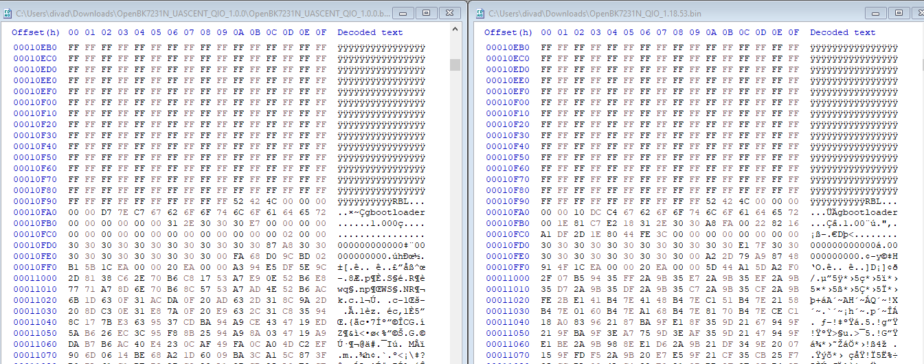

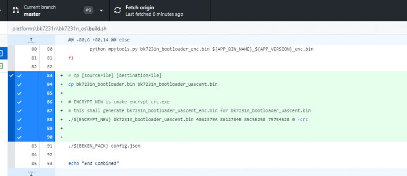

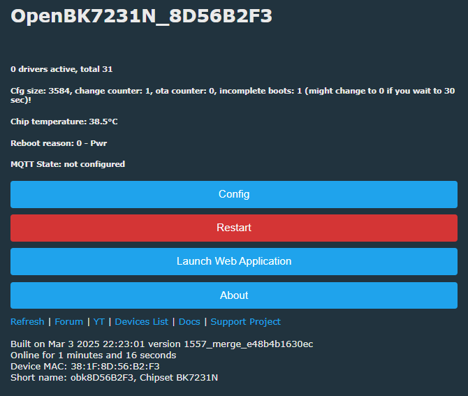

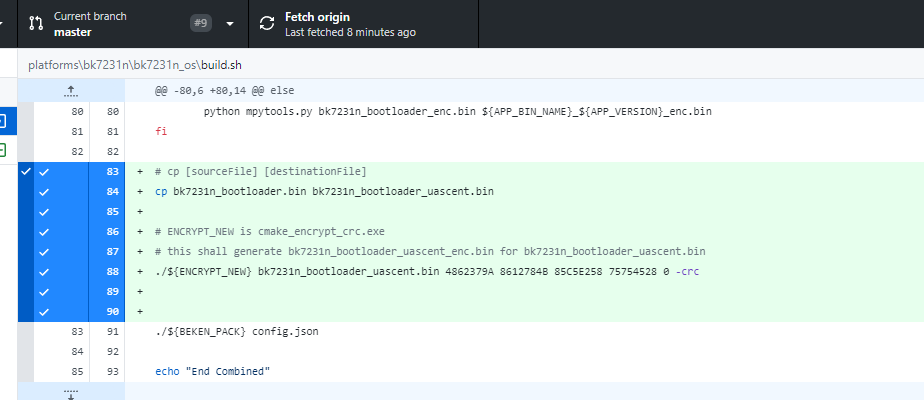

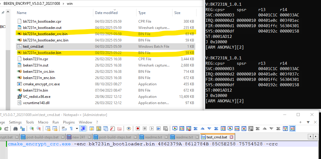

  • CRC-enabled BL file boots BK7231N on Uascent
    #42 21465151
    Posts: 5223
    Help: 449
    Rate: 918
    hmm.
    trying with
    generated file does not boot.
    Added after 18 [minutes]:

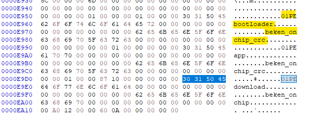

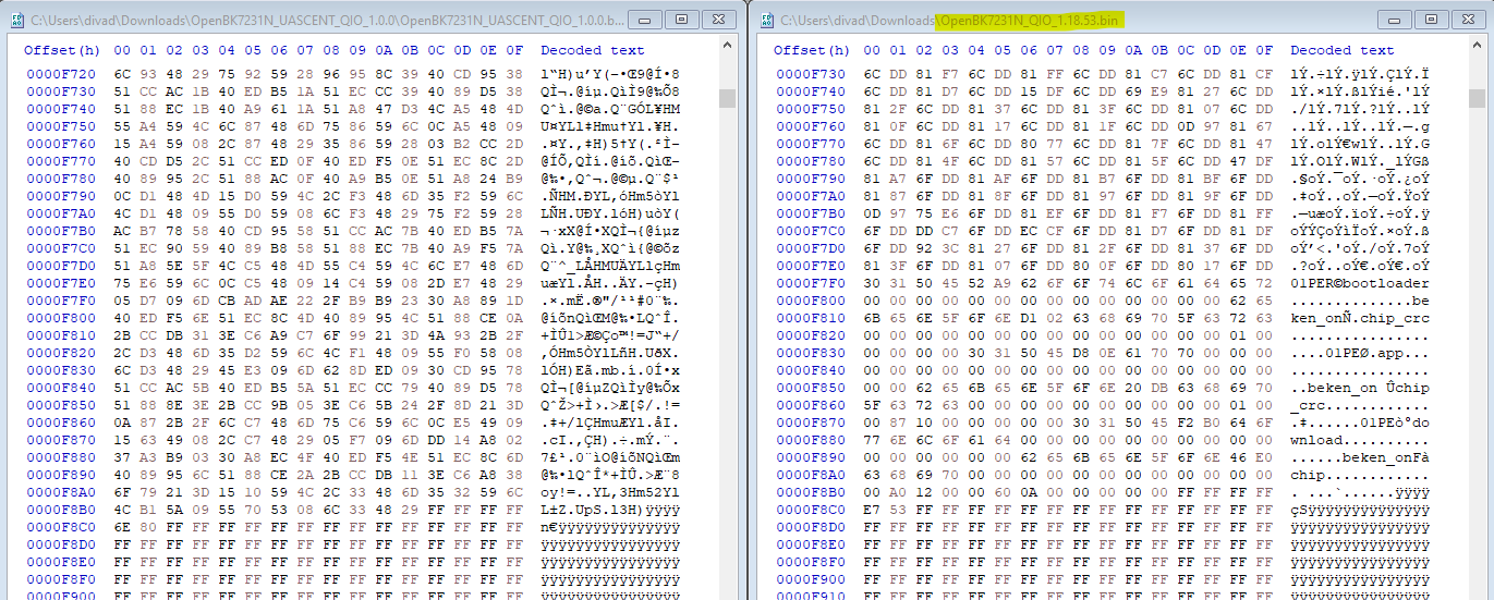

    I have been wondering about the crc and the BL file size differences. I remember seeing an example batch file in BEKEN_ENCRYPT_V5.0.0.7_20231008 that had -crc switch
    also that it always seems like BL has CRC
    Hexadecimal code snippet with textual annotations.
    I've given that a go, as below, and look! BK7231N_1.0.1 for the first time ever booting on Uascent (that I've seen)
    Screenshot of a folder with BIN files and a Notepad++ entry.
    and now. full erase. flash new BL with crc to 0x0, UART PR with new key to 0x11000 and restore RF partition in EF:
    OpenBK7231N control panel with device information.
    OBK with a mac and matching hostname
    curiously OTA doesn't work at the moment, but maybe these manual steps is missing some crucial bits. otafix for example.
    Added after 3 [minutes]:

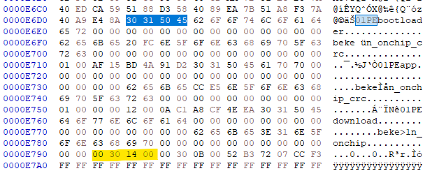

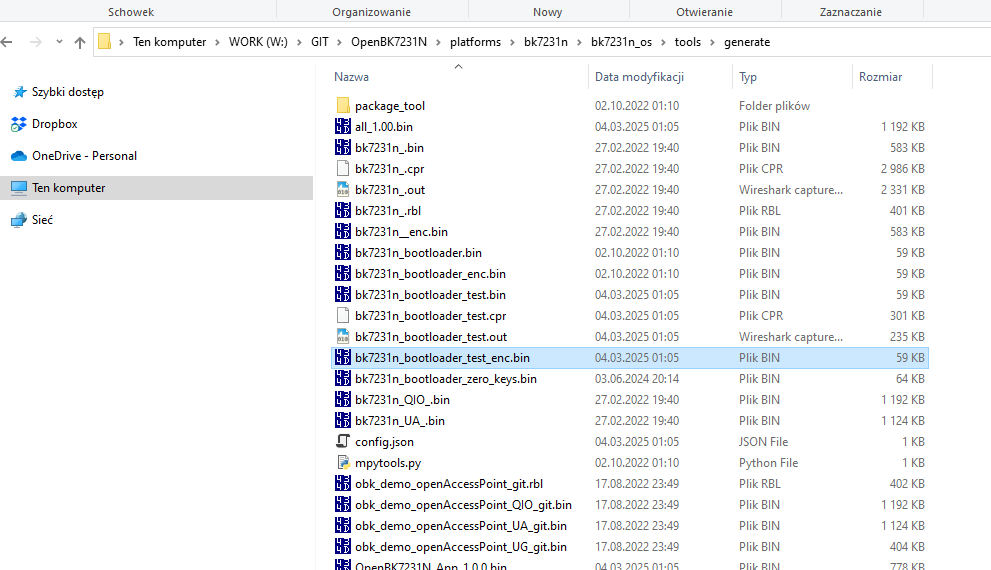

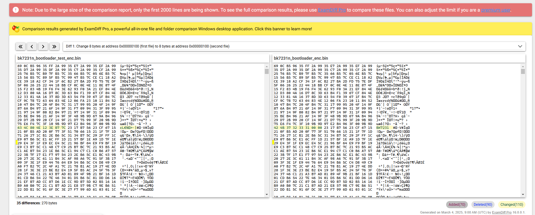

    #43 21465364
    Posts: 14782
    Rate: 12920

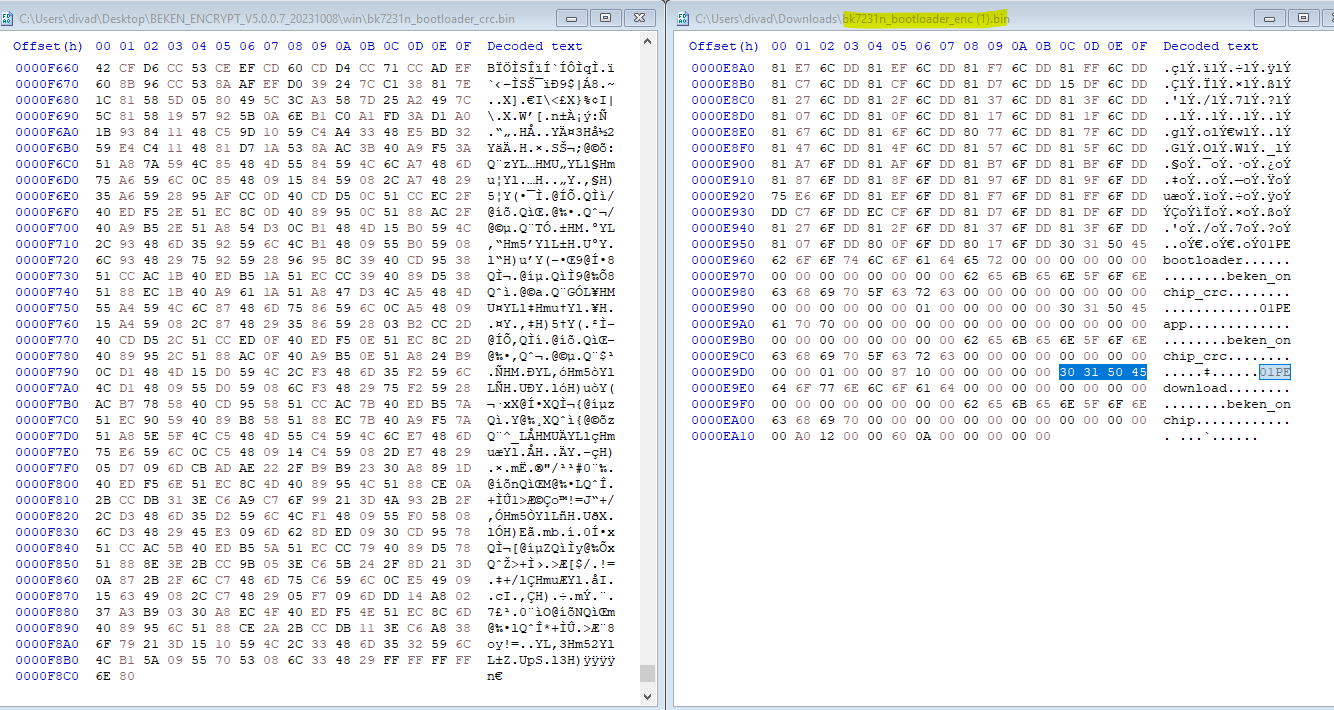

    I'd suggest doing different experiment, just to be sure.
    In my previous post, I've found that we have unecrypted bootloader and we can encrypt it ourselves.
    This line creates encrypted bootloader with given key:
    Now, we can check if our DIY encrypted bootloader (bk7231n_bootloader_test_enc.bin) is the same as bk7231n_bootloader_enc.bin , which was supplied by tuya. This will tell us if we do exactly 1:1 as them.
    At first glance, they are the same.
    However...
    I've used online binary compare.
    Binary file comparison using ExamDiff Pro with differences highlighted in colors.
    This is still not perfect.
    Changes as shown by AI:
    00000100+8
    -> 42 4B 37 32 33 31 00 00  BK7231..
    -> 63 4C 80 4E 12 3E B7 7C  cL.N.>.|
    0000E95C+212
    -> 30 31 50 45 62 6F 6F 74 6C 6F 61 64 65 72 00 00 00 00 00 00 00 00 00 00 00 00 00 00 62 65 6B 65 6E 5F 6F 6E 63 68 69 70 5F 63 72 63 00 00 00 00 00 00 00 00 00 00 00 00 00 00 01 00 00 00 00 00 30 31 50 45 61 70 70 00 00 00 00 00 00 00 00 00 00 00 00 00 00 00 00 00 00 00 00 00 62 65 6B 65 6E 5F 6F 6E 63 68 69 70 5F 63 72 63 00 00 00 00 00 00 00 00 00 00 01 00 00 87 10 00 00 00 00 00 30 31 50 45 64 6F 77 6E 6C 6F 61 64 00 00 00 00 00 00 00 00 00 00 00 00 00 00 00 00 62 65 6B 65 6E 5F 6F 6E 63 68 69 70 00 00 00 00 00 00 00 00 00 00 00 00 00 A0 12 00 00 60 0A 00 00 00 00 00 -- -- -- -- -- -- -- -- -- -- -- -- -- -- -- -- -- -- -- --  01PEbootloader..............beken_onchip_crc....................01PEapp.....................beken_onchip_crc....................01PEdownload................beken_onchip.................`..........................
    -> B1 2E 3F 98 E3 08 00 A9 ED 00 0E B9 E4 05 6F DD 81 7F 6F DD 81 47 6F DD 81 4F 6F DD E3 32 04 B8 EF 00 00 B3 E2 CF 07 AD DE CC 1C BE 81 B7 6E DD 81 BF 6E DD 81 87 6E DD 81 8F 6F DD 81 97 6E DD B1 AE 3E 98 E0 97 1E DD 81 EF 6E DD 81 F7 6E DD 81 FF 6E DD 81 C7 6E DD 81 CF 6E DD E3 B2 05 B8 EF 80 01 B3 E2 4F 07 AD DE 4C 1C BE 81 37 6E DD 81 3F 6E DD 81 07 6F DD 81 88 7E DD 81 17 6E DD B1 2E 3E 98 E5 08 19 B3 ED 00 0F B9 81 77 6E DD 81 7F 6E DD 81 47 6E DD 81 4F 6E DD E3 32 05 B8 EF 00 01 B3 E2 CF 00 AD 81 AF 69 DD 81 B7 69 DD 81 BF 69 DD 81 27 7B DD 81 EF 63 DD 81 97 69 DD 7E 60 96 22 FF FF FF FF FF FF FF FF FF FF FF FF FF FF FF FF  ..?...........o...o..Go..Oo..2................n...n...n...o...n...>.......n...n...n...n...n..........O...L...7n..?n...o...~...n...>..........wn...n..Gn..On..2............i...i...i..'{...c...i.~`."................
    Questions to consider:
    - why our own bk7231n_bootloader_test_enc.bin is still different from Tuya bk7231n_bootloader_enc.bin ?
    - does our bk7231n_bootloader_test_enc.bin runs on the same device where bk7231n_bootloader_enc.bin would run?
    - how to get exactly the same result as Tuya?
    Maybe it's indeed this CRC switch.
    @divadiow if you use your method to encrypt Tuya bootloader with the Tuya key, do you get the same 1:1 file as the bootloader Tuya has given us already encrypted?

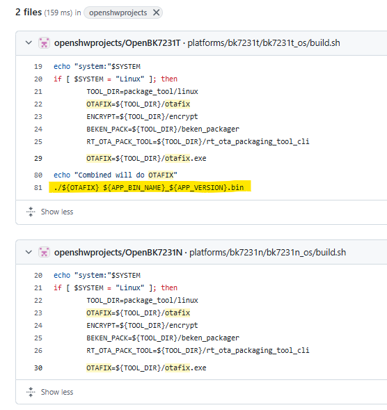

    Is otafix anywhere used in the code?
    https://github.com/search?q=repo%3Aopenshwprojects%2FOpenBK7231N%20otafix&type=code
    oh. must be what I saw and thought it was being invoked. just looks like a variable for it, but not used?

    otafix is used on T but not N? What does it even fix?
    build.sh script code for the OpenBK7231T and OpenBK7231N projects.

    I've tried to add "-crc" switch to encrypt from OpenBK7231N repo:
    	./${ENCRYPT} bk7231n_bootloader_test.bin 510fb093 a3cbeadc 5993a17e c7adeb03 0 -crc
    but no matter what I do, argument is not recognized?
    It seems like we need to get that new encrypt you've found into our repo, and then we could integrate an OBK build (without OTA working yet) for Uascent ?

    Rate: 918
    OK, so Uascent module doesn't boot with non-crc BL and -un-skip argument also means no boot. So this = working BL on Uascent:
    Added after 4 [minutes]:
    it's like it's encrypting too much. 01pe partition should be in plain-text surely
    Comparison of two binary files in a hexadecimal editor.
    Added after 28 [minutes]:
    Interesting, I've changed ALL keys in the build.sh into the Uascent one, so N and M QIO should both boot, neither do.
    https://github.com/openshwprojects/OpenBK7231...mits/d2c2eda407d011406ef3158e0c91244e79383871
    both QIOs contain 01PE as one would expect
    Added after 12 [minutes]:
    the M QIO general release does not boot on 4mb SparkleIOT BK-N

  • Add zero-key and QIO build steps to script
    #54 21466425
    Posts: 14782
    Rate: 12920
    Yes... and then use it in our script.
    Probably here:
    echo "Will do extra step - for zero keys/dogness"
    cp ${APP_BIN_NAME}_${APP_VERSION}_zeroKeys.bin ${APP_BIN_NAME}_${APP_VERSION}.bin
    echo "Will do zero keys encrypt"
    echo "Will do zero mpytools.py"
    echo "Will do zero BEKEN_PACK"
    echo "Will do zero qio"
    cp all_1.00.bin ${APP_BIN_NAME}_QIO_${APP_VERSION}.bin
    cp ${APP_BIN_NAME}_QIO_${APP_VERSION}.bin ../../${APP_PATH}/$APP_BIN_NAME/output/$APP_VERSION/OpenBK7231M_QIO_${APP_VERSION}.bin
    cp ${APP_BIN_NAME}_UA_${APP_VERSION}.bin ../../${APP_PATH}/$APP_BIN_NAME/output/$APP_VERSION/OpenBK7231M_UA_${APP_VERSION}.bin
    Add the same code but for uascent..
    I can try maybe, but you can try as well, I'll see how far we can get :D
  • #56 21466442
    Posts: 14782
    Rate: 12920
    I'm trying this at the moment:
    Source code snippet in GitHub editor with highlighted changes.
    Added after 6 [minutes]:
    Not tested:
    https://github.com/openshwprojects/OpenBK7231...mmit/960cc10ddcfca021de7372469b5cb4a09b1d593b
    Added after 32 [minutes]:
    Does it boot?
    • OpenBK7231N_UASCENT_QIO_1.0.0.zip (883.81 KB) You must be logged in to download this attachment.
  • UASCENT encryption and packing steps
    #57 21466505
    Posts: 14782
    Rate: 12920
    Current approach:
    # 	UASCENT steps (4862379A 8612784B 85C5E258 75754528)
    # Copy blank bootloader just to have it  with "uascent" in name
    # cp [sourceFile] [destinationFile]
    cp bk7231n_bootloader.bin bk7231n_bootloader_uascent.bin
    # Call encrypt like Divadiow did
    # ENCRYPT_NEW is cmake_encrypt_crc.exe
    # this shall generate bk7231n_bootloader_uascent_enc.bin for bk7231n_bootloader_uascent.bin
    ./${ENCRYPT_NEW} -enc bk7231n_bootloader_uascent.bin 4862379A 8612784B 85C5E258 75754528 -crc
    # Copy blank-start App with zero keys bin
    # Apply keys to the App
    echo "Will do UASCENT encrypt"
    # This will generate ${APP_BIN_NAME}_${APP_VERSION}_enc.bin
    ./${ENCRYPT} ${APP_BIN_NAME}_${APP_VERSION}.bin 4862379A 8612784B 85C5E258 75754528 10000
    # Use mpytools.py to generate config.json for encrypted bootloader and encrypted app
    echo "Will do UASCENT mpytools.py to generate config.json"
    # python mpytools.py [BootloaderFile] [AppFile]
    python mpytools.py bk7231n_bootloader_uascent_enc.bin ${APP_BIN_NAME}_${APP_VERSION}_enc.bin
    # Use Beken Pack on created config.json to combine bootloader and app together into all_1.00.bin
    echo "Will do UASCENT BEKEN_PACK"
    echo "Will do UASCENT qio"
    cp ${APP_BIN_NAME}_QIO_${APP_VERSION}.bin ../../${APP_PATH}/$APP_BIN_NAME/output/$APP_VERSION/OpenBK7231N_UASCENT_QIO_${APP_VERSION}.bin
    cp ${APP_BIN_NAME}_UA_${APP_VERSION}.bin ../../${APP_PATH}/$APP_BIN_NAME/output/$APP_VERSION/OpenBK7231N_UASCENT_UA_${APP_VERSION}.bin
  • Second boot log confirms BK7231N startup
    #58 21466523
    Posts: 5223
    Help: 449
    Rate: 918
    awesome. yes it does boot!
    here is second boot with RF written to standard Tuya in place
    sadly no OTA to n rbl. OTA log

    Posts: 5223
    Help: 449
    Rate: 918
    So you're saying that both bootloader and application are running? Or just bootloader is correct?
    both running
    curious about the 01PE stuff missing though.
    a couple of comparisons
    Comparison of two binary files in hexadecimal format.
    Developer view with two Hex Editor windows displaying raw binary data.
