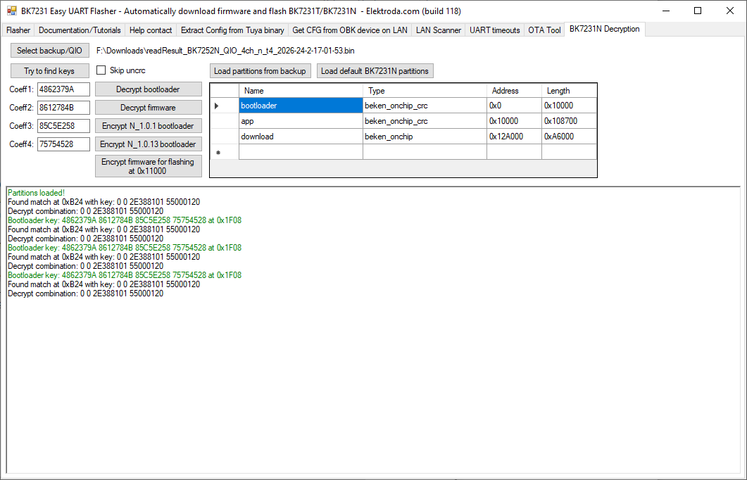

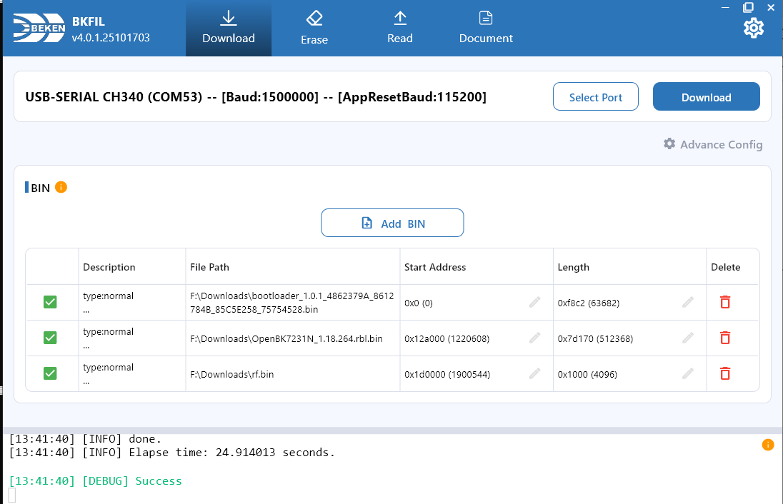

    it takes a bit of fiddling because of the encryption key in efuse that Uascent devices have set.
    you need to load up your backup in the BK7231N Decryption tab in Easy Flasher, find keys, add default BK7231N partitions, encrypt bootloader - flash encrypted bootloader to 0x0. then encrypt the OpenBK7231M app partition only for burning to 0x11000. Ideally you'd then restore RF from your backup to correct location too.
    Screenshot of BK7231 Easy UART Flasher showing partition table and decryption log output
    A bit long-winded and I think it would still be better to have a Uascent QIO in artefacts, ready-built.
    I attach a file that has all that done. Do erase all on your device then flash this full dump from 0x0 under BK7231M mode or BK7231N with skip key check. This file includes the RF from your backup. Initial boot will unpack the ota rbl I put in at 0x12A000 and then boot into fresh OBK. OTA within OpenBeken works for me in testing.
    File is a 2mb dump of flash after this creation:
    Screenshot of BEKEN BKFIL showing BIN file list and a “Success” log message.
    To add template to device list, submit a PR for edit to this file https://github.com/OpenBekenIOT/webapp/blob/main/devices.json
    • Uascent_1.0.1_4862379A_8612784B_85C5E258_75754528_OBK_1.18.264_RF.bin (2 MB) You must be logged in to download this attachment.
