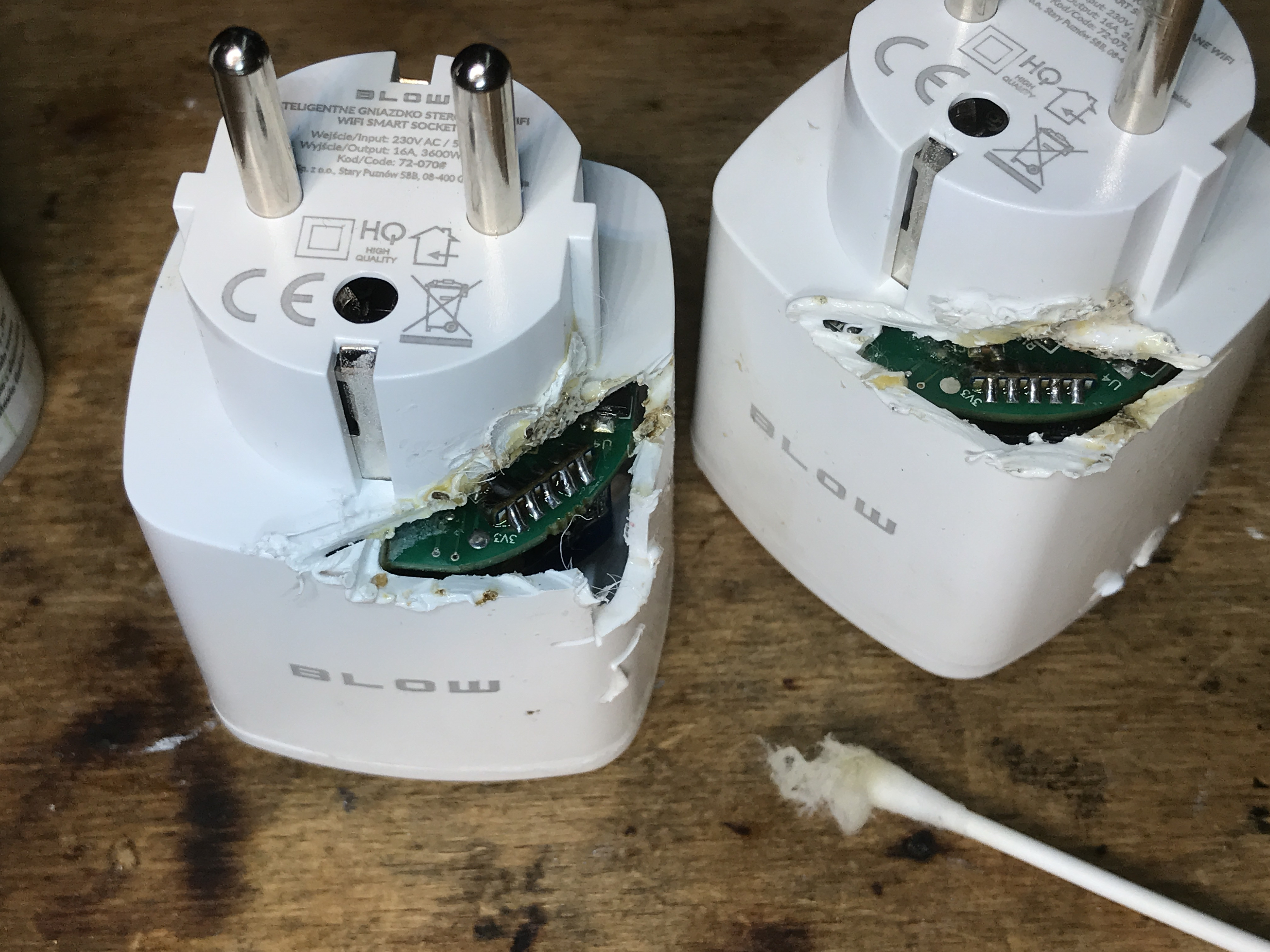

I will show you a little interesting fact - a quite invasive but effective way to change the firmware of the cheapest WiFi-controlled socket. This socket is characterized by a low price (PLN 30) and a structure that makes it impossible to remove the board with the WiFi module from inside, which makes changing the insert very difficult. This is not a product like Blitzwolf sockets, where we have either a hidden screw or retractable pins, here everything is held together and there is really no way to get to the programming pads. Normally I wouldn`t touch it, but I received a request from a reader to change the insert of such a socket at all costs ...
You can buy this socket really cheap and it`s not strange at all - it`s the cheapest option possible:

Interior and blow flashing
At first, they are disassembled like LSPA9, but after a while we have a surprise - the ground plate holds the rest of the system:
Open plastic electrical socket with visible interior components.
I don`t know how to make sense of this:
Interior of a cheap WiFi socket showing the PCB and electrical components.
After consulting the reader, the decision was made - we cut:

Already then I tried to connect with the programmer:
View of a damaged electrical socket with exposed wires and exposed PCB. Modified electrical socket with exposed interior.
There is of course BK7231 inside, BK7231Flasher should be able to handle it:
but here is the problem, because the energy measurement system is probably on RX/TX... so you need to desolder the module:
Damaged Blow socket with exposed circuit board. Image of a damaged electrical socket with visible electronic components inside.

Finally, we protected the socket - first with a solder mask, and then (on the reader`s side) with epoxy or some form of filler, at our discretion:
Two damaged electrical sockets with exposed PCBs. Two electrical sockets with visible damage and glowing blue light.
Summary
Nothing to be proud of here, terrible load changing device. Very problematic, especially since now the products are no longer susceptible to the exploit allowing the first OTA via WiFi. I have very fond memories original LSPA9 where it was possible to remove the entire PCB from the housing. In the case of Blow, this is not possible due to the previously mentioned rivet plate.
It`s possible that something better could be invented, but I only programmed two pieces, so the method from the topic worked anyway.
