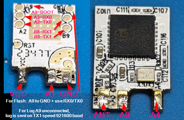

This is a teardown GU10 RGBCW Bulb with new VERY tiny LN882HKI module, which I've never seen before. Obviously, this device is also supported by OpenBeken, so you can free it from the cloud and use with Home Assistant. Here are the details...
Device can be bought here:
https://www.aliexpress.com/item/1005005881188...o.order_list.order_list_main.4.4e951802GSrd1g
Pin connections for LOG
VCC <- 3V3
GND <- GND
B8 (TX1) -> RX (log is using baudrate 921600)
Pin connections for backup and flash
VCC <- 3V3
GND <- GND
A3 (RX0) <- TX
A2 (TX0) -> RX
A9 -> GND
Backup was done using
LN882H_Flash_Dumper.py COM3 backup 0x0200000
It took about 10 minutes, but the dump is fine
Upload was done (of course after power off/on module to activate bootmode) using:
LN882H_CMD_Tool COM3 download flash 2000000 0x0 OpenLN882H_1.17.586.bin
It took about only 4 seconds - but no error and everything seems to be ok
Just to be sure, I've used baudrate 115200
LN882H_CMD_Tool COM3 download flash 115200 0x0 OpenLN882H_1.17.586.bin
It took about 60 seconds now
After restarting the module
- on TX1 is there something like "start console ok...."
- on TX0 is there OBK std output...
Next step was to set WiFi using std. procedure over OBK AP (192.168.4.x)
I had problems with the WiFi connection, because the antenna is on the power supply board, and I flashed it as just the module itself (meaning without the antenna). I had to put the module close (1m) to the WiFi AP to make it working. After soldering module later back into the power supply board, the WiFi worked normally.
Bulb has just two active pins to rule the BP5758.
I've discovered this:
A0 - BP5758D_CLK
A1 - BP5758D_DAT
Last thing was to change color map, because red was blue a blue was red.
I've added OBK Startup command to solve it:
BP5758D_Map 2 1 0 3 4

p.kaczmarek2 18 May 2024 07:09
Thank you for sharing. The used module seems similiar to CBLC5. Maybe it's an LN882HKI version of that? Here is original CBLC5: https://obrazki.elektroda.pl/9677894700_1716008948_thumb.jpg [Read more]
XJ_ 18 May 2024 11:01
I agree, it looks like. Its pinout compatible. Unfortunately, I couldn't find anything on the module, what would appear to be a type. There is only a date on the QR code - 202401090239F. I couldn't even... [Read more]
p.kaczmarek2 18 May 2024 12:25
There are few things that can be done to reduce the heating of your module: - first of all, you can enable PowerSave 1 in short startup command or in (if supported) LittleFS file autoexec.bat - then... [Read more]
max4elektroda 18 May 2024 13:58
The high temperature is a known problem, the module itself gets quite hot, the surrounding (especially with heating LEDs) will make it even hotter. You probably should try if powerSave 2 is an option... [Read more]
divadiow 18 May 2024 14:56
module also seen here https://www.elektroda.com/rtvforum/viewtopic.php?p=20983813#20983813 [Read more]
divadiow 20 May 2024 07:15
sorry, missed this [Read more]
p.kaczmarek2 20 May 2024 08:00
The best way to get some info: https://www.elektroda.com/rtvforum/find.php?q=LN882HKI Second best way: https://openbekeniot.github.io/webapp/devicesList.html but we may need to improve search function... [Read more]
