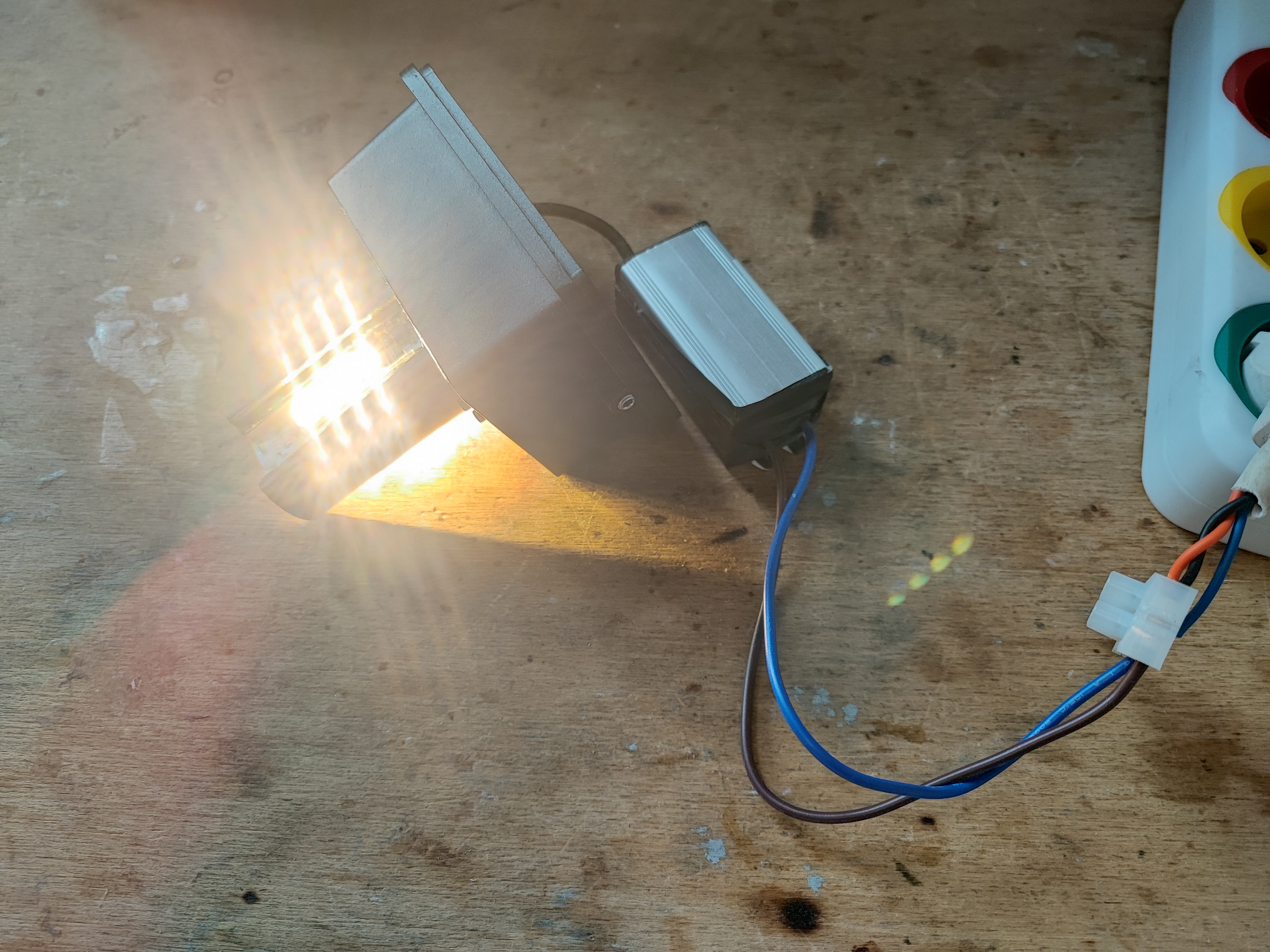

Here I will present an interesting RGBCW lamp driver with a communication protocol very similar to the WS2812B diodes. I became interested in the subject at the request of a reader from Germany, who even sent me a "smart" lamp with this very driver so that I could try to decrypt it and run it in my environment. The aim, of course, was to make it cloud-free. We started the adventure by reverse-engineering, although after we had already decrypted some of the communication, someone else from the readers shared the catalogue note, so things got simpler too. But one step at a time...
This topic is the result of a thread from Elektroda.com:
OpenBeken Driver Connection Issues with RGBIC SM15155E and BK7231N in Smart Wall Lamp .
SM15155 is used in at least one of the Tuya lamps available to buy online:

Since the base works, the lamp can be put together. I took the opportunity to add paste between the LED plates and the metal housing:
Black lamp housing with a layer of thermal paste on a metal base. .
A short test and everything works:
LED lamp illuminating a wooden surface. Wall lamp with open casing, connected by cable, emitting bright light. Lamp with connected wires on a workshop table. Preview module with green light on a desk Smart LED lamp emitting blue light on a wooden workbench. .
The lamp now correctly displays the control panel on the OBK home page and can be paired with Home Assistant.

The 14-byte frame carries five 16-bit channel values, then four configuration bytes. The author first inferred the layout from color-change captures, then the later shared datasheet clarified that after 5 × 16-bit channel data come five 5-bit current settings, 2 standby-enable bits, and 5 unused bits. In practical tests, the packet tail 73 9C E7 1F stayed constant and allowed the lamp to work. [#21121650]
How do you modify the PulseView or Sigrok WS2812B decoder to analyze SM15155 byte streams correctly?
You modify the WS2812B decoder so it outputs raw bytes instead of assuming RGB grouping. The author changed the Sigrok decoder to collect bits, emit one annotation every 8 bits, and keep reset detection based on a low period above 50 µs. That immediately revealed a 14-byte frame. This approach works because the signal timing is close enough to WS2812B for the bit-level logic to remain useful. [#21121650]
Which timing values were observed on the SM15155 data line, and how close are they to WS2812B signaling requirements?
The author observed about 340 ns high and 1.16 µs low on the data line. He described those timings as reminiscent of WS2812B, though not ideal. They were still close enough for practical reuse of a WS2812B-style decoder and SPI transmission method. That timing similarity was the key reason the lamp could be controlled with an existing SPI-based LED sender before a dedicated driver existed. [#21121650]
SM15155 vs WS2812B: what are the key differences in channel count, byte meaning, and practical control method?
SM15155 differs by channel model, frame meaning, and intended lamp use. WS2812B workflows usually assume RGB bytes for addressable LEDs, while the SM15155 lamp in the thread used 5 channels for RGBCW and one global lamp color. The SM15155 frame also included configuration bytes after channel data. In practice, both could share a timing-compatible SPI sender, but only after the author prepared the correct SM15155 raw packet format. [#21121650]
How can you control an SM15155 lamp in OpenBeken by reusing the SPI-based SM16703P or WS2812B-style raw byte sender?
You can control it by sending a handcrafted SM15155 frame through the existing SPI-based SM16703P raw-byte path. The author started SM16703P, initialized 5 outputs, and used SM16703P_SetRaw with frames such as FF000000000000000000739CE71F00. That cycled the lamp through RGBCW channels successfully. The extra trailing 00 was ignored in his test, which made the existing sender a practical bridge before native integration. [#21121650]
What is the purpose of the last bytes like 73 9C E7 1F in the SM15155 packet, and how do they relate to current settings or standby bits?
Those final bytes encode non-color configuration, not visible RGBCW intensity data. After the datasheet appeared, the author linked that packet tail to five 5-bit current settings, 2 standby-enable bits, and 5 unused bits. That explains why color control still depended on keeping 73 9C E7 1F in place during successful tests. It also explains an edge case: changing only channel bytes may fail if the configuration tail is invalid. [#21121650]
How do you flash OpenBeken onto the FL_M129_V3 BK7231N module inside this lamp and wire up 3.3V, RX, and TX safely?
You flash it by removing the FL_M129_V3 module, then wiring the programming pads to a 3.3 V serial adapter. The thread shows the author soldered to 3.3 V, GND, RX, and TX and flashed OpenBeken using the BK7231 toolchain. Use only 3.3 V logic and avoid powering the module from higher voltage rails. The module was worth desoldering because its underside pads were clearly labeled. [#21121650]
Why did the author conclude that this particular SM15155 lamp appears to react to 8-bit values even though the datasheet mentions 16-bit color resolution?
He concluded that because his practical tests changed only one byte per 16-bit channel and the lamp still responded correctly. In the integrated code, he wrote 8-bit values into packet positions i * 2 and left the paired bytes at zero, yet the lamp produced the expected colors. He explicitly noted the mismatch and said more testing was needed to explain what the other 8 bits were doing in this product. [#21121650]
What steps are needed to start the SM15155E driver and apply LED_Map in OpenBeken so the lamp works with Home Assistant?
You need to start the driver and apply the lamp’s channel remap. The thread says the minimum autostart command is startDriver SM15155, and the later template uses backlog startDriver SM15155E; LED_Map 0 1 3 2 4. After that, the lamp exposes the proper control panel in OpenBeken and pairs with Home Assistant like other supported RGBCW devices. The template also lists BK7231N board details for this exact lamp. [#21128586]
What safety precautions matter when testing this disassembled RGBCW lamp without proper heatsinking or cooling?
You must limit run time and watch LED temperature because the lamp can overheat when disassembled. The author explicitly warned that his bench setup had no cooling and required care to avoid overheating the LEDs. He later added thermal paste between the LED plates and the metal housing before final assembly. That detail matters because open-air testing without the intended thermal path can damage LEDs or skew results. [#21121650]
