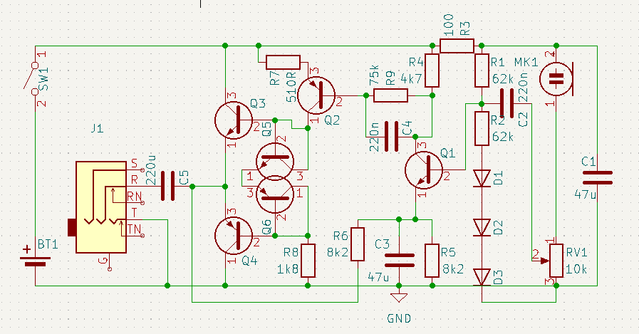

Similar topics have already been discussed on the Forum, but my device is the most mine, so I decided to share a report of its construction with those who either have hearing problems or would like to make a similar device for someone with such a problem.
I'm not an acoustician and I don't do acoustics at work, so professionals versed in the art may find the presented device technically poor, incompatible with the art and Be at all, but it has an undeniable utility value confirmed by the person concerned, with whom I can now communicate freely.
I know you can buy a fairly decent amplifier on the MAX9814, however, where is the fun and learning here?
So I borrowed the base schematic from the website : Link .
I made this device unchanged, but it had some significant drawbacks such as a very high resting current ( battery life ) and a lot of noise.
So I decided to simulate this circuit under LTSpice, which pointed me in the direction of improvements.
This resulted in a circuit with relatively low noise, a flat gain characteristic from about 80Hz to the limits of audibility ( probably around 10kHz ) and a negligible resting current of less than 3mA.
The final shape of the circuit is shown in the diagram below:
Circuit diagram of an audio amplifier. .
and here is a revised version of the final layout form:
Hand-drawn schematic of an electronic circuit on grid paper. .

kris8888 24 Jun 2024 15:13
Why transistors Q5 and Q6 and not ordinary diodes in this location? Does this have any significant effect or influence on anything (on e.g. noise)? [Read more]
yego666 24 Jun 2024 16:54
In the first version I used 1N4148 diodes, which is what was recommended, but I noticed on the oscilloscope a waveform skip ( actually it was a saddle) when switching the output transistors. After replacing... [Read more]
kris8888 24 Jun 2024 17:09
. Yes, this is crossover distortion. It's just that when you used diodes there was too little resting current for the terminal transistors. Apparently transistors Q5 and Q6 as diodes have a minimally... [Read more]
yego666 24 Jun 2024 18:42
Thanks for the expert explanation and definition. "Cross-cutting" - nice word :) . I did not pair transistors Q5 and Q6 but Q3 with Q5 and Q4 with Q6 to match the voltage drops across the connectors... [Read more]
kris8888 24 Jun 2024 19:13
This is also unnecessary because all that matters is the sum of the voltage drops on Q5 and Q6. And in what proportions and whether they correspond exactly to the E-B voltage drops of transistors Q3 and... [Read more]
